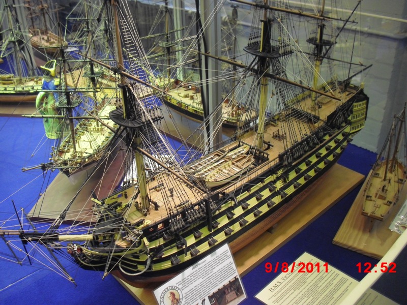

Hi Jase I love what you are doing with this enhancment, is this any help, notice the walkways over the Guns to the steps:-
CALDERCRAFT PRODUCTS 002.jpg (263kb) downloaded 27 time(s).
#8 Posted : 28 November 2011 20:59:00
Nice pics matey!! i am assuming DeAg have got the walk ways?! I may have to put an extra beam in place to support the deck if i am moving the cabins back. working on the side pieces at the moment the measurements are the same so there will be standard window sizes throughout Cool
