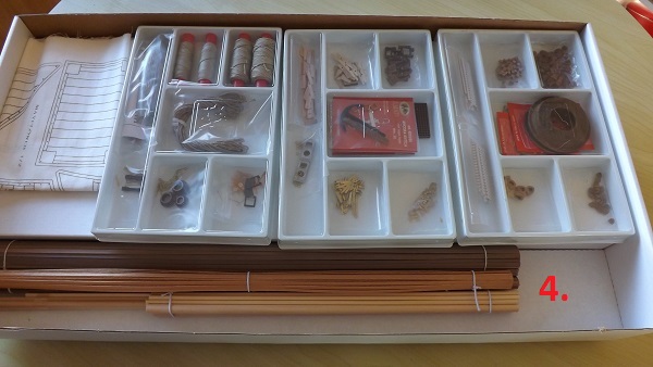

What can be said about this kit is the box design is very eye catching.
PICTURES 3 & 4

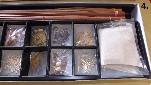

The box contents are quite sparse.
You get 3 pre-sorted trays containing various fixtures and fittings. Some of the parts such as the anchors and chain pumps are from the standard Amati accessories range and as such are packed in the little card headed bags.

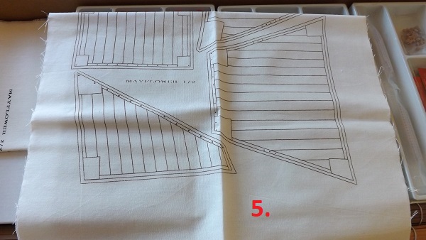

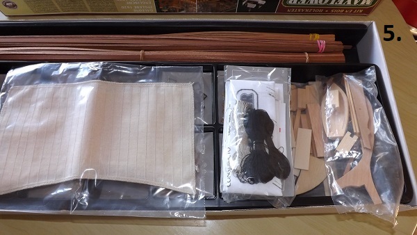

PICTURE 5
With this kit the sails have to be made by the builder and are supplied on 2 sheets of pre-printed sail material.

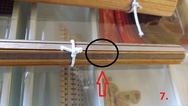

Another slight niggle (and not unique to this manufacturer is the use of “gooey” sticky tape to hold the timber lengths together. Picture 7 shows what this can do to timber in terms of staining it and that marking is not always easy to remove. It can also affect the wood if you are staining the part.
I tend to remove tape on kits I have and use elasticated thread to keep the wood sections together.
In the past I have seen Amati use the same elasticated thread or a piece of paper wrapped around the timber lengths and then taped (thereby keeping the glue off the wood.

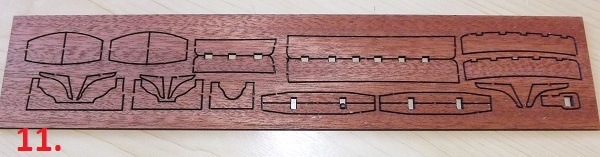

PICTURES 8 through 11

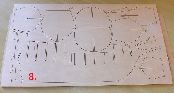

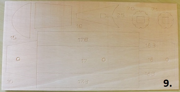

In this kit we get 4 panels of laser cut parts. All very neatly done.
The 2 build stand pieces shown in Picture 9 are “Interesting” because they have no dowel rod to hold the 2 parts together in traditional stand fashion.

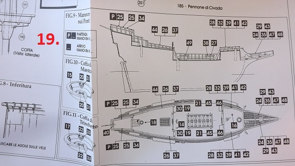

The assemble instructions in this kit consist of some text (pic 12) as well as a black and white drawn picture guide. Any text in the picture guide is in Italian and most of it centres on paint colours so fairly easy to translate via Google for instance.

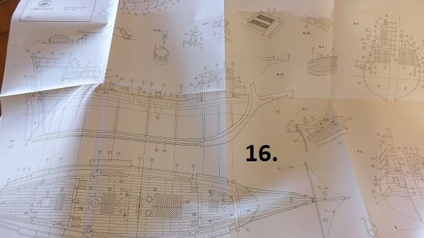

PICTURES 15 through 20

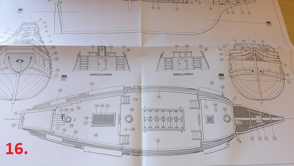

The build is further supported by 2 sets of fully size plans. Again, all text on these is in Italian.
The plan sets are available to purchase on their own should you have a desire to scratch build and as such over half of one of the plans is taken up with full size kit part outlines.

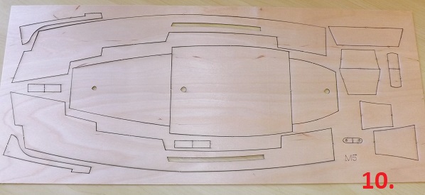

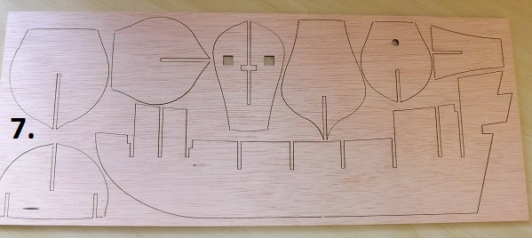

Underneath the parts tray we find the laser cut parts.
In this kit we also receive a display stand that when varnished should look very nice.

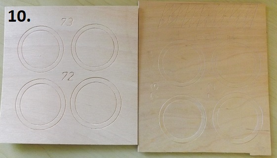

In pic 10 there is that duplication of old and new kit I referred to. Here we have 2 die cut (not laser cut in this case) sheets that make up the fighting tops (crows next). On one of the sheets we have small triangles that form part of the hull decoration.
On the second sheet this is missing.
Referring to the TWO instruction books included (again old and new kit) it seems in the newer version of the kit this hull detail is cut from a timber length.

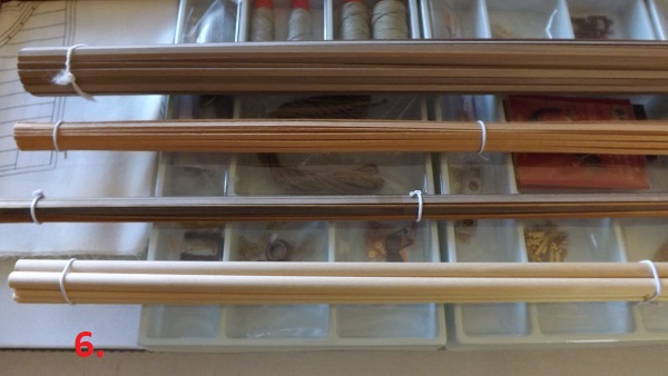

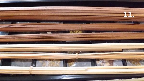

If there is one thing that stands out in this kit it’s the amount of timber.
I did check the instructions to see if I might have additional timber from a second kit but what I have is exactly the amount detailed in the instructions.
What is nice is that the instructions detail each wood piece by size as well as name.
The main wood used for the hull planking is referred to as “Bokapi” not a timber name I am familiar with and not one that seems to readily available should you require additional pieces.
The hull planking is also a thick 2mm timber to work with and having examined the wood its not in the slightest bit flexible so my plan is to replace the timbers in this kit.

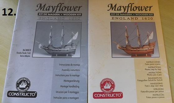

PICTURES 12, 13 & 14

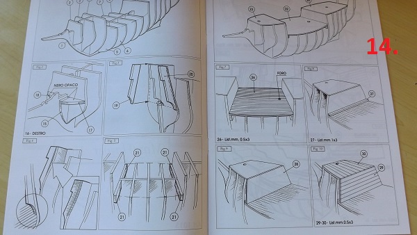

IN this kit we receive a colour picture guide as well as a text-based set of instructions (brief at a page and a half long) and a full breakdown of all of the parts being used.
I do like the layout of these Constructo instructions with each numbered part in the instructions showing you if that part is in one of the bagged parts, if it’s a standard timber length or if it’s a piece that needs to be cut from one of the supplied timbers.

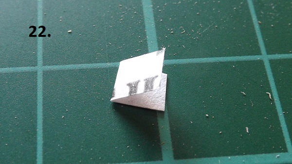

This small slip of paper is included in the kit stating that after customer feedback Constructo have included a further pack of 0.5mm timer to act as a second planking layer. However, that layer is not factored into the build instructions and being a single colour, you are advised to plan carefully if you decide to use this part.

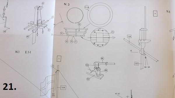

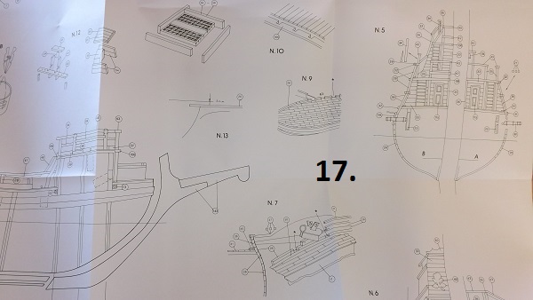

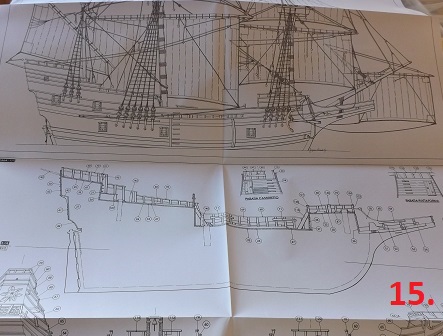

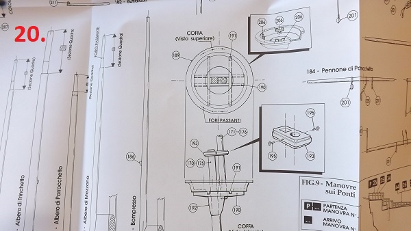

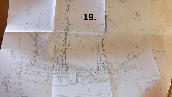

PICTURES 16 through 21

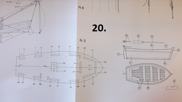

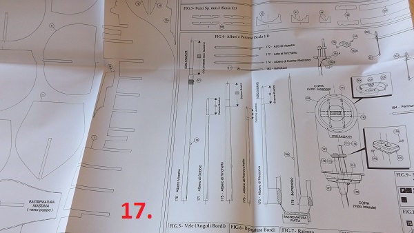

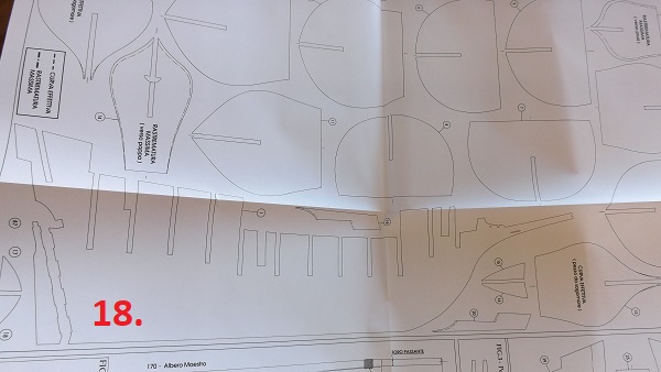

2 full size plan sheets are included with this kit (in my case duplicated with the same plans from an earlier version of the kit but exactly the same in what they show).
Everything looks easy enough to follow and there is no text to speak of on these plans that would need translation as there is with the Amati kit.

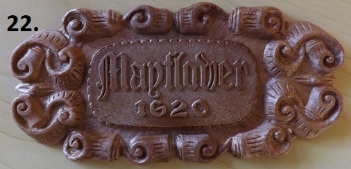

PICTURES 22 & 23
Couple of extras I have picked up. One being a very nice name plate that can be painted up.

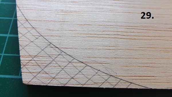

PICTURES 24, 25 & 26

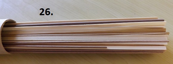

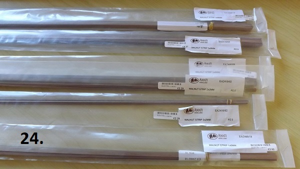

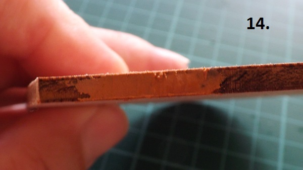

I mentioned earlier that the kit supplied timber I am not overly happy with as it looks like it could be difficult to work with. Cornwall Model Boats do have a section for Bokapi but much of that is out of stock.
So, on that basis I am going to change the timber used on my build to bring it more in line with the timber supplied in the Amati kit.

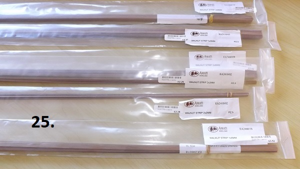

I plan to use Lime as the first planking layer as this is nice and flexible and something, I am more familiar with. This will be topped off as a second planking layer using walnut.
Again, much of the timber I wanted I have struggled to get. A good part of what I did order came from Cornwall Model boats (always good on prices but more importantly very very good on their postage charges for timber lengths.
The bagged Amati lengths I had to source from another online supplier.
Not sure how much raw timber Artesania Latina supplied when they were in business but my assumption is the limited timber presently available may be down to this company folding last year.
So, there we have it. This Constructo kit will be the one I use to build my version of the Mayflower.

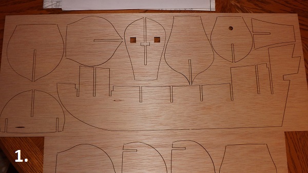

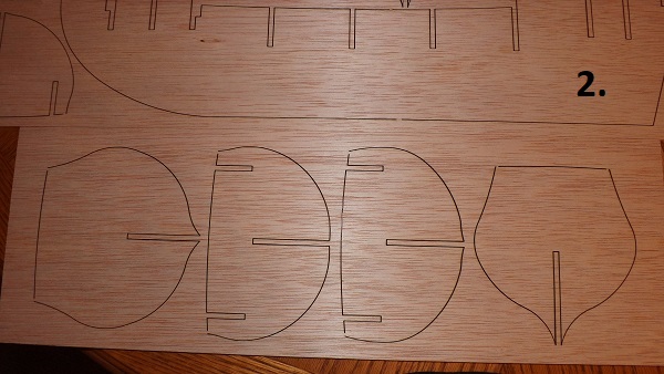

We start with the 2 laser cut sheets from the kit that hold the keel and bulkhead parts.
Quite pleased to find that even being an “old” second hand kit these sheets are nice and flat with no bowing that you sometimes find when kits have been stored (and not always in ideal conditions) for any length of time.

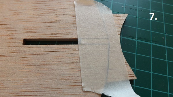

PICTURE 3

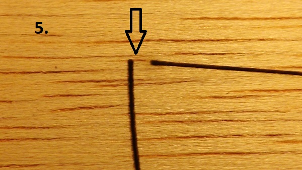

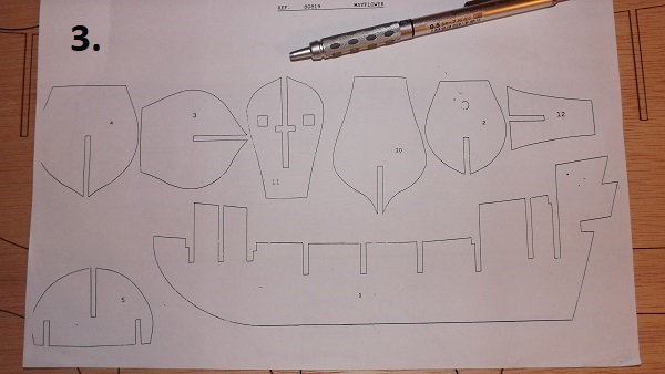

Its really important to ensure we place all of the bulk heads into the correct slots on the keel.
You may find in some kits the wood pieces are already numbered but, in this kit, we get a “Cut Sheet” that mirrors the wood sheet.
Its just a case of matching printed page to the wood sheet and transferring the piece numbers across.

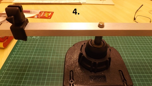

PICTURE 4
We need to mount the keel into some sort of jig during the early stages of the build to ensure everything stays nice and straight.
In this instance I am going to use the pictured keel jig from Amati.

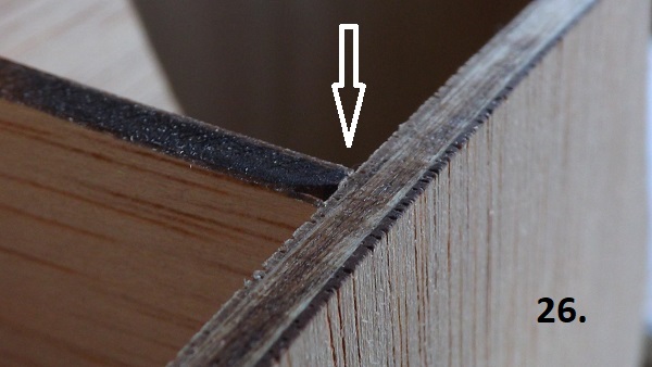

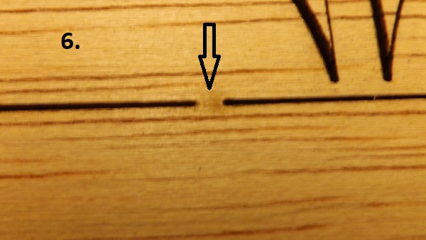

The parts are laser cut with smallish tabs left that need to be cut through in order to remove each section from the frame.
PICTURE 7
Once the pieces are removed you just need to carefully sand down and imperfections that might be left.

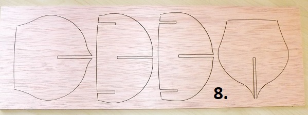

PICTURES 8 & 9

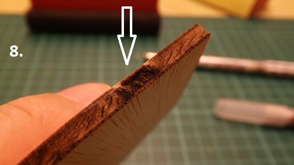

The parts we are working with are ply and there are a number of areas that will need some additional work as the inner wood is not of a very good quality and there are a number of areas (pic 8) that will need filling before we start planking this one.
So that some of these areas are not overlooked at a later stage I have marked them up as can be seen in Pic 9.

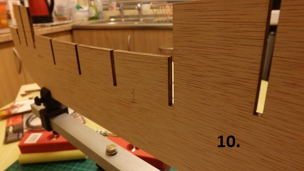

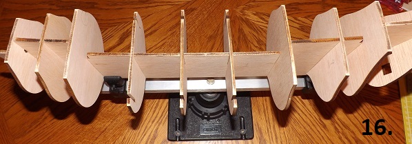

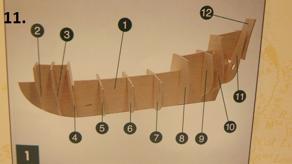

So, with the keel in its jig we now use the picture from the build guide to place each of the bulk head pieces into their correct locations. At this stage nothing is being glued in place.

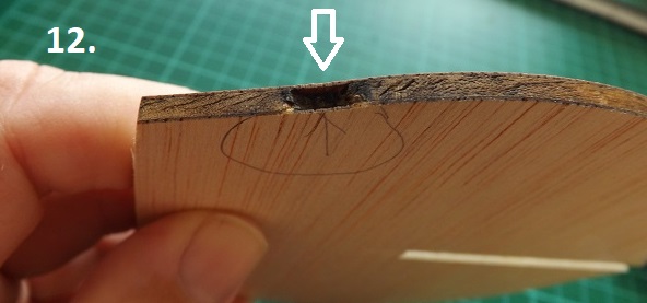

PICTURE 12

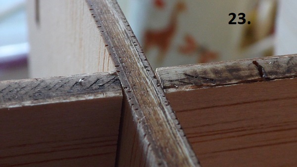

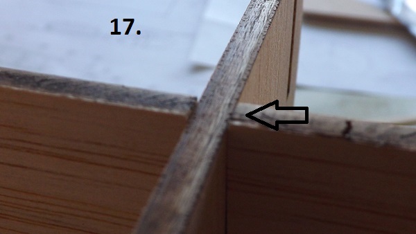

What I did find is that none of the slots in either the keel or the bulkheads were wide enough to fit together.
To resolve this, I used the flat file from a set of “Fine” Permagrit files I have.
This really is a brilliant file and its shape and size is just about perfect for opening up slots such as this.
After some careful filing (we do not want to remove too much wood and cause more issues for ourselves) we can finally slot the bulkhead pieces into the keel.

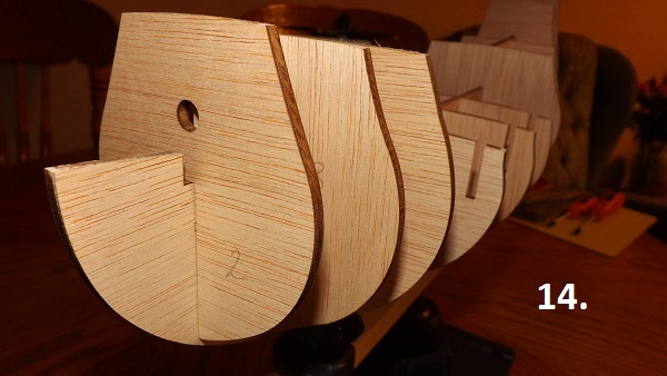

PICTURES 13 Through 16
And that is the stage I left this at 3am this morning having sat through “Storm Dennis” as trying to get any sleep was just about impossible.
Next stages will be to mark out and shape the keel and then start gluing the bulkheads permanently in the keel.

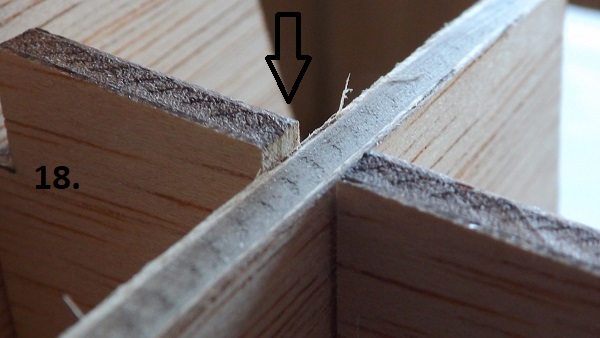

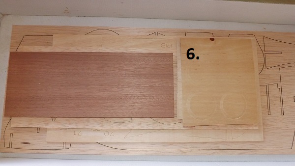

#17 Posted : 26 February 2020 19:54:12
THE MAYFLOWER – 26th February 2020
Not a lot of progress in terms of how the kit looks so far.

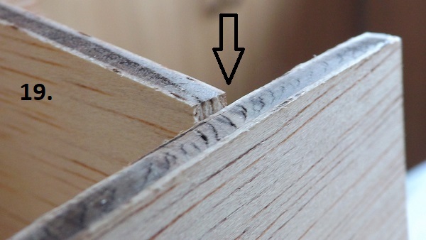

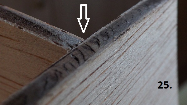

That is mainly down to the fact there are quite a number of issues that needed to be corrected.
Leaving the following “errors” in place will come back to haunt the modeller at a later stage of the build so time spent now should, in theory, pay dividends later.
I will try and break this down into the various correction stages I have had to sort.

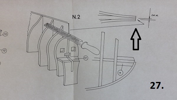

FRAME SHAPE CORRECTION

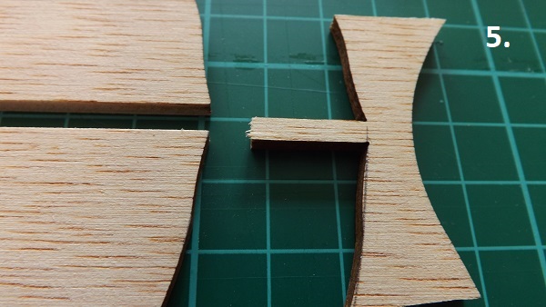

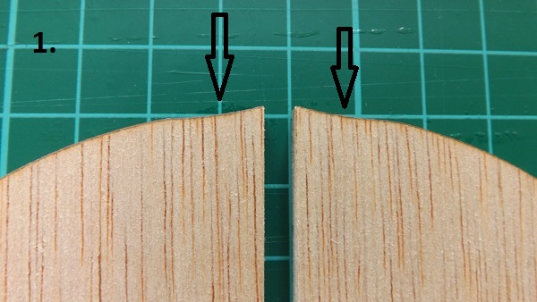

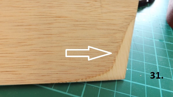

PICTURES 1 & 2

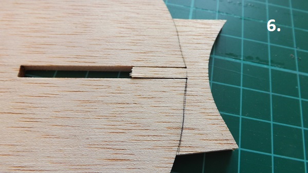

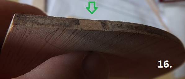

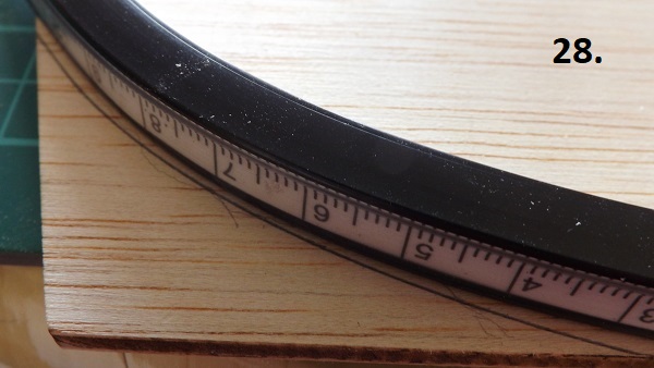

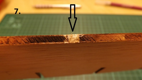

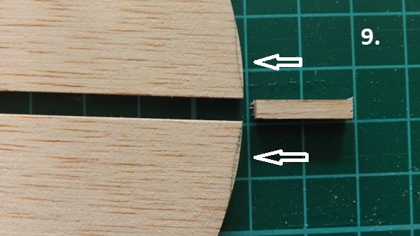

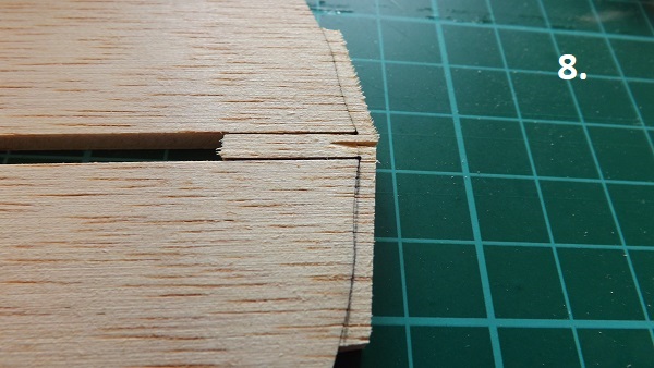

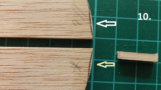

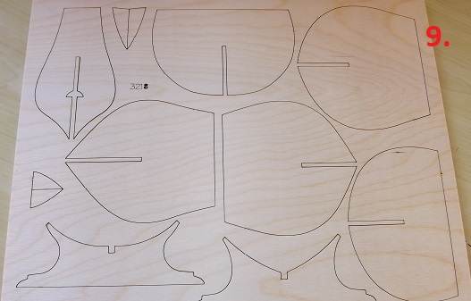

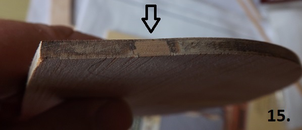

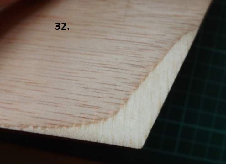

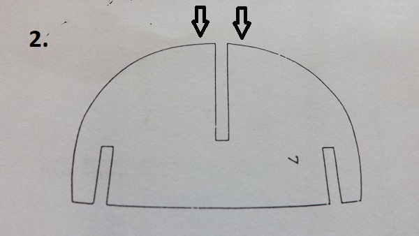

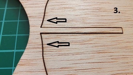

Frame 7 is one of the mid-section frames and as such should mirror closely the frames either side of it.
With frame 7 however there are 2 distinct dips that you can see arrowed in Pic 1.
If you refer to the Cut sheet (Pic 2) we can see the frame should have a nice some curve with NO indents.

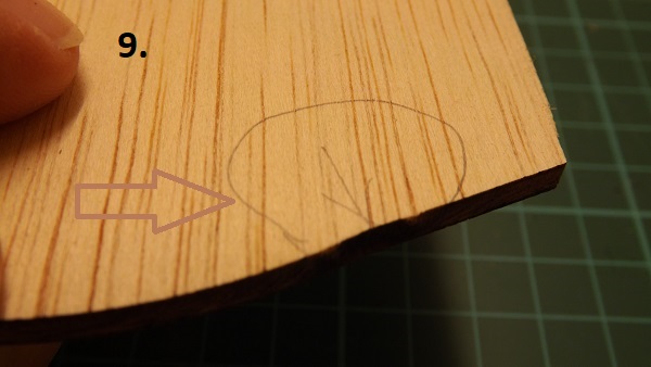

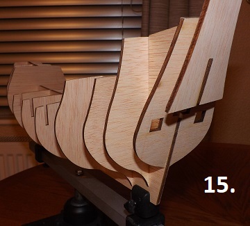

PICTURES 3 & 4

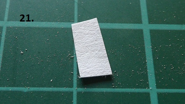

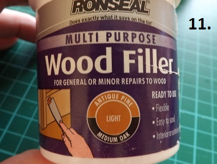

There may be several methods builders might use to repair this defect but for me using filler is a No No as that tends to be a poor solution with the potential the filler will flake away.
The easiest method I have found is to put the frame back into the fret it arrived on (pic 3) and to remove a section of the fret that can then be glued to the frame (pic 4).

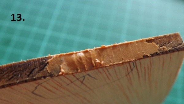

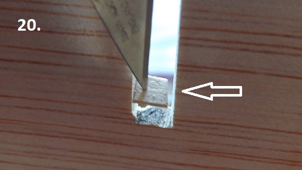

PICTURES 5, 6 & 7
Once the section of fret is removed (pic 5) we can glue this to the frame (pic 6) and to ensure this dries without movement its held in place with a piece of tape until dry (pic 7)
PICTURES 8, 9 & 10
When the part is properly glued in place, we can use a file or a sanding block and CAREFULLY start to reduce the section of wood we have added (pic 8)
We keep going, very carefully until we reach the point that “plug” running into the frame slot simple falls away (pic 9)
Looking at Pic 10 we can see that the frame has now taken on the correct curve and can also see just how small the repair is (arrowed).

HOLES IN THE FRAME SIDES
PICTURE 11
I mentioned in my last update that a number of holes have been found in the frame sides.
Having spent some proper time looking at all of the frames in details I found around 7 areas that require filling.
Various fillers would be ideal but as I had this Ronseal product available that is what I have used.
Here we can see one of the imperfections.
Fairly straightforward to resolve with the wood filler.
Just fill slightly proud to allow any minor shrink back as the filler dries (I did notice that with this particular filler is does not shrink as some other brands do.
PICTURES 15 & 16
Once the filler is dry its just a case of carefully sanding back to neaten up the repair.

FRAME SEATING
PICTURES 17, 18 & 19
Another issue I encountered was a number of the frames sat far too low in their slots.
This can be quite common issue with these type kits and its worth spending time to correct this.
In these pictures you can see how the frame tops sit lower than the top of the false keel.
PICTURES 19A, 20, 21 & 22
Again, individual modellers will have their own preferred methods to resolve this but for me I just build up the slot in the false keel until the frame top sits flush with the false keel top.
I start of with slivers of 0.5mm plank offcuts and the addition of 1 or 2 of these resolves most issues.
Were 0.5mm is still too large I will resort to pieces of paper as we can see in Pics 21 and 22.
PICTURES 23, 25 & 26
Once the various shims are in place, we can see the tops of the frames are nicely back in level with the top of the false keel.

BEARDING LINE
PICTURE 27
One of the things we need to consider is the so-called Bearding Line.
Basically, we need to ensure that when the planking is completed its blends in with the width of the stern post.
The keel has a thickness of 4mm and we will be applying 4mm thickness of planking (2mm port and 2mm starboard) so will end up at the stern with a thickness of 8mm.
The stern post is 5mm thick so what would happen, unless we correct now, the stern planking will sit proud of the stern post.
We need to reduce the thickness of the stern end of the false keel to cater for this.
The kit is sadly lacking in any detailed build instructions and it’s a case of having to refer to the 2 sheet plans, the pictorial guide and the page and half of written instructions and having scanned all of that the only reference to any sort of Bearding Line is this arrowed diagram in Pic 27.
It appears to indicate we need to reduce the keel at the stern to a thickness of 1mm.
PICTURES 28 & 29
As mentioned, there is NOTHING in the instructions to mark out this area so the best way, I have found of doing this is to fit all of the frames in place.
As we get to the stern area there will be a space between the rear frames and the base of the keel and it’s from this point, we need to make the Bearding Line.
I have marked out the shape using a flexible curve and using this curve it allowed me to transfer the exact same shape to the opposite side of the keel.

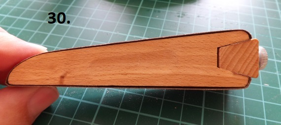

PICTURES 30, 31 & 32
Now there are many methods we could use to reduce this section down. But as we need to do this slowly and precisely (or as precisely as skills allow) I would personally not use a power tool (i.e. Dremel or the like) to achieve this.
For me one of the best little tools I picked up was this little angled sanding block. Being wedge shaped it allows you to create a similar wedge on the keel as you carefully reduce the size of this area.
Pics 31 and 32 is were I have left this. The rear of the stern is now down to 1mm in section but once I start looking at the planking and how it sits, I may need to big this sanding task more inboard of where I stopped.
