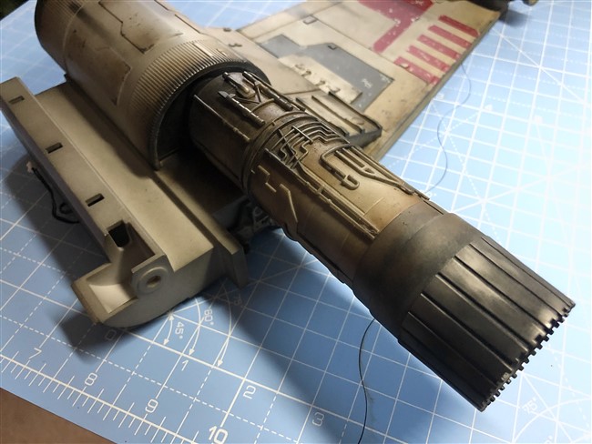

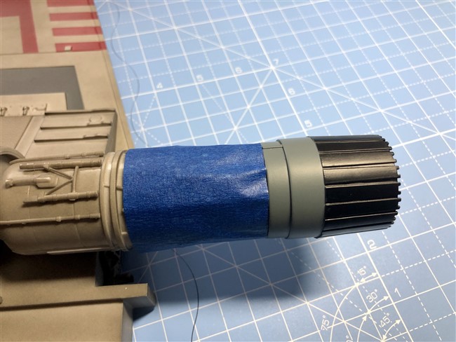

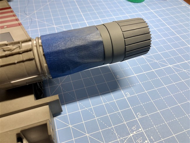

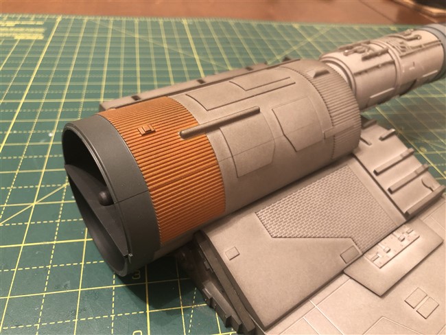

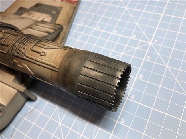

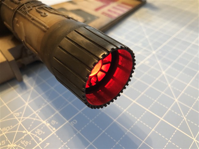

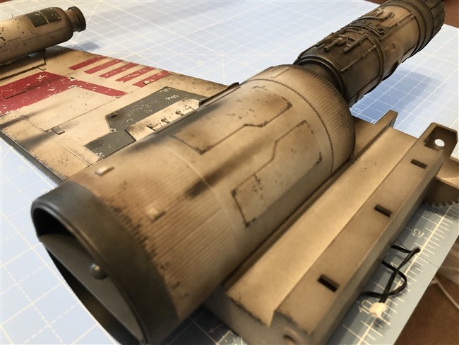

First, was to tone down the exhaust ends. I masked off the area I wanted to paint and then sprayed a very light coat of sea grey, just enough so the black was still showing through slightly.

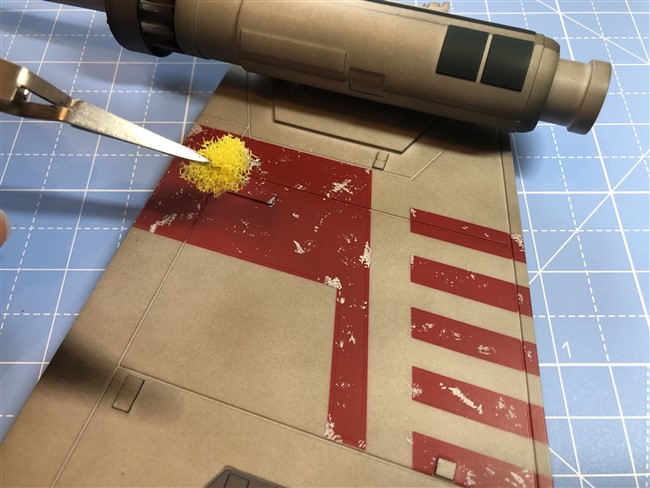

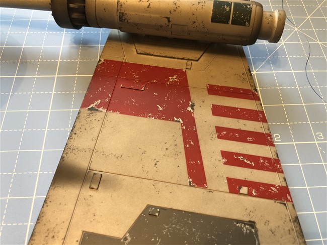

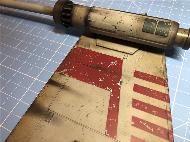

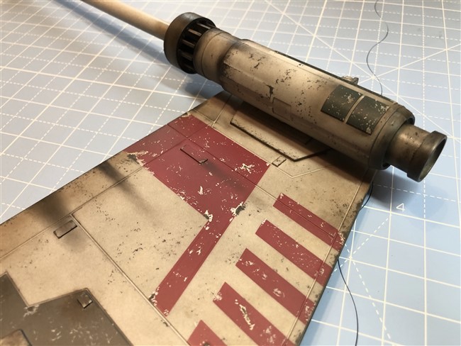

Secondly, I wanted some chipping effects on the wings. This was achieved by using Vallejo paints. This is very quick drying, so take care.

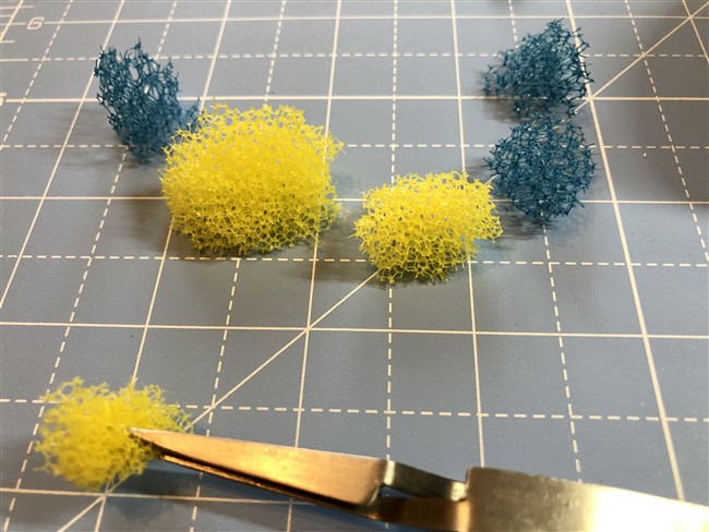

I used some small pieces of sponge to create the chipping effect. These were dipped into the paint, dabbing off any excess on a paper towel and then carefully applied over the areas I wanted chipping. The first colour was a light grey, similar to the main colour of the model. This will go over the red painted areas.
I mixed a combination of light grey, white and aged white to achieve this. Some of the larger chips were made with a small brush. Just take your time when placing the paint, less is more, so they say.
Once this was done, I then used a German grey for the main hull areas as well as dabbing some of this colour on the larger light grey chipped areas I did on the red paint.
Next, was to add some darker weathering to the hull, particularly around the engine areas. This was achieved by using Abteilung oils, Starship Filth, Dark Rust and German Ochre.
For the main wing areas, I used the German Ocher, applying it to the brush straight as it come out of the tube. Dab the excess off and blend in with a dry soft brush. A little Starship filth was also applied in areas. The engine part was painted with dark rust and softened with a dry brush and a good amount of Starship filth was blended in for the dark areas. After this was done, I used some Mig rocket dust pigment on the Starship oils and the ends of the engine exhausts.
Finally, some gun metal pigment was used to give a metallic feel to some parts.
I will allow this to dry for a good week or so before sealing it with a matt varnish to which I will then paint the underside.

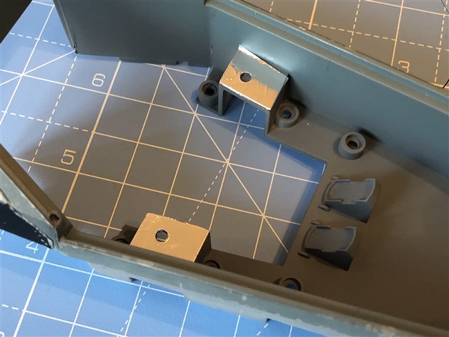

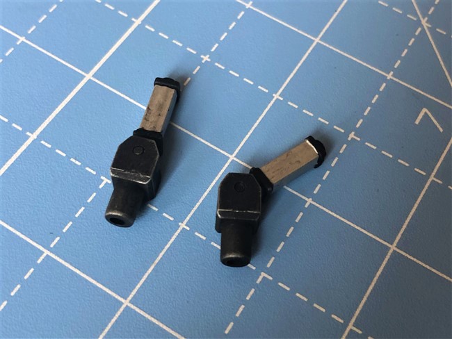

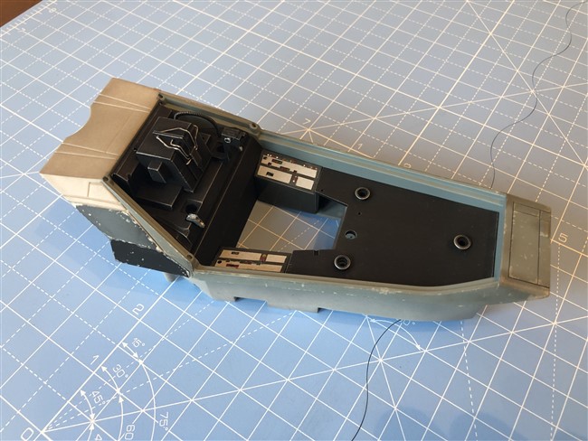

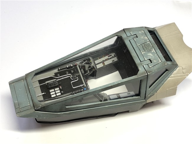

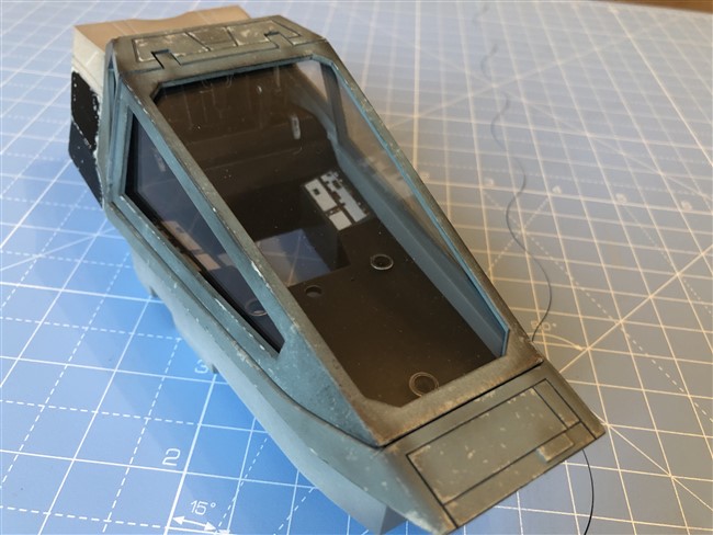

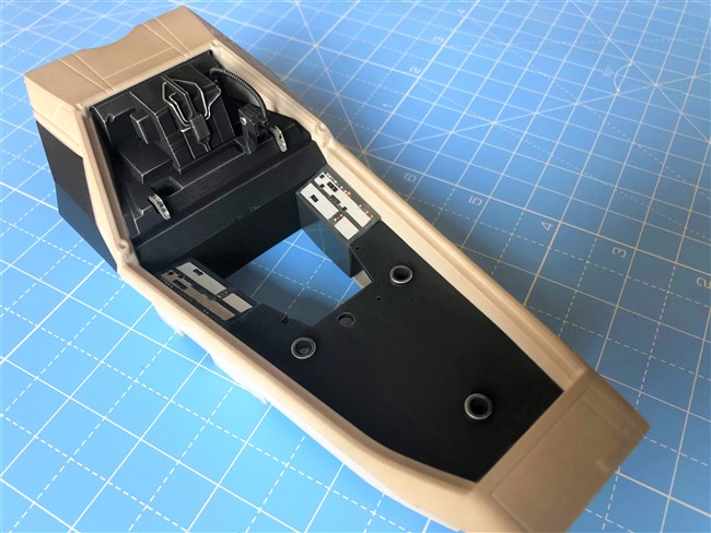

Pack nine saw some inner cockpit parts, mainly the life support system. We also got the hydraulic pistons for the cockpit canopy.

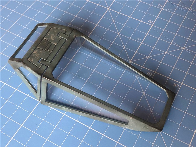

The first part I painted was the canopy. I took the glass out the frame and sprayed with primer. Once dry, I then painted the canopy with a mixture of pale blue and light grey about 50/50. Then I applied some chipping effects before finishing it off with some Starship filth to add some grime. I finally gave it a coat of matt varnish to seal it, once I allowed it to dry for a couple of days.
The hydraulic pistons were given a coat of matt black and then painted the bottom silver.

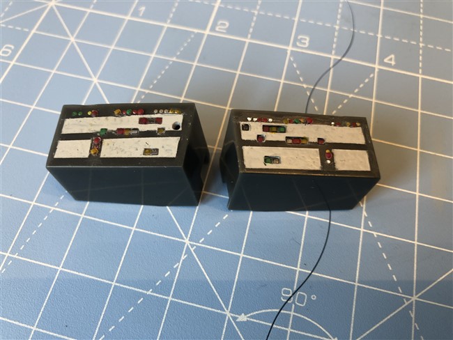

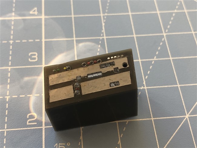

Next, was the life support box. This was again painted with a matt black, dry brushed with silver to highlight and then painted the pipework silver. Obviously, there will be more parts to be attached to this, but these will be painted as and when the issues instruct me to.

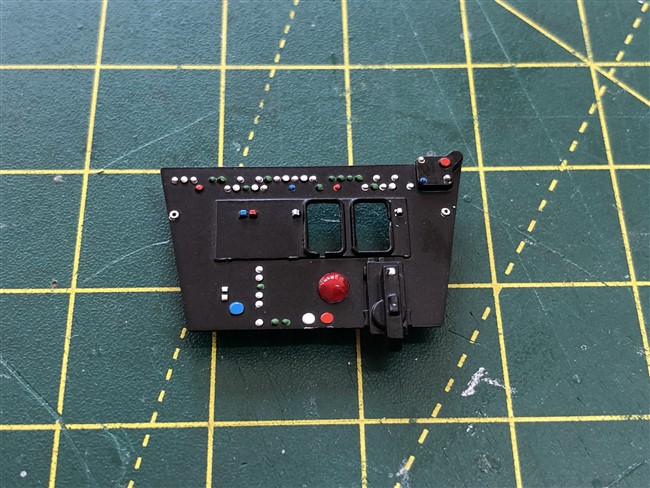

Finally, the side seat consoles were a little bland. I looked at reference pictures of the full-scale filming model that was used and noticed that they had lighter inner white/grey panels. Using some masking tape, I taped off the areas and painted it white with a touch of grey, so they didn’t look too stark.

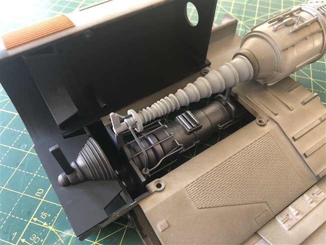

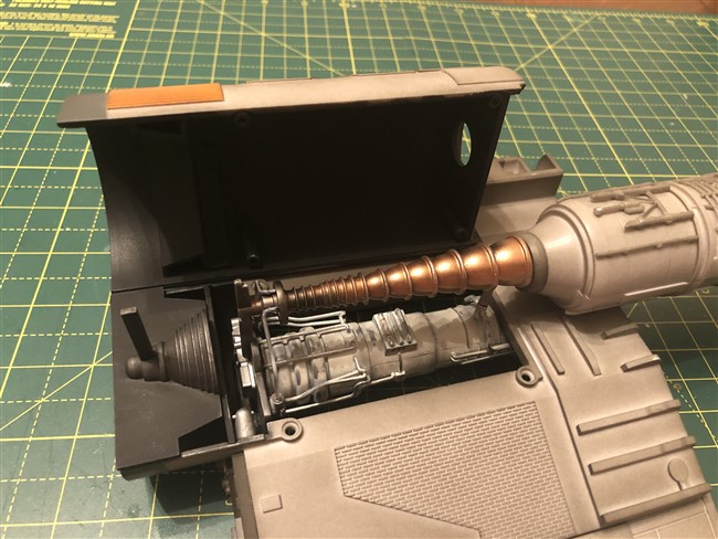

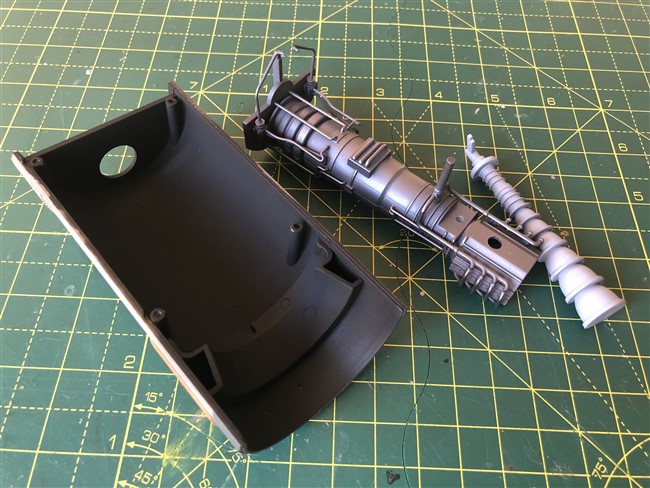

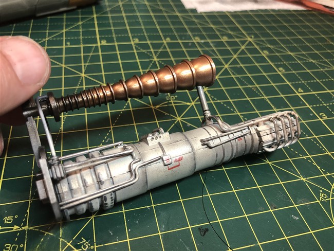

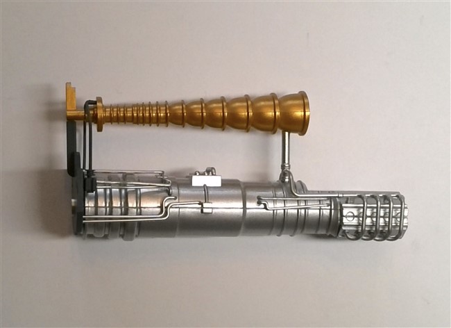

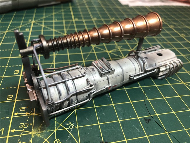

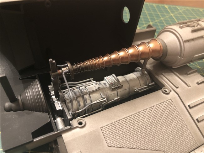

After almost completing the final wing, I decided to have the top wing engine canopy to open. I took off the four screws that holds this in place and will replace the screws with some circular magnets at a later stage before the wing gets attached to the main body. I then sprayed the inner part of the canopy with matt black. With this open, it will allow the engine to be displayed.
I also took out the screw and disconnected the engine, as I wanted to repaint it and add some detail to this part. I then primed the parts and once dry, spayed the engine with metalcote paint and allowed it to dry.
The main engine was lightly airbrushed with an off white/grey colour. When this was almost dry, I used a cotton bud and rubbed some of the paint off exposing the metalcoat paint underneath. Some black was also sprayed to darken some areas before a light coat of silver dry brushing was applied. The Power convertor was airbrushed with a combination of copper and brass, then darkened with black.
I have also added some greebies to the front engine that goes in the small gap at the front. The engine has been temporarily placed back into the wing to give an idea of how it will look, however some more detailing will be done when the wing undergoes its weathering at a later stage.
Next time I will be showing some extra lighting using fibre optic cables in the side consoles. This will not require additional LED’s to be used.

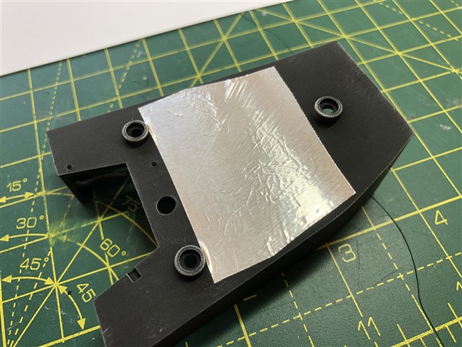

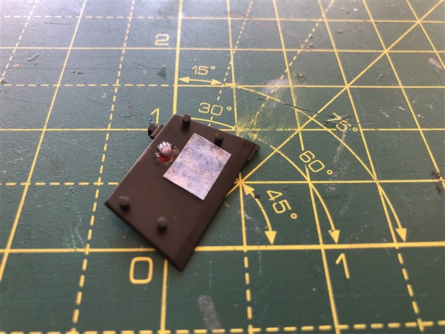

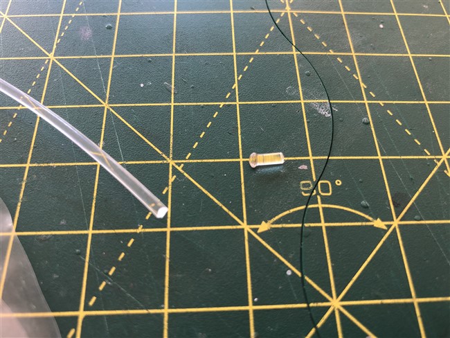

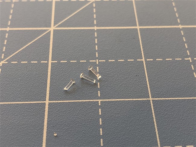

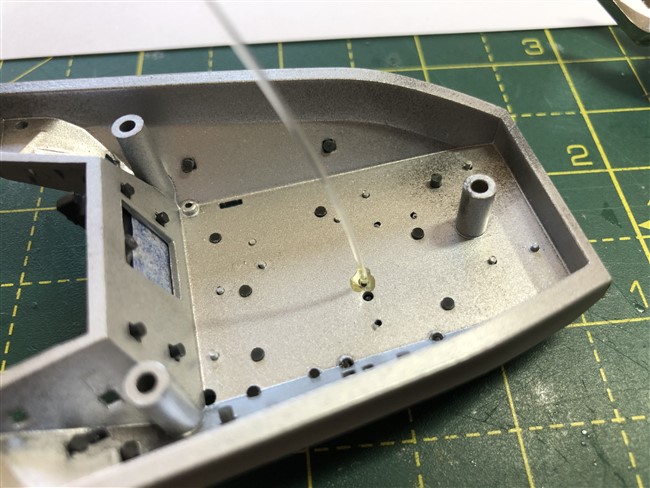

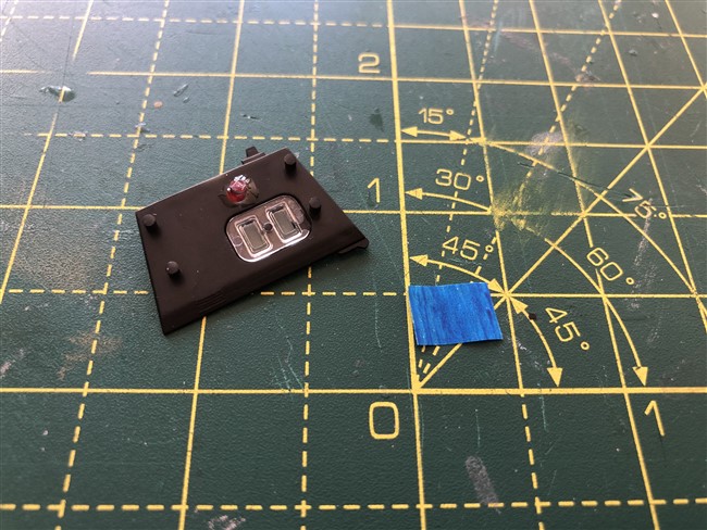

I have now added some fibre optic cables into the side consoles in the cockpit. Because of the limited space there is under the console where the LED bulb will be attached, I have cut the optic cables very small. I used 0.75 fibre optics and mushroomed the ends to give a smoother finish. Once these had been inserted, I glued the inside to hold them in place with some PVA glue. I have also added some aluminium foil to the inside as shown, this will make it a little more reflective when the lighting is attached at a later stage.
The lower part of the cockpit has been painted with a blue/grey to match the canopy. On looking at reference pictures, the studio model shows this to be the same colour as the canopy.

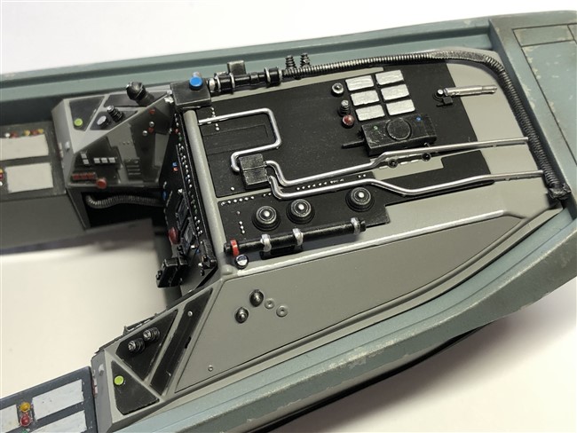

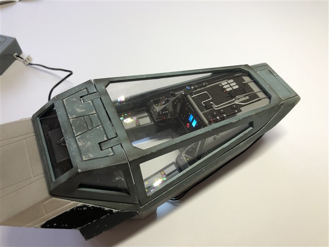

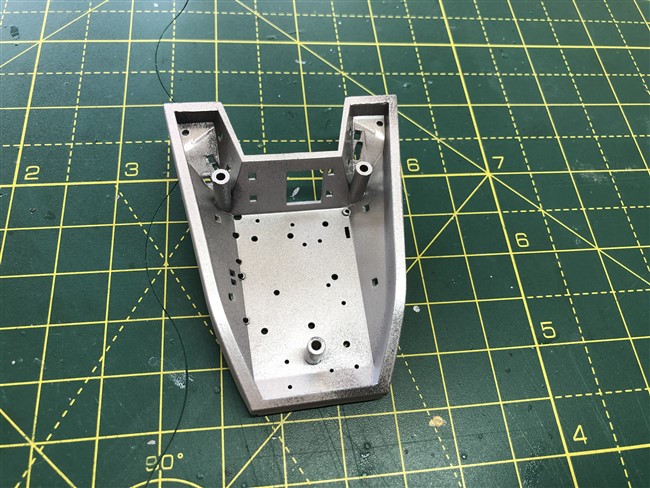

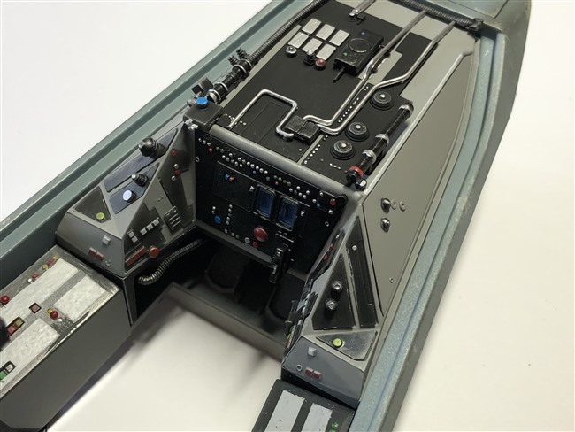

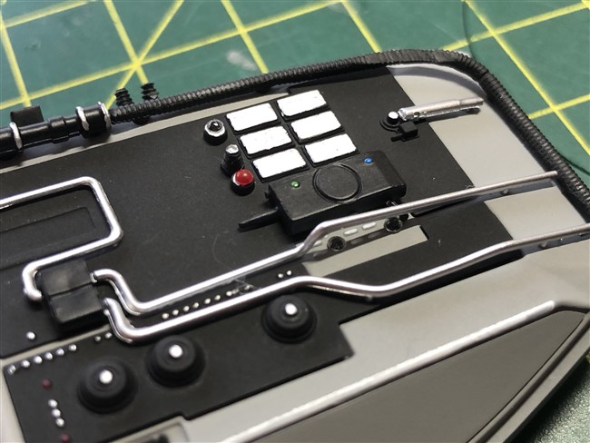

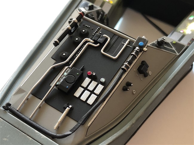

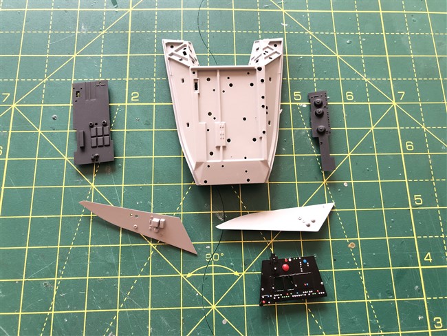

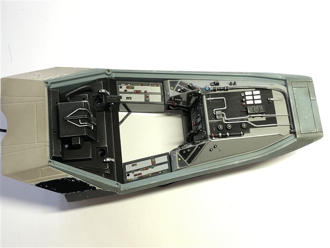

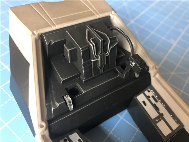

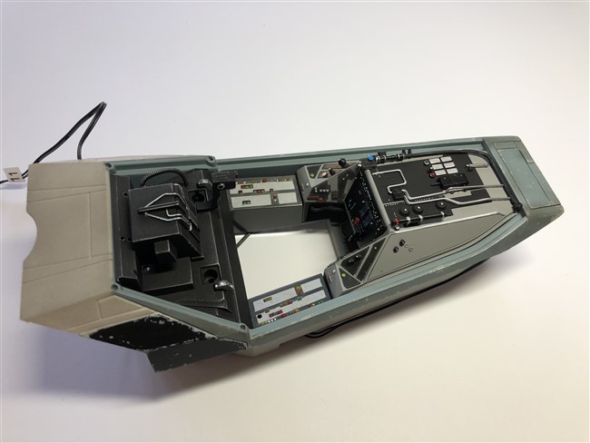

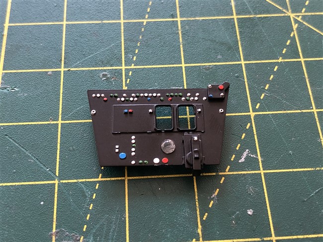

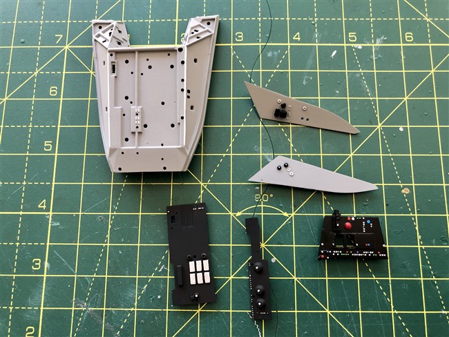

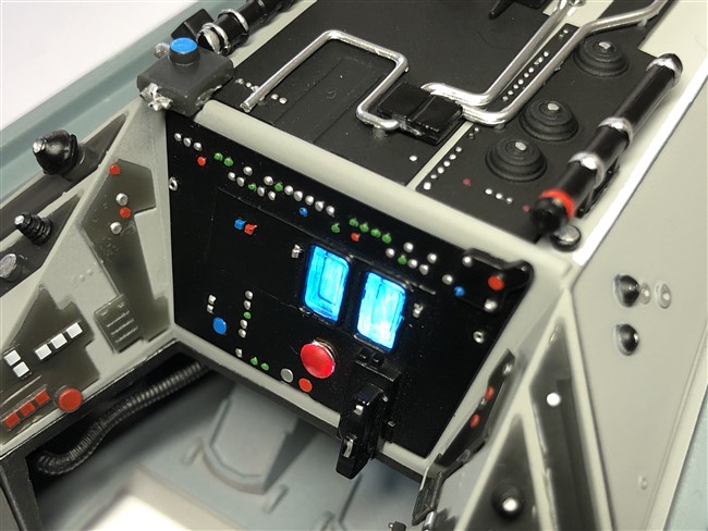

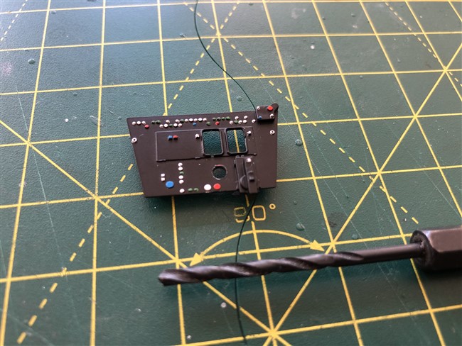

Pack 16 brings the cockpit parts. As I have done before, I have added extra lighting and did some repainting giving it more detail. All the extra lighting will utilise the existing LED lights that come with the kit. I started with the front panel drilling out and adding some fibre optic cables.
I then repainted parts as shown and added a little more detailed paint to the parts. The front cockpit screen was inserted, and some tracing paper painted blue was then placed on the underside. This will give a blue look to the screen as well as defusing the lighting. More fibre optic cables were placed and painted with translucent paint.
The rest of the pictures show some detailing added to the parts with paint before the lighting was attached and tested.
There will be some more detailing of my own, which will be added next time.
The official build diary will follow in the next few days.
