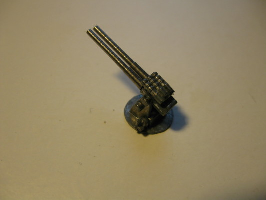

Stage 22 - Contains the starboard stern deck plate, planking and an anti-aircraft gun and platform.
This is a repeat of the stage 21 planking and stern port deck plate installation, therefore I am not going to repeat the process here.

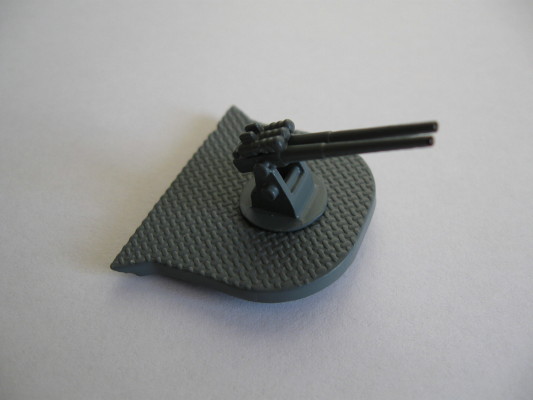

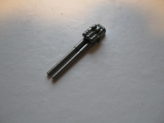

Assemble and paint the anti-aircraft gun as before and carefully store.

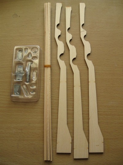

Stage 25 - Stern frames x3, planks and a Nakajima B5N aircraft kit.
Stage 26 - Stern frames, planks and decal sheet.

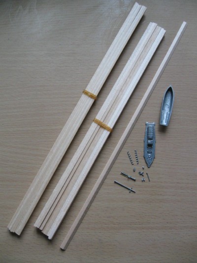

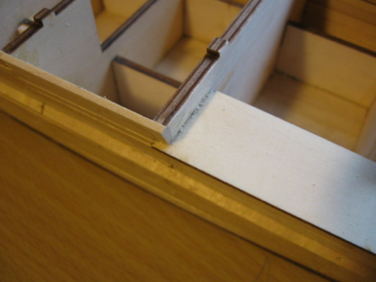

Stage 23 - Contains planks, chamfered moulding and boat parts.
Fit the chamfered moulding and planking as per steps 1 to 7
I chose to leave the fitting of the stern planking (steps 8 to 15) until the starboard hull planking has been completed in the next stage (24), where the entire lower stern can be planked in one go, and because the starboard stern planking is not yet started, there is risk of creating a hull twist.

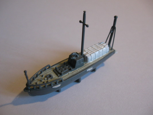

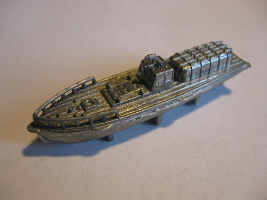

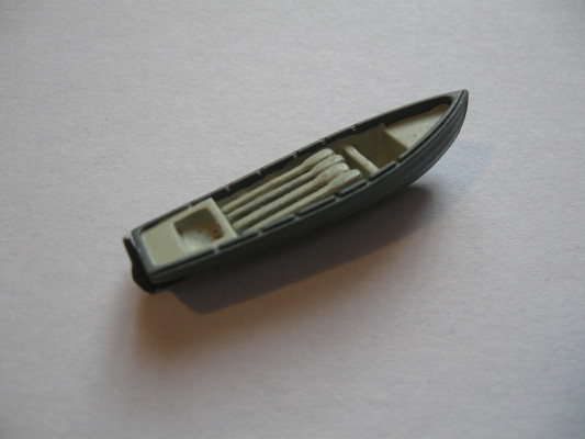

11m ships boat - Remove any burr's from the castings with a fine file, then start the assembly of the hull by adding the three castings.
I chose to glue deck to the hull and added the railings, which require a slight curve to follow the deck line. I then primed and painted the hull and added the masts.

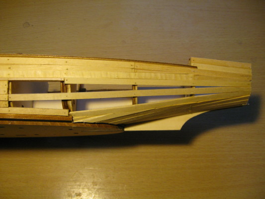

#4 Posted : 16 December 2011 10:15:09

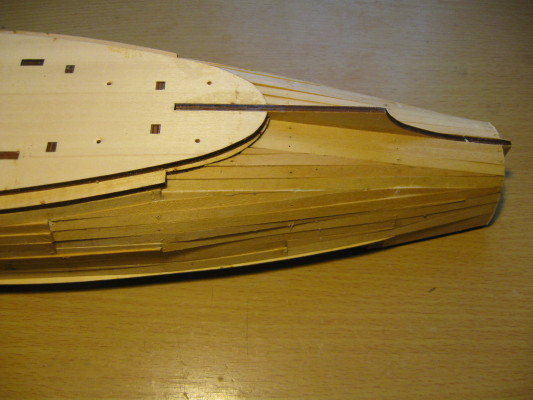

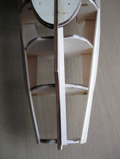

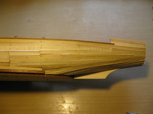

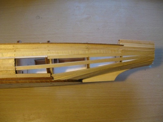

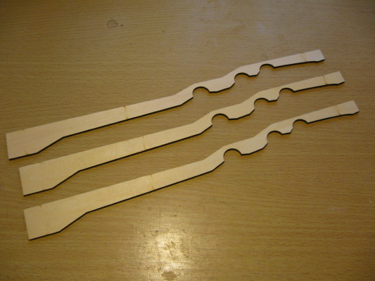

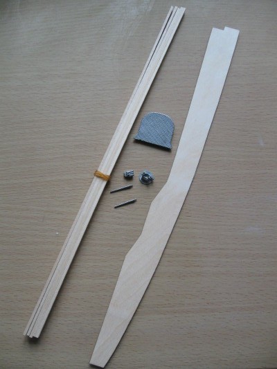

Stage 24 - Contains short & long planks, chamfered moulding, anti-aircraft gun parts and platform.

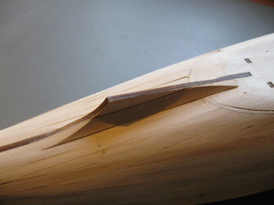

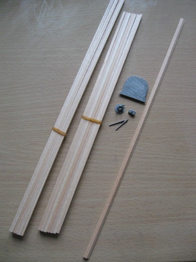

Ensure that you choose the right planks, the long planks are thinner than the shorter planks.

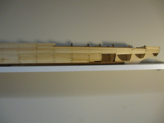

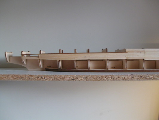

The hull planking in stage 24 is identical to stage 23, (though I left steps 8-15 of 24 - the stern underside planking to be completed at this stage after step 10 has been completed.
After planking the side of the hull, I removed the hull framework from the build board and turned it upside down, and then referred to steps 8 to 15 of stage 23 in conjunction with steps 11 to 19 of stage 24 which are a repeat.
Place a long plank along side the central keel plate, shape its end to match with the profile of the hull base plate, and then cut the plank to length so that it overhangs frame 26 by 1mm, glue the plank in place and then repeat the process with a further two planks, then repeat on the opposite side of the hull.
Test fit a long plank so that it runs from frame 23a so that it meets with the ed of the previous plank, then cut it to length so that it overhangs frame 26 by 1mm.The opposite end will need to be shaped as shown in the step inset diagram, so that its end sits under the corner of the base plate. Glue the plank in place and repeat on the opposite side of the hull.
You can now fill the remaining gap between the plank just laid and the previously laid planks, cut and shape the planks to fit and glue into place.

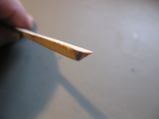

Shape a long plank to fit in the gap between the base of frames 21 to 23, you will need to chamfer the edge of the plank as shown in the inset step, glue it into place and repeat on the opposite side of the hull.
Finally shape a long plank to fit in the gap between the planks at the stern so that it runs from frame 22 to 1mm past the end of frame 26, you'll need to taper its end for it to fit, glue in place and repeat on the opposite side of the hull.
Assemble the anti-aircraft gun and platform, and paint as before.

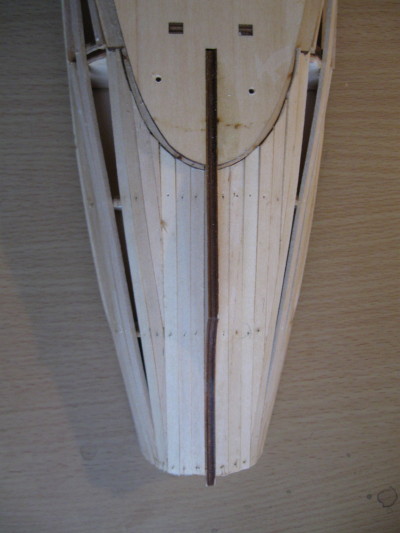

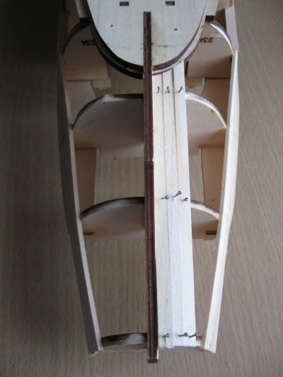

#5 Posted : 23 December 2011 13:38:28

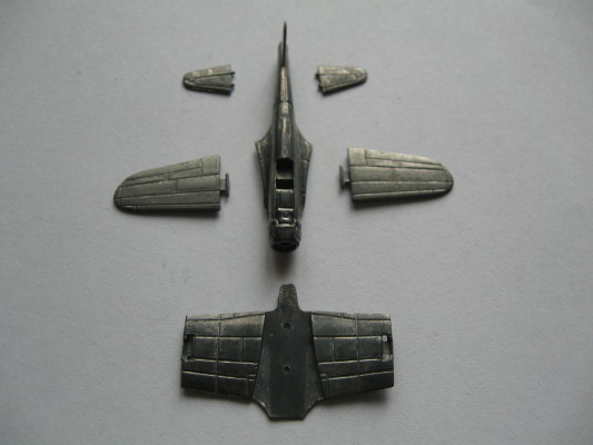

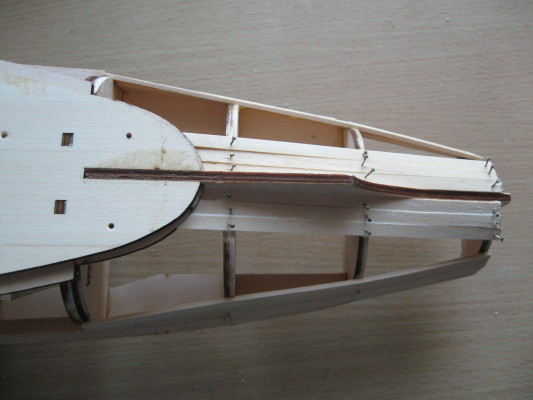

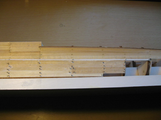

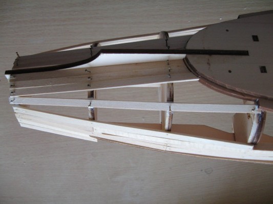

Fill the remaining stern planking gaps with planks cut to fit as per the steps.
Sand flush any overhanging planking at stern frame 26, and sand flush any over hang planking at frames 19 and 25.
Glue the deck frames together ensuring they are square, then sand the front edge so that all edges are flat and smooth.
Test fit frame onto the portside deck plate between frame 19 and 25, you may need to slightly sand equal amounts off each end to get a good fit, then glue the frame into place so that its front edge at either end is level with the hull planking.

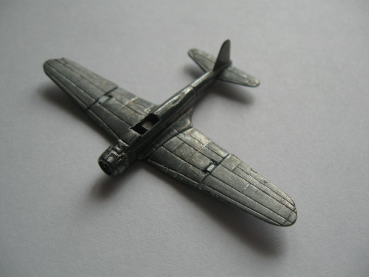

Assemble the B5N aircraf kit as before.

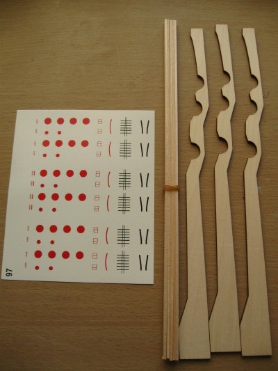

#6 Posted : 29 December 2011 12:08:13
Fill the starboard stern planking gaps and fit the stern frames as per the previous build sequence.
A decal set and steps are provided to finish three of the Nakajima B5N aircraft, though I will leave the finishing of the aircraft until all aircraft are to hand.

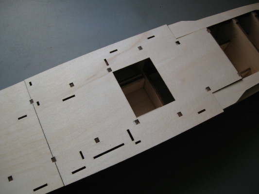

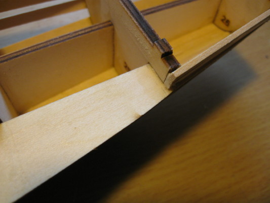

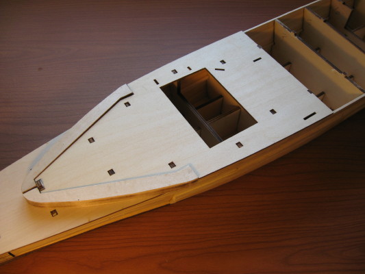

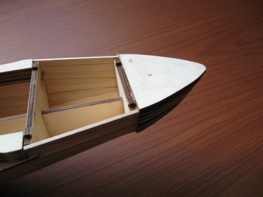

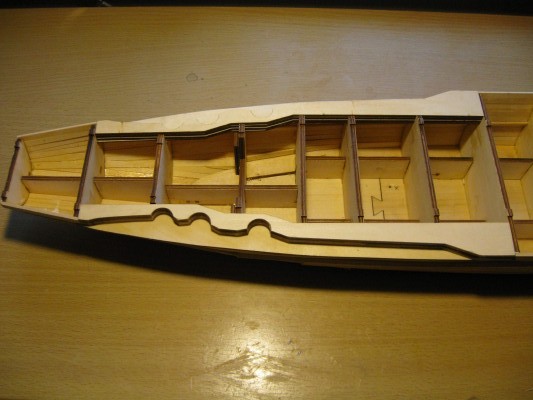

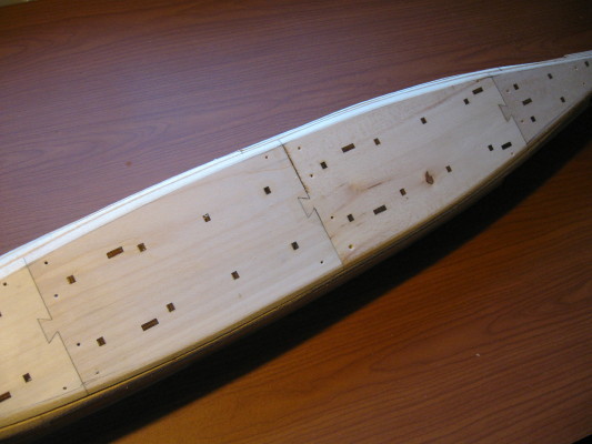

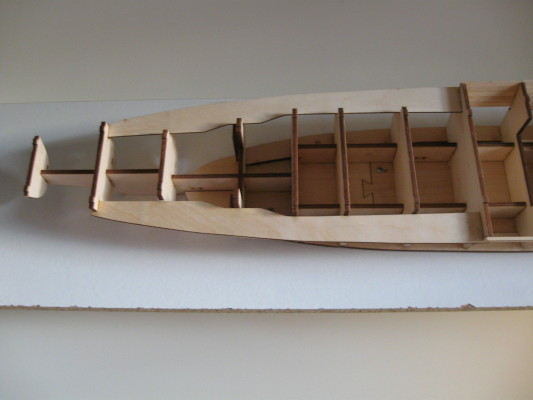

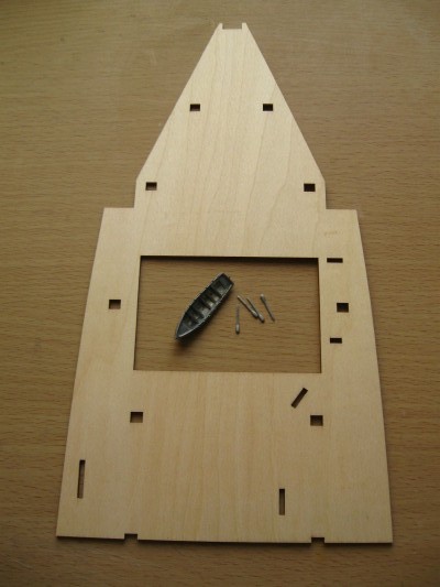

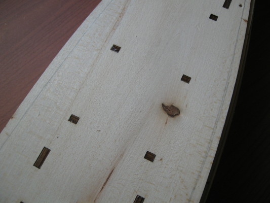

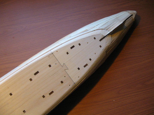

Stage 27 - Contains the bow hangar deck and a ships boat.

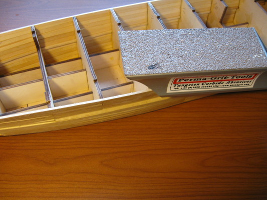

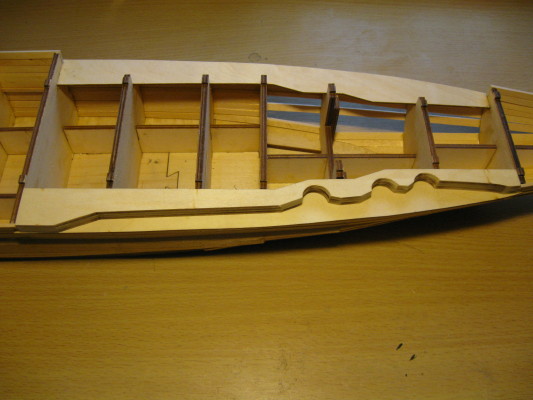

Start by making two notches into the top of frame 10, (2mm deep, 1mm wide)., this is to accommodate the forward end of the bow hanger deck at the correct level.
Use a sanding block to level and sand smooth the top of the hull planking sit it sits level with frames 12-19.
Fit the bow hangar deck onto the frame projections ensuring that the deck is the right way round as highlighted in the steps.
You will most likely need to make some adjustments to the frame projections to get the deck to seat properly, and you may want to wait until you have to hand the aft three deck sections so that all the hangar decks can be married together.
I found that the triangulated part of the forward hangar deck was slightly too wide, thus forcing the two former pieces (situated either side) slightly apart at the front, I'll leave this adjustment for now.
Do not glue any of the hangar decks in place just yet.
The steps say to increase the strength of the hull by applying an epoxy adhesive to the inside surface of the hull planking, and is best applied and left to fully cure before you start the shaping of the outer hull.

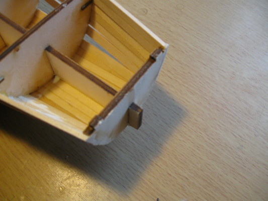

Fit the stern block and if necessary sand the mating side to obtain a snug fit, then glue it in place.
The corners of the bottom of the hull need to be sanded to a curve., draw a smooth curved line around the base of the hull at the edge distances shown in the steps/diagram, and then shape accordingly., the profiling and sanding of the hull sides will be done later on.

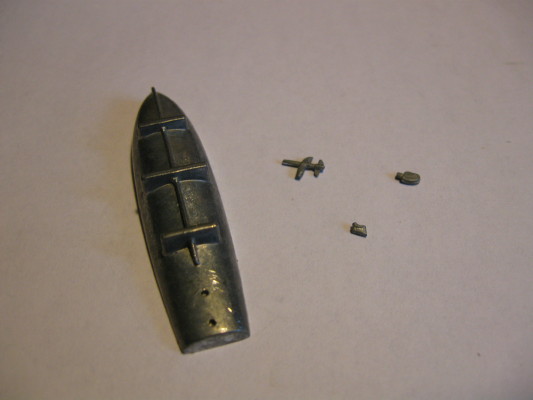

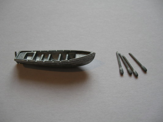

Ships boat - Remove any burrs from the boat and oars, then prime and paint as before.

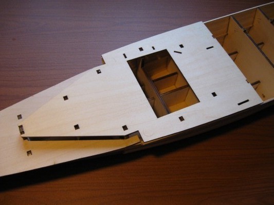

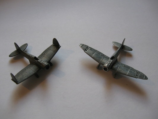

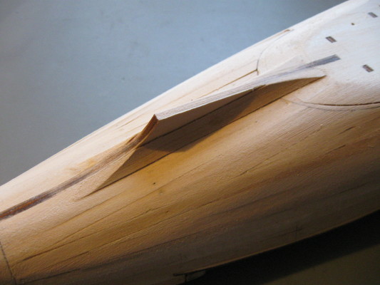

#9 Posted : 19 January 2012 16:58:25
Stage 28 - Central hangar flooring and two Aichi D3A aircraft kits.

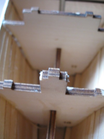

Temporarily fit the central hanger deck (ensuring it is fitted the right way round) and adjust any of the frame projects to get a snug fit.

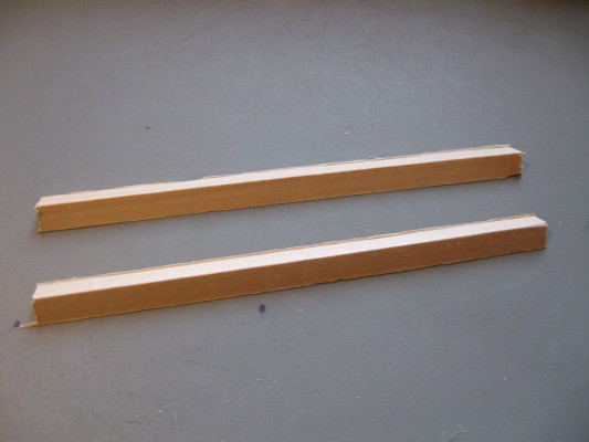

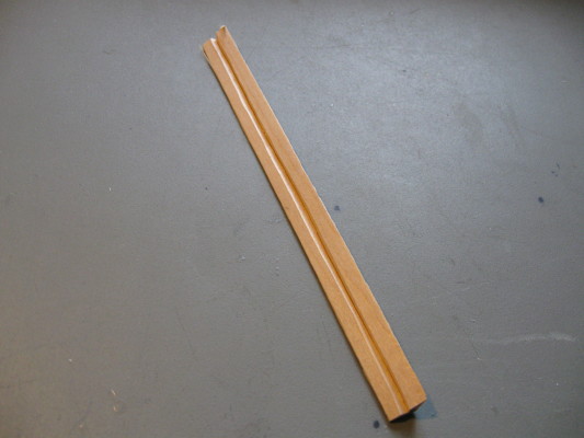

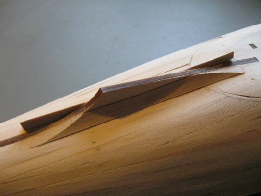

Sand smooth both sides of the keel at the stern, then cut the triangular wood strip into two 120mm long pieces.
Cut the groove as shown and shape the outside face of strips to form a concave curve, then glue them to the hull/keel as shown.
When the glue has dried further shape the pieces to match the keel shape and further smooth the concave surface of the keel infill's.
Final smoothing and shaping of the hull is completed during the next despatch (29-32).
Construct the two aircraft kits (one with folded wing tips) I'll finish these when all aircraft are to hand.
