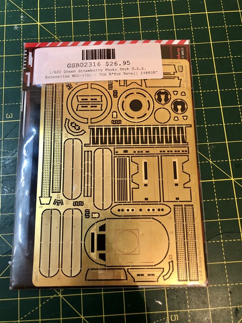

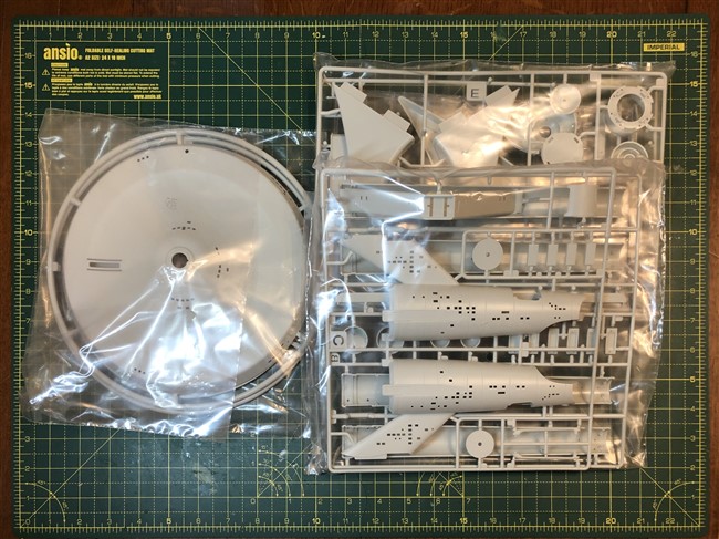

As soon as I have all the electronics in place, I will be starting this build. Back to me building spaceships again and this one I have been looking at for some time, and it’s not Star Wars. I had looked at the Polar Lights kits, but the larger version was too big at 1:350 scale and the smaller one was very small. The Revell versions comes out somewhere in between, measuring around 50cm in length. I have also bought photo etch parts.
I will be doing the full electronics with this one, with rotating nacelles, lighting and detailed bridge and shuttle bay from the PE. The plan is to have a shuttle leaving the bay in flight, as well as having various sound effects, well that’s the plan.Cool
Coming soon.

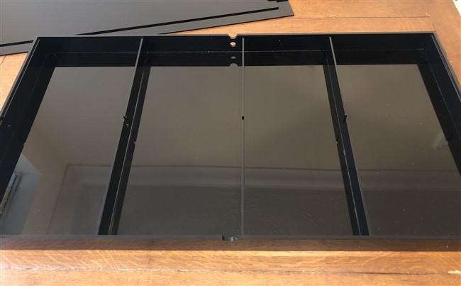

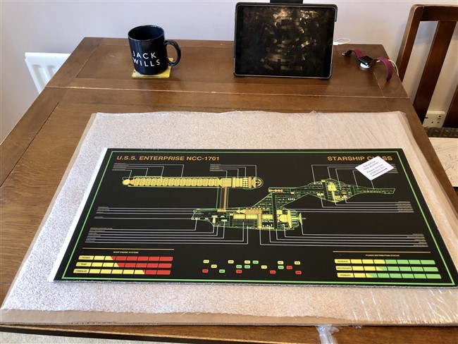

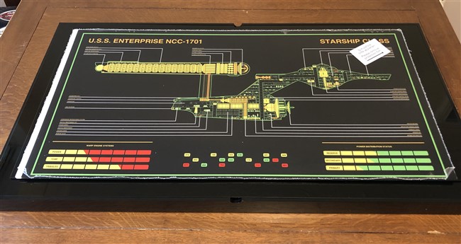

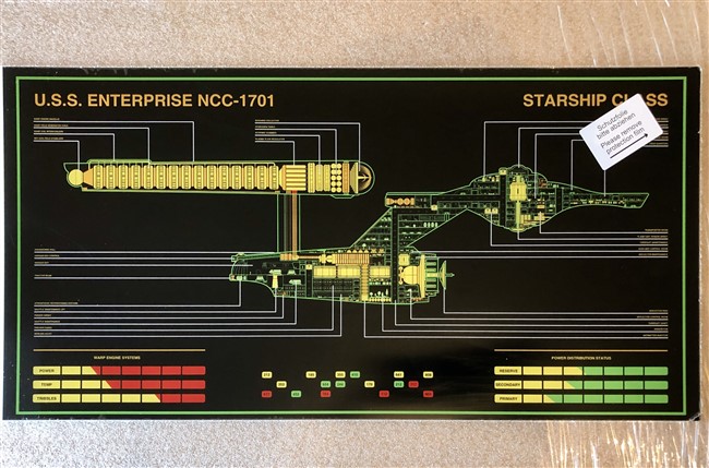

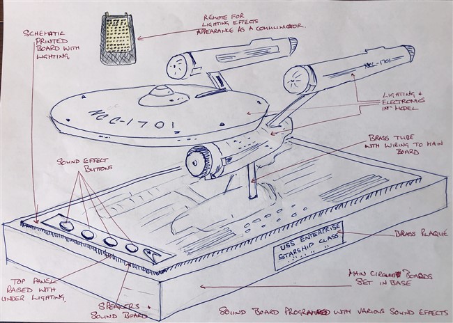

I have been planning this build so I know what I need as well as know how it will all come together. I will not be using the supplied stand as this will be on a base with a lot of electronics inserted into the base as well as the model itself.
The first thought was to have a mirrored base, but I found a schematic picture of the Enterprise and printed this onto some acrylic which will now be the base for this kit. It will also be raised with lighting underneath to backlight the whole schematics.
The last picture is me holding it up to the room light to give some idea of the backlit feature.
Starting very soon.ThumpUp

Very impressed with how you have printed up that acrylic back panel cannot even begin to work out how you did that but it looks very nice indeed.

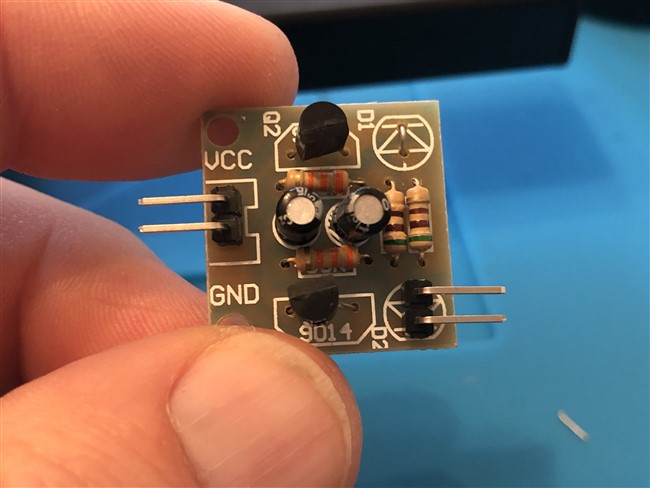

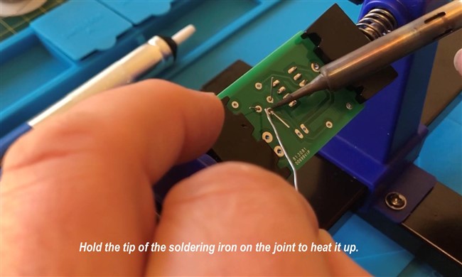

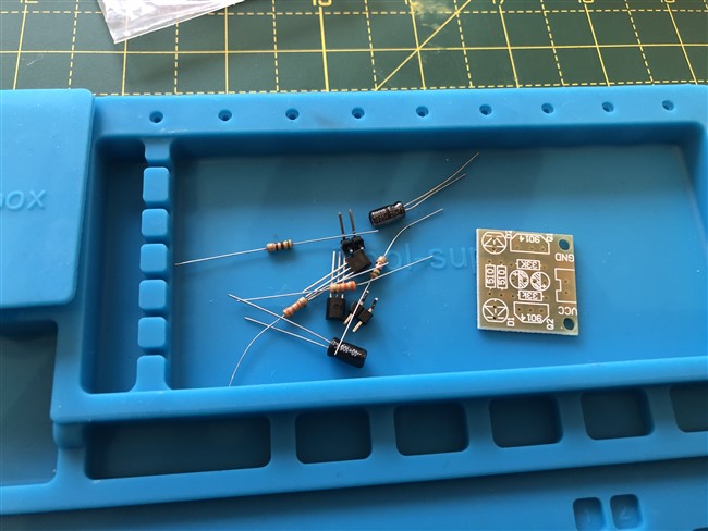

#18 Posted : 17 November 2019 16:08:06

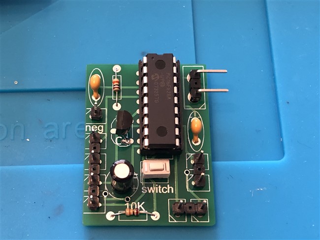

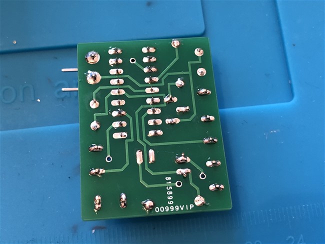

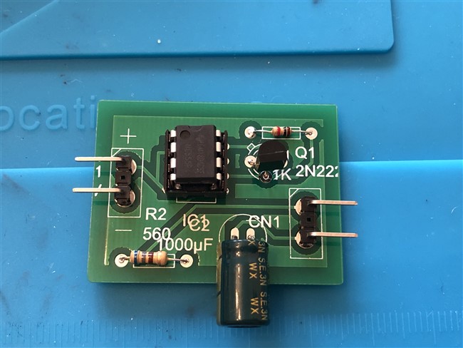

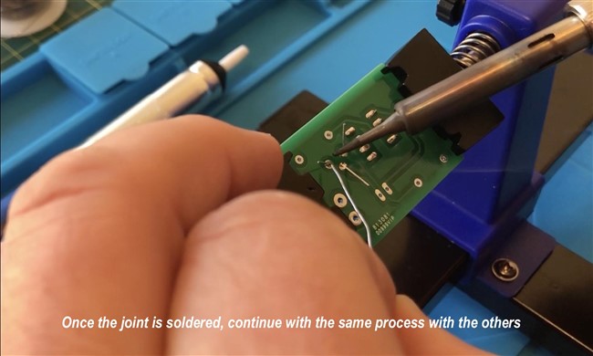

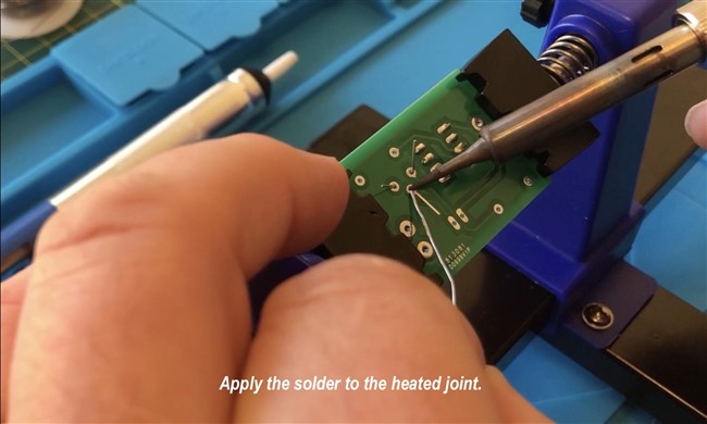

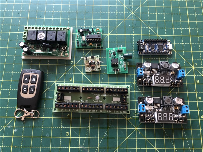

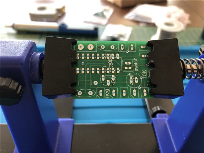

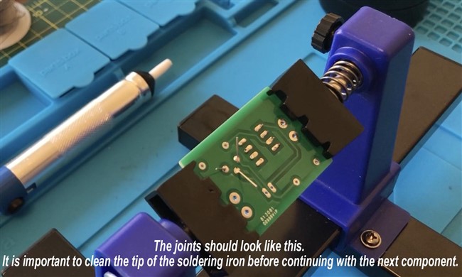

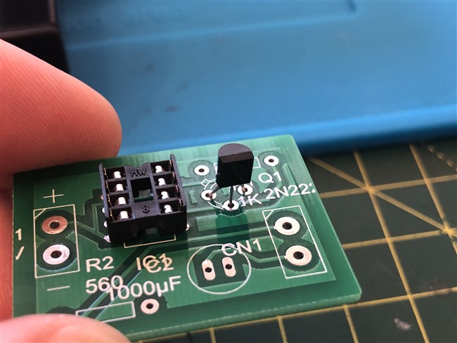

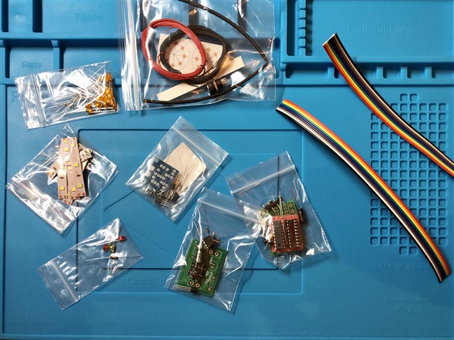

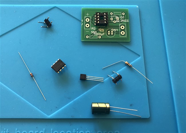

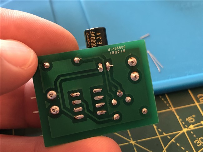

I have started getting some of the components soldered. There are quite a few as well as lots of LED’s to be made up. For those who are tempted to have a go with a project but not sure of there soldering skills, I have put some pictures up to help. The main rule is to have a hot iron, hold it to the area where the solder is to be applied, then apply the solder and once the joint has enough solder to make a nice join, remove both the solder and iron.
I have made up a few of the components including the Adafruit sound board, which I will show in detail how to programme later in the build.

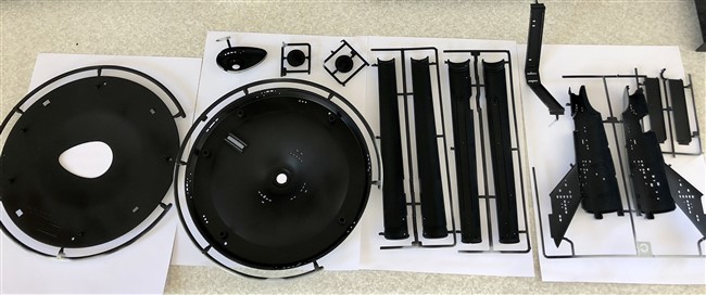

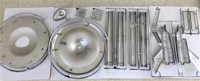

I have also painted the interior of the model. First, a coat of primer was applied, then black to stop any light bleed and finally silver to give a reflective surface.
I will be fitting all the components first before painting the hull, lots of window to mask off.Crying

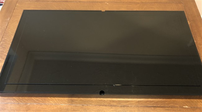

The last few pictures show the base on which the Enterprise will sit. As you can see the top part comes off to reveal a hollow base where some of the electronics will go, other smaller components will be in the model itself.
The last picture shows the schematics which will be raised slightly with underlighting.

Very cool.I see the IR relay board, the adafruit sound unit, 2 voltage converters and some custom boards which I assume are to control the LEDS and a power distribution board.Will be watching this with great interest.Where did you get the graphic for the base.It looks amazing.
