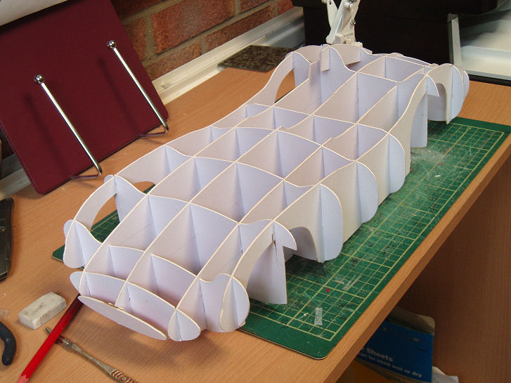

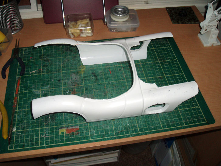

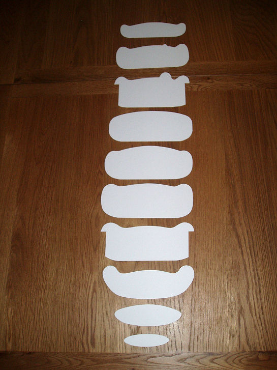

Glad to see you're thinking about jumping in at a scratch build.

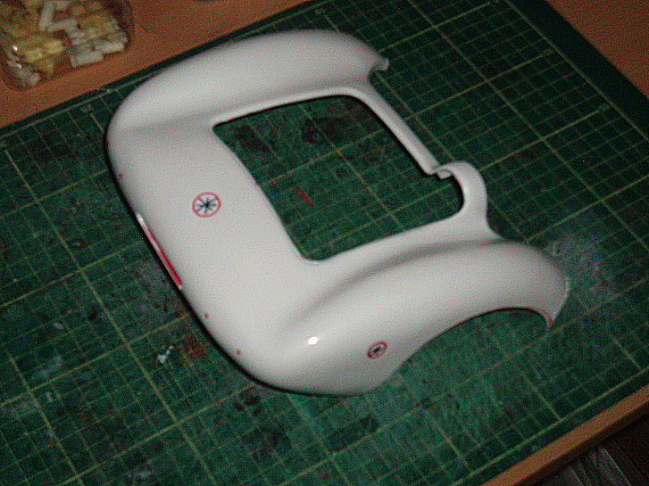

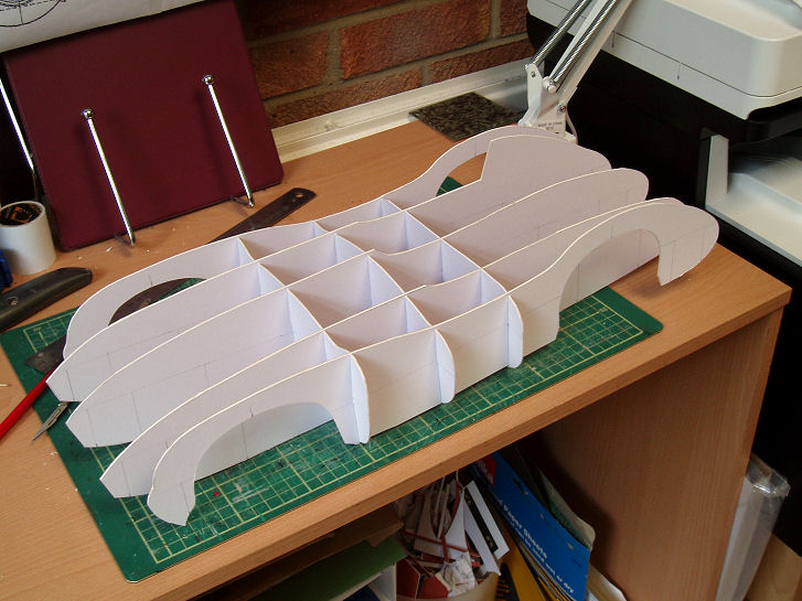

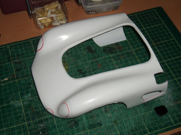

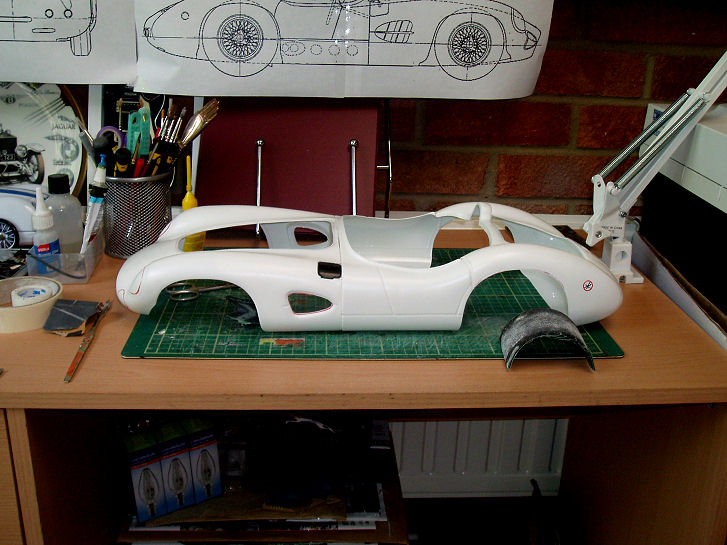

There are quite a few different ways of going about the body.
Yes, you can'carve' one using balsa and car filler, them make mould from it.
You could look at getting one 3D printed - probably the quickest and most accurate but pretty expensive.
Another way is to make one using card sandwiches and then filling spaces with expanding foam, smoothing down, then filler. Then get a vac form shell made in sections.
If you can find sectional drawings of the car, that's about the easiest DIY method and is cheap.

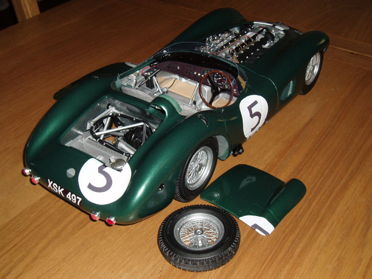

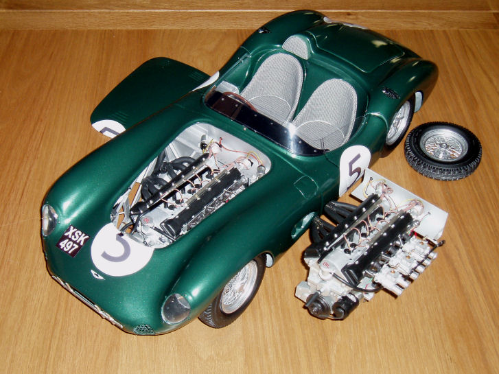

I've attached some pics of my Aston DBR1 that was made that way.
If I can help in any way, let me know...
