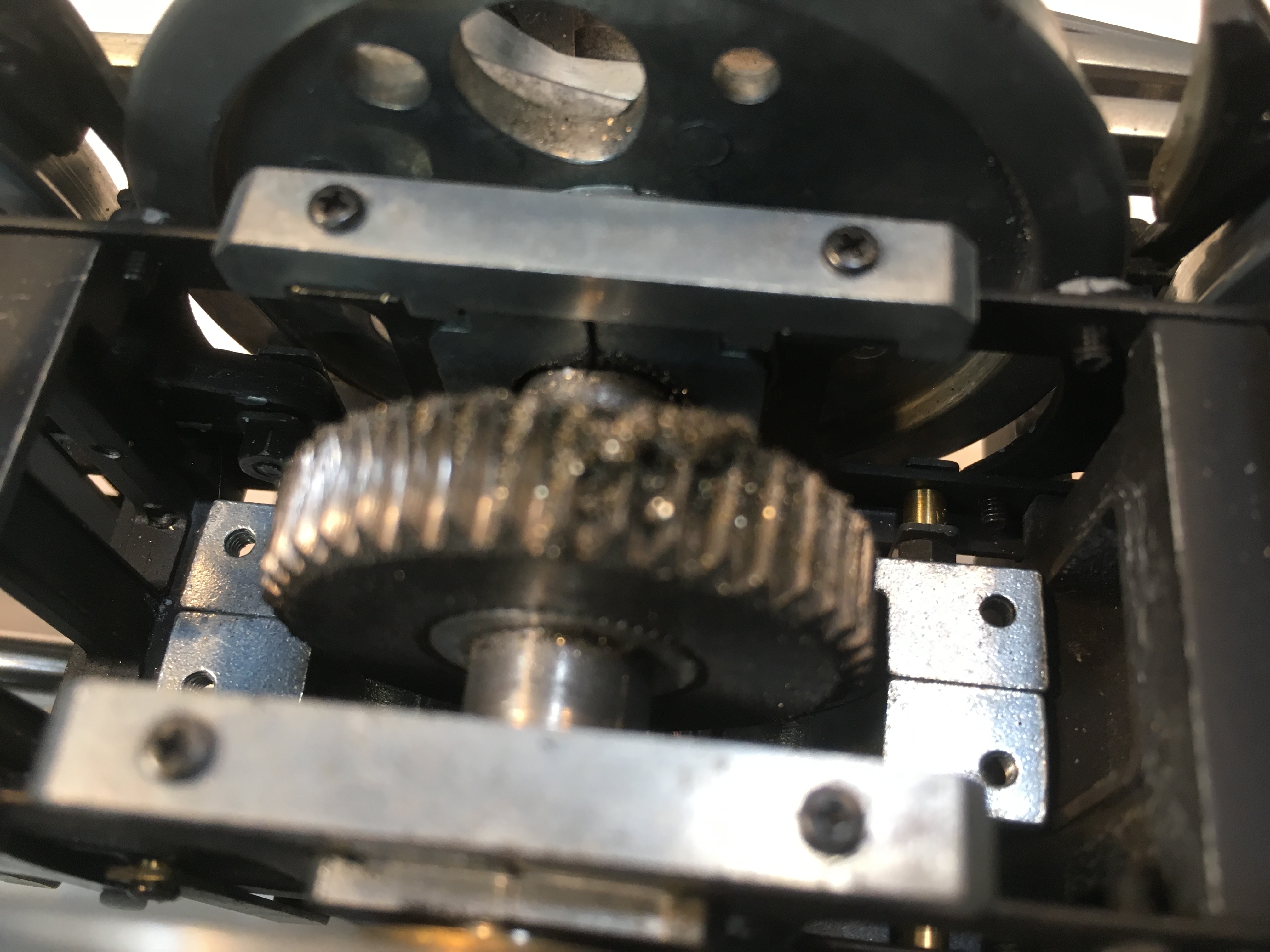

Sorry to drag this on, but it is driving me more crazy than usual. I opened the gear case and found the gear full of tiny metal "crumbs". All cleaned out, and everything looks to be installed correctly, but even under no load conditions(holding the drivers off the rolling road, it looks like the worm gear may not be fully engaged with the driving gear, because the worm gear tends to slip. Any ideas,folks?
Thanks

To close the loop on this thread, after browsing the model railroad forums, I disassembled the worm/drive gear assembly and applied a small amount of white lithium grease. The model now runs smoothly and quietly. Based on what I have read, the application of grease will probably outlieve me!
