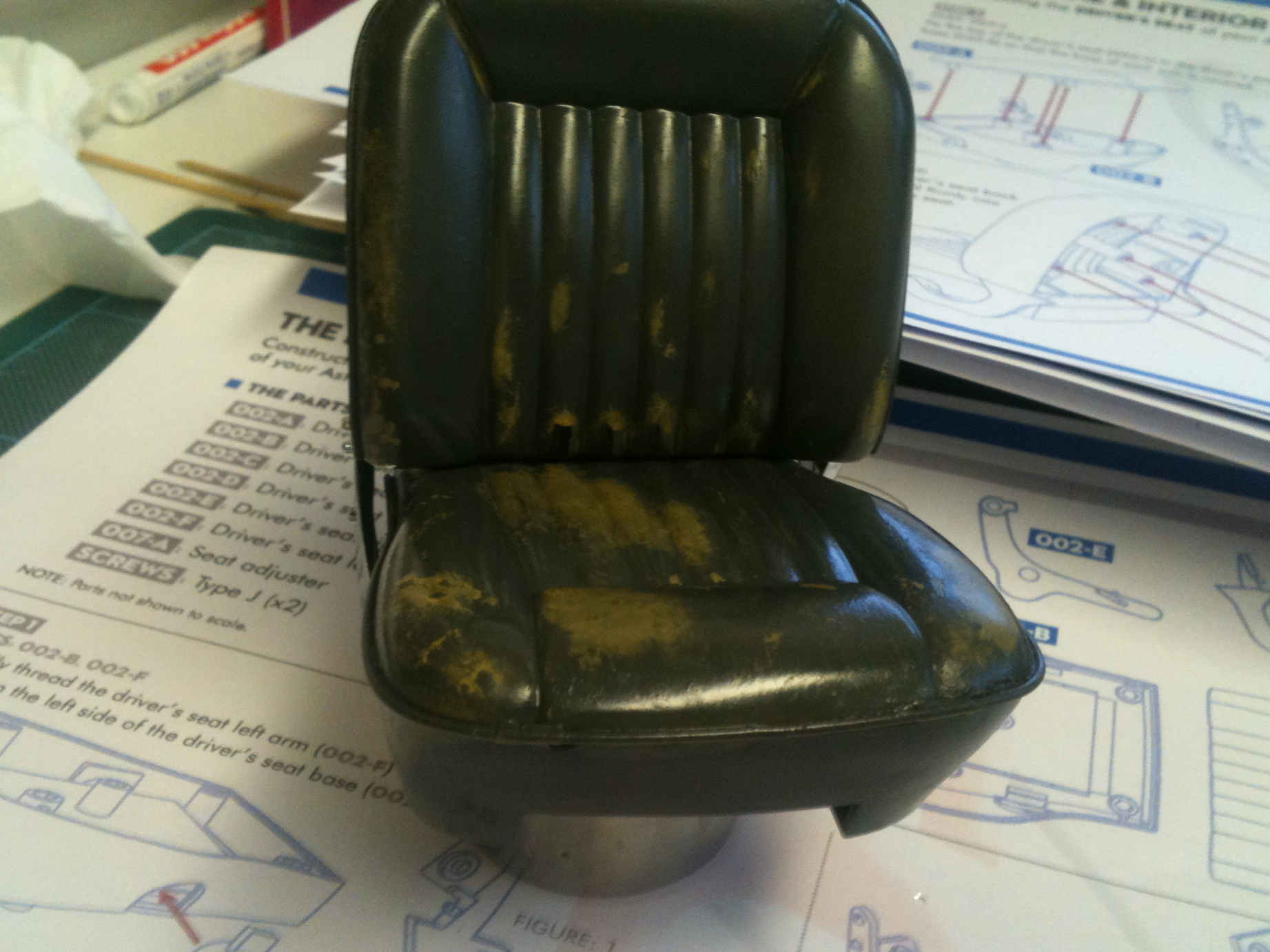

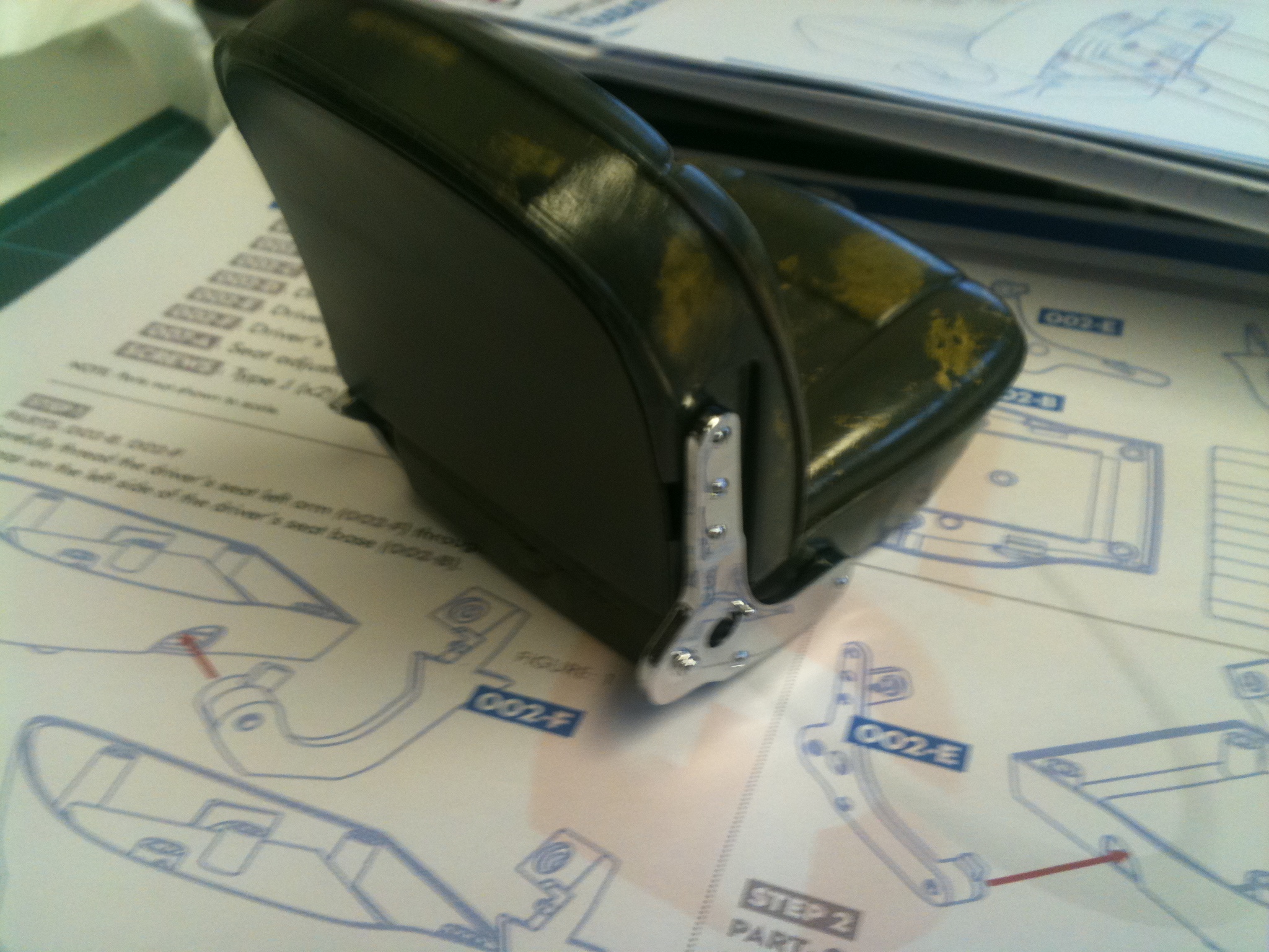

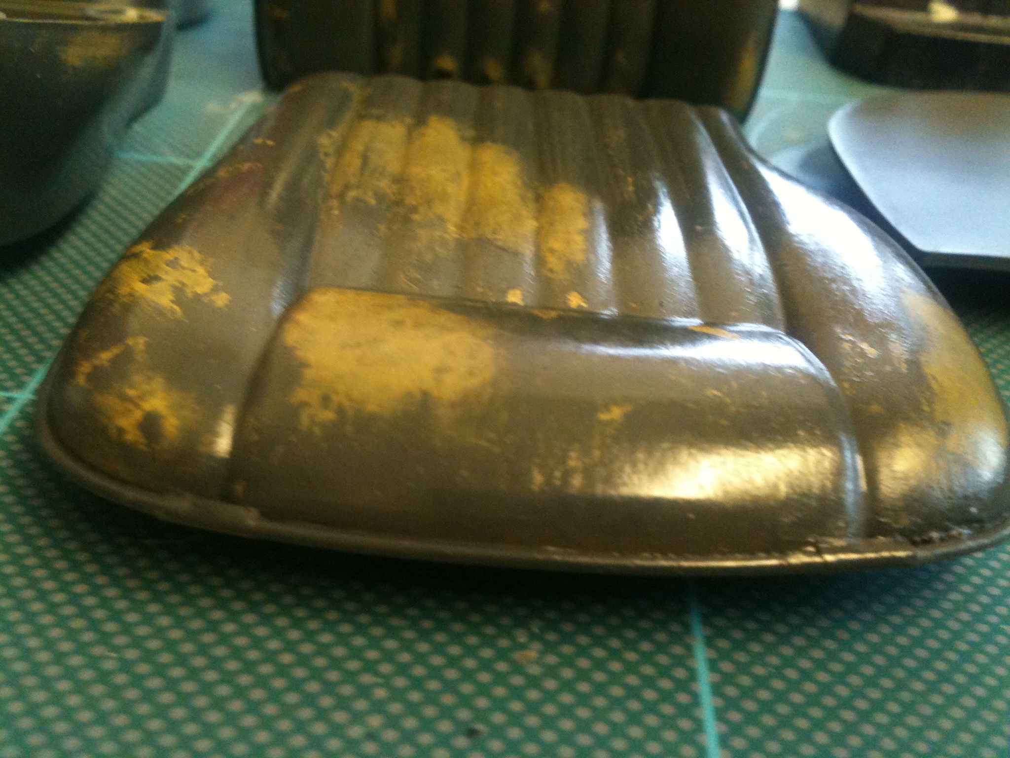

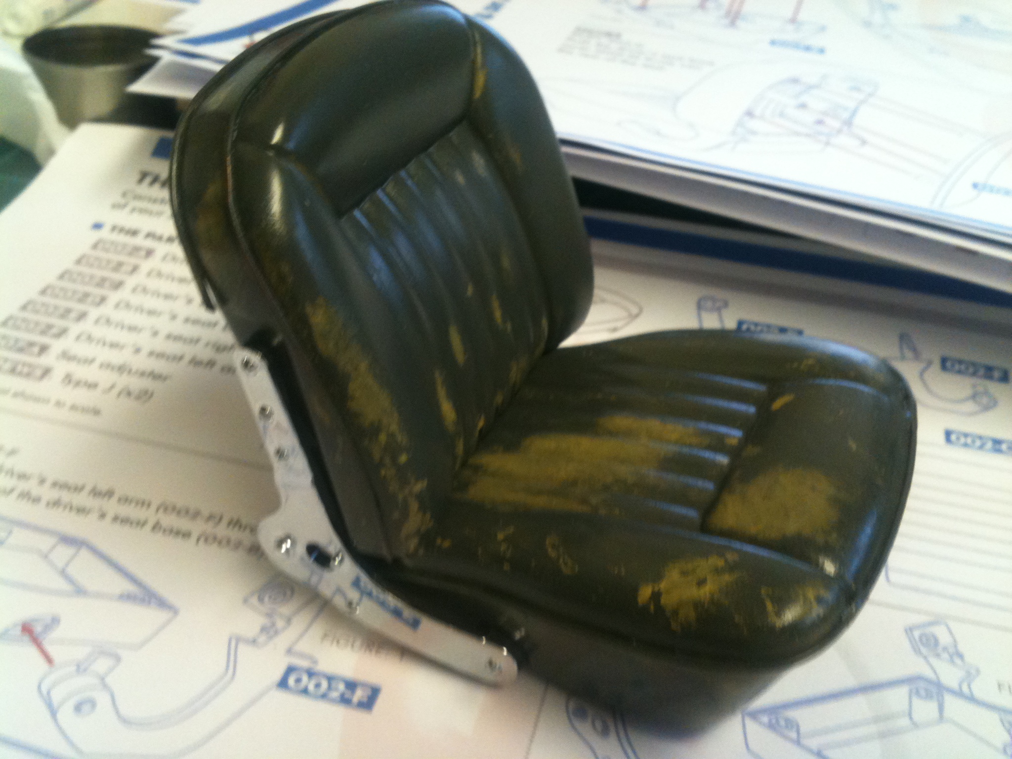

As building the Mclaren is going to take quite awhile I decided to embark on the [i]007 DB5 to fill in the time. To be honest the Aston is such an iconic car I just had to have ago. Having found a great deal of info on the Web I decided to build the car as it appeared in a 360 degree view, well used on the inside. I am going to try to post some pics of the drivers seat as it looked in the pictures.
#2 Posted : 02 November 2011 21:07:36
Welcome to the Forum Bigma10, the seat looks great by the wayBigGrin Cool

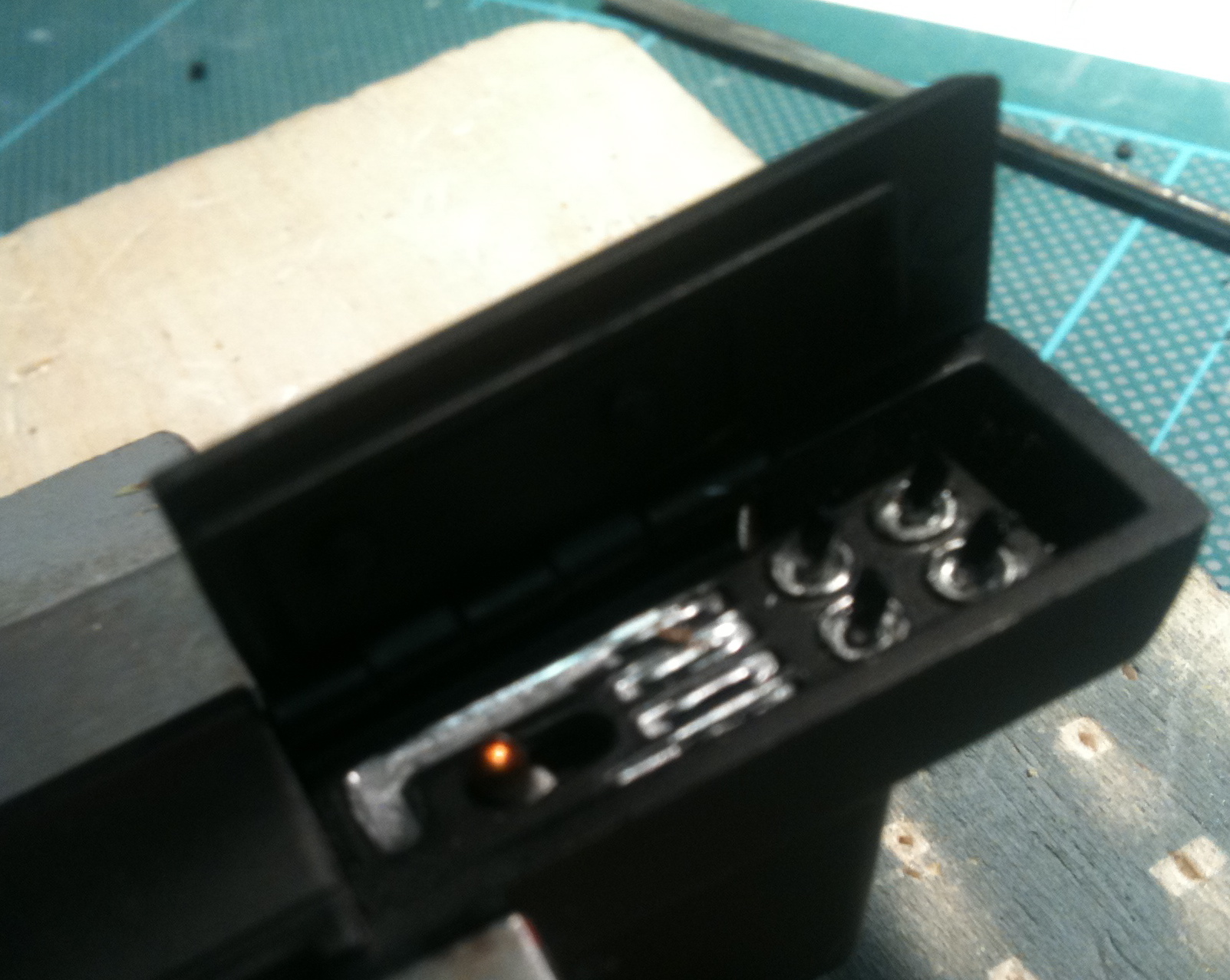

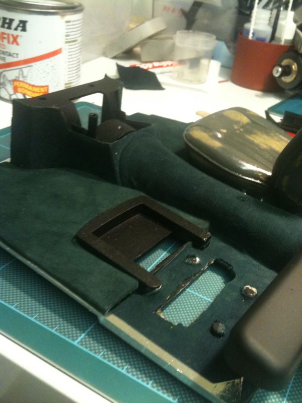

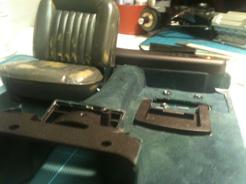

My carpeted floor unit
bigmal0 attached the following image(s):
SennaMentalMe
#4 Posted : 04 November 2011 23:21:37
BigGrin Hi bigmal0,
Excellent carpet fitting skills there I must say, very neat and tidy and looks the biz !! ThumpUp
Thanks for posting up the pics, and I will be following your build with interest !! BigGrin

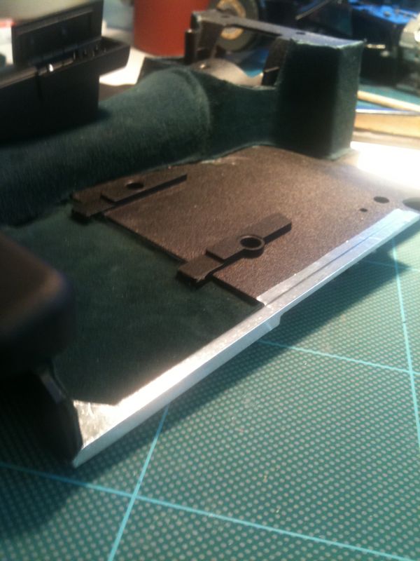

I have been doing this stuff for years now and use old fashioned masking tape to enable a template to be made.
Then depending on the area to be covered I use a thin plasticard and double sided tape to fix the leather/cloth etc which
Keeps large flat areas smooth. It's good to put up work for scrutiny and see what others think, as we all build for ourselves
So rarely have the chance to be tested if you know what I mean.

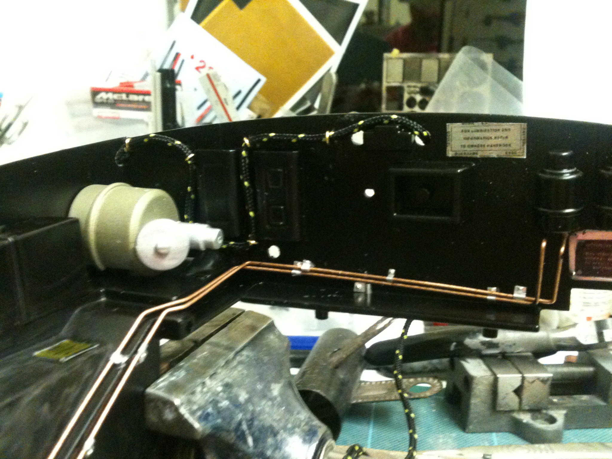

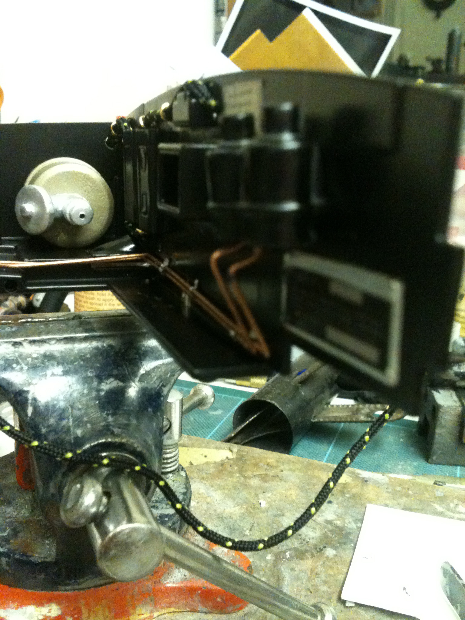

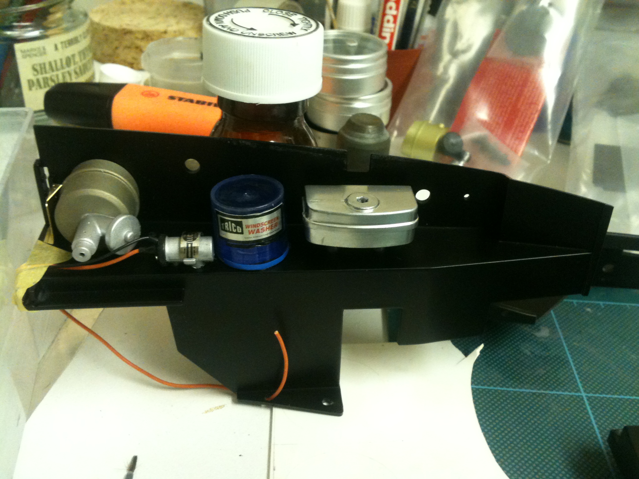

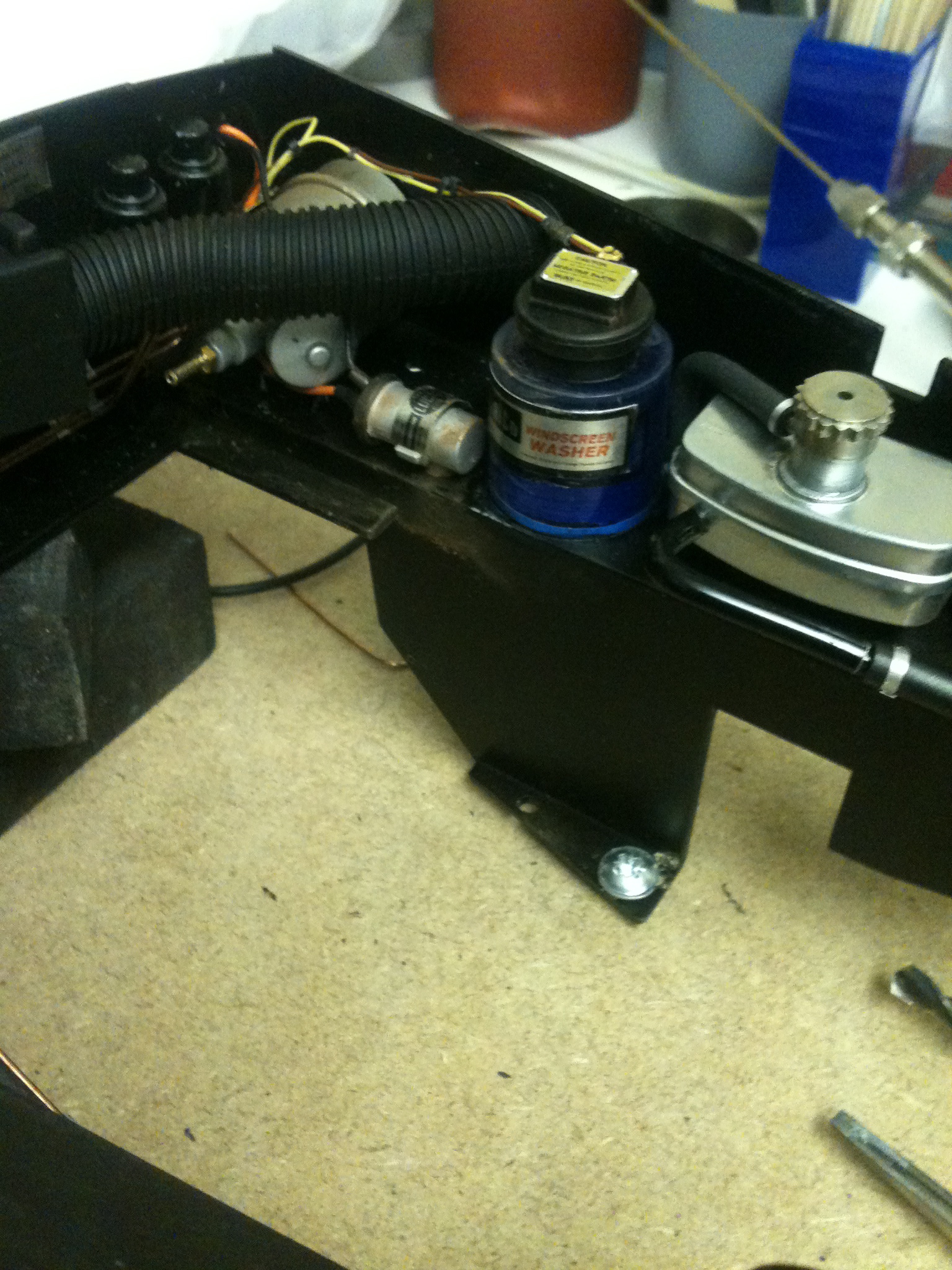

I have spent today working on the left engine bay and the rear bulkhead.
Question, on the rear bulkhead on the left as you face it are two raised sections and what appears to be a tube, anybody got any ideas what they represent
#10 Posted : 09 November 2011 20:37:38
Fuse Boxes, and wiring loome Tony

Many thanks for the info, I may have a go at removing it and replacing with some scratch building

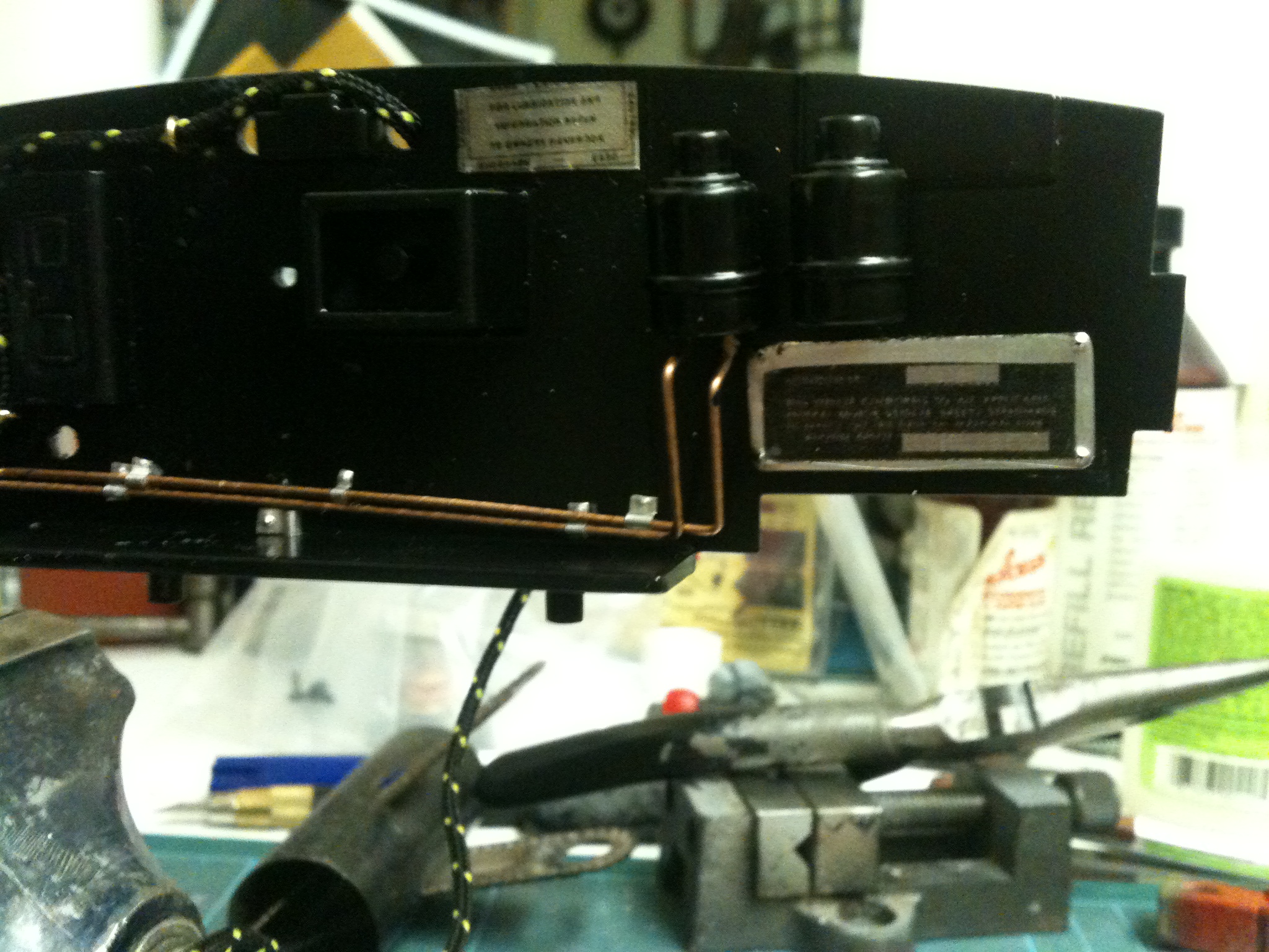

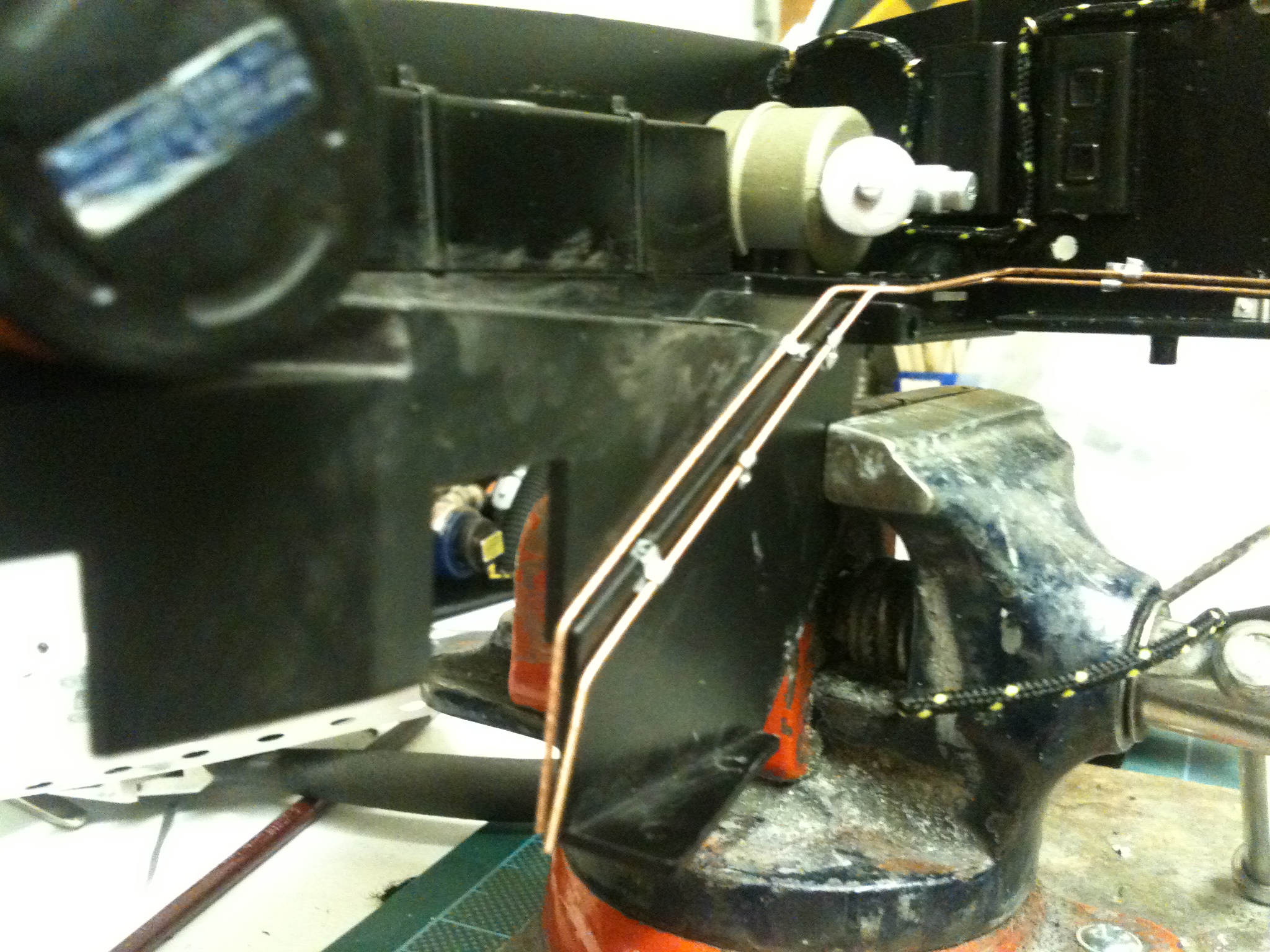

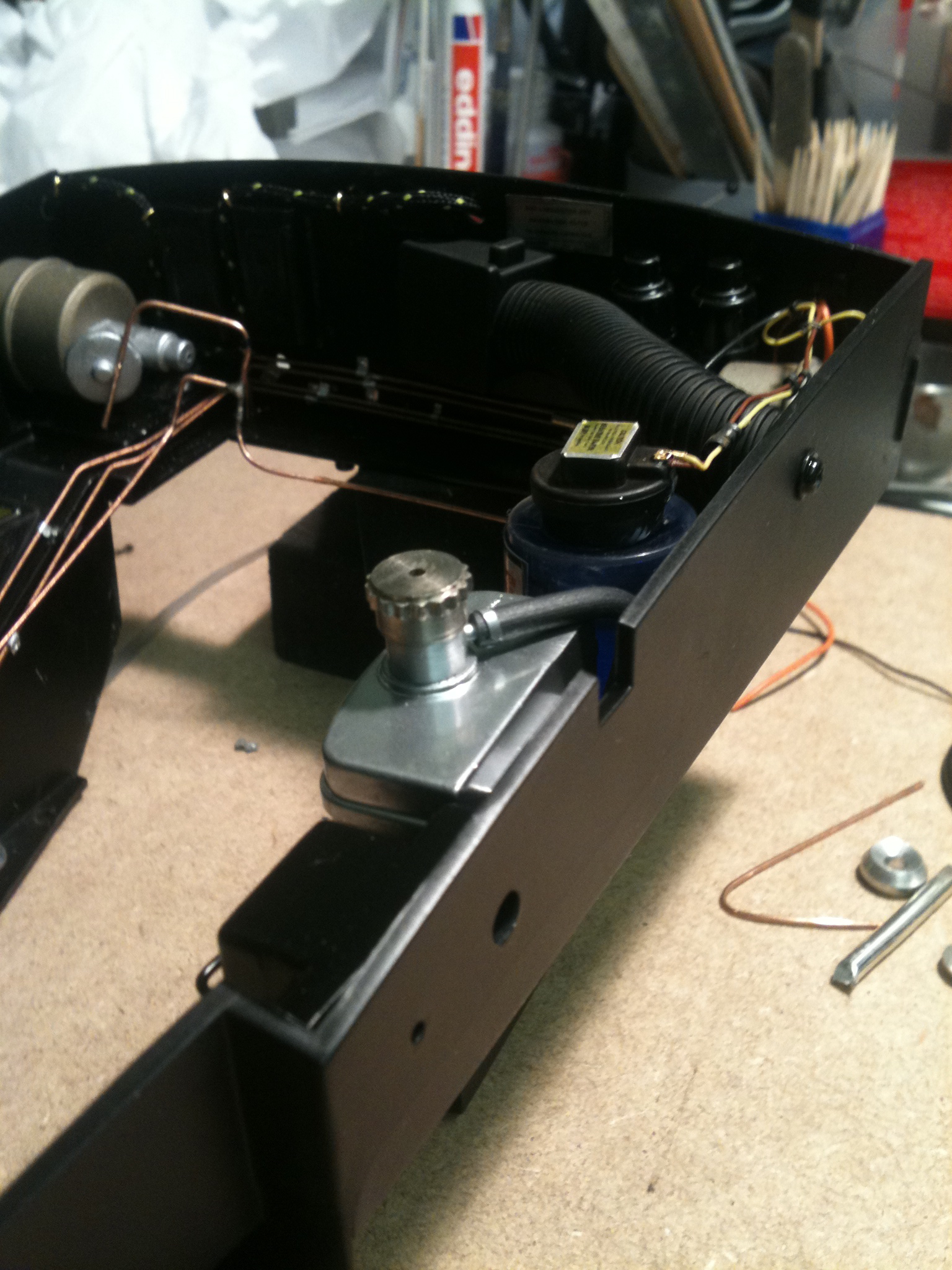

My bulkhead and engine compartment so far
SennaMentalMe
#14 Posted : 11 November 2011 21:22:25
BigGrin Hi Tony,
Excellent stuff there mate, looking very good indeed !! ThumpUp
I particularly like the black and yellow flex that you have used on this model and also I noticed, on your Trumpeter GT40, it looks like a very good representation of the old fabric covered wiring looms from the 60's & 70's - cool stuff and top class motor modelling mate. Well done, we need more of this !!Love ThumpUp
Cheers ... Kev. BigGrin

Great enhancements Tony, keep up the good workBigGrin Cool

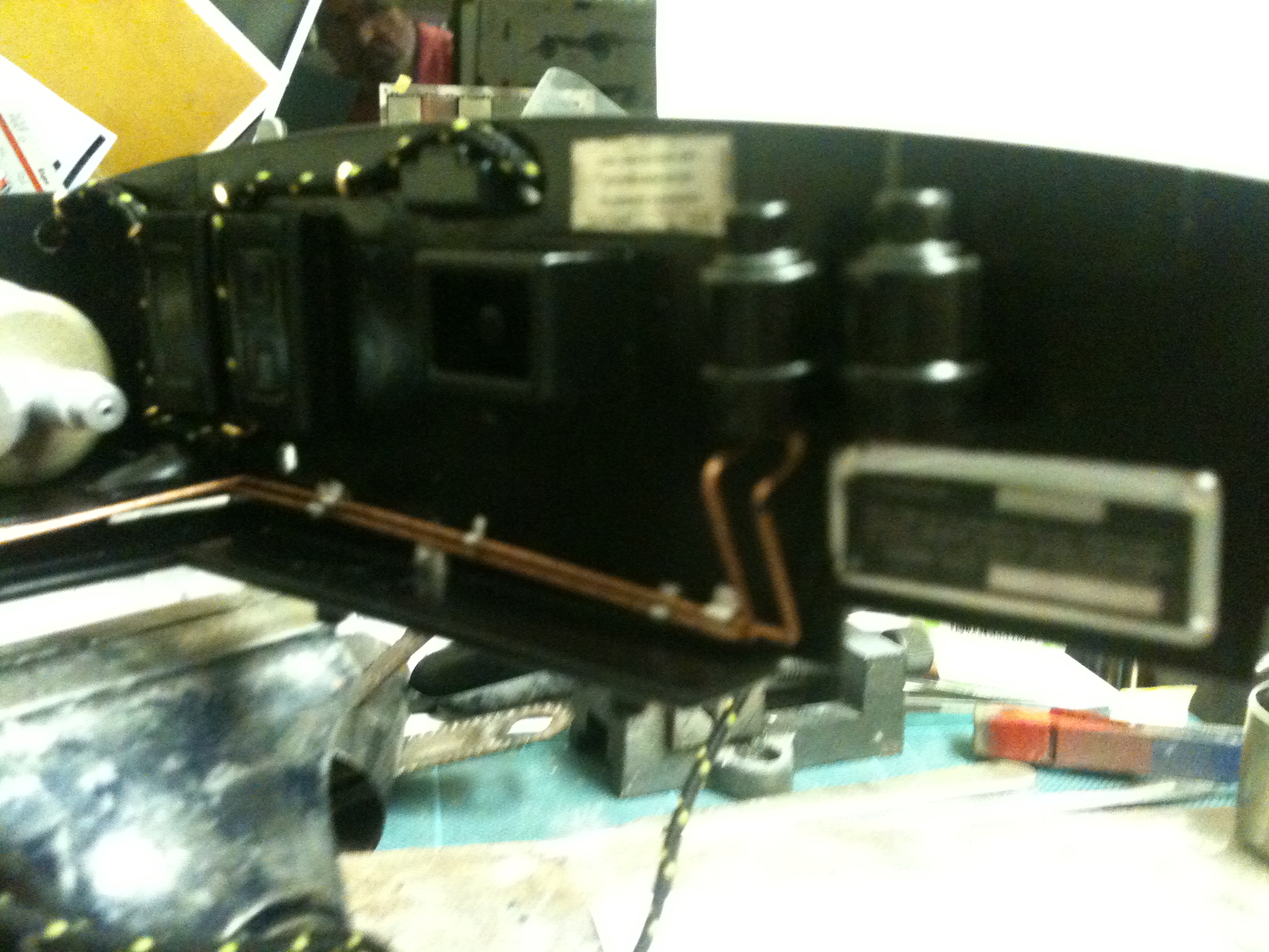

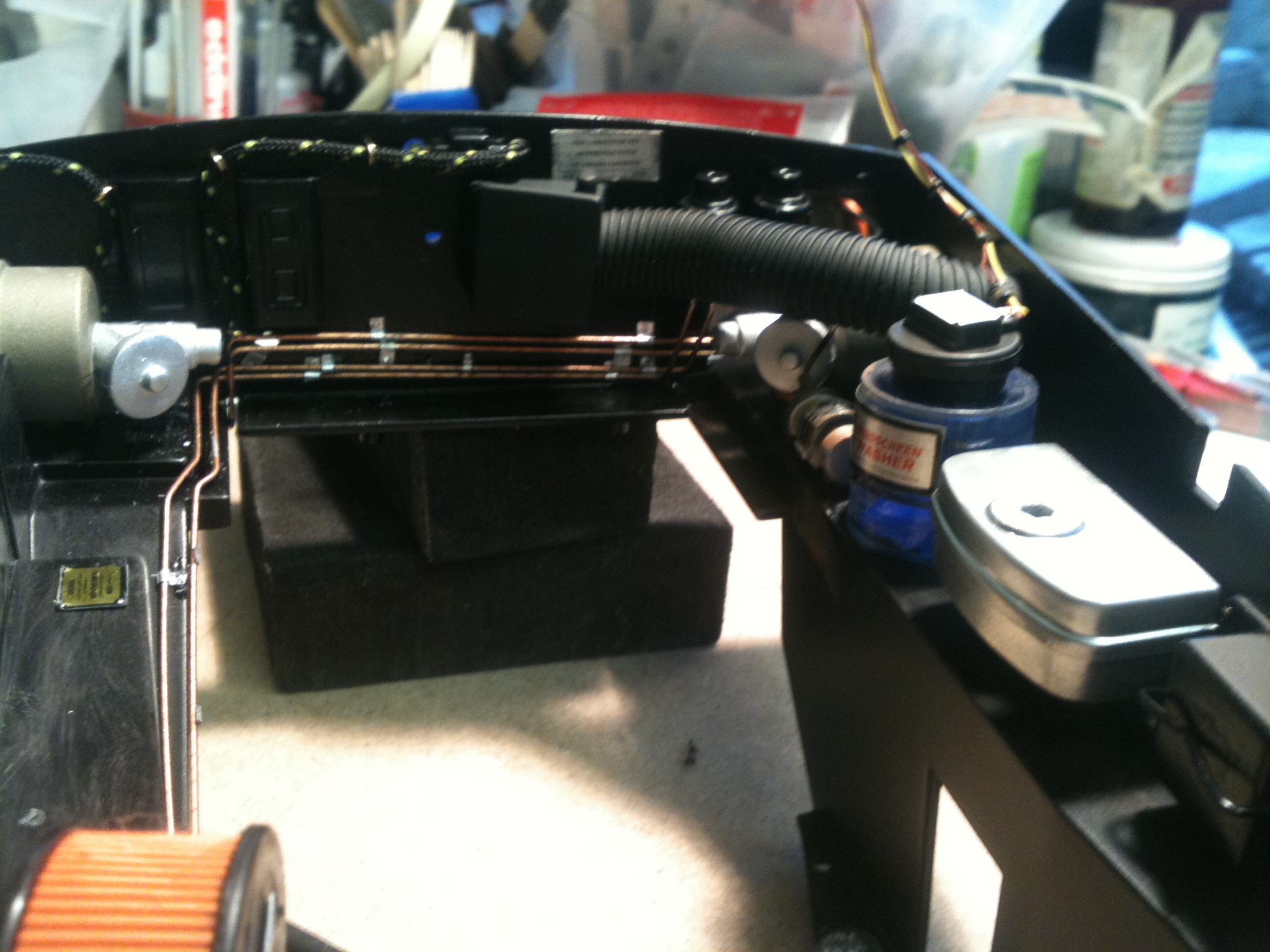

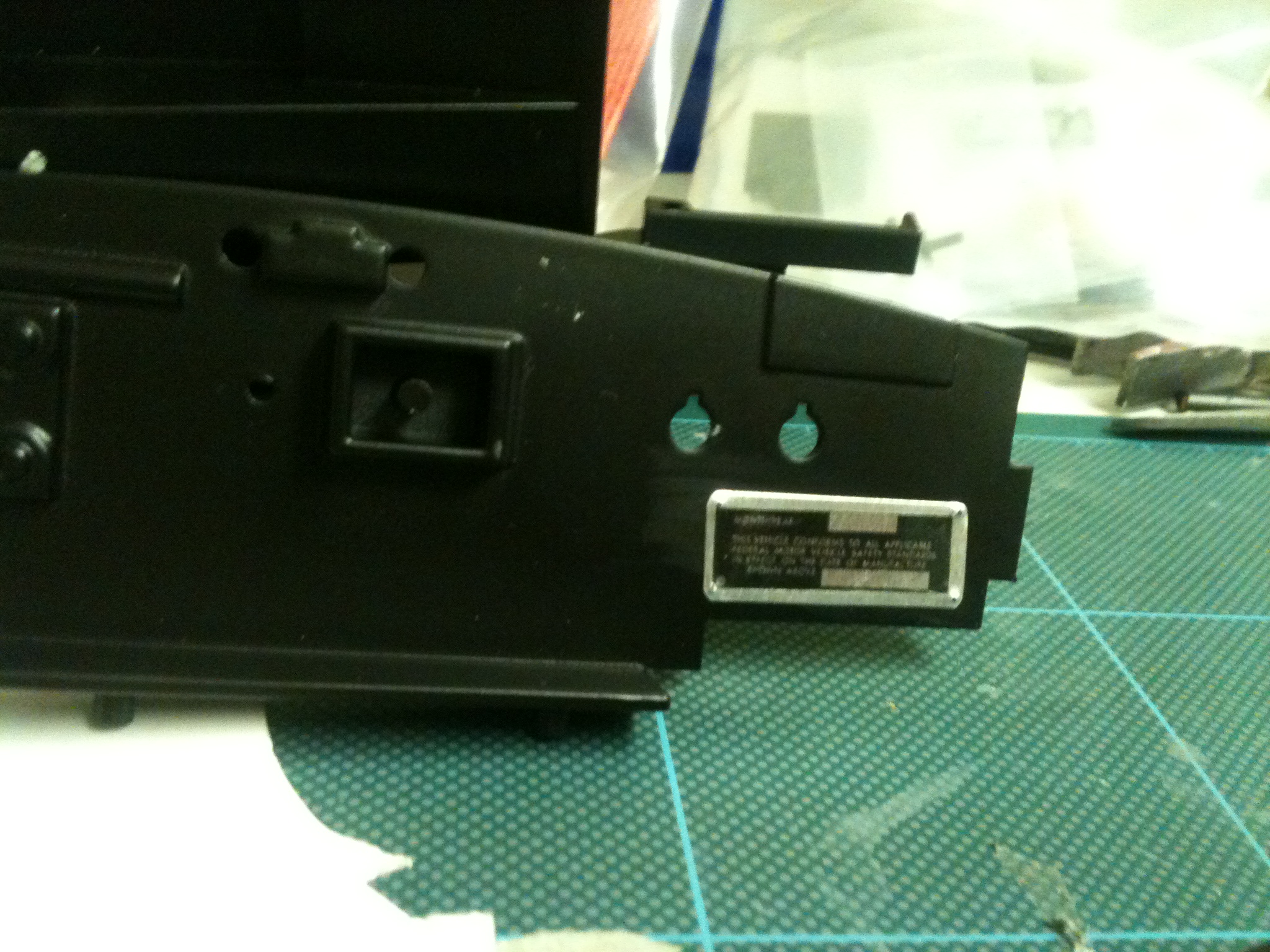

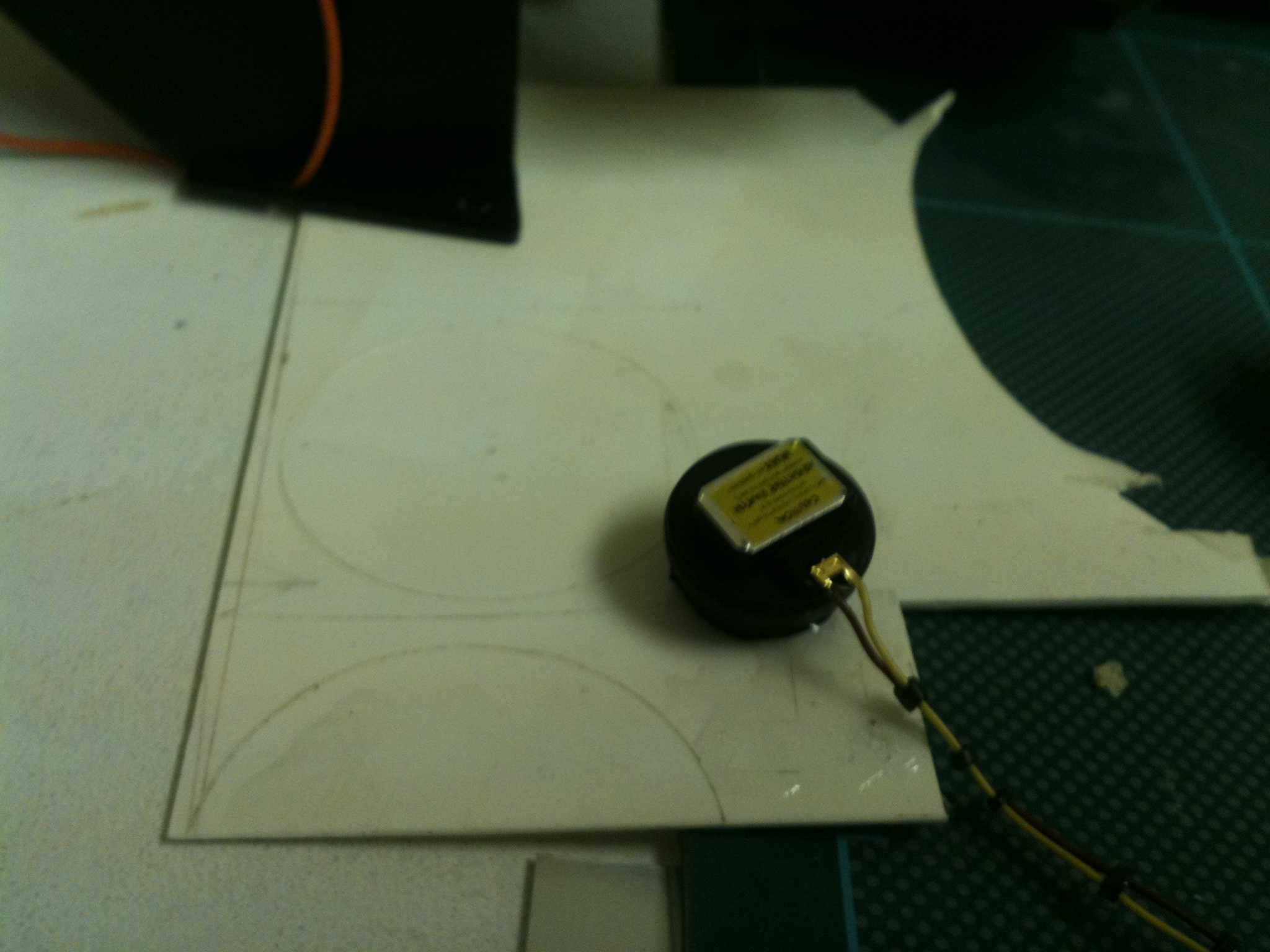

A bit more progress whilst waiting for parts for either the DB5 or MP23. I am spending a lot of time making parts from brass tube and wire but its looking reasonable compared to my reference pictures, see what the team think.
#17 Posted : 14 November 2011 20:19:39
Looking very authentic TonyBigGrin Cool
kryten2b
#18 Posted : 14 November 2011 21:18:46
Joined: 08/03/2011
Posts: 245
Points: 726
Location: Norwich
Looking good - how are you making up the labels you are using in the engine bayDrool

I downloaded them then put them into Word so I could resize them then printed to decal, two coats of clear laquer then I had them as transfers.
