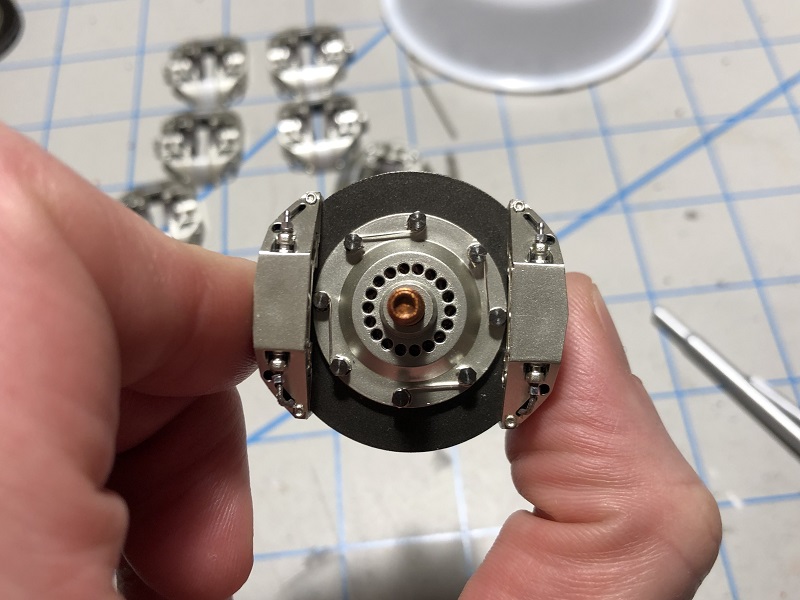

Brakes
I decided to drill out the bolts and add the safety wires to the brakes. Through trial and error, I learned the best way to assemble is to glue the brake halves together and drill through both parts. I then added the bolts and finally twisted the wire around them. I normally get my scale bolts from Model Motorcars but they didn’t have the right size so these came from Knupfer. They are 1.4mm x 6mm and fit perfectly – no need to cut them down. The wire is 28-gauge craft wire that I found on Amazon. I wrapped it around by hand and used a screw driver to straighten and tuck the ends under the bolt head. The braided wire and fittings are from Pro Tech and the brake bleeders from RB Motion. I have thought about replacing the brake lines on the back (not pictured) with braided lines and banjo fittings but ended up preferring the kit pieces. I’m debating adding temperature decals to the calipers.
