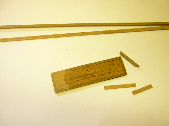

Hi Guys.
As promised a few pictures on how I built my small chairs,I found that the main aim was to keep everthing square,This is so important at this stage and at this scale of modeling.
Chairs: 14mm High.
Legs: 3mm Long by 1.5mm Square.
Seat: 8mm Square.
First make a jig I used balsa, and slot in a base plate to work from.
Draw a line 14mm from the base plate add the first rear leg.
Then draw another line 8mm apart from the out side of the first leg.
Measure down 8mm add top and seat middle sections.
Next I made the seat from 2mm ply.First cut a square 8mm shape up to square.
Next add the front legs,this is better done out off tye jig.
Hope this is off interest.

Thanks Trev for your tutorial,I like themBigGrin Cool
Hans
