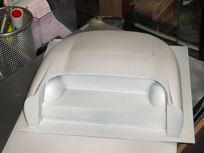

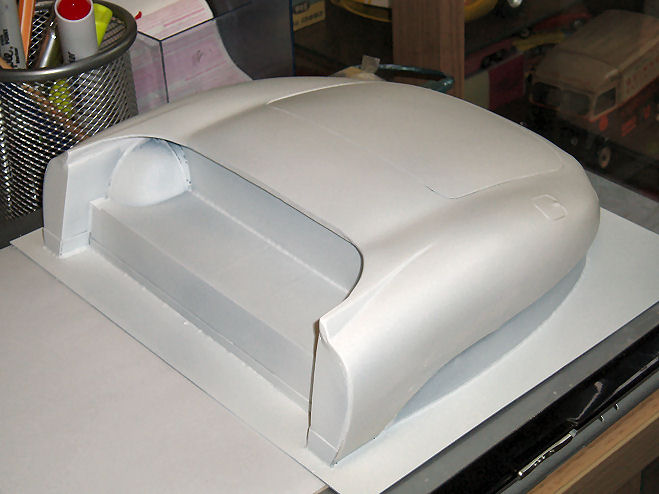

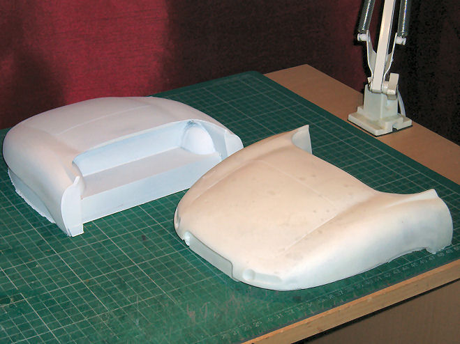

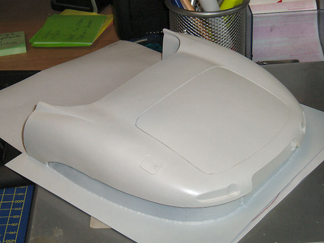

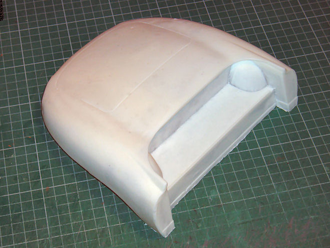

Here is my master pattern made from pieces of the giant Revell kit.
Hopefully the dimensions and shape will work.
Only one way to find out.

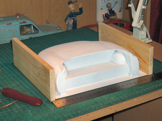

I'm hoping to make the actual rubber mould from the master this week, then get a test piece cast.
Then it will be a fair bit of hoping...Confused

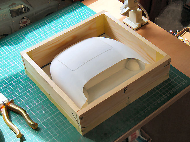

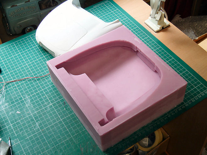

Well, after a bit of faffing about I've now got the rubber mould.
I've never had a go at 'slush' casting before so fingers crossed...

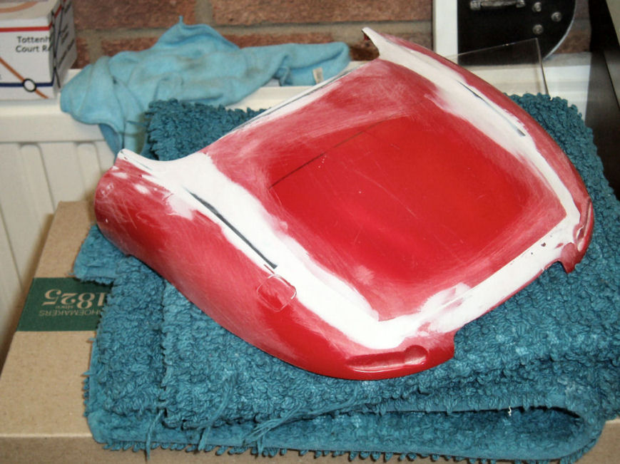

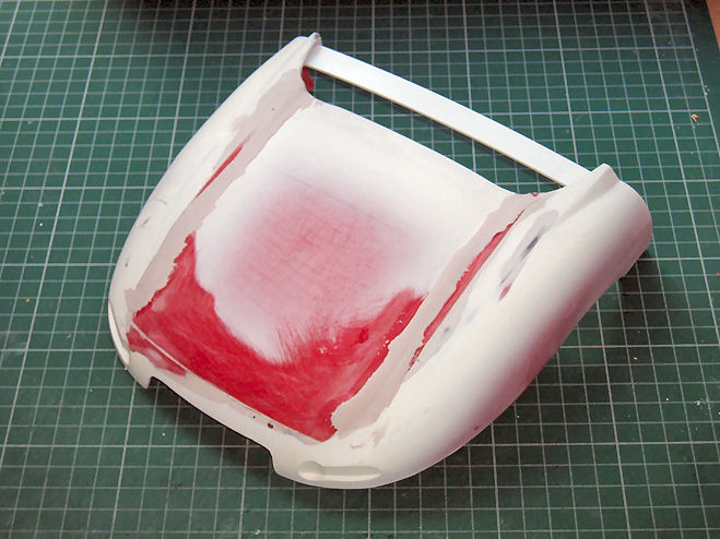

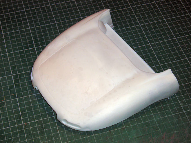

At last, my first (very) rough pull from the mould.
Not bad, but a bit of tweaking to do.

BigGrin The overall surface produced looks good and could take paint with minimum prep as for tweeks I presume thats to minimise the amount of excess moulding material. From my experience leaving a bit on to be removed in prep is better than trying to cast a master everytime. Apart from that nicely done and looking good.Cool

Yes, the tweaks I mentioned are just to get a better and more even layer of resin overall as the part is slush cast, so the inner surface isn't smooth like the outside.
Also, on this one, I tried adding a layer of thin matting to the main rear deck area for strength but it created some small air pockets which means in places, the outer skin is very thin.
Mind you, as I said, this was a first attempt.
I'm also going to try using a different resin to see if I can get a more even slush.
