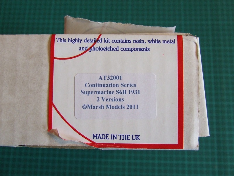

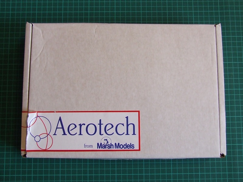

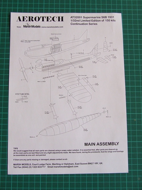

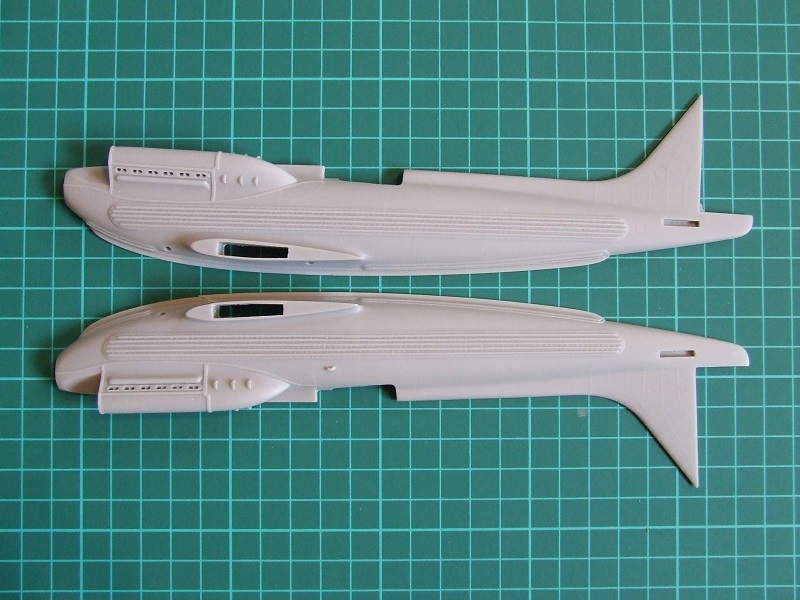

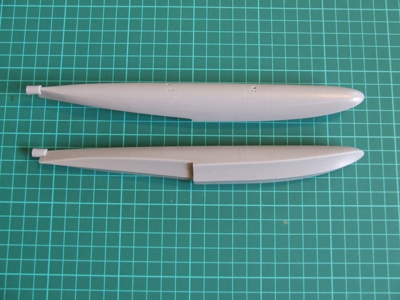

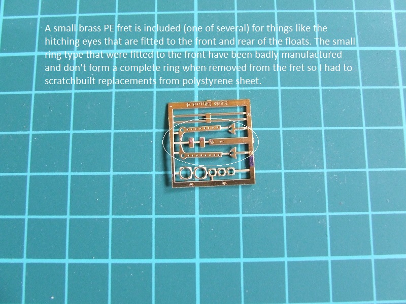

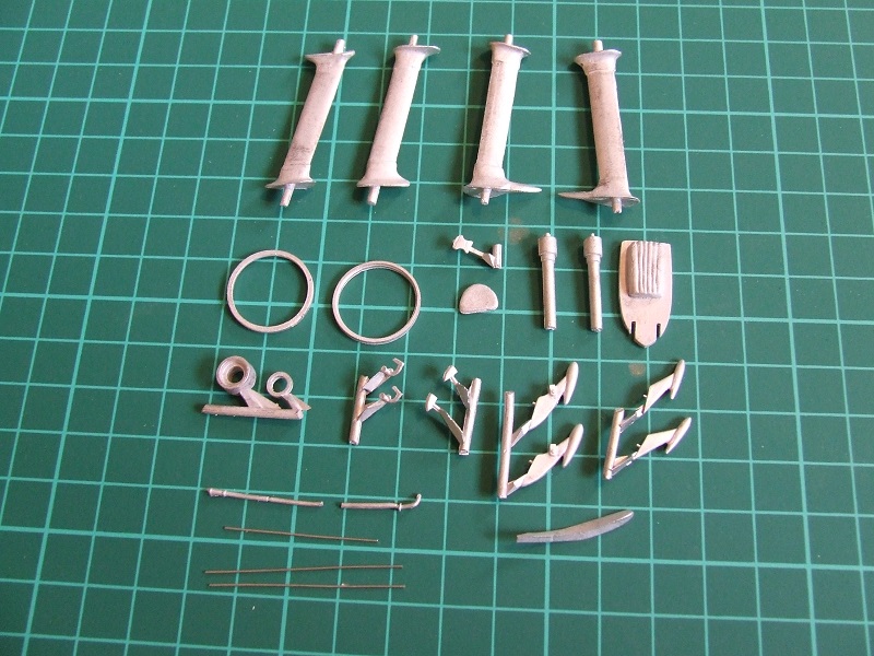

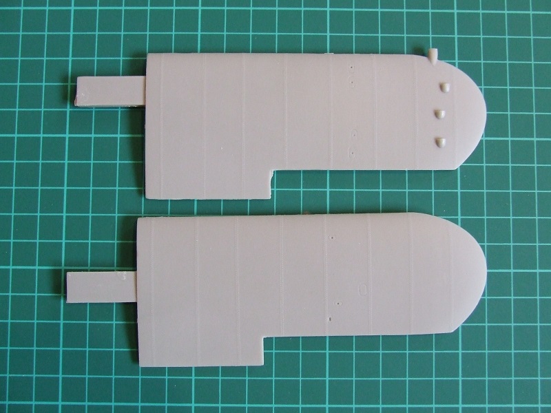

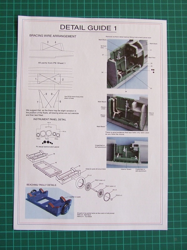

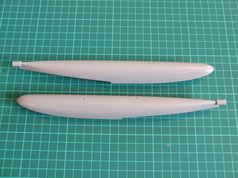

Hello all,

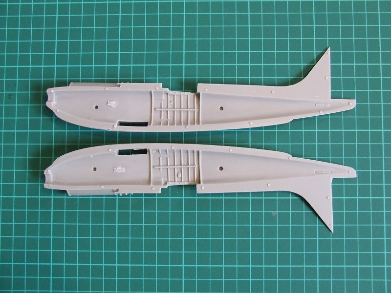

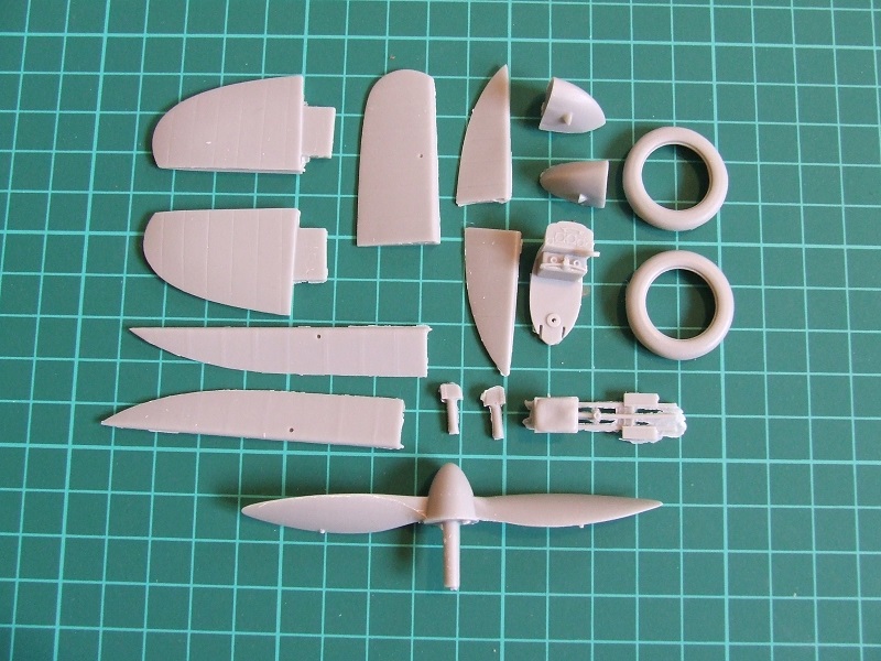

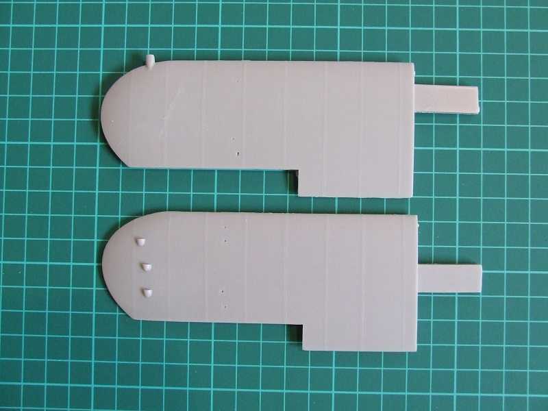

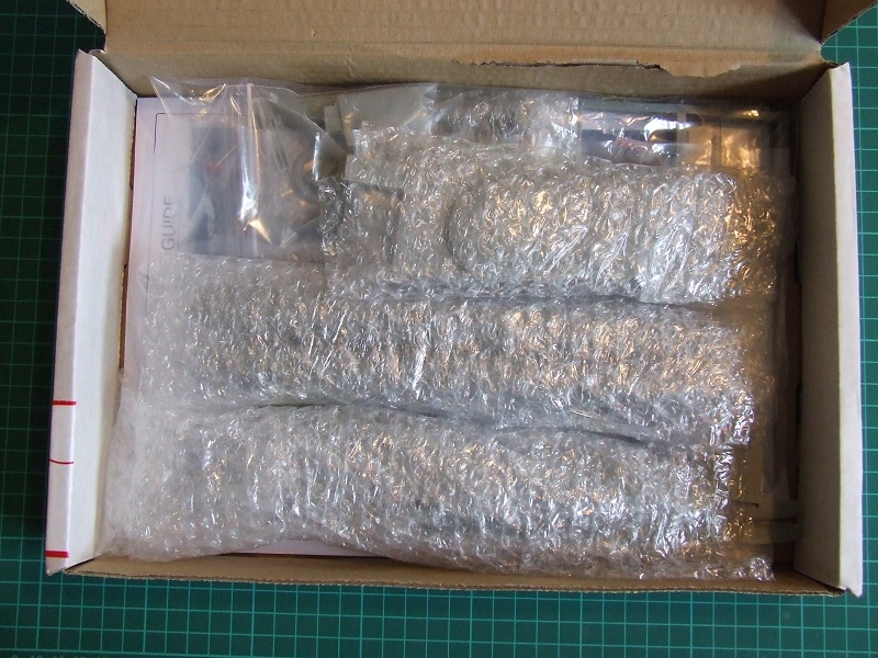

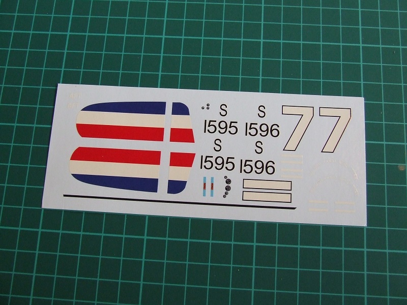

I have been after one of these kits for a few years, and finally, I am over the moon at taking ownership of one! Released in 2011 by Marsh Models - which is based about 10 miles from where I live - this kit was produced in very limited numbers of just 50. Mine is one of the early ones being kit number 5/50 and they are not cheap, even now on the second-hand market!

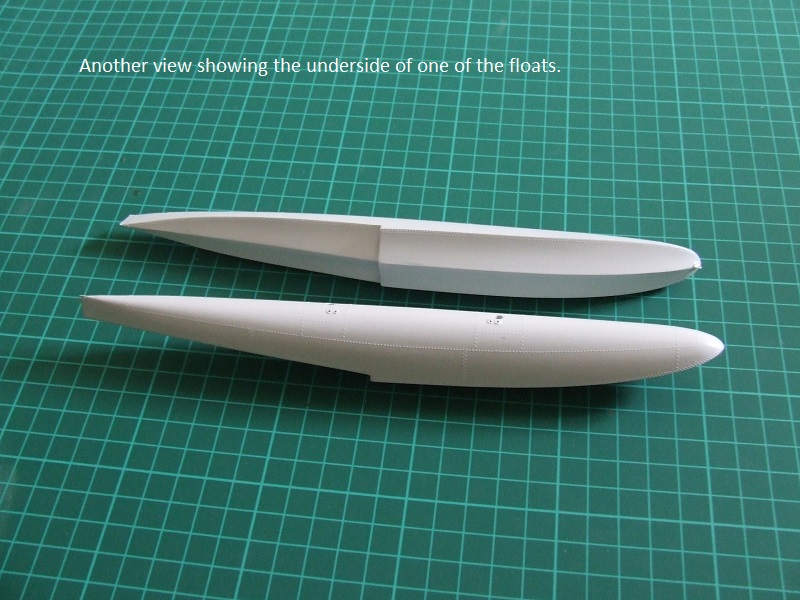

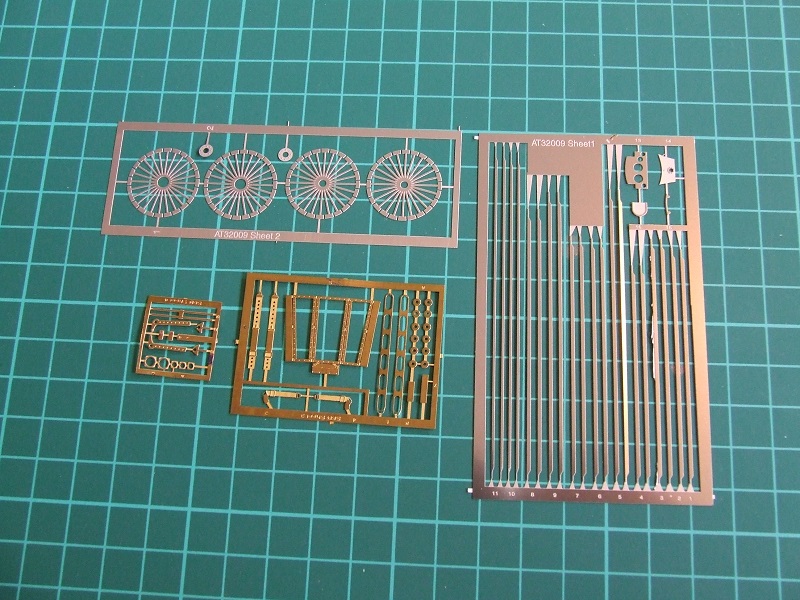

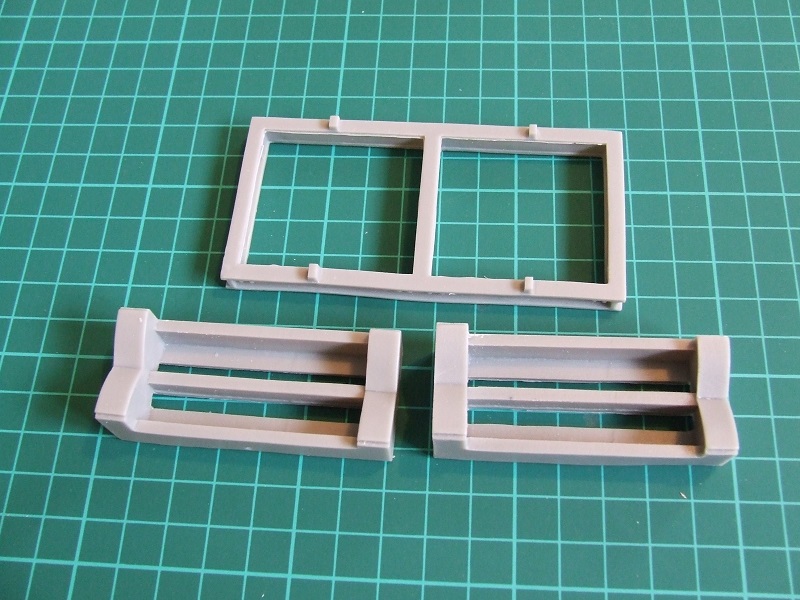

The kit consists of some beautifully cast and very finely detailed resin parts (the two floats are solid resin and very weighty) along with a good number of white metal parts, again beautifully cast plus some PE steel and PE brass sheets for the finer details. A beaching trolley is included. A nice sheet of decals is included, though on the real aircraft markings are minimal and most of them I will likely mask and spray anyway rather than use the kit decals. A basic but very nicely printed instruction sheet along with a colour and decal placement sheet is included, along with a 'Certificate of Authenticity' which gives a brief history of the Schneider Trophy events and a number for the Limited Edition (5/50)
I am itching to make a start on this so watch this space in the next week or two for my first update. I will of course be continuing with my other forum builds as well.
Photos below show the kit contents.

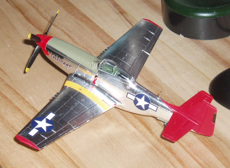

Looks like a great kit.
I'd be inclined to use chrome BMF to get the finish you want.
Here's my little Airfix Mustang - finished with BMF...

Hi Roy, thanks for looking in and your input, greatly appreciated. I see where you're coming from, but the foil is too chrome I think? The real aircraft sported a silver paint and was not bare metal finish, so I don't think foil would look correct. I have included a photo of the S.6B in the Solent Sky Museum where you can see it is more silver than chrome or baremetal? :
https://c8.alamy.com/com...e-solent-sky-C4EFF7.jpg
Nice model of the mustang by the way and you did a good job of the bare metal foil. I didn't think you made aircraft models, just cars - you should build more aircraft, they look good! Cool ThumpUp
I have previously built the same model as yours and posted it in the Finished Build Gallery back in 2015 when I was posting as 'Modelmania' - a great little kit! I used ordinary 'el cheapo' (very thin!) aluminium kitchen foil and 'Microscale Foil Adhesive'. You can find it here:

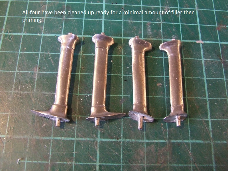

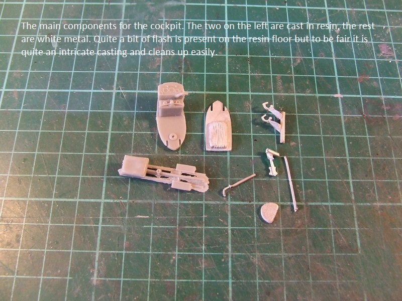

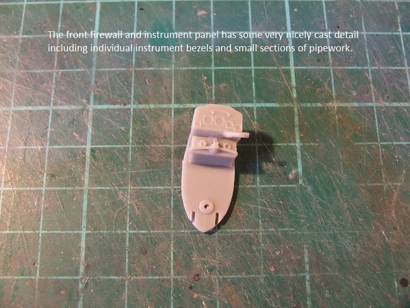

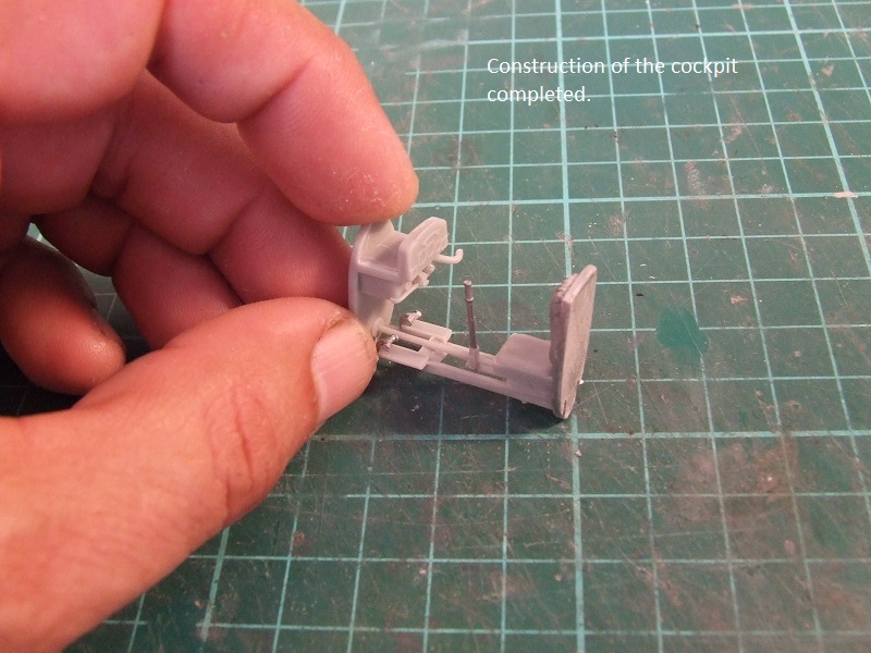

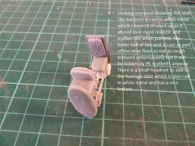

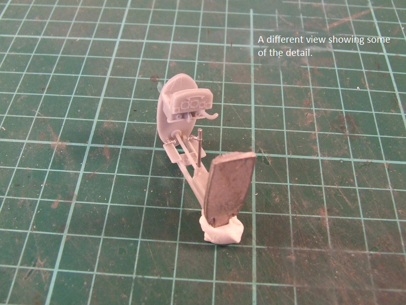

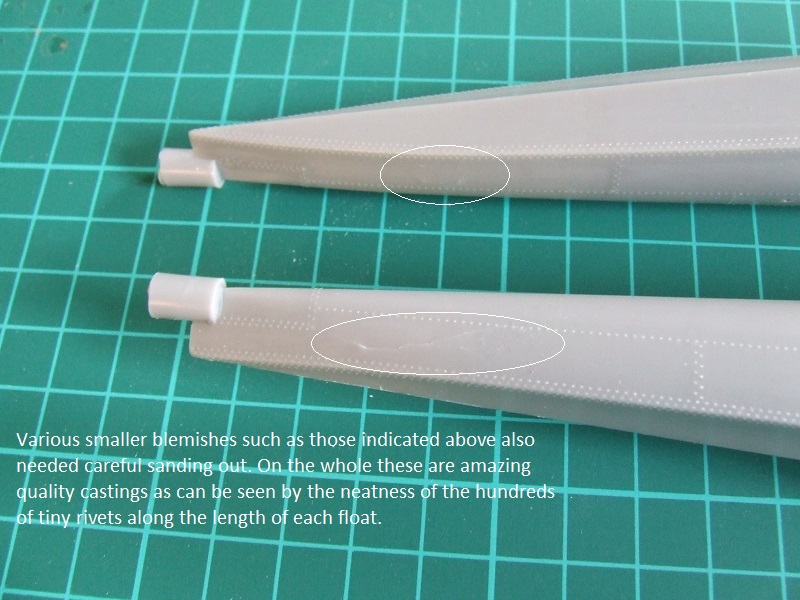

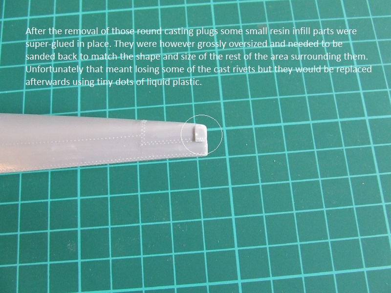

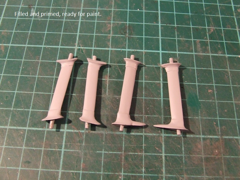

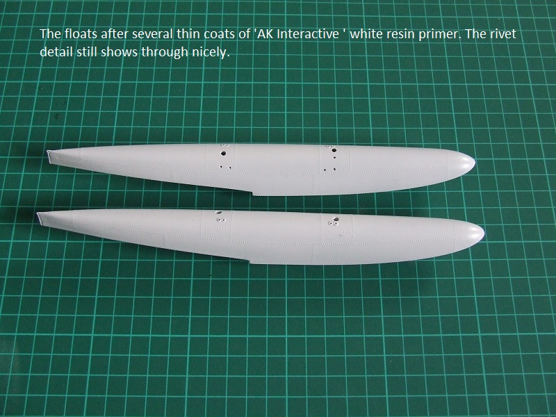

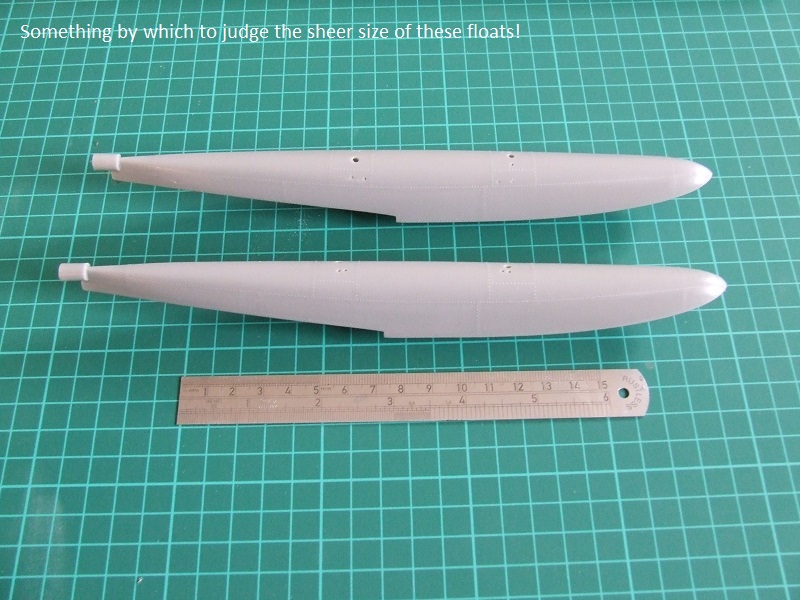

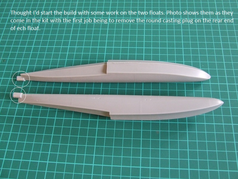

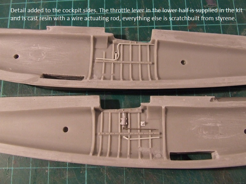

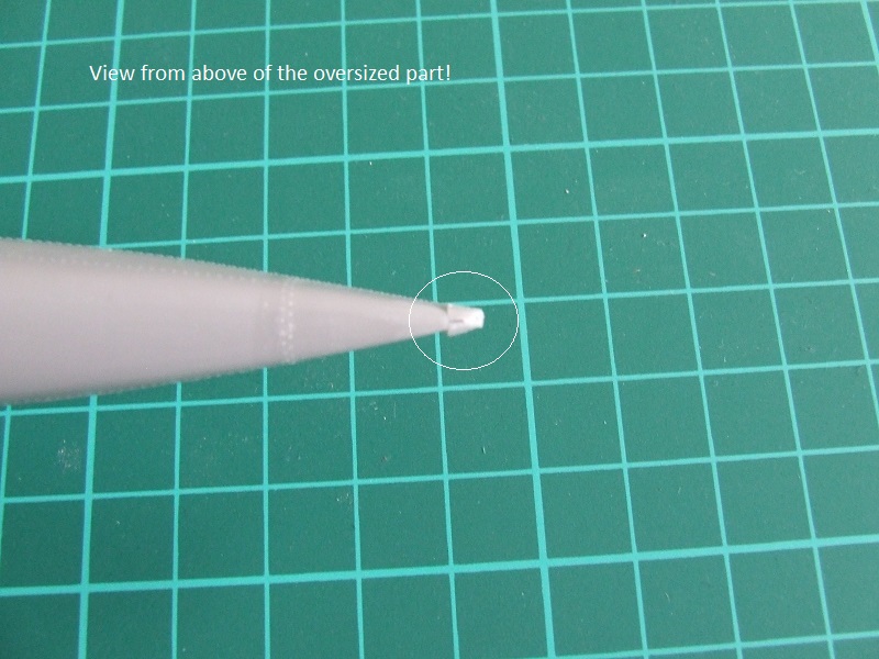

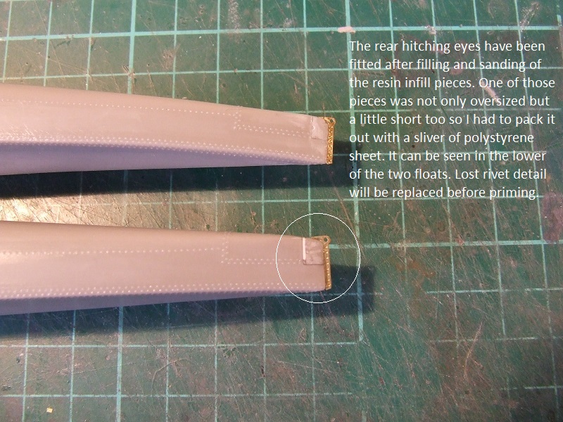

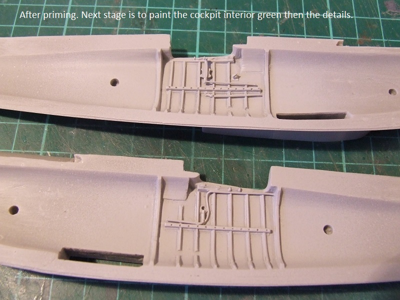

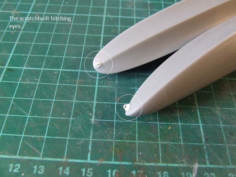

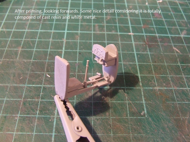

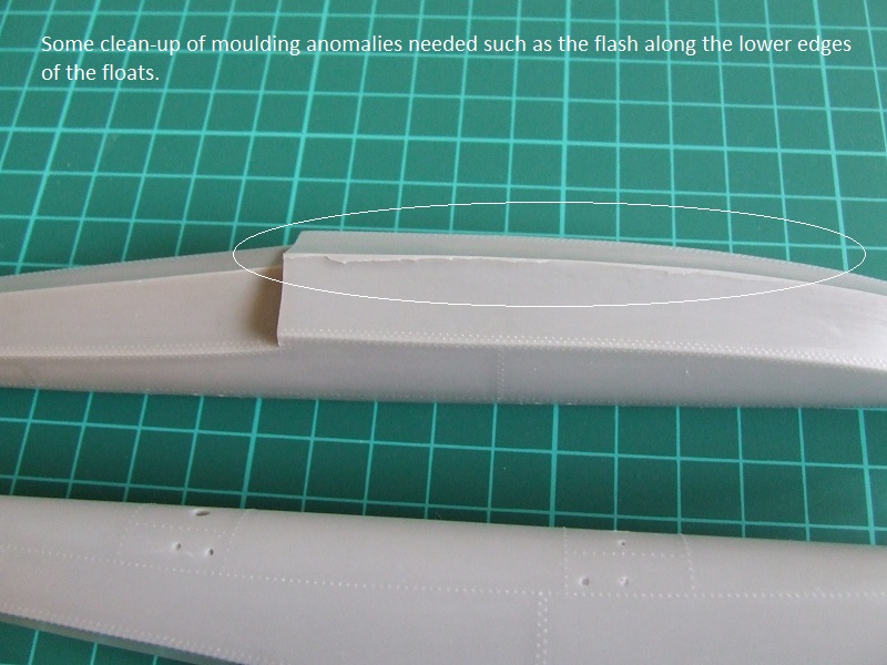

Hello all,
Time to make a start on this build, a bit later than I intended, and apologies to anyone who was waiting to see a start but work and life (mainly work!) just got in the way since I put up the opening post. This is turning out to be a lovely kit to build even though working in mostly resin and white metal has it's own challenges, but very much enjoyable - I intend to build more of these, they are great fun!
Photos will explain what has been done so far. Thanks for looking, all comments and criticisms welcomed. ThumpUp

BigGrin Nice start and looking good. I do like resin kits and have several in the stash to bring out in the futureCool
#12 Posted : 06 June 2019 17:27:45
Looks goods so far kev. I cant believe how thick those body parts are.I am amazed you dont have any warpage with those parts.probably going to be a heavy model once finished.

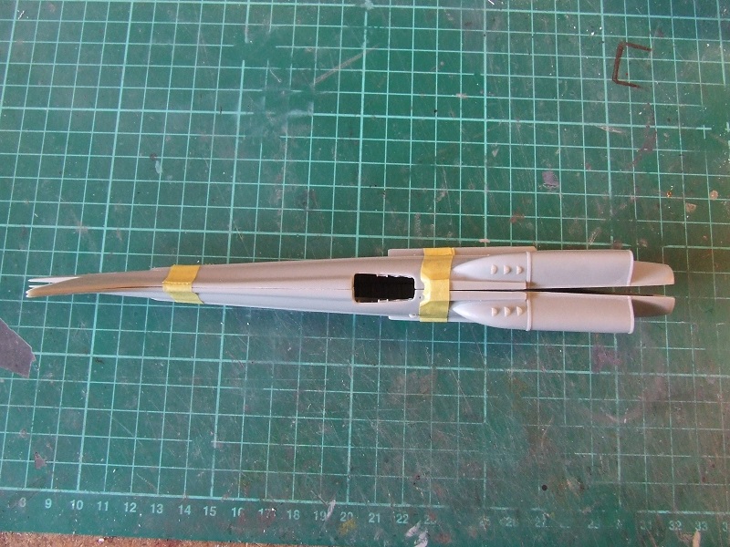

Thanks for looking in and your comments Carl, greatly appreciated as always. Cool ThumpUp
Actually, don't be too amazed as the fuselage halves DO have some warpage, I just haven't got to the stage of the build where I'd show it, but here's a preview just for you - time to get that hot water and clamps ready! Blink
It does have a nice weight to it too! ThumpUp

Those warps should come out quite nicely with the hot water method,all part of the fun and challenges of resin kits.

yeah that warp isnt bad at all.Really nice looking castings.Will be following this build
