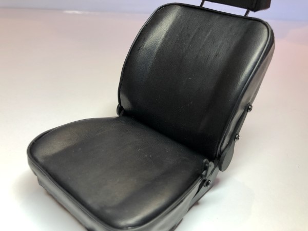

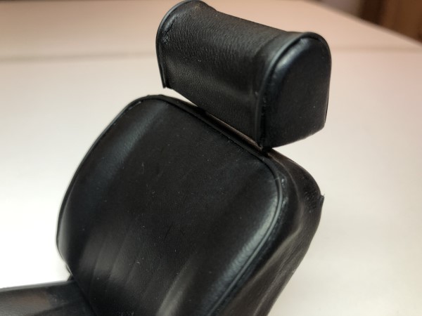

I have just started the Porsche build. I still haven’t got all the parts yet but thought I would make a start on it anyway. I want to try and put as much detail into this kit as I can, and I have got quite a few tips from various people on this forum who have already build this.

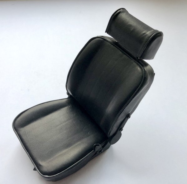

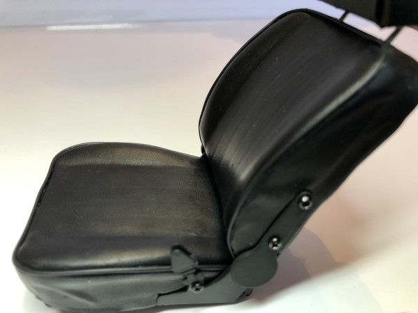

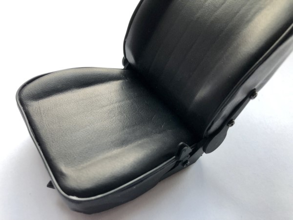

The first part was to upholster the seats with black leather. I bought some black goat skin hide, 0.45mm thick, this has a very soft yet strong qualities and ideal to fit over the existing seat parts. There was a lot of trial and error until I was happy with the result and thanks to Roy’s build for some references.
Once the leather was in place, I finished it with black trim. This was some very thin heat shrink tubing then heated gently and stretched out to make a fine thin and pliable strip to be placed around the edge.
Many thanks for looking, more soon.

Can see this is going to be a good one to follow Mark, count me in..... Excellent start with the seats.....Drool Drool
#3 Posted : 16 April 2019 08:17:23
Thank you Alan, hopefully the second seat should only take a fraction of the time now I know what to do. LolLOL
#4 Posted : 30 April 2019 18:55:08
Nicely done Mark, a great end result for your first effort with real leather, it actually looks like you've been doing that sort of thing for a very long time!
Well done and a neat trick with the shrink tubing too. Cool ThumpUp

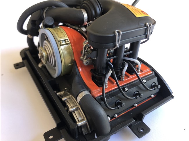

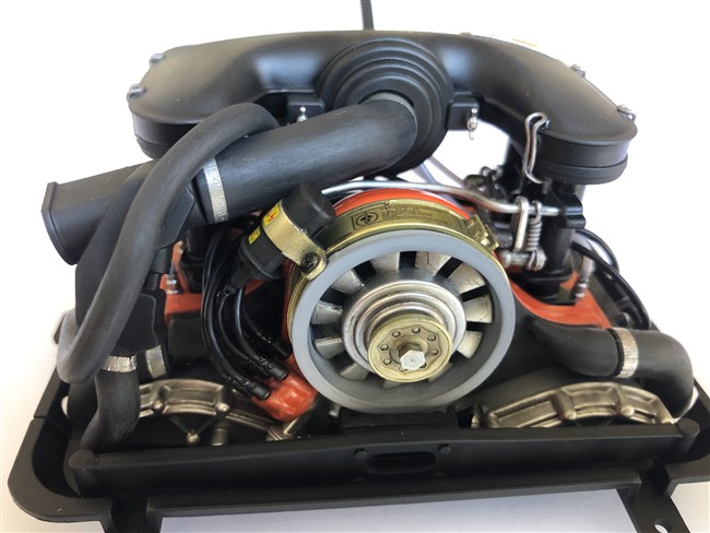

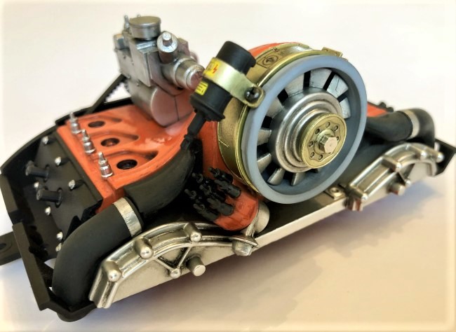

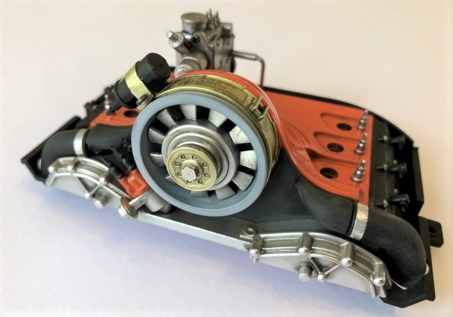

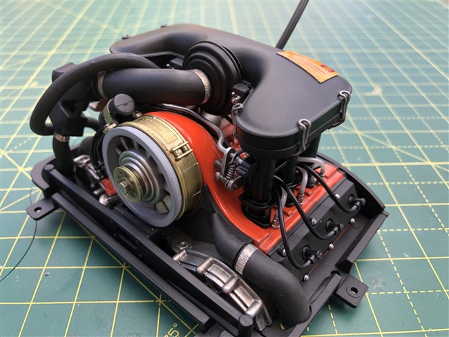

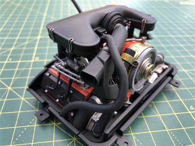

Just a small update. After experimenting with the leather seat, I now have enough parts to start this build. I have started on the engine assembly first, unfortunately I had a spark plug connector missing, but another one is in the post to me. It gives me a chance to file down and repaint the manifolds and throttle bodies. I have sanded down the hoses, taking off the seam line and to give them a more natural look. I have also added hose clips using aluminium foil.
More soon.

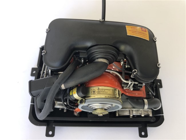

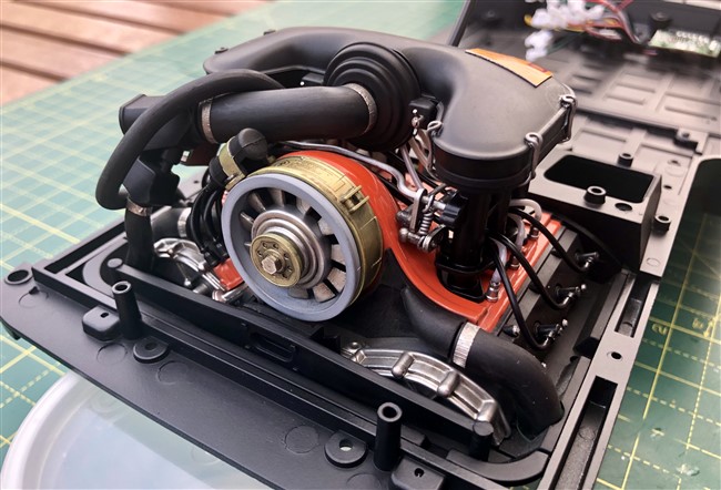

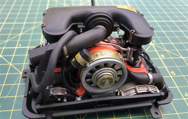

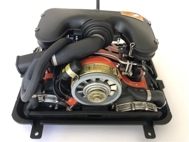

#8 Posted : 30 June 2019 17:19:29
Almost finished the engine, just some electrical wiring to add. Thanks to Roy and Richie, took a few tips on some more detail to it and it makes all the difference although some of it is quite fiddly.
That’s it for now, more soon. Thanks for looking.

Very impressive Mark, certainly looking the biz.....Cool Cool Cool Cool
#14 Posted : 01 July 2019 09:59:51
Fantastic work on that engine Mark, it looks super realistic and almost like it would actually run!
Blimey, that's good! Very well done Mark, great job. DroolThumpUp

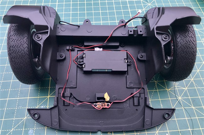

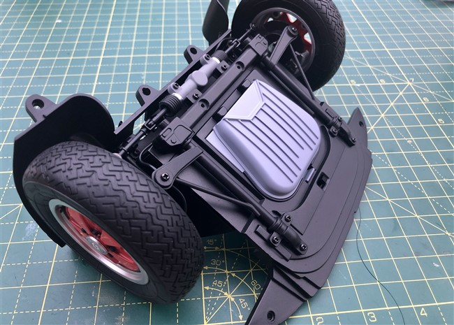

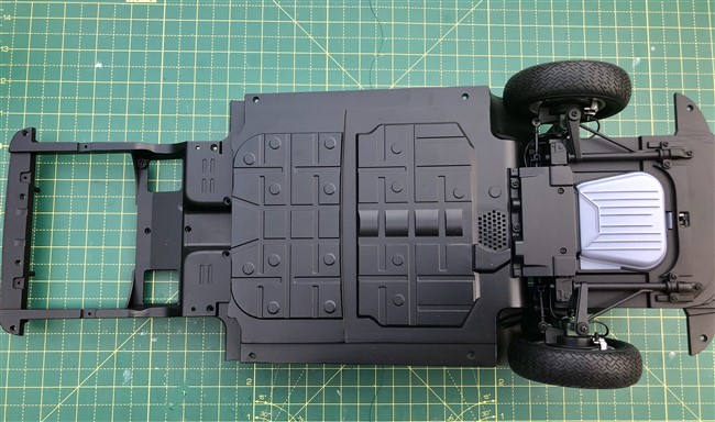

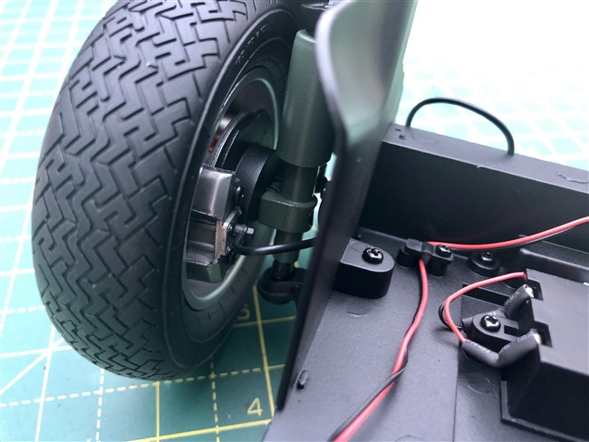

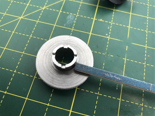

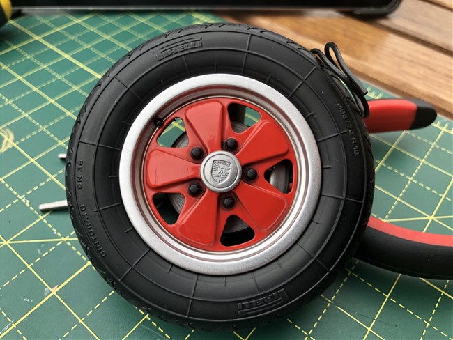

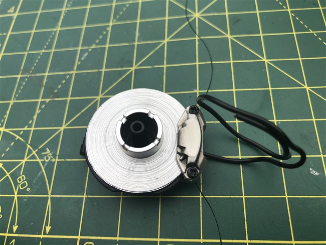

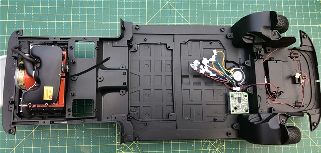

Back to the Porsche build. I have started to build the body parts and front suspension. As you can see in the first couple of pictures, I used a thin sanding stick and rotated it on the wheel disk giving a scraped effect simulating a real brake disk. A little subtle oiling was then added to certain parts. These were then polished off creating shadow and highlighted areas.
The rest of the bottom frame was assembled, and the engine inserted as instructed.
More very soon. Thanks for looking.
