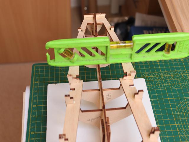

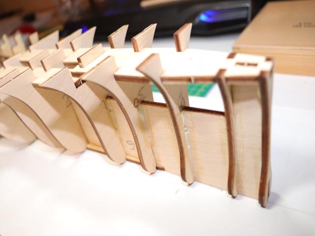

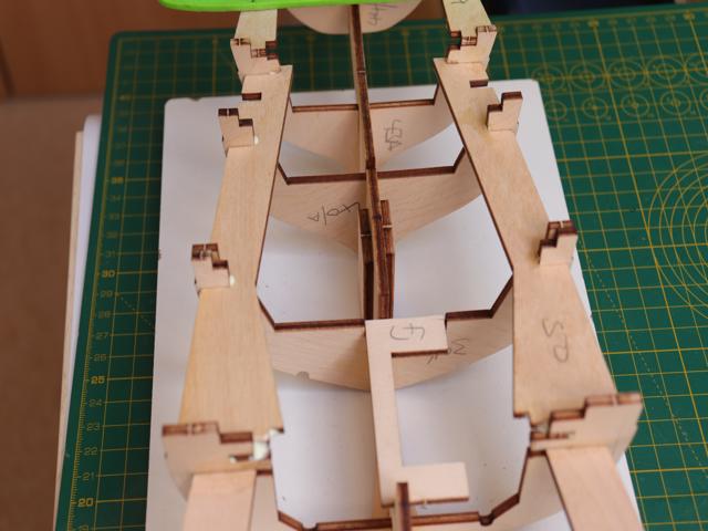

After exchanging funds, the kit has duly arrived, and i must say i'm very impressed! Hardly any warpage (although the first part of the keel base needed a quick steam iron-but not a lot), and the parts go together like a dream - so far BigGrin.

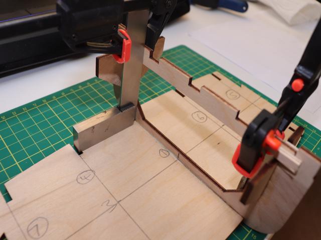

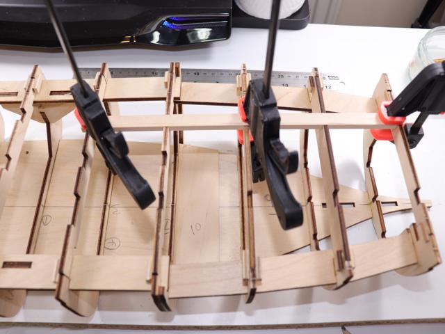

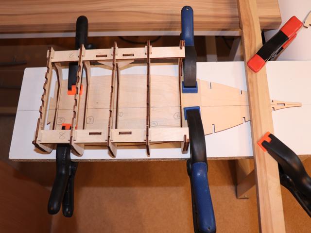

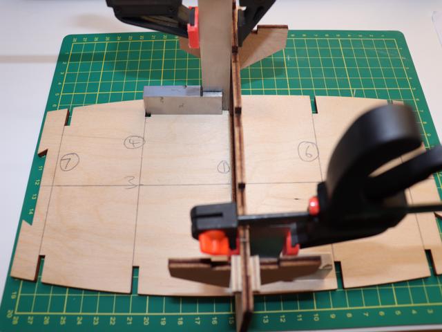

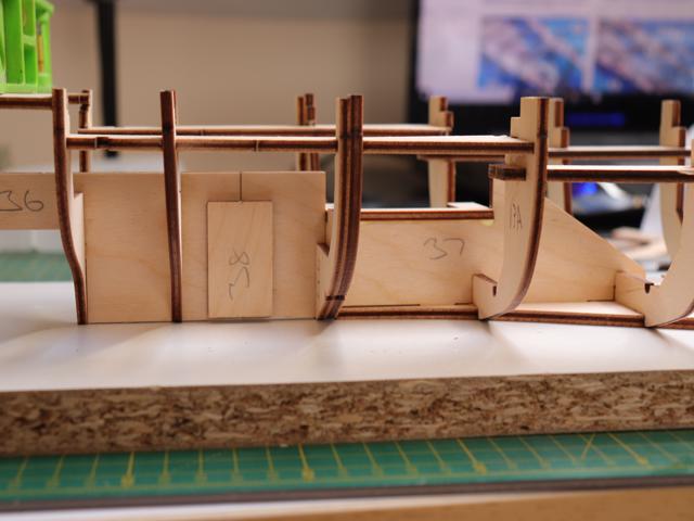

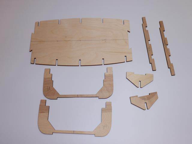

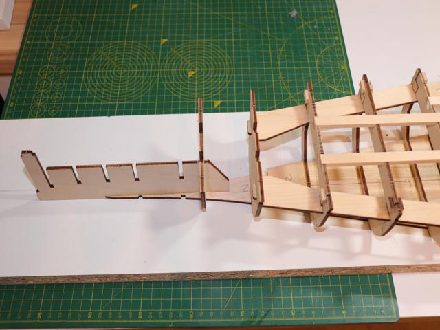

The shots below show the assembly of the first 6 stages ( out of 140). I decided to fix it to a build board,just on the off chance and to keep everything as straight as possible. I made some locating guides for the cross beams out of scrap wood, again to aid alignment.
I also ordered 'Anatomy of the Ship - The battleship Bismarck' by Stephan Draminski - an unbelievable source of photos and material, highly recommended for any builder of this ship whoever the manufacturer.
Amati, who produced this kit for both Hatchette and Modelspace, kindly provided a very good build diary (which is where I copied the cross beam tip from), although much speeded up Laugh
So here are the photos of my progress so far.
#2 Posted : 28 March 2019 06:41:51

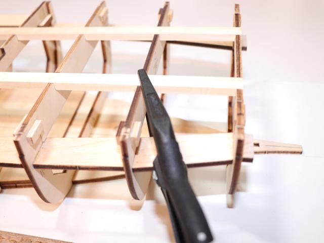

BigGrin Nice start and have fun with her, be careful with the stern area as its easy to put a bend in the hull hereCool

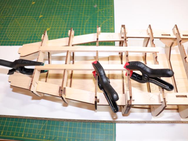

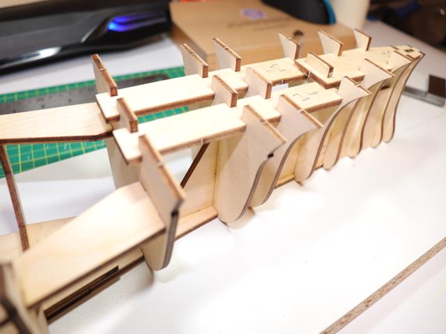

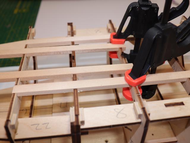

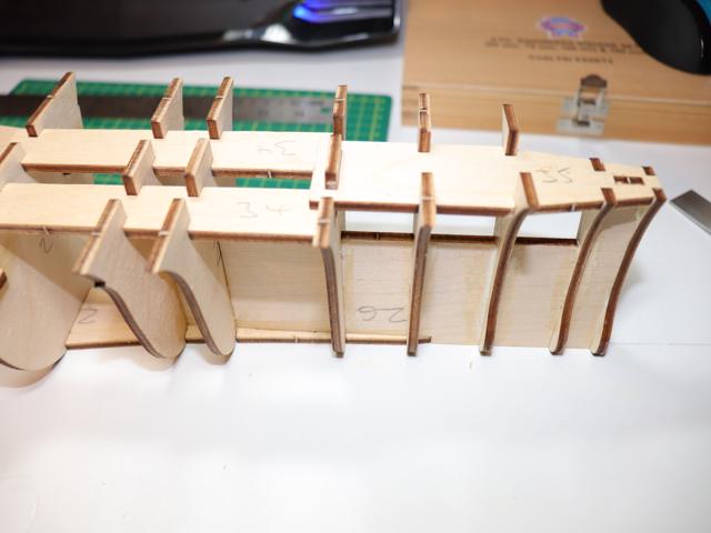

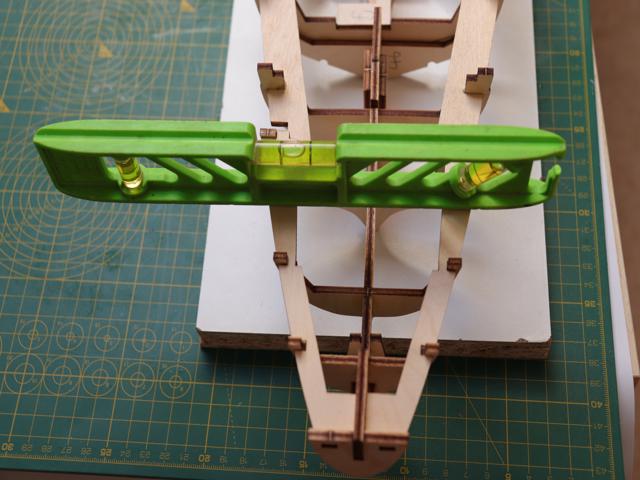

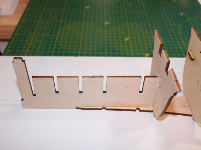

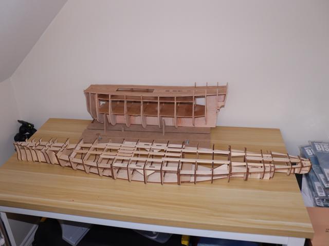

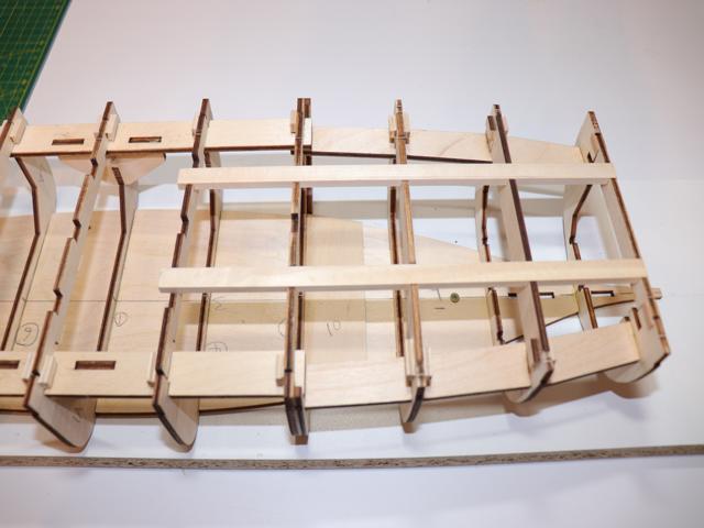

Here are stages 7 to 10. I have to say i was a little worried with the stern, as she seemed to be developing a small warp. However, pleased to see once the strengtheners were added, she straightened up a treat ThumpUp.
The locating lugs for the deck supports have now been removed and getting ready for the next stage: planking Scared.
The last photo shows the shear size of this thing, alongside my Trinny! She's gunna be a big'un Woot
