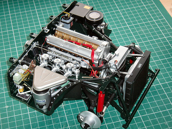

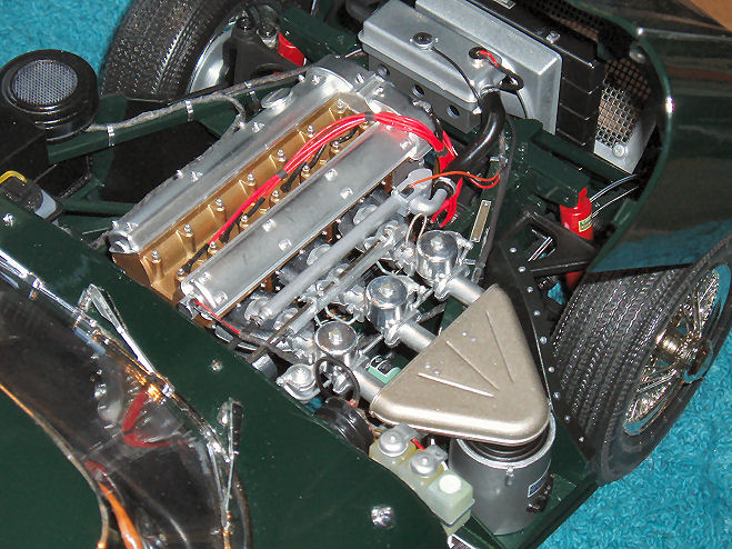

I can't imagine what the problem might be.
I painted all my parts and had no problems.
Try running a very fine drill bit down inside each plug hole on the engine, and the same on the distributor.
I did actually make my own leads, but I still used the kit 'plug cap' ends.
They went in with no bother.
Roy.
Roy.
