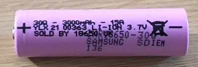

I recently completed the R2-D2 build and have tried two different sets of batteries, but he won't fully power up and I haven't been able to use him yet.
With both sets of batteries, the same results: I've fully charged the batteries and turned him on. He jerks forward slightly and his main red light stays on, indicating less than 20% power I think. I can connect to him on the app but it says bettery level 0%. If I try to operate him, he beeps out in protest and nothing else happens.
I opened him up and can't see any obvious loose wires. Any ideas what I can try next please? I'll try to add a picture of one of the batteries, but this is my first post here.
Thanks.

Hi could you provide a link to the batterys you bought and also if you have a test meter what is the power reading from the battery box.

Here's the link where I bought the batteries:
https://18650.uk/product/samsung-30q-button-top/
The battery charger showed 4.20
#4 Posted : 09 February 2019 17:01:18
Batterys look fine but we need to check your battery box is working next . Borrow a test meter if you can and find out what voltage your getting from the leed that plugs into the MSU.
