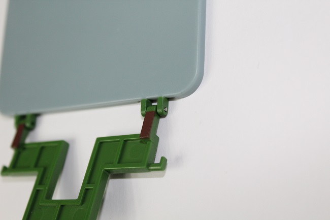

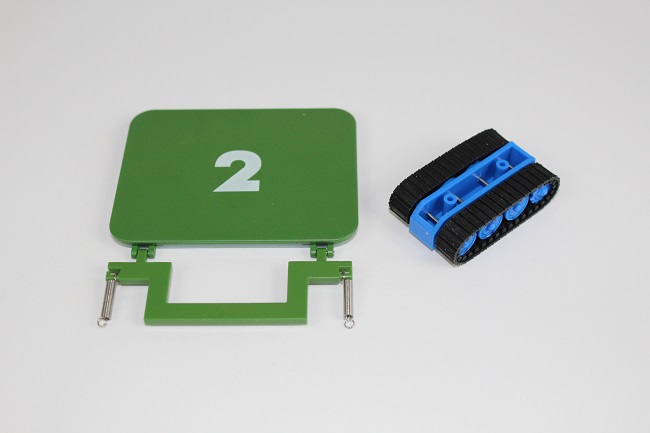

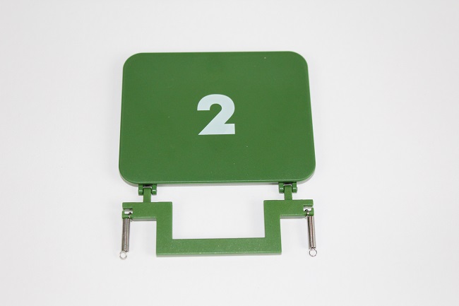

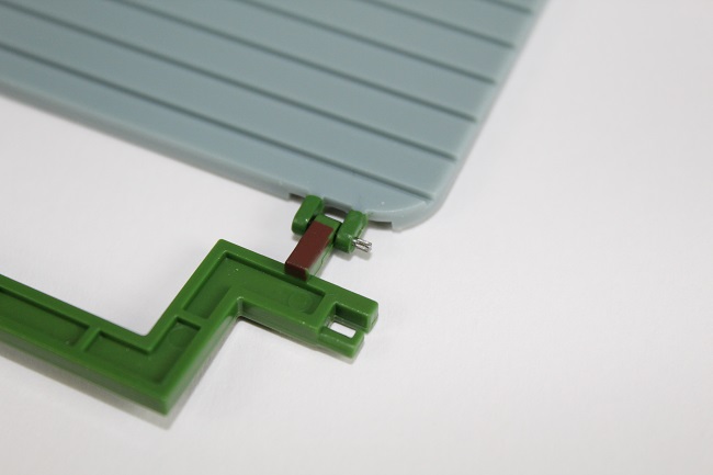

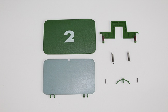

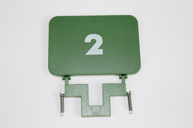

Stage 81
Pod 2
Parts supplied:

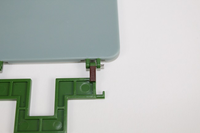

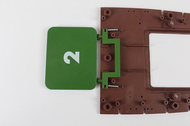

Front hatch, Front hatch inner, Hatch stay, Stopper, Springs x2, Hinge pins x2.
Fit the stay to the front hatch inner and use the tweezers to fit a hinge pin, inserting it from the outside and with the ribbed tip left exposed then push the pin fully in. Use the back of the tweezers if necessary and then repeat the steps for the other pin.
Next fit the stopper into the recess in the inner hatch with its tip seated in the notch. Then using superglue fix the front hatch to the inner hatch, via the locating lugs.
Finally place the loop at the end of a spring onto the hook at each side of the hatch stay.

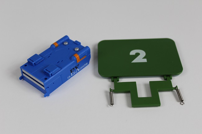

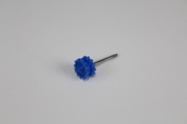

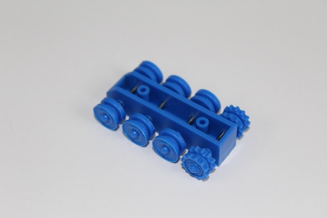

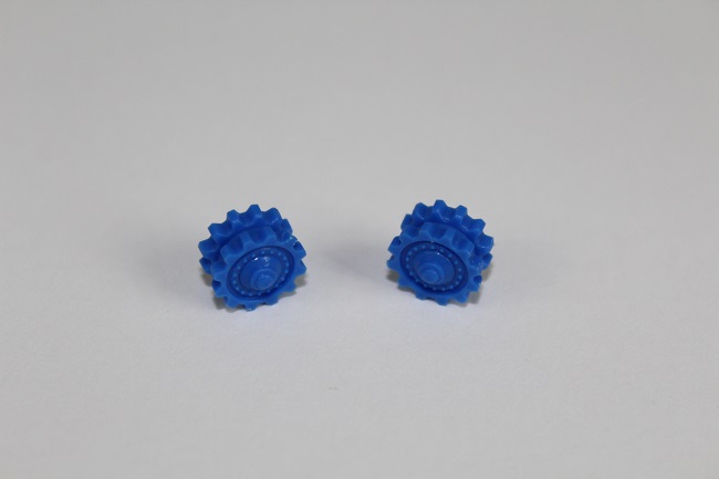

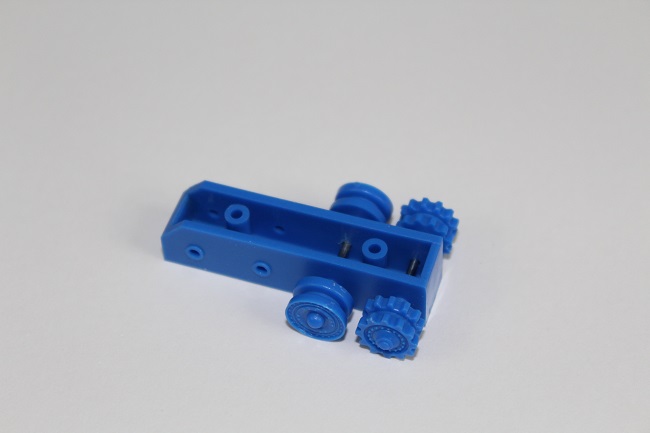

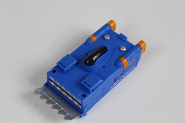

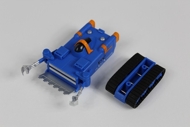

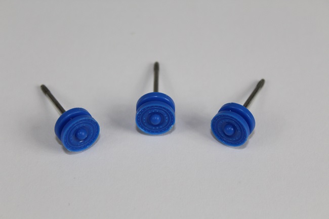

Excavator

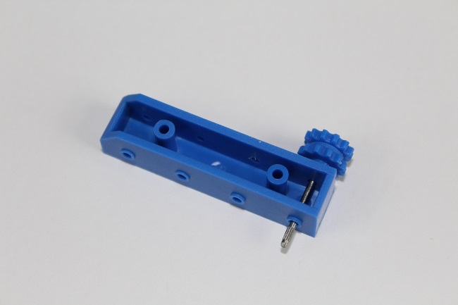

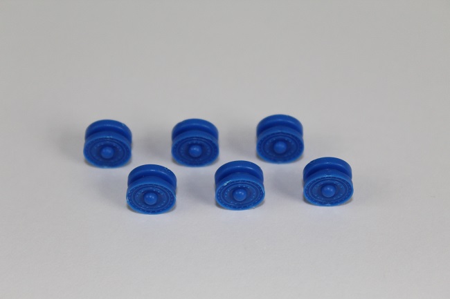

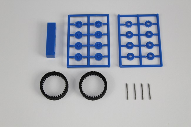

Parts supplied:

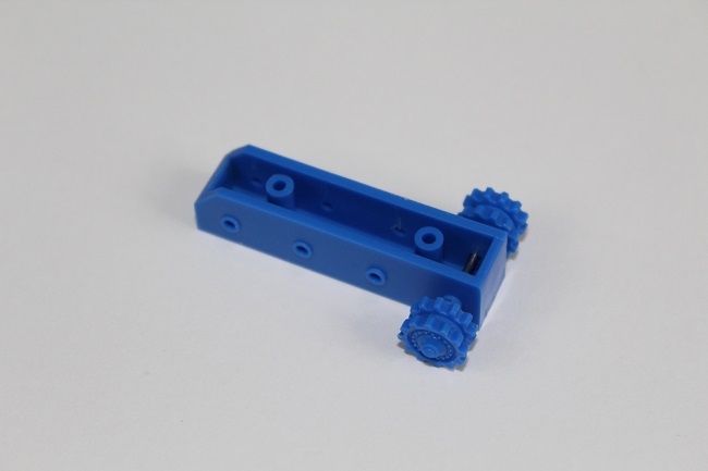

Chassis, Wheels A (fret), Wheels B (fret), Tracks x2, Axles x4.

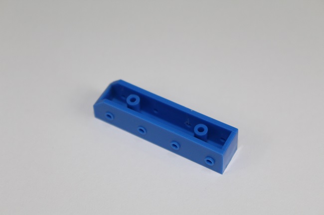

Separate the drive wheels A and B from the fret and glue them together making two drive wheels. Then do the same for the wheels A and B making six wheels.
Fit an axle into one of the drive wheel sets and the other three axles into a wheel set. Now checking the orientation of the chassis fit the drive wheel/axle through the rearmost holes in the chassis sides. Then fit the remaining drive wheel set to complete the drive axle.
Pass one of the wheel axles through the next hole in the chassis and press another wheel set onto the end of the axle. Now repeat for the remaining axles and wheels. Finally fit the two tracks over the wheels.

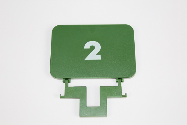

#3 Posted : 06 February 2019 19:59:55
Stage 82

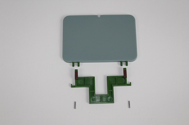

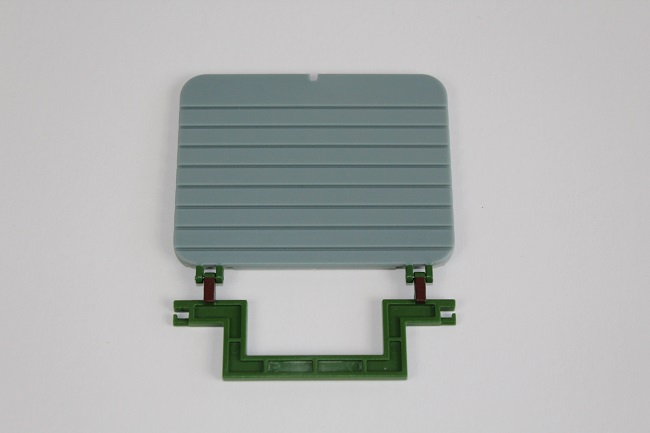

Pod 2
Parts supplied:

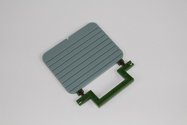

Rear hatch, Rear hatch inner, Hatch stay, Stopper, Springs x2, Hinge pins x2.
Fit the hatch stay to the rear hatch inner in the same way that you fitted the front hatch and fit the first pin leaving the ribbed tip out. Now press the tip into place and repeat for the other pin.
Next fit the stopper and glue the main rear hatch panel to the inner face as you did before. Finally, fit both of the springs onto the hooks of the stay.

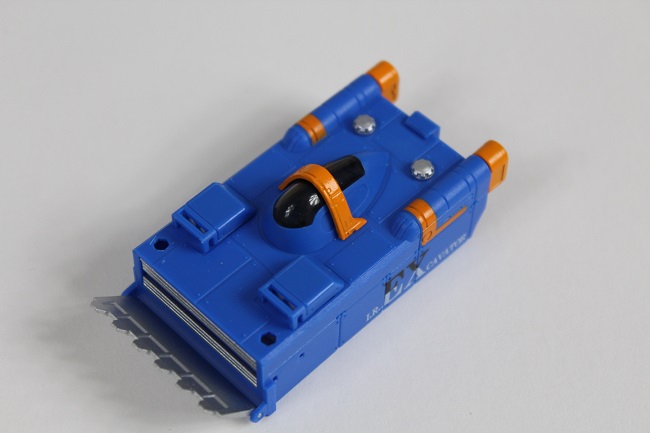

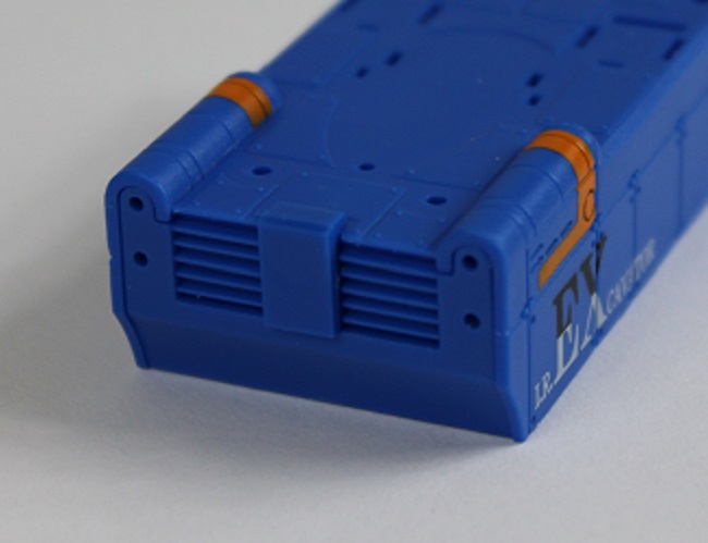

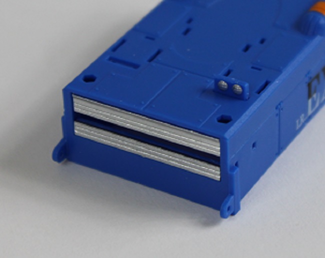

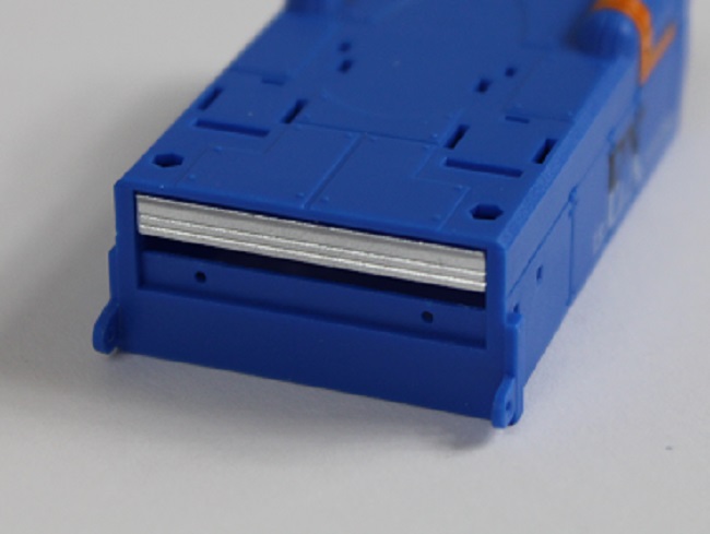

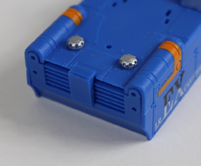

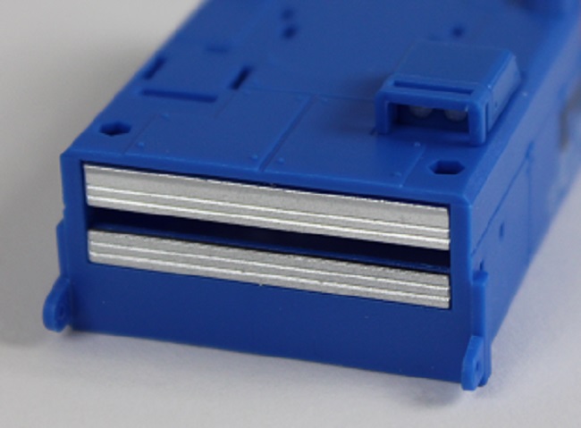

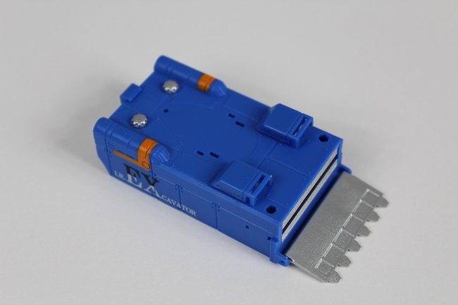

Excavator
Parts supplied:
Main body, Headlights x2, Headlight covers x2, Shutter A, Shutter B, Rear Panel, Detail A, Detail B x2.
Glue the pins on the reverse of shutter A into the holes in the front of the main body, making sure you have it in the correct orientation and then glue shutter B to the front of the body below shutter A.
Next insert the rear panel into the opening in the rear of the main body, carefully checking its orientation and then glue detail A into the holes in the centre of the rear panel, also checking its orientation.
Glue one of the headlights in place on top of the body and glue the headlight cover over the headlight into its slots in the body and repeat these steps on the other side of the body.
Finally fit the two detail B parts into the holes in the top of the main body at the rear.

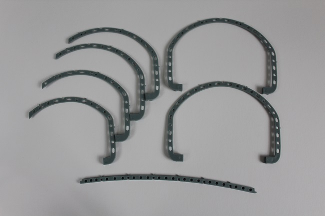

Stage 83

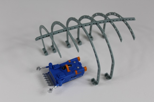

Pod 2

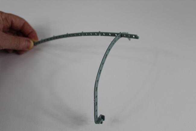

Parts supplied:
Frames 1 to 7
Note: this is a test fit only for the frames of pod 2 and that frames 1 - 6 have their numbers stamped on them.
Having checked the orientation of frame 7, insert the top of frame 1 into the first slot in the front of frame 7. Now repeat this process and fit frames 2 - 6 into frame 7 working from frame 1 towards the rear of the pod.

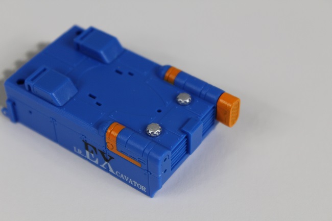

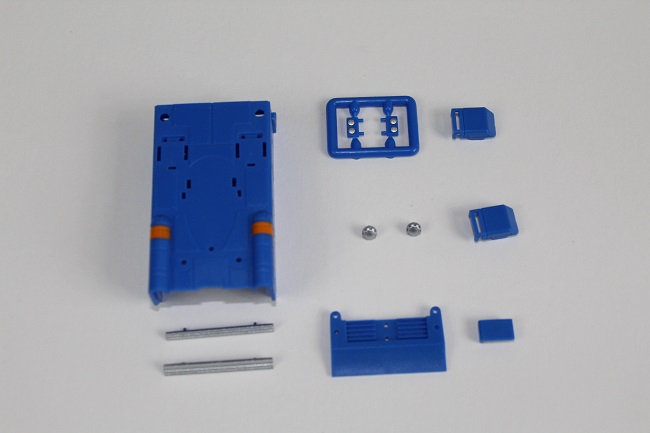

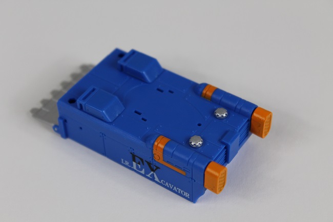

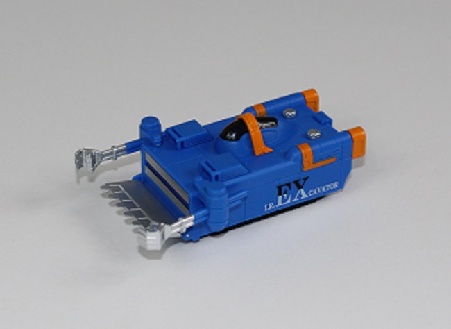

Excavator

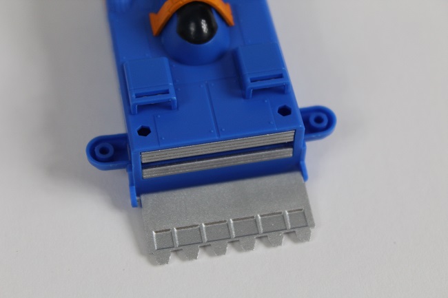

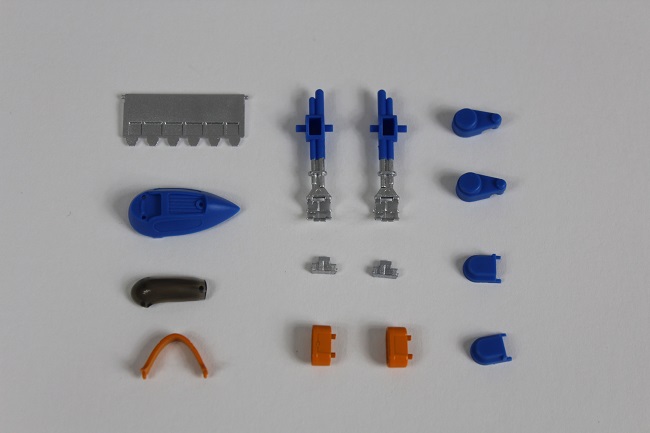

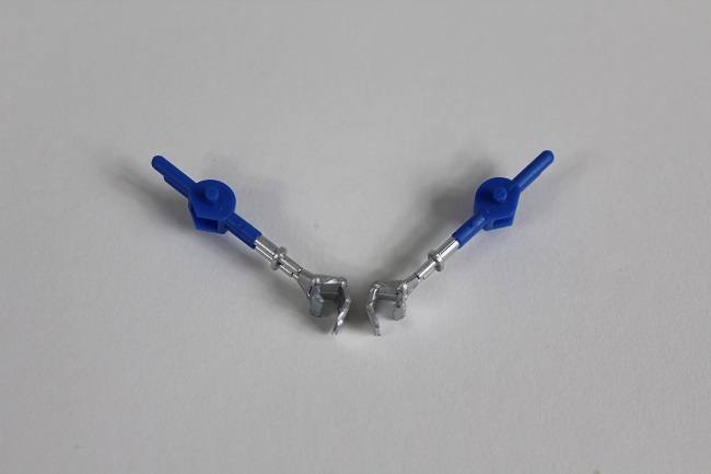

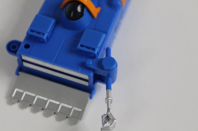

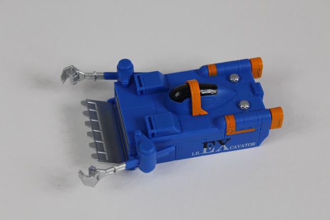

Parts supplied:

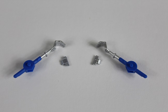

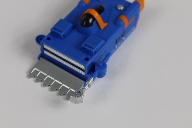

Canopy, Cockpit, Roll bar, Scoop, Nozzles x2, Arm L, Arm R, Claws x2, Arm joint L, Arm joint R, Arm mount L, Arm mount R.
Insert the pin on one side of the scoop into the hole at the front of the body, then carefully insert the other pin into the other hole and check that the scoop can rotate.
Insert the two pins on a nozzle into the two holes in the rear of the body and then fit the second nozzle to the other side of the body. Next insert the three pins on the underside of the canopy into the corresponding holes in the cockpit and then insert the pins on the underside of the cockpit into the three corresponding holes in the body. Now insert the pins of the roll bar into the holes on either side of the cockpit.
Noting that the frontmost pins of the arm mounts L and R are thicker than the rearmost, fit arm mount L to the left side of the body and arm mount R to the right side of the body. Now insert one of the claws into the rectangular hole in arm L and the second claw to arm R.
Fit the pin on the underside of arm L into the hole in mount L and then fit arm joint L onto the left side of the body and the left arm. Now repeat this operation for the R arm and joint.
Finally insert the two posts in the centre of the chassis into the two holes in the underside of the body, then check that the arms and scoop can move. The Excavator is now complete.

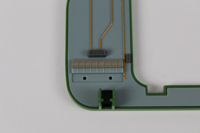

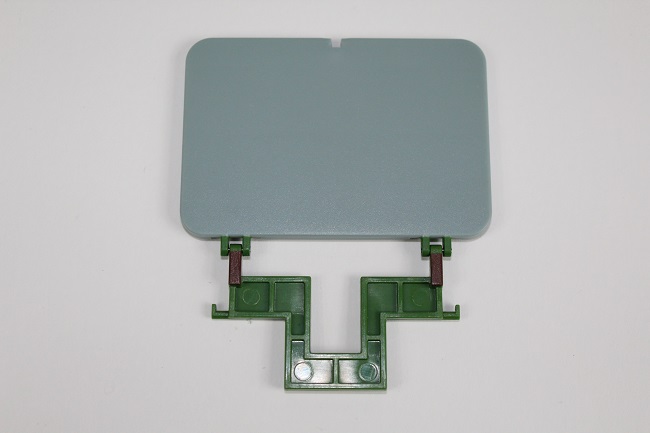

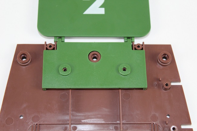

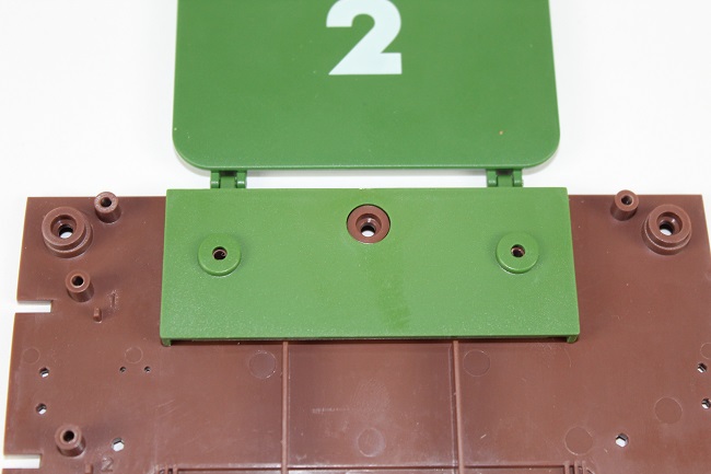

#5 Posted : 06 February 2019 22:49:29

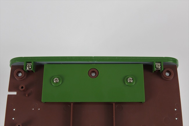

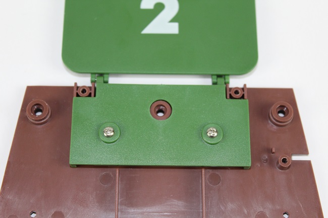

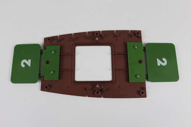

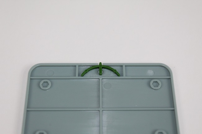

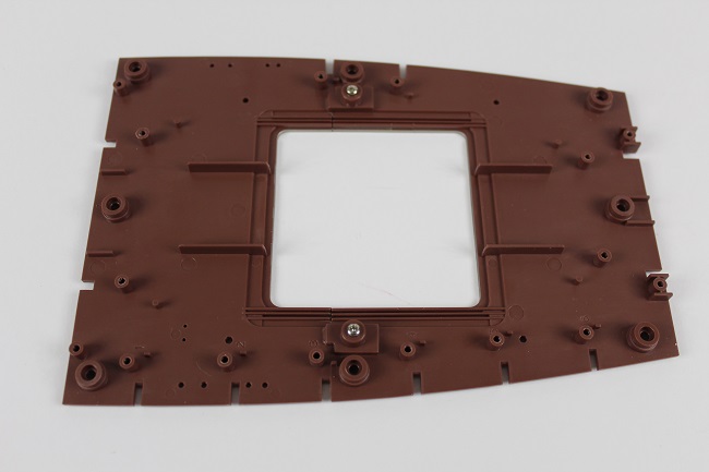

Stage 84

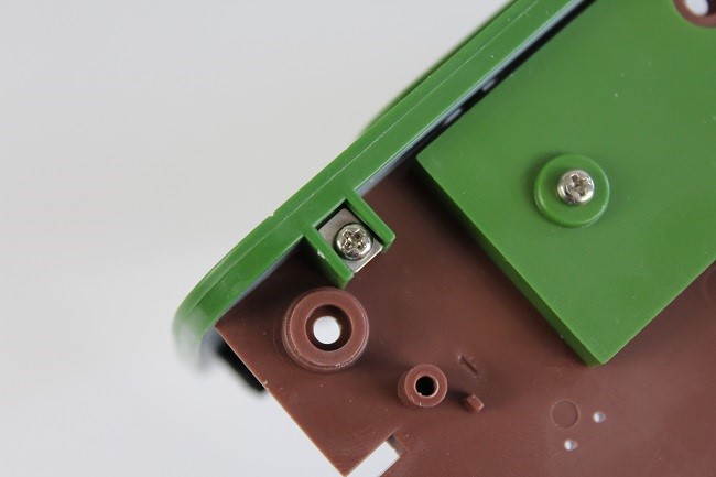

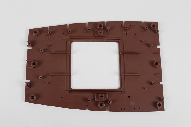

Pod 2

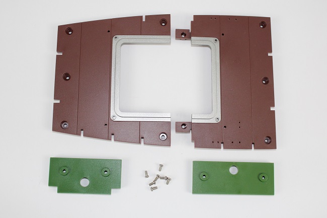

Parts supplied:

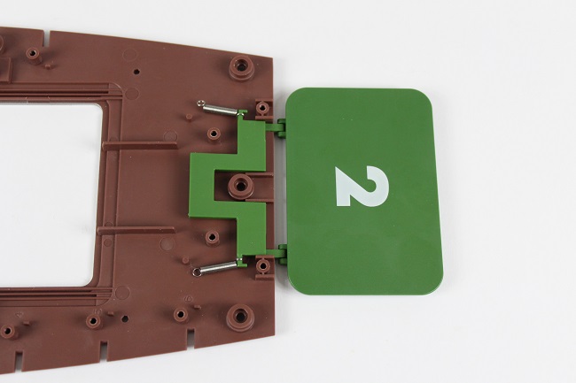

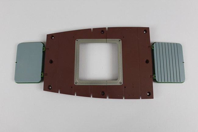

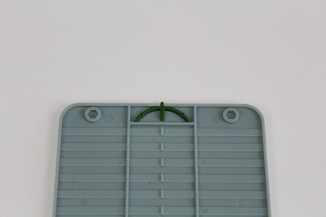

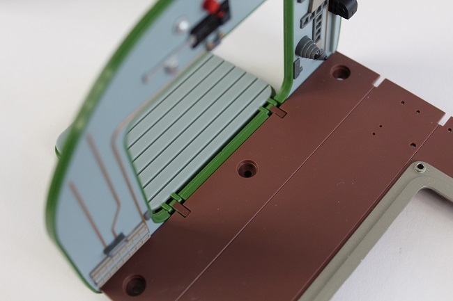

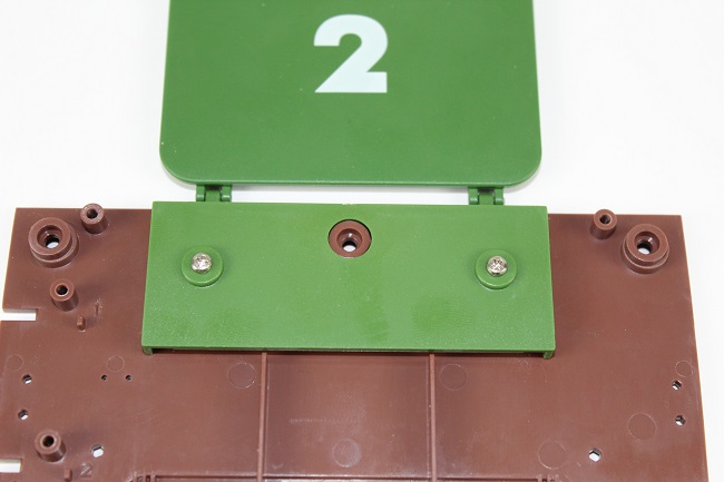

Floor A, Floor B, Front hatch mount, Rear hatch mount, Screws x9.

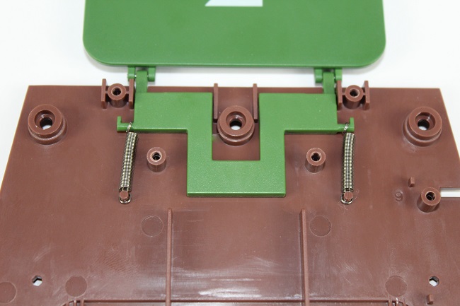

Insert the posts on the underside of floor B into the holes in floor A and fix the parts together with two of the provided screws.

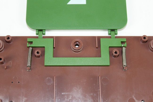

Fit the front hatch assembly onto the underside of the floor’s front end via its stay, making sure the hinges are flush to the floor’s edge. Now, holding the hatch in position use tweezers to pull both springs over the pins just behind them. Then place the front hatch mount over the stay making sure the springs remain in place and secure it with two of the supplied screws.
Now fit the rear hatch via its stay to the underside of the floor, checking that the hinges are flush and fit the springs over the pins in the same way as those of the front hatch. Ensuring the springs stay in position fit the rear hatch mount and secure it using two more screws.
The front and rear hatches have now been fitted to the pod floor.

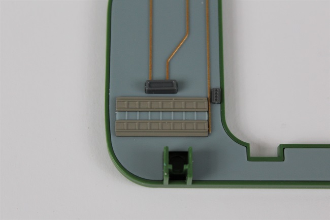

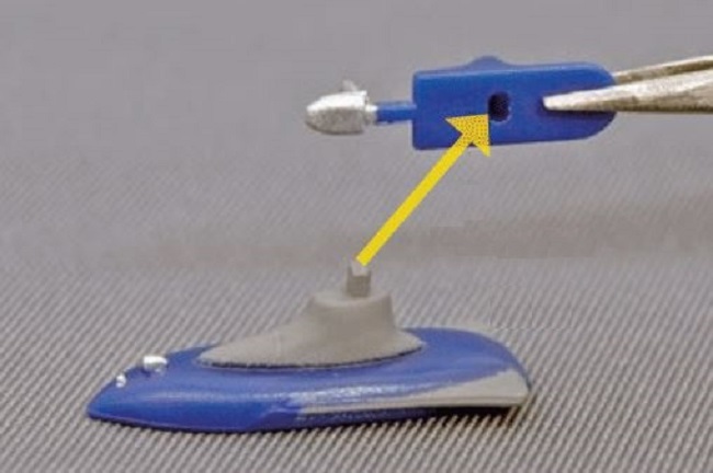

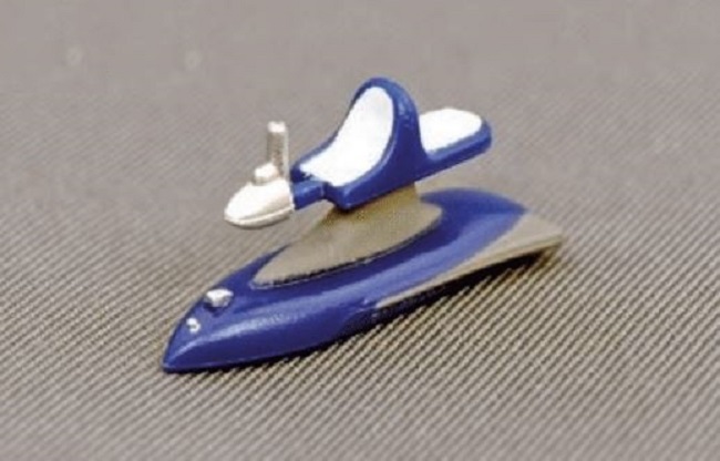

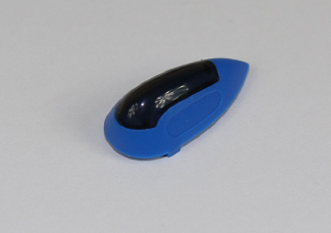

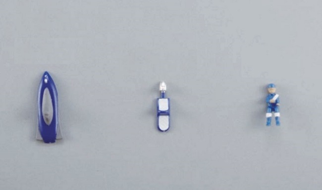

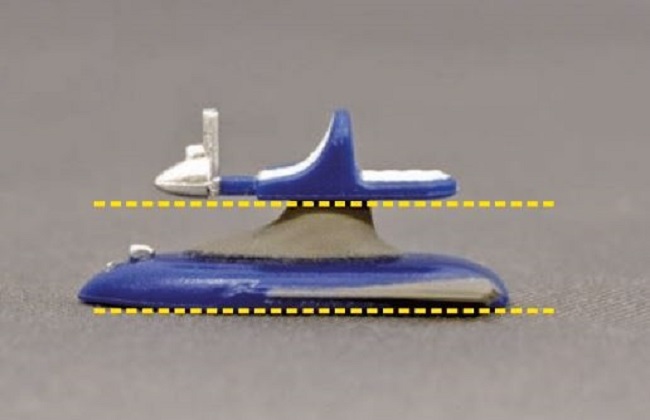

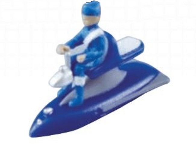

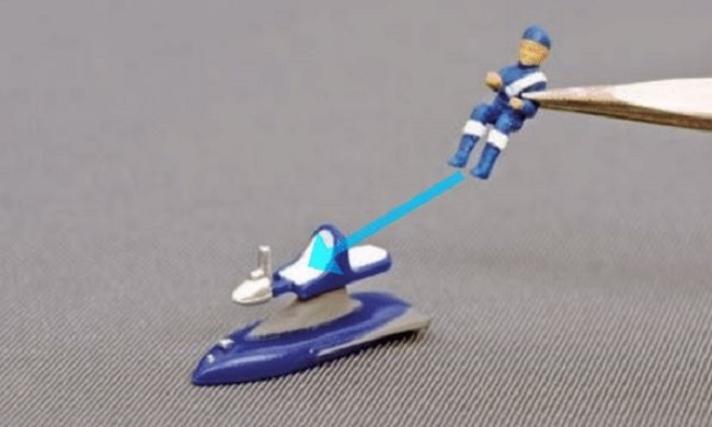

Hoverbike
Parts supplied:
Main body, Seat, Alan Tracy.
Glue the seat to the main body checking that the parts remain parallel to each other.
Alan Tracy will sit on the model’s seat.

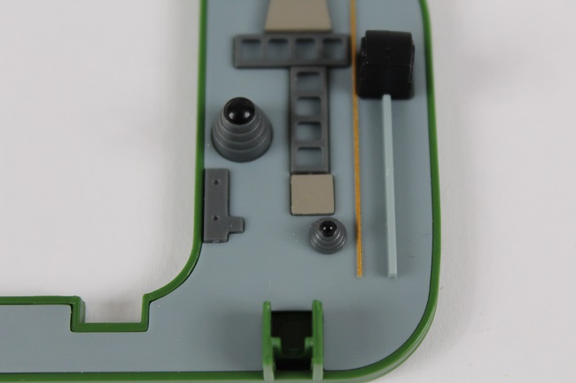

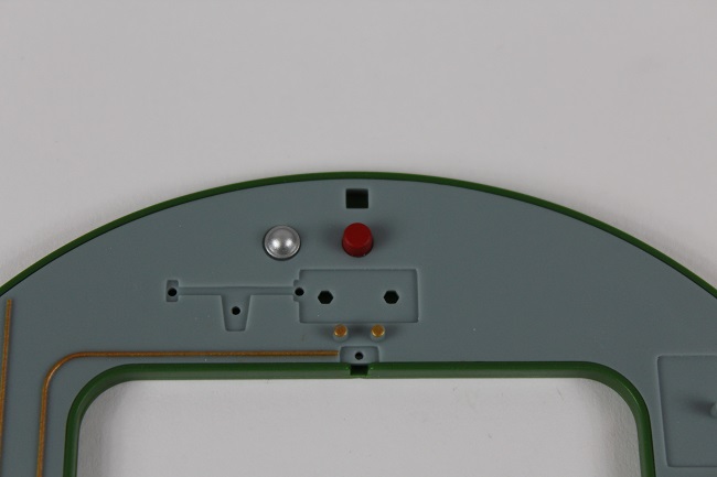

#6 Posted : 06 February 2019 23:07:07

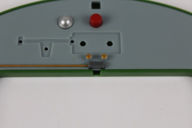

Stage 85

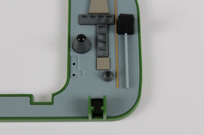

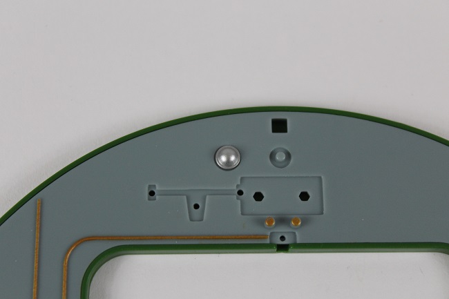

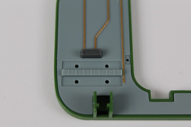

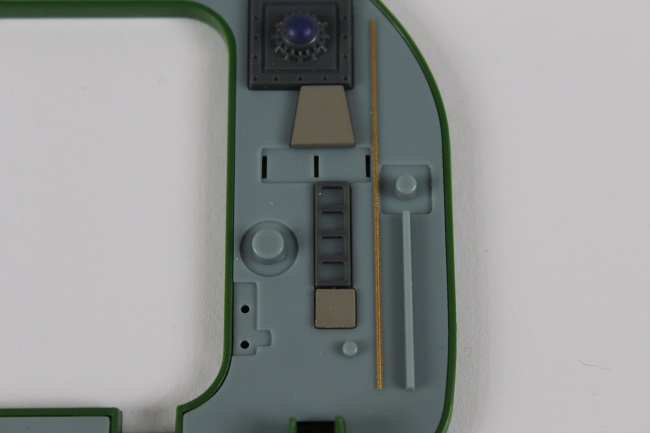

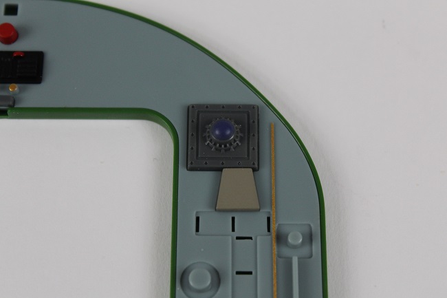

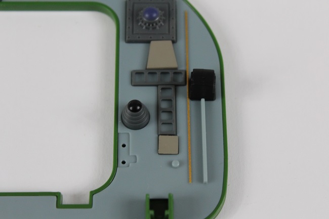

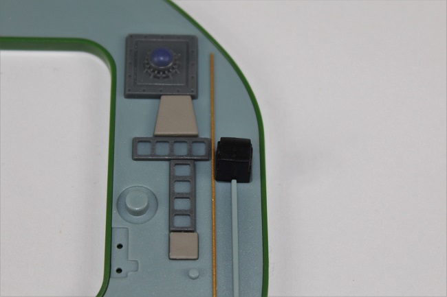

Pod 2 Front Panel

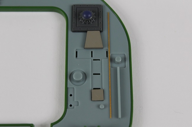

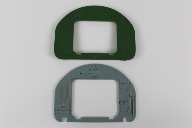

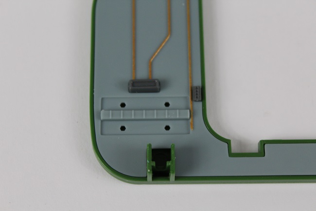

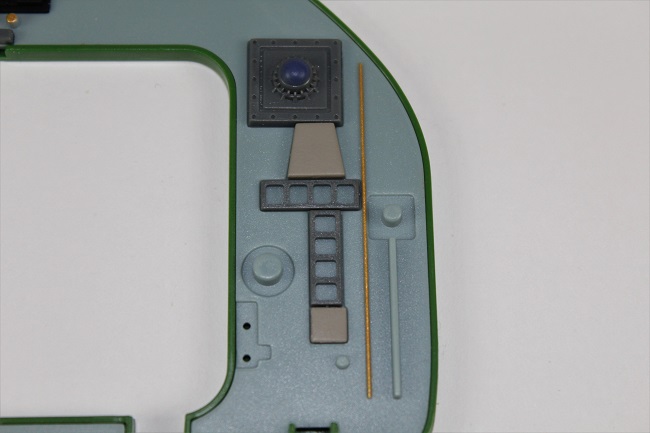

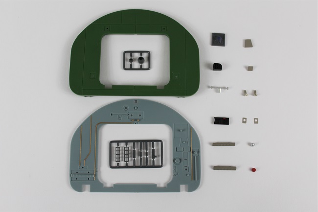

Parts Supplied:

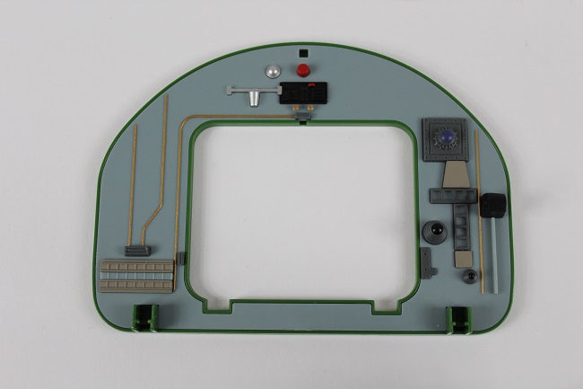

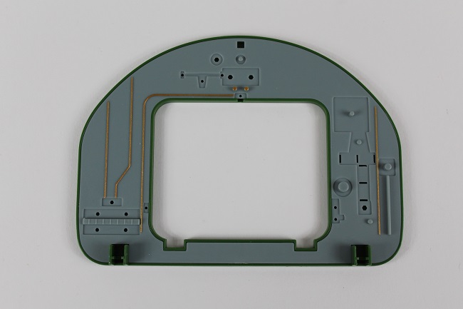

Front panel (inner/outer), Details 1(X2) and details 2- 5 on a fret, Details 6 and 7 on a fret, Details 8 - 17, Screws (X2), Washers (X2).
The inner and outer parts of the front panel are supplied temporarily fastened to each other. Separate them, add some glue to the fixing points and then reattach them, holding the parts together until the glue has dried.
Remove the detail parts supplied on the sprues, then trim any burrs.
All the detail parts used in this stage should be secured with a dot of glue.

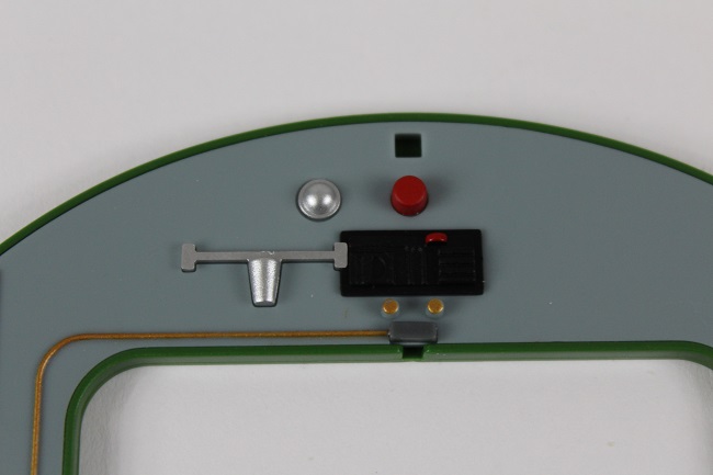

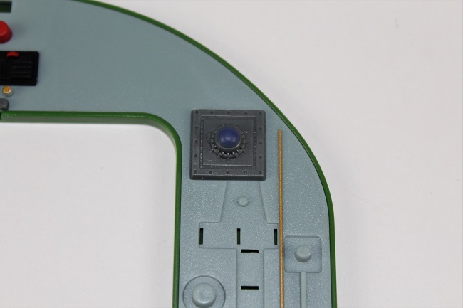

On the left side of the inner hatch fit details 2 and then 4. Next fix detail 8 making sure there is an A stamped on the back of the part and that you orient it exactly as shown. Now fit detail 9 (stamped B) orientating the part as shown and make sure each part is pressed into place.
At the top of the inner hatch fix details 15, 14 and 3. Then fix detail 10 being careful with the delicate part. Detail 11 is now fixed next to 10 where its recess will accommodate the right arm of detail 10.
Working on the right side of the inner hatch fix details 12, 16 and 17. Now fix the first detail 1 vertically, making sure that it engages fully with all the narrow slots. Then fix the second detail 1 horizontally above the first. Carry on by fixing detail 13, checking that you have the correct orientation and then detail 6 (This is the larger of two similar parts), detail 7 and detail 5. The internal details of the front panel are now complete.

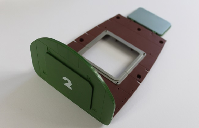

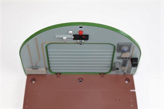

Next, slot the front hatch of your Pod 2 assembly through the middle of the pod front panel and slide the bottom ridge of the front panel in between the front hatch stay and the pod floor making sure that everything is flush in this area. Now carefully turn the assembly over, place a washer at the fixing point and secure it with a screw, then repeat on the other side.
