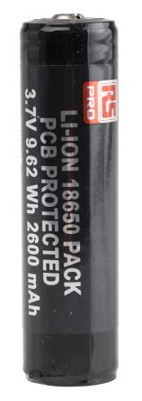

I used 18650 lithium ion batteries 3.7 volt button top terminals no protection 2600 mah capacity RS stoke no 880-1558 brand RS pro from RS components
i was only able to charge two of the batteries to full capacity showing a charge of 4.05 volt the remaining 4 show a charge of 3.70 volts i have a replacemet charger coming as in issue 92 could the low charge on 4 of the batteries be the problem what batteries did you use and where did you get them

The problem is unlikely with the test charger.
You appear to have 2 faulty batteries but this aside, your batteries are indicated on the label as being “Protected” type which is incorrect for R2 use - they should be “Unprotected” (no protection) type, and therefore you first need to replace all of your batteries. Also there seems to be no spec info about the capacity discharge amperage of your battery which needs to be 3 Amps minimum.
A battery source can be found here: https://www.ecoluxbatter...30q-3000mah-15a-battery
If the RS Components webpage or your receipt, notes your battery as “no protection”, I would contact them for return/full refund as you have received “Protected” batteries as noted on the sleeve.

Those batteries are very low power as 9watts/hour at 4volts equates to 2.25amps. Like Tomick has said if they are not charging/or not charging fully then it would also appear that you have at least 5 bad batteries.It also appears that they are protected flat tops. https://uk.rs-online.com...eable-batteries/8801558/
