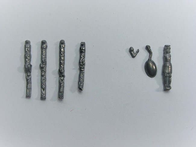

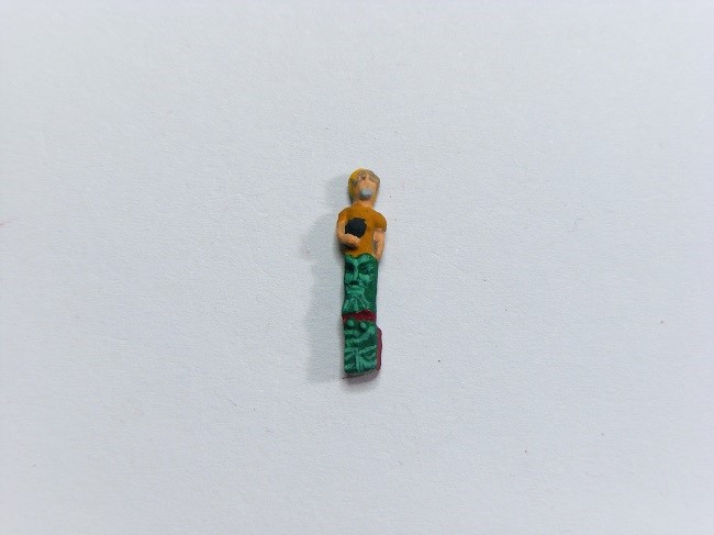

Vasa Pack 8 – Stages 78 - 89

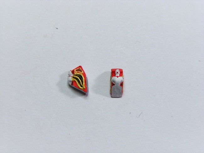

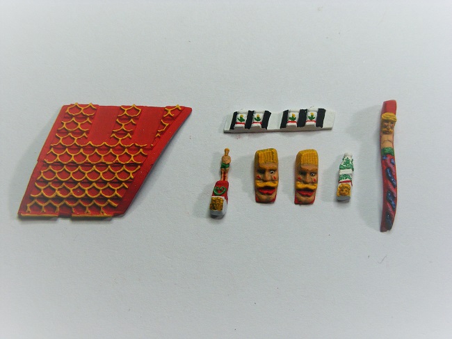

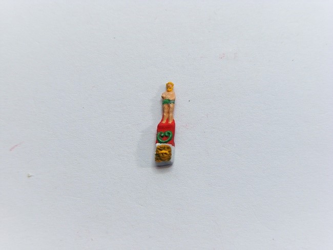

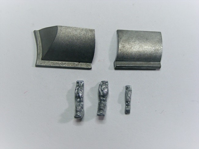

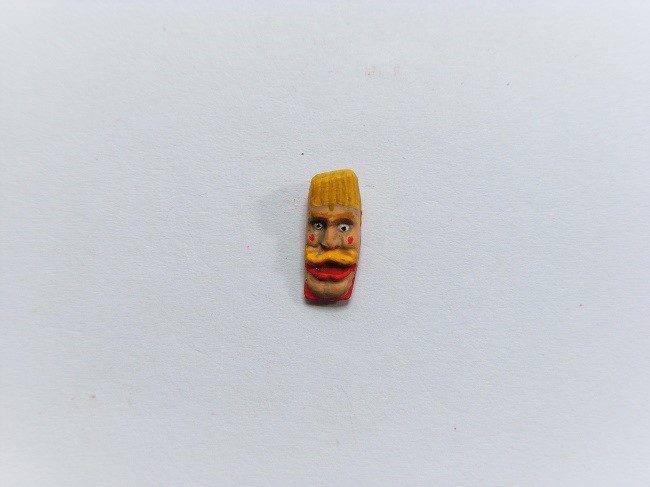

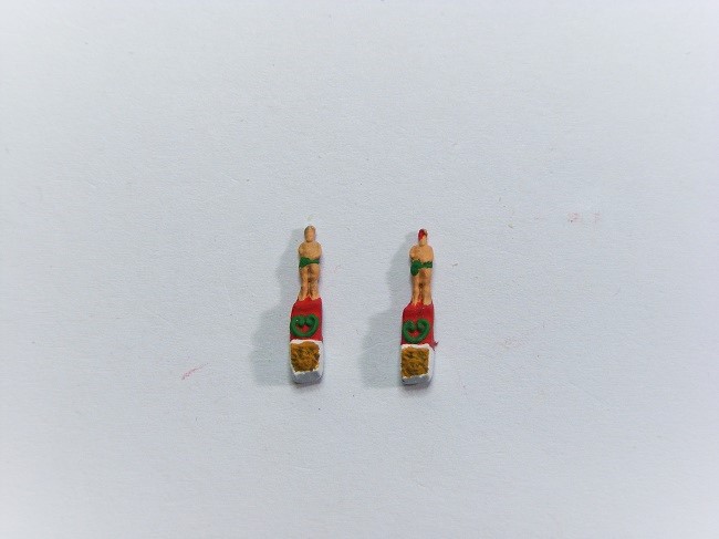

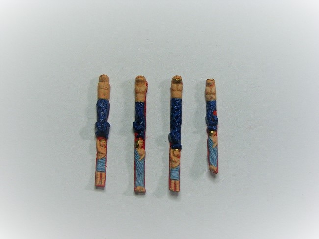

Stage 78 Contents: Decorations

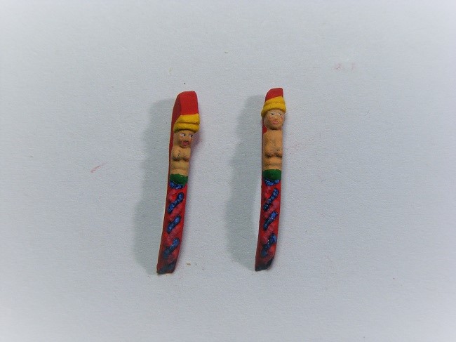

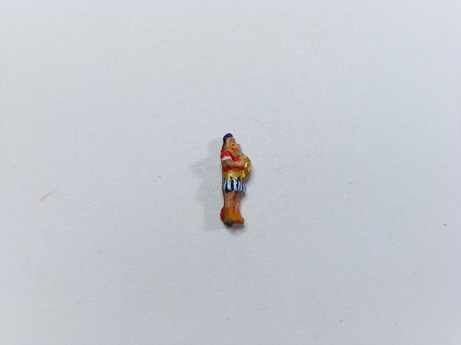

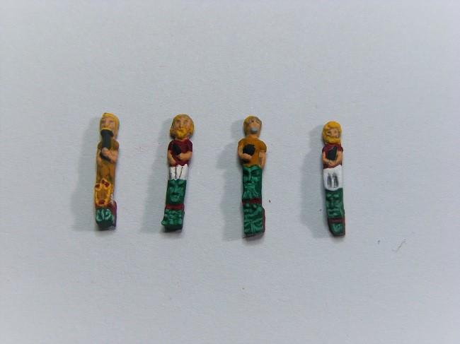

Remove any flash or burrs from the decorations C47, C48, C49 and C50. Apply a coat of metal primer and leave to dry then follow the painting guide provided within the instructions.
Recover decoration C24 supplied with stage 77. Prepare and paint the decoration following the guide in stage 42 but using the colours outlined in the instructions for this stage.

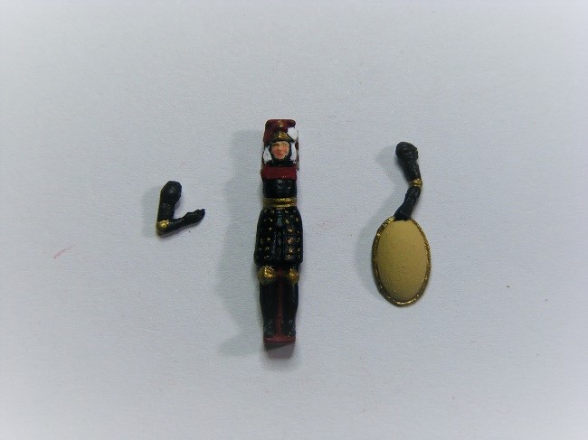

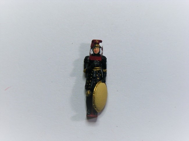

Remove any flash or burrs from the decorations C13, C14 and C19 supplied with this stage. Apply a coat of metal primer and leave to dry, then follow the painting guide provided within the instructions
Finally, glue the arms C14 and C19 to the figure C13 and leave to dry.
This stage is now complete. Carefully store the decorations in a bag labelled with this stage number.
#2 Posted : 27 January 2019 11:33:41

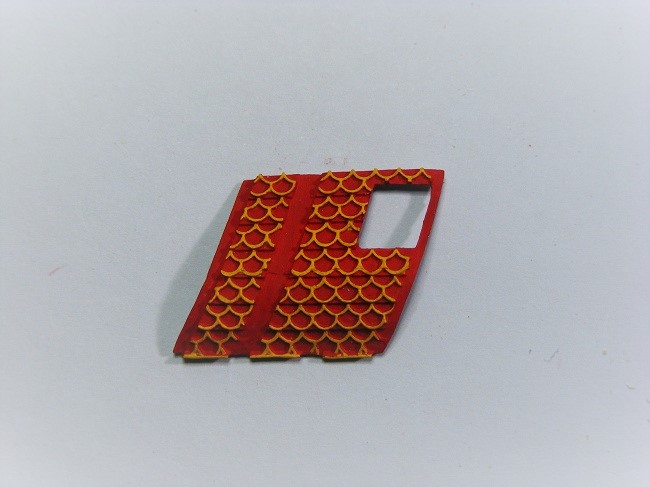

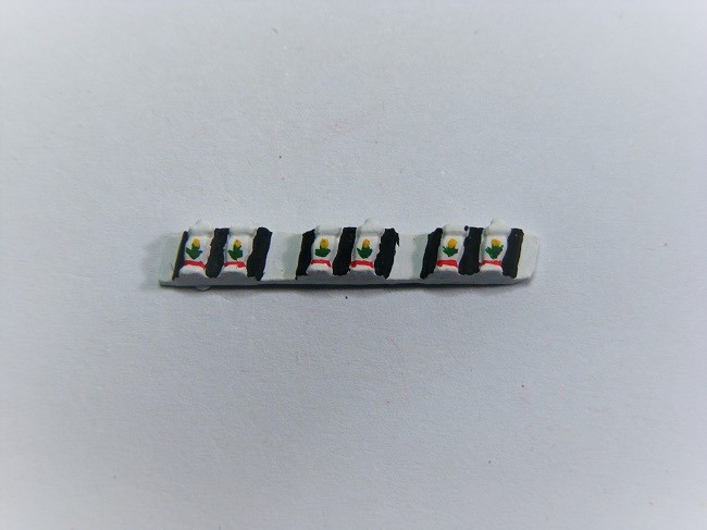

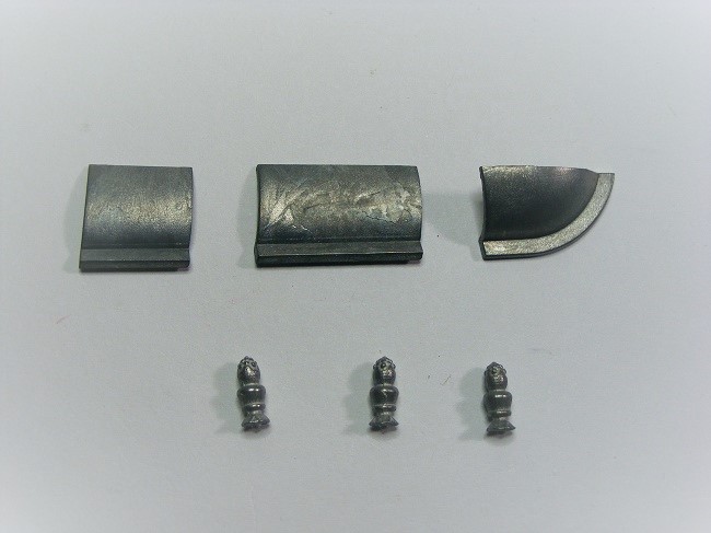

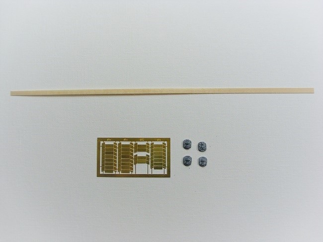

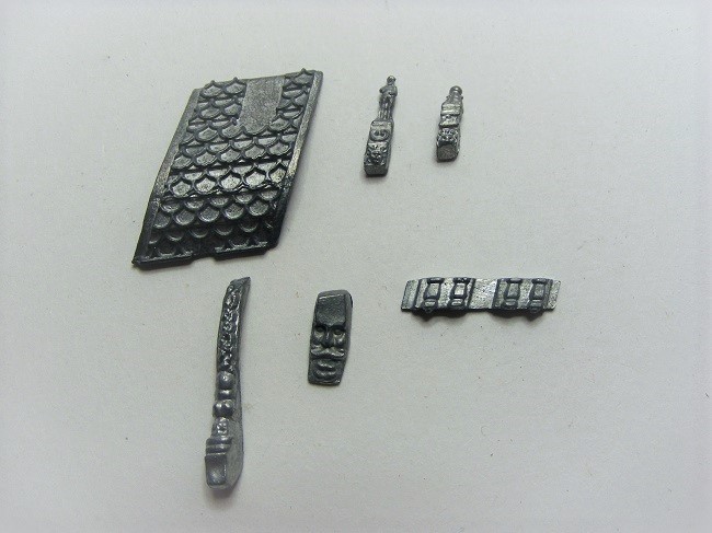

Stage 79 Contents: Gallery Roof and Decorations. 

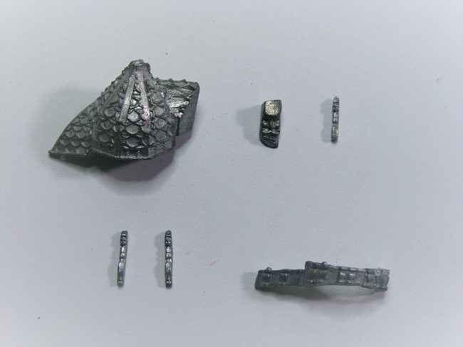

Retrieve decorations C64b, C64c, C64d, C64e, C64g, C64h, C64i, C64j and C64k from stage 72, remove any flash or burrs from each on them, then apply a coat of metal primer and leave to dry.
Identify decorations C64b, C64c, C64d and C64e. Follow the painting guide provided within the instructions to paint these decorations.
Now identify decorations C64g, C64h, C64i, C64j and C64k. Again, paint these decorations following the painting guide provided within the instructions and leave to dry.
This stage is now complete. Carefully store all these decorations in a bag labelled with this stage number.

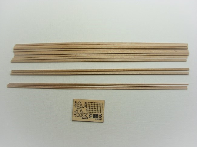

Stage 82 Contents: ST Ladders, Wooden Strip and Decorations.
Retrieve decorations C67, C67a, C67b, C67c, C67d, C67e and C67f from stage 75. Remove any flash or burrs, then apply a coat of metal primer and leave to dry. Follow the painting guide provided within the instructions to paint the decorations

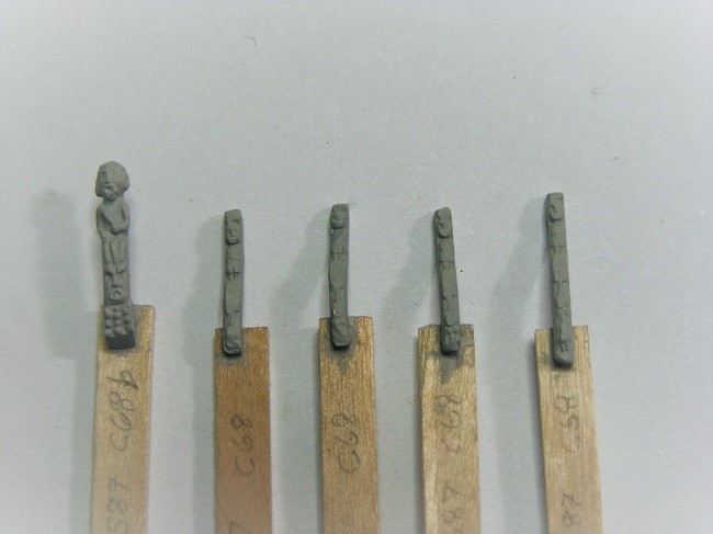

Retrieve decorations C68, C68e, C68f, C68i, C68l, and C68m from stage 79. Remove any flash or burrs, then apply a coat of metal primer and leave to dry. Follow the painting guide provided within the instructions to paint the decorations
Smooth any flash or burrs from the lion head decorations C20, provided with stages 80 and 82, then apply a coat of metal primer and leave to dry. Follow the painting guide provided within the instructions to paint the decorations.

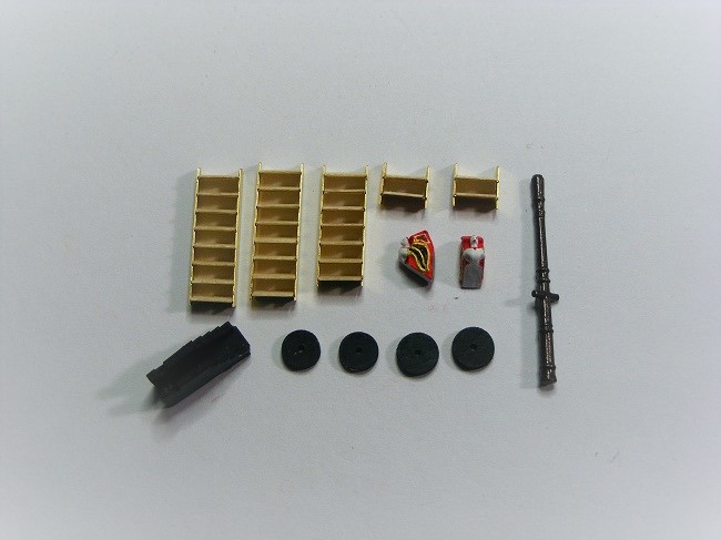

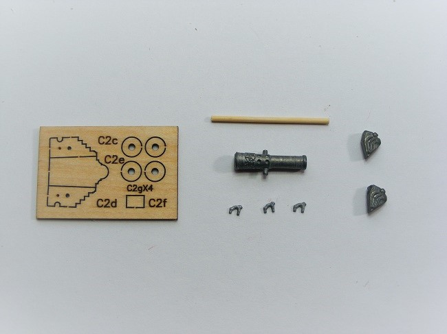

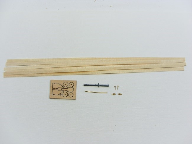

Stage 84 Contents: Wooden Strips, Brackets, Eyebolts, Cannon, Cannon Carriage and Wheels.

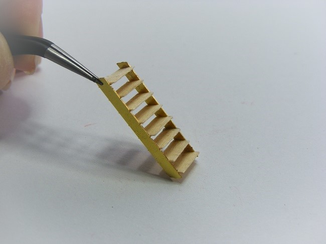

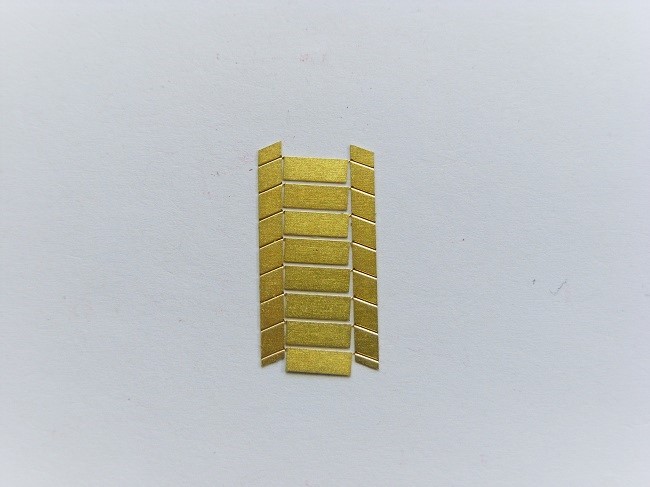

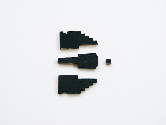

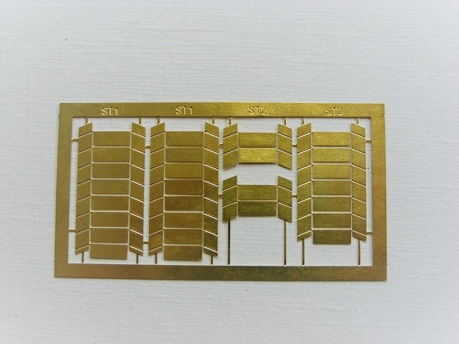

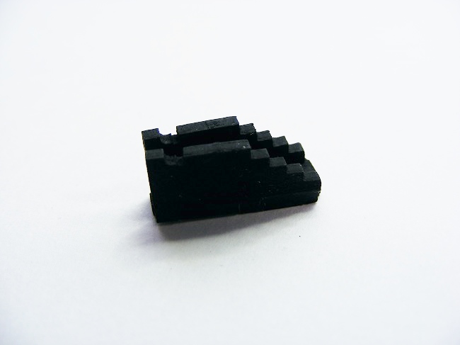

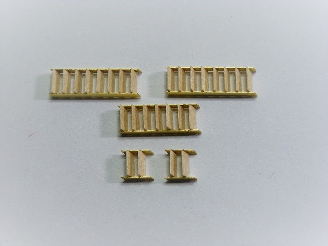

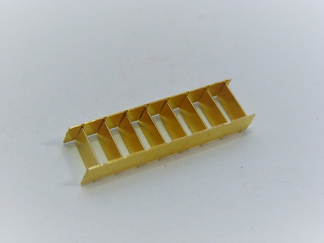

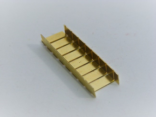

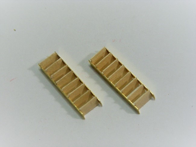

Retrieve the ladders supplied with stage 82 and remove one of the two ST1 ladders from the fret. Fold the two sides in until they are at right angles to the central section, then carefully bed the steps of the central section up, aligning them with the notches inside the two sides.

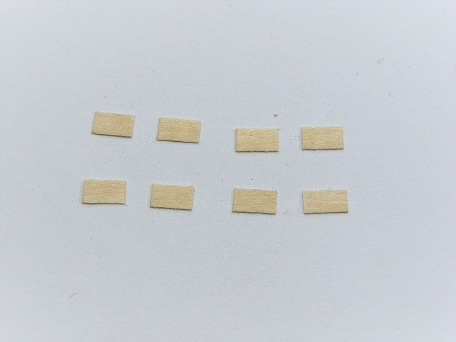

Cut eight 8mm lengths from the 0.5x5mm wooden strips supplied with stage 82 and glue them onto the steps of the ladders.
Repeat the process to assemble a second ladder ST1, an ST3 ladder and two ST2 ladders.

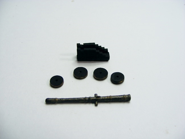

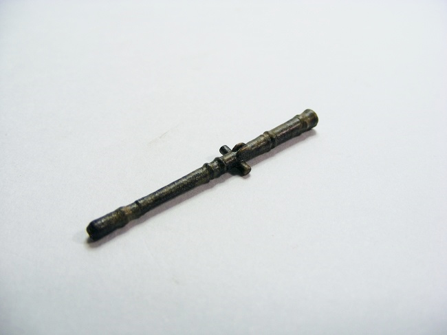

Separate the cannon carriage components from the fret, smooth the edges of all the parts and paint them black. The assembly of the carriage is the same as that outlined in Stage 9 so will not be repeated here.
Remove any imperfections from the barrel of the cannon then apply a coat of metal primer and leave to dry. Paint the cannon with a bronze colour (No RAL Code) then store the cannon and the assembled carriage until needed again.
Smooth any flash or burrs from the decorations C26, provided with stage 81, then apply a coat of metal primer and leave to dry. Follow the painting guide provided within the instructions to paint the decorations. When dry, carefully store the decorations in a bag labelled with this stage number until they are needed again.
This stage is now complete. Carefully store any unused parts in a stage labelled bag.

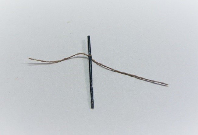

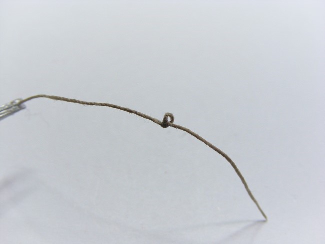

#8 Posted : 20 February 2019 22:23:02

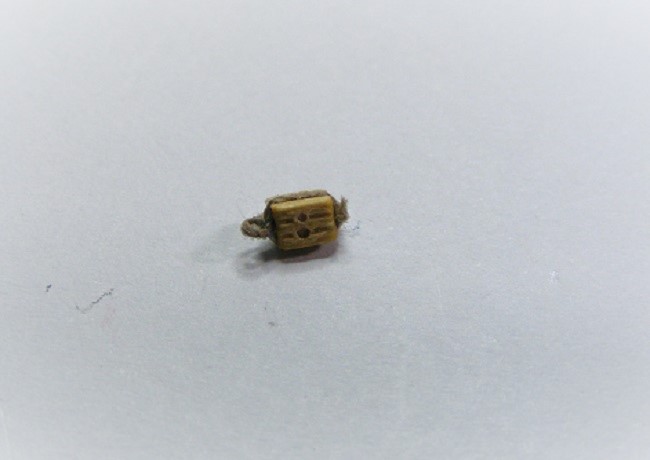

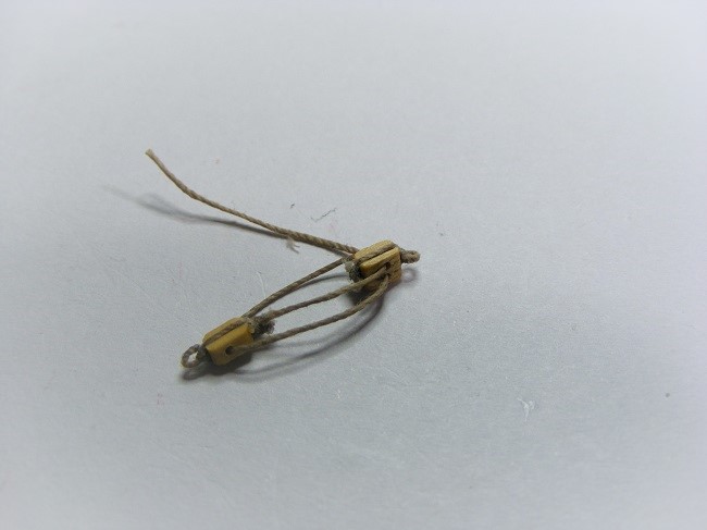

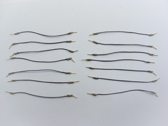

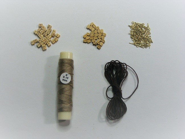

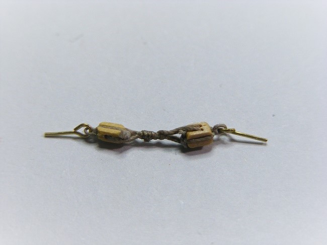

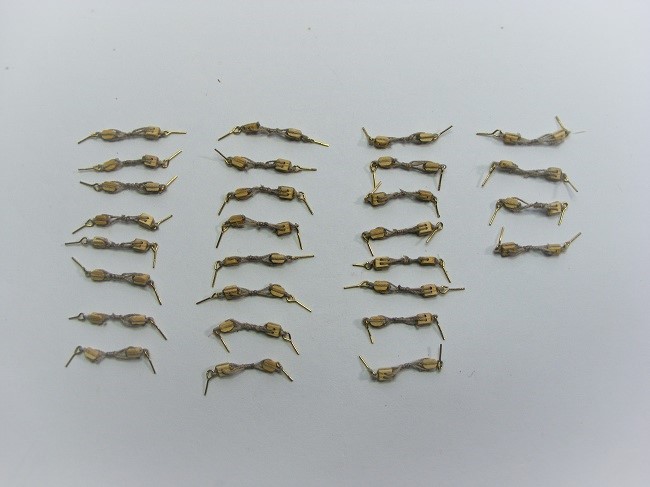

Stage 85 Contents: Single Blocks, Double Blocks, Eyebolts, Brown Thread and Natural Thread.

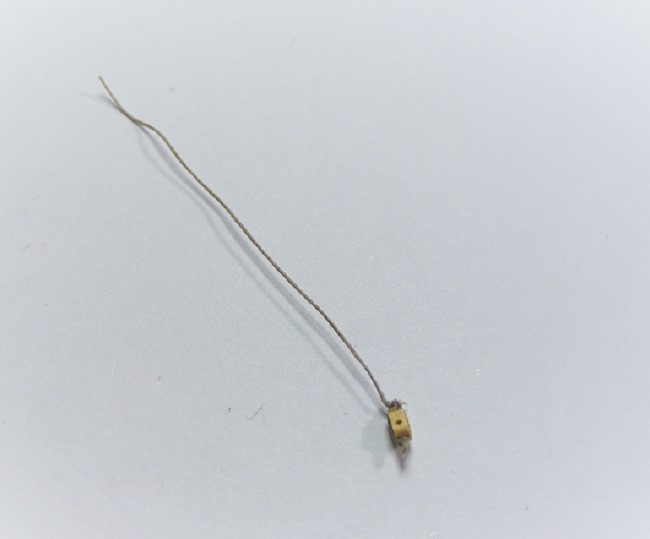

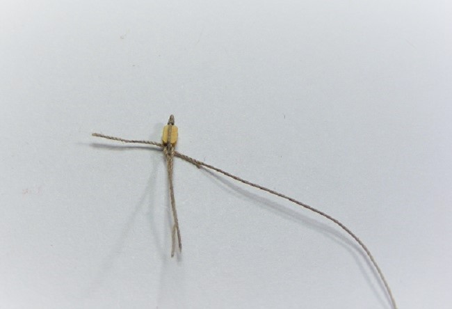

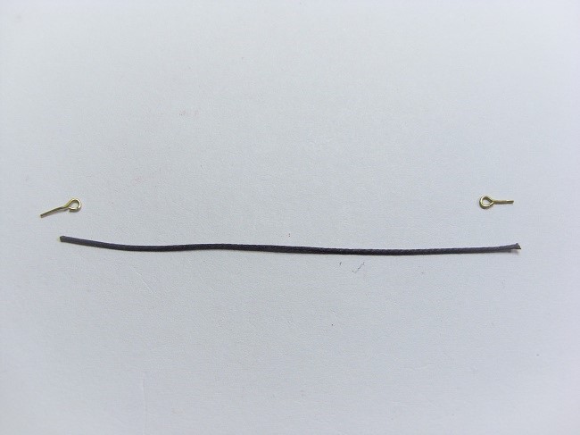

Cut a 50mm length of 0.15mm natural thread and make a loop in the centre of it. Now cut a 100mm length of natural thread and then check all the holes in the blocks are clear. Tie the 50mm length of thread around the block and to one end of the 100mm length. The hole in the block should be nearest the loop. Fix the knot with a little glue and then cut off the excess from the 50mm length. Tie the short section of the 100mm length around the knot and apply a little glue if necessary. Cut off the excess leaving the single long length.
Cut a second 50mm piece of natural thread and tie a loop in the centre of it. Tie the line around a double block with the loop positioned nearest the holes. Apply glue to the knot to secure if necessary, then cut away the excess.
Take the line from the single block and pass it through one of the holes in the double block, leaving a distance of 10mm between the blocks. Pass the line back through the hole in the single block then take the line and feed it through the second hole in the double block. Wrap the line around the lines between the two blocks and secure with a knot. Cut away the excess line up to the knot, then take two eyebolts, open the eyes at the end of each and hook around the block loops, then close the eyes. Repeat these steps to assemble a total of 28 gun tackles.

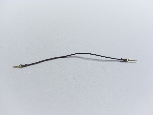

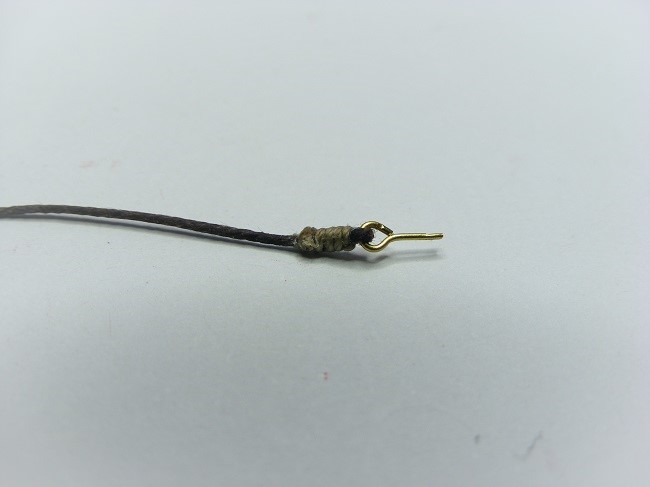

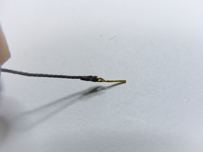

Cut an 80mm length of brown thread and pass one end through the eye of an eyebolt. Fold the end of the line back on itself by 3mm, applying a small drop of glue may help to hold it in position. Now cut a 40mm length of natural thread and tie it around the doubled line, close to the eye. Wrap the 40mm length of thread around the doubled line, tie off the line and cut of the excess at either end. Attach an eyebolt to the other end of the brown thread in the same way. This is known as the breeching. Repeat these steps to assemble a total of 14 breechings.
Each of the cannons on the decks will require two gun tackles and one breeching.

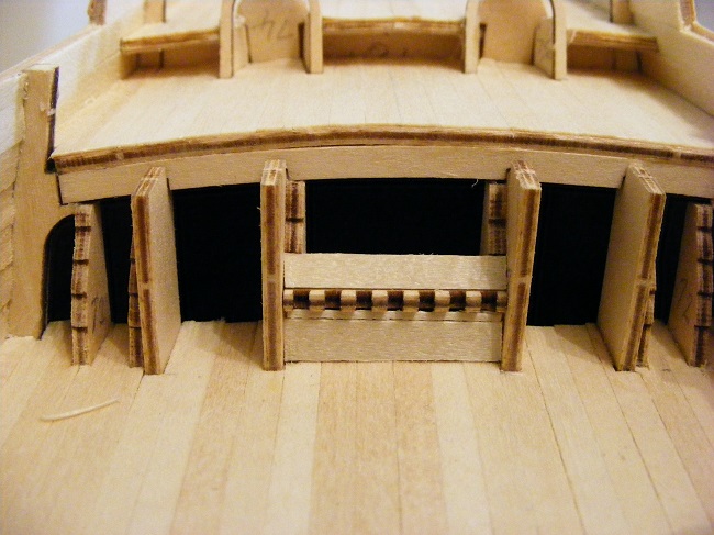

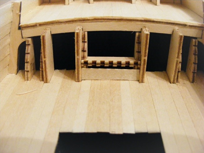

#9 Posted : 23 February 2019 23:55:43

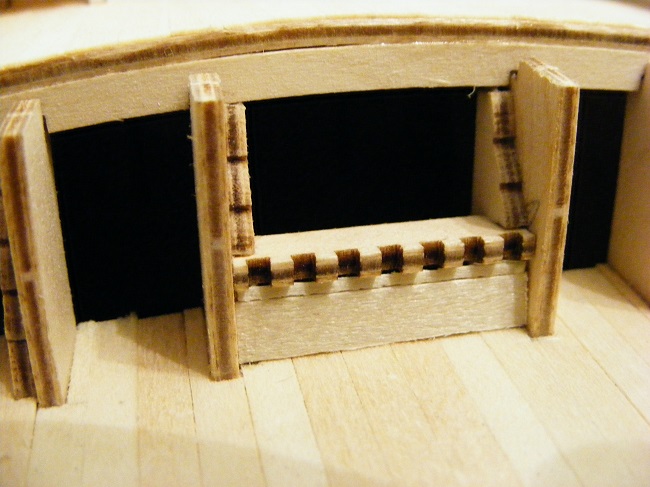

Stage 86 Contents: Gallery Parts and Decorations.

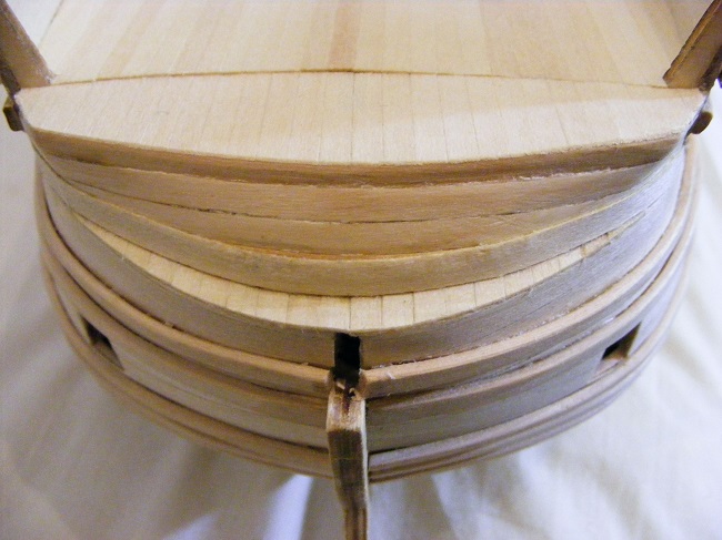

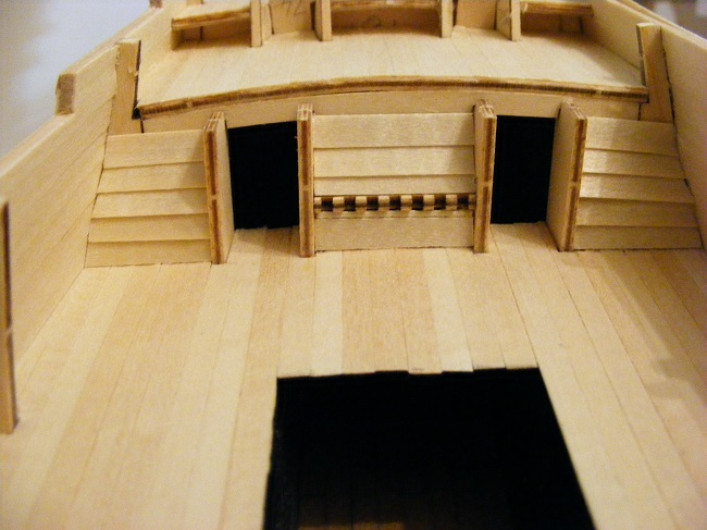

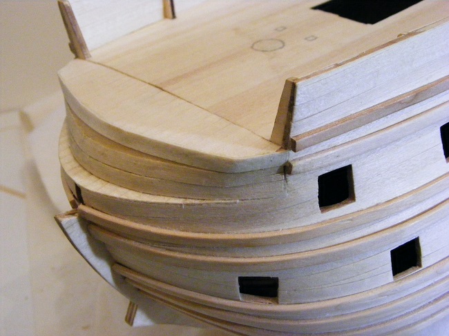

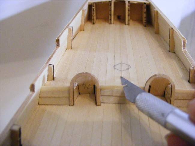

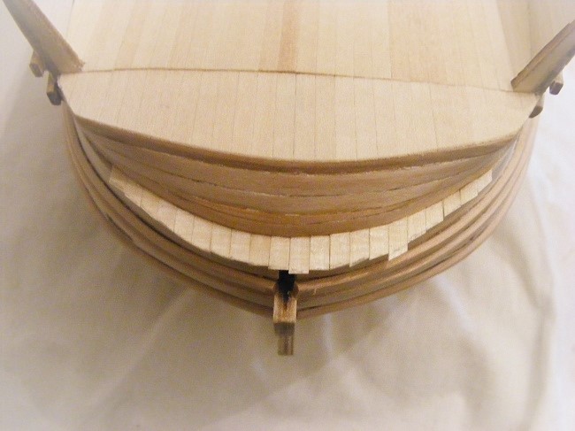

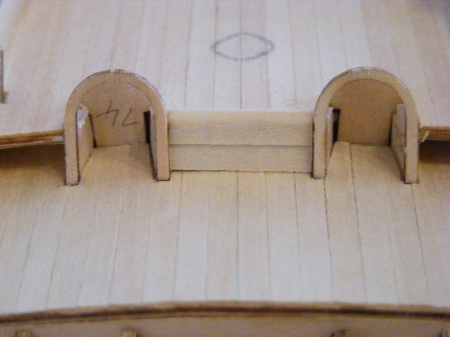

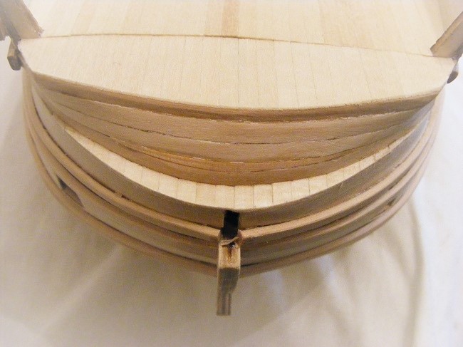

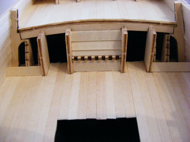

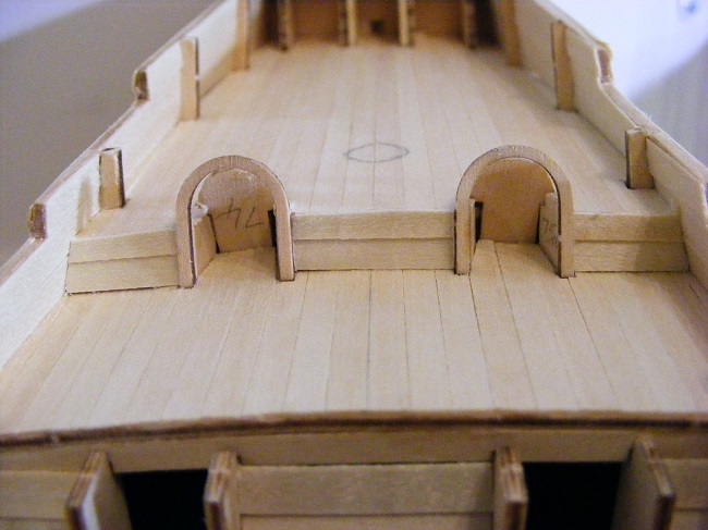

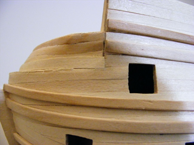

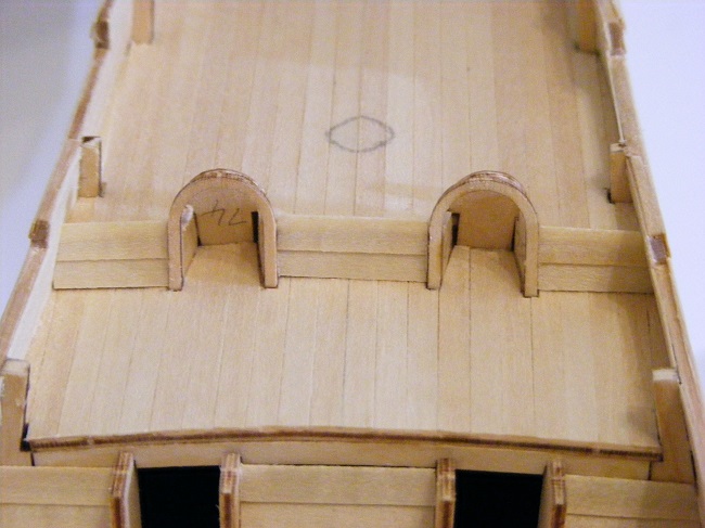

Draw a line in the middle of the false keel at the bow. Retrieve the 0.5x4mm wooden strip from stage 84, cut two lengths and glue either side of the line you just marked. Continue to cut and glue strips to cover the area at the bow then trim the ends of the strips.
Cut a length of 0.5x5mm wooden strip (stage 84) to fit between the uprights then glue the strip in place, up against the stepped uprights. Cut and shape another strip to fit between the strip you just added and the cross beam above, glue the strip in place. Prepare another strip to fit above the cross beam, glue it into place up against the uprights, flush with the step. Prepare and glue a further two lengths of strip against the stepped uprights. Each strip should overlap the one below slightly because of the angled steps.
Now cut and glue two strips to the uprights on either side of the deck. Place the strips between the stepped uprights and the bulwarks, fitting them flush with the steps. Prepare and glue a further four strips on each side, overlapping each strip.

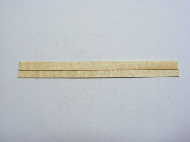

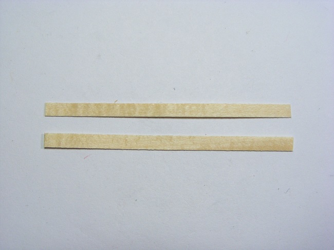

Cut two 90mm lengths of 0.5x5mm strips. Glue one strip onto the other along its length, overlapping by 1mm and leave to dry fully. When dry, cut it to fit between the two door frames of the quarterdeck. Cut more of the strips and glue them between the door frames and the bulwarks on either side. Now cut the strips in line with the top of the deck.

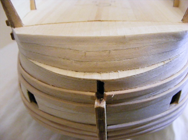

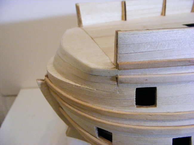

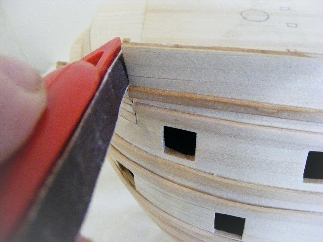

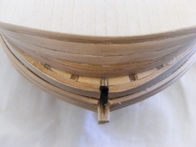

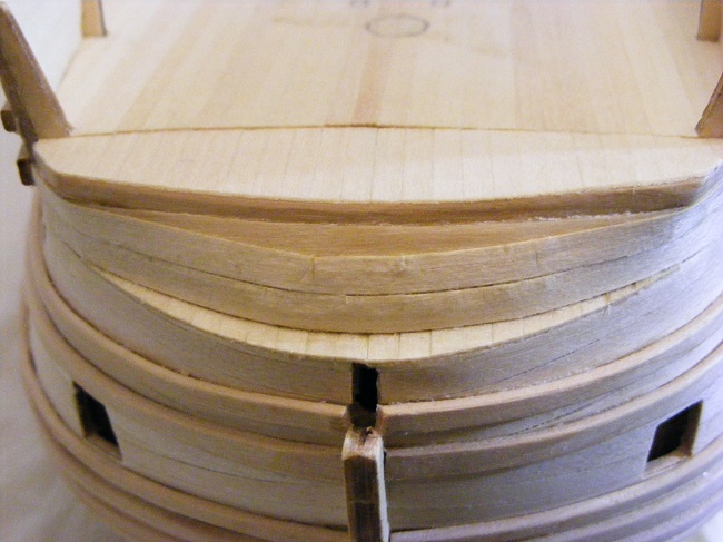

#10 Posted : 27 February 2019 23:39:22

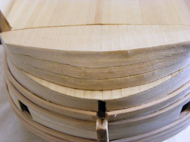

Stage 87 Contents: Gallery Parts and Decorations.

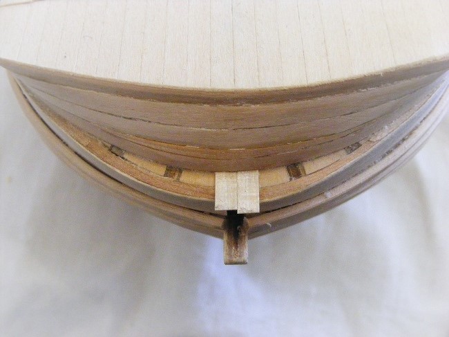

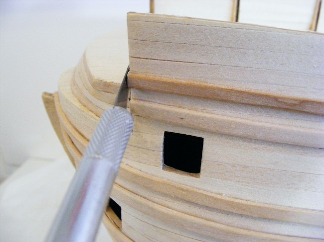

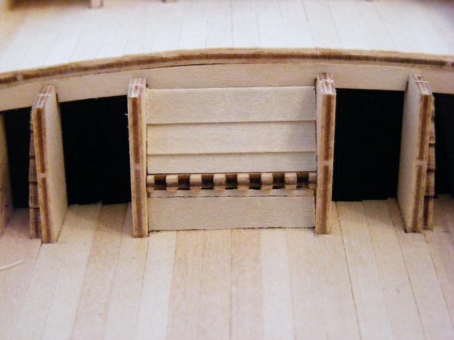

Cut the ends of the stakes flush with the forward edge of frame 2 on both sides of the hull then sand smooth. Now cut a length of 0.5x5mm wooden strip to fit around the curved bulkhead at the bow, the ends of the strip should be flush with the front of frame 2. Now cut a second length of strip to fit around the bow with the ends flush with frame 2 then glue it into place.
Prepare a third strip to fit around the bow and glue it flush with the top of the deck, leaving a gap between it and the strip previously fitted. Cut a piece of strip to fit in the gap created between the strips and glue it into place. Use a fine sanding block to smooth the strips covering the bulkhead, taking care not to sand through the thin strips.

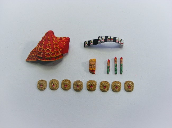

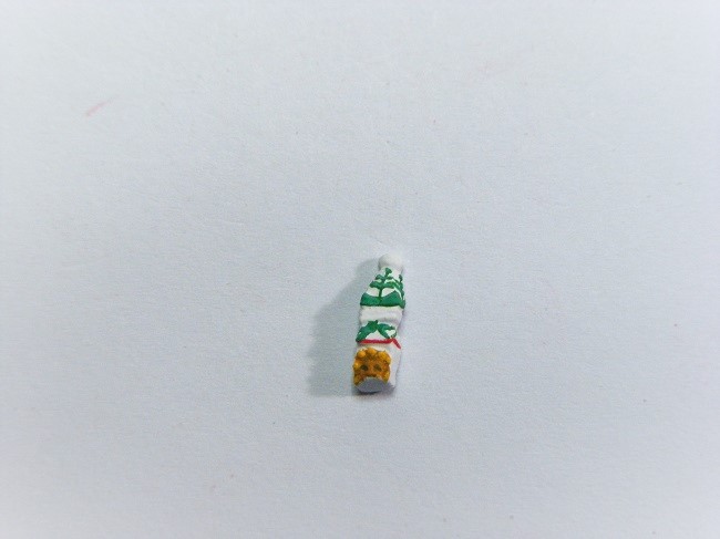

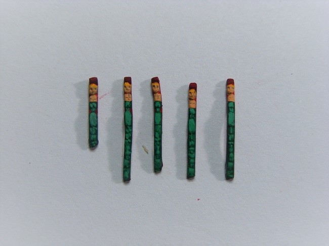

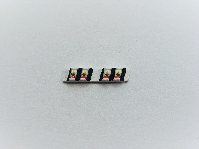

Retrieve decorations C68a, C68b, C68c, C68d, C68g, C68h, C68j and C68k supplied with stage 80 and remove any burrs or flash. Apply a coat of metal primer to them and leave to dry. Store decorations C68b, C68g, C68h, C68j and C68k in a bag labelled Stage 80.
Follow the painting guide provided within the instructions to paint the decorations C68a, C68c and C68d. When dry, carefully store the decorations in a bag labelled with this stage number until they are needed again.

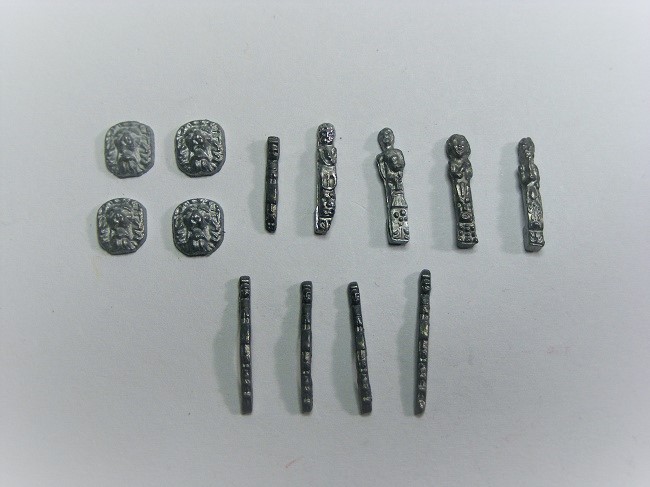

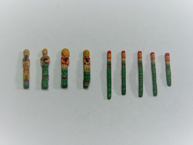

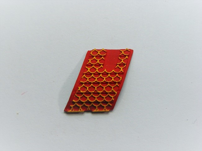

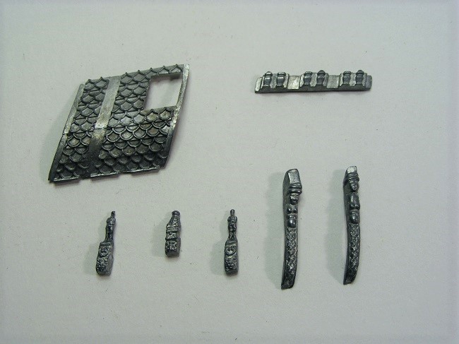

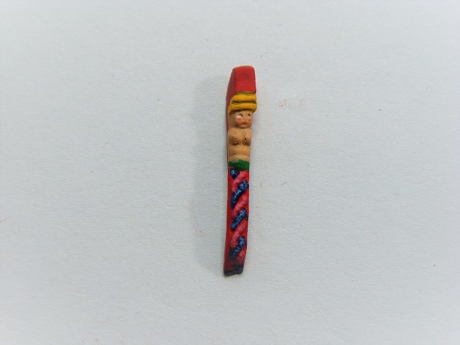

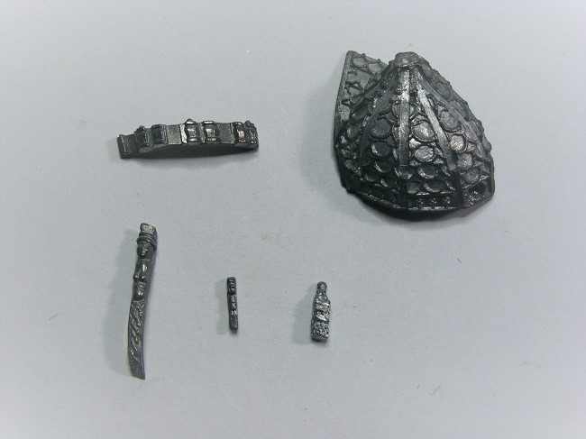

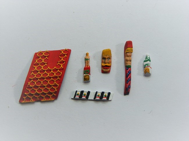

Remove any burrs or flash from decorations C87, C87a, C87f, C87l and C87m supplied with this stage. Apply a coat of metal primer and leave to dry.

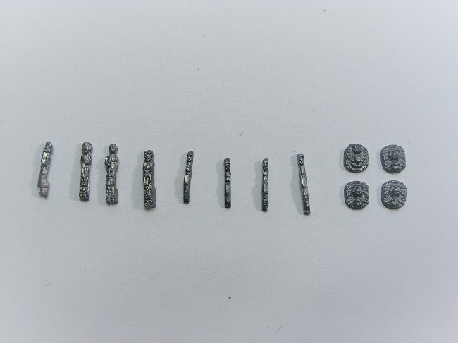

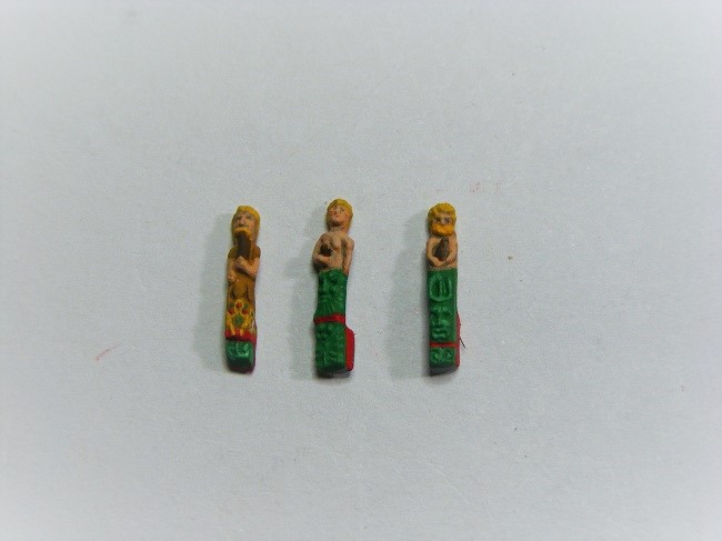

#12 Posted : 04 March 2019 22:58:53

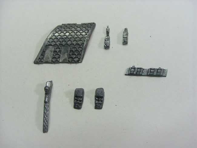

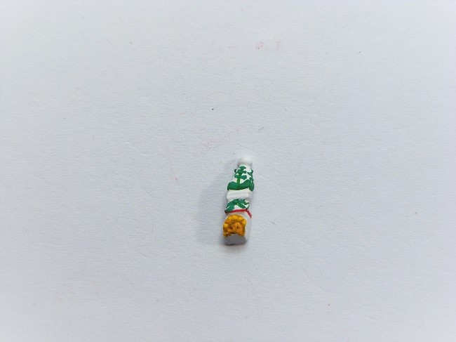

Stage 89 Contents: Decorations.

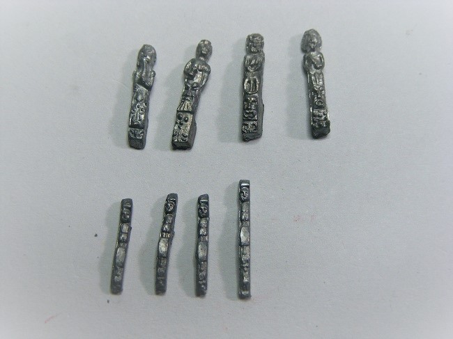

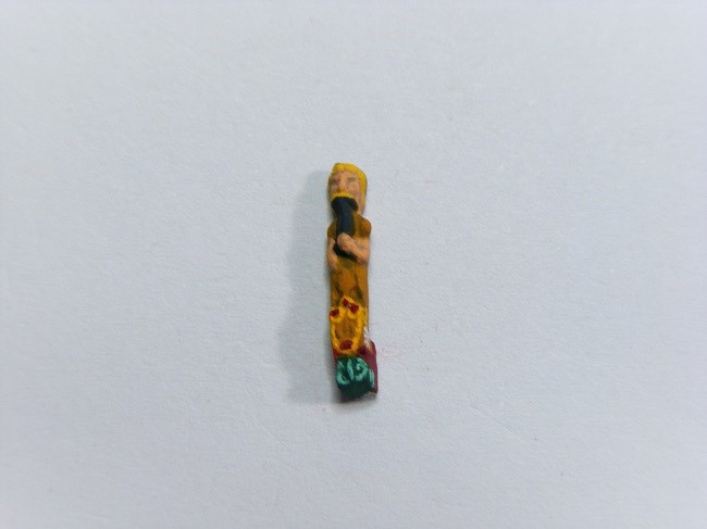

Remove any burrs of flash from decorations C87b, C87c, C87d, C87e, C87g, C87h, C87i, C87j and C87k supplied with this stage. Apply a coat of metal primer and leave to dry. The four lion head decorations will be painted at a later stage.
Follow the painting guide provided within the instructions to paint and assemble the decorations. When dry, carefully store all the decorations in a bag labelled with this stage number until they are needed again.
#13 Posted : 04 March 2019 23:01:20

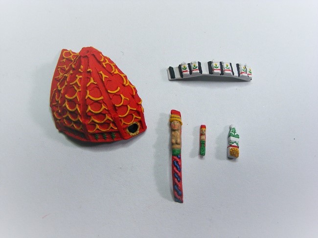

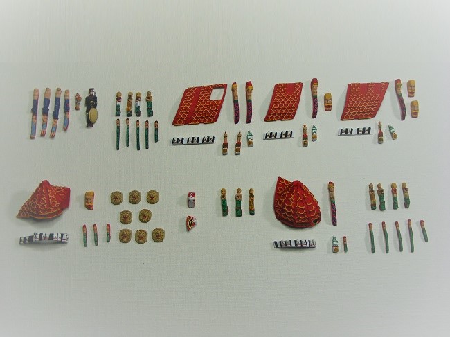

Ships Decorations Pack 8
The decorations contained in pack 8 have been painted following the instructions given for each stage noted in pack 8.
Store the painted decorations carefully in stage labelled bags until needed.
