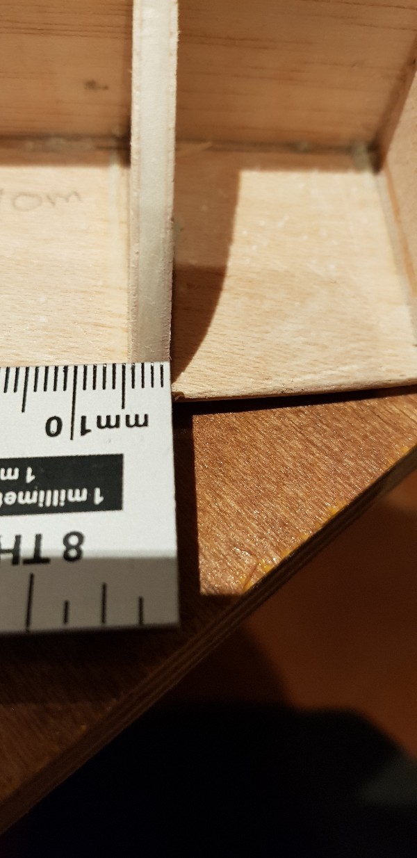

To reiterate what insaid earlier how poor the ply is....
Well last night n today i finished laying the micro thin pieces of decking onto the false deck using contact glue then went out for a few hrs while it dried and then started on the fairing..
Disgusted to say the least.
I spent several hrs upon fairing both sides and i then siaked two pieces of decking which look like a hard wood..
Anyway the ply for the false keel and the bulkheads is nothing more than two slithers of the cheapest plywood with a layer of what looks like polyfilla but a tad harder...
The ply just splits when you start the rub down Angry
So im going to get some 3mm balsa and glue a piece to each side of the bulkhead and clamp them over night..
I even tried a piece of soaked planking i wiped off the excess water but the bulk head soaks it right up......
I was looking forward to this pre victory build to give an insight into fairing n planking..

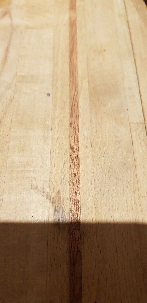

Anybody any idea what wood in the pic is..
Im using it for the planking the Albatross...
Also im thinking of using a softer similar wood instead so any thoughts on that please..

#13 Posted : 24 January 2019 18:51:06
BigGrin Hi ant the wood looks like Sapele a Mahogany look a like but a lot lot cheaper and is very brittle. If this is a old kit it might have dried out so soaking it water for a few minutes makes it a lot easier to use Cool
Hope this helps
Martyn

Ive been soaking the planks but the last 2 inches at each end stay solid hardly any give at all.....
