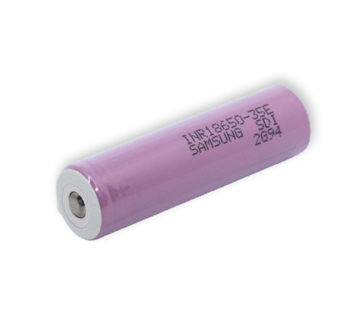

frank könig attached the following image(s):
#11 Posted : 13 January 2019 23:38:17
Could you provide a picture of the button top end of your battery please.
