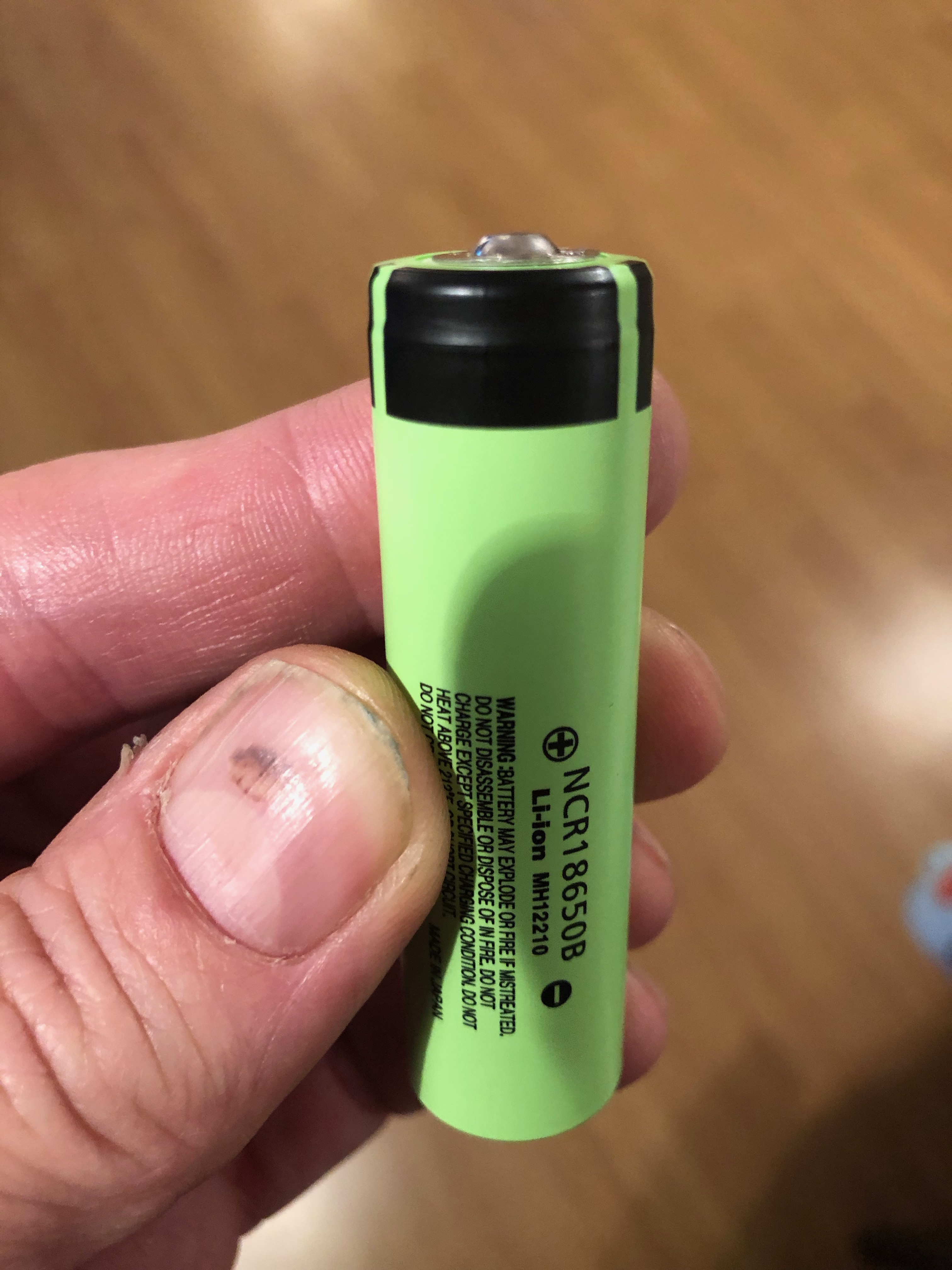

going by the link you sent it does say flat top, can you put a photo of the batteries positive end please.

#9 Posted : 27 December 2018 20:55:49
Can you check that the solder joints are good on the lead into the battery box.

https://flic.kr/p/2cJgbxU
It says 'unprotected' on the description. This is all a bit frustrating. Would a protected battery perform in any way, as I'm switching R2 on and getting absolutely nothing. I would have thought, even with a protected battery, something would light up or buzz? As I said, full voltage across the series in the battery box, but nothing at the plug. All batteries have been tested at the positive/negative plates in the box.
