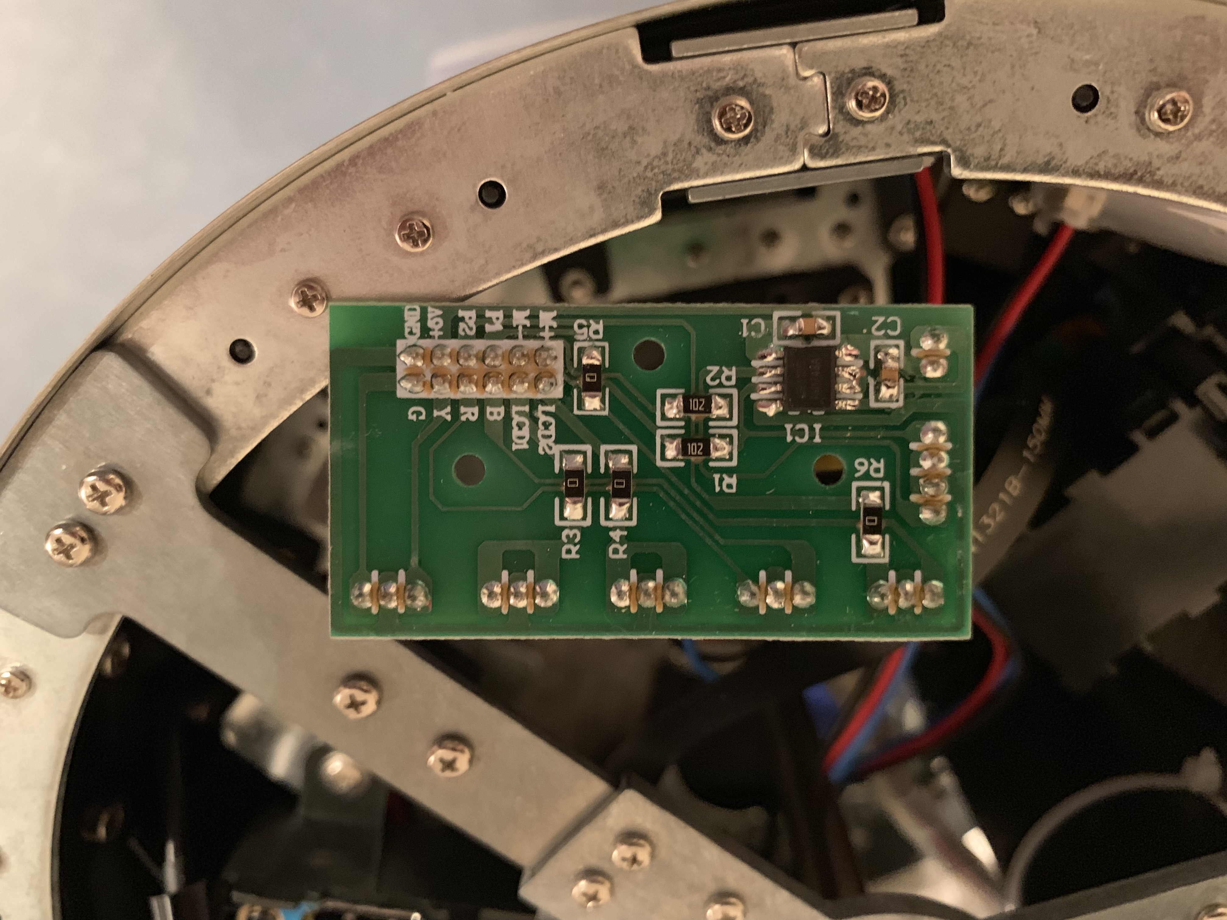

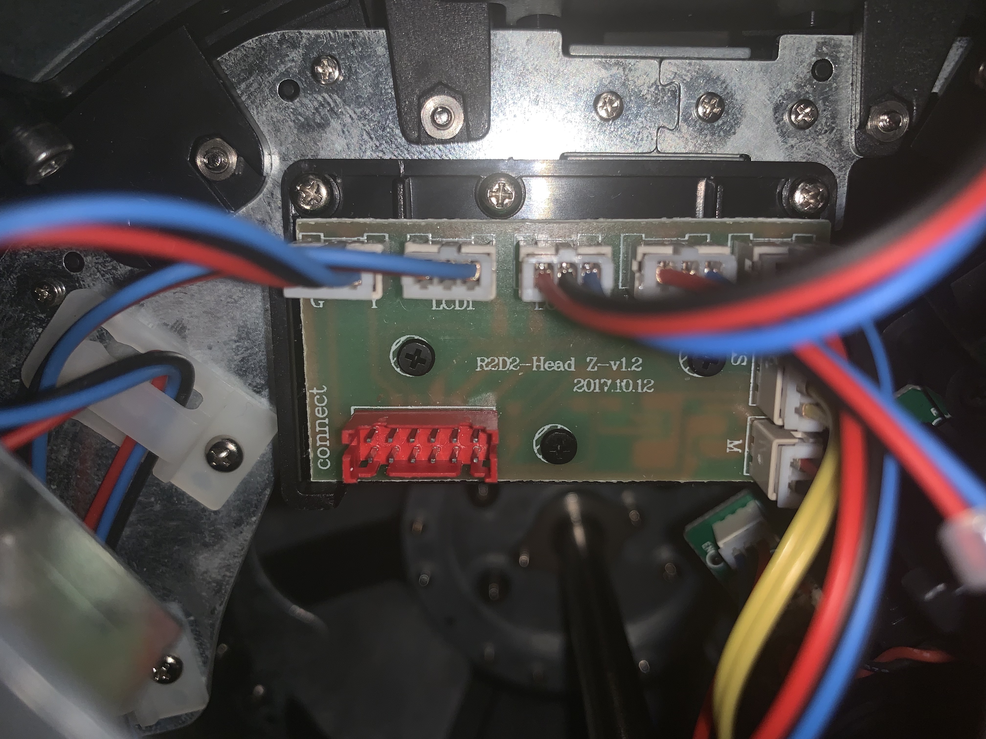

#2 Posted : 20 December 2018 20:08:22
Hi can you examine the circuit board that the projector plug is fitted too for damage or cracks.

#5 Posted : 20 December 2018 20:48:52
Have you removed the board and checked underneath it.
Resize your pics to 600 x 450 pixels and they will show on the forum. Video's need to be put on Youtube and a link to the vid placed on the forum.

#6 Posted : 20 December 2018 21:09:07
Rank: Beginner Level 1
Joined: 20/12/2018
Posts: 9
Points: 30
Hi,
PCB seems ok.
Have attached picture and links to videos 👍
