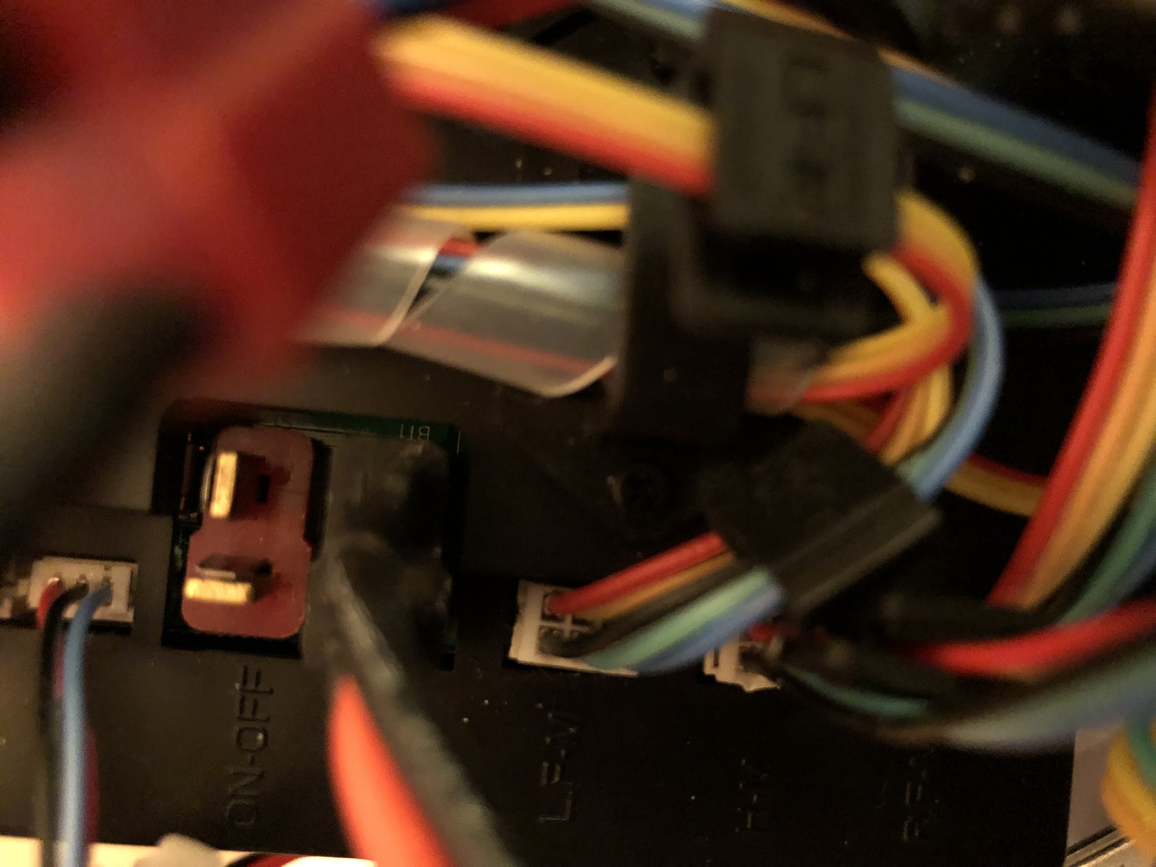

Understand, and im willing to try anything, i have checked all cables in the body and head, have stripped down and traced back
below is a video with the head partial removed so I can block the sensors to check they are working too
https://www.youtube.com/watch?v=h9DVV8_ZZ0o
NeoFuture
#16 Posted : 15 December 2018 23:36:23
Rank: Beginner Level 3
Joined: 11/12/2018
Posts: 29
Points: 96
Photos attached

i know you mentioned that you have checked all your cables etc, but hear me out here;
someone on facebook noticed that one of the images in issue 97 shows one of the plugs actually back to front in the socket! so shows how easily a mistake can be made. double check you haven't inadvertently put a plug in a socket the wrong way around - they have tabs on the sides of the male plugs that line up with slots in the female socket.
i know it may sound like sucking eggs, but worth checking!
