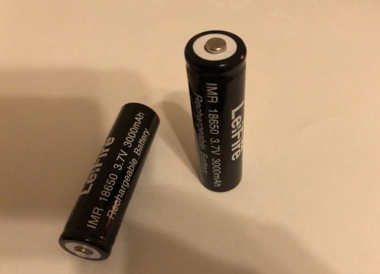

Can you post a picture of the battery and is it protected or unprotected.

Here a picture
PeterP attached the following image(s):
#8 Posted : 13 December 2018 00:42:06
According to the Amazon spec for your battery, it says it’s a “Protected” type battery
https://www.amazon.co.uk...lashlight/dp/B01HGBUNWK
Therefore is unsuitable to use in R2 - the magazine spec clearly states “Unprotected” type.
If this is so, you need to replace your batteries but the concerning thing is that you may have also inadvertently damaged the MCU as a result of installing Protected batteries, you’ll only discover this after you install the correct batteries and see if your R2 starts up and runs as he should or may also need to replace the MCU, might even be worthwhile doing a swop anyway.
