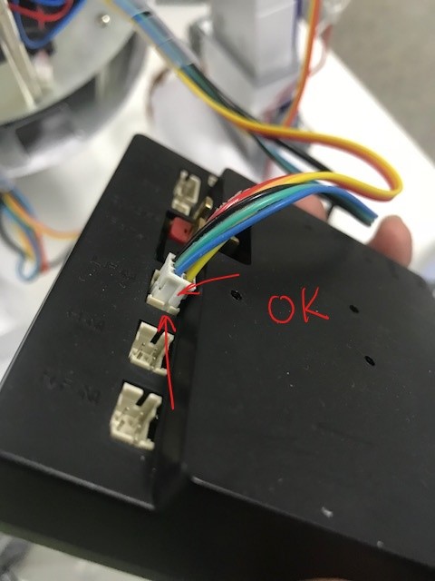

Inverted Connections
An “Inverted connection” seems to be the most common cause of malfunction with R2-D2.
An inverted connection means that the connector is plugged into the correct socket but the wrong way round.
One of the previous examples that the connection between the leg motor and the MCU board was inverted caused no movement of the R2-D2 and damaged the MCU and encoder of both motors on the left and right legs. This required replacement of the MCU board and motors of both left and right legs.
See the photos at the end for illustration.
This type of inverted connection can happen to many connections on the MCU and CPU boards.
An inverted connection between the MCU and the CPU will result in R2-D2 being unable to start up when the start up button is pressed, (a brief light up of one of the LCD screens will happen). Continually trying to start R2-D2 will result in damaging components. If however, the cable was corrected without constantly starting up, then the likelihood of any damage will be minimized and R2 will function correctly.
An inverted connection between the MCU and the head motor will result in R2-D2’s dome failing to turn during the start up process. Unfortunately, this will also damage the encoder on the head motor. As a result, even when the connection has been corrected, the dome will turn at a higher speed and slam to the extreme left and right during start up. The precise rotation of the dome is not possible since the MCU can no longer determine the position of the dome. This will require the replacement of the head motor and its possible the MCU board may also be damaged in this case.
An inverted connection between the MCU and the leg motor will cause R2-D2 not to perform any movement on one of the legs, or both depending on whether both left and right leg connections have been inverted. We believe that in this case the MCU board will also be damaged which will require replacement.
