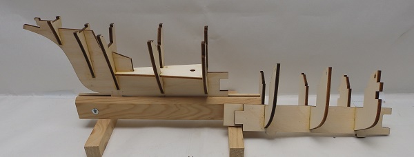

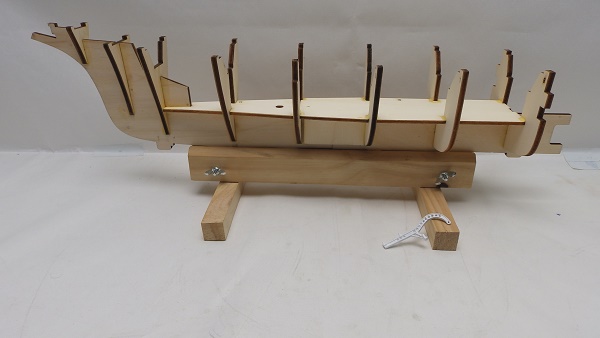

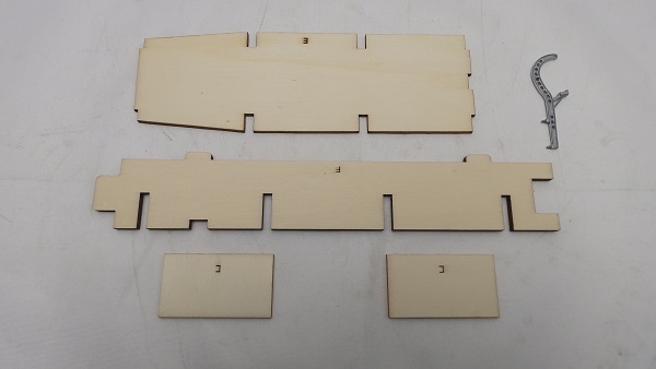

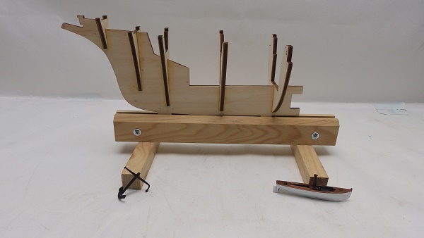

Imperial Yacht Standart Pack 1, Stages 1-5.

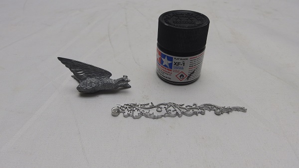

Stage 1

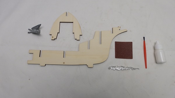

Stage 1 contents:- Forward false keel ,frame, figurehead, bow decoration, glue, sandpaper and a brush.
I have used the ModelSpace build stand for the Pack 1 stages of the build. This is not a nessassary item I have used it for display purposes.The build stand can be found here.
https://www.model-space....stand-san-felipe-1.html
Pack 2 contains a keel jig as part of the assembly.

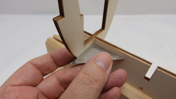

Take the false keel and the frame and sand them smooth. Check the fit of the frame into its slot on the false keel and adjust the fit if needed. When you are happy with the fit glue frame 5 into the 5th slot on the false keel making sure it is at a right angle to the keel.

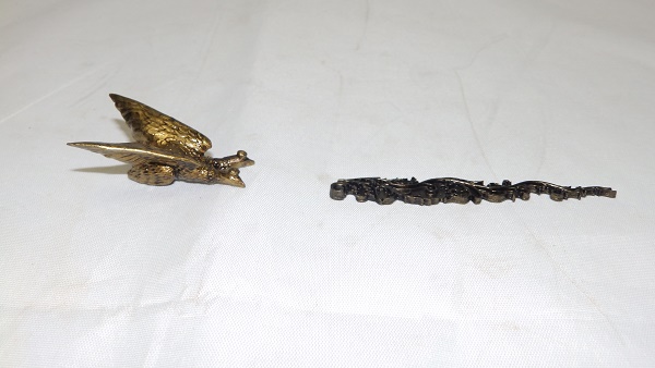

Next take the bow decoration and paint it matt black. When it is dry take some gold paint and dry brush the raised areas of the bow decoration. I then painted the figurehead gold with a dark wash to bring out the high lights.
Stage complete.
Store any unused parts in a labelled bag for future use .

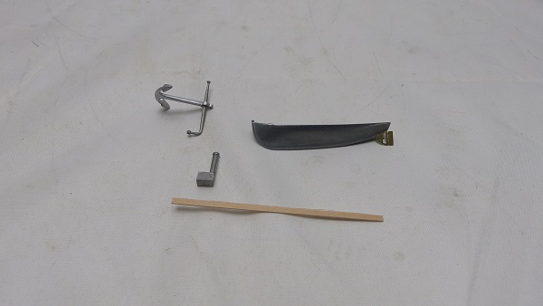

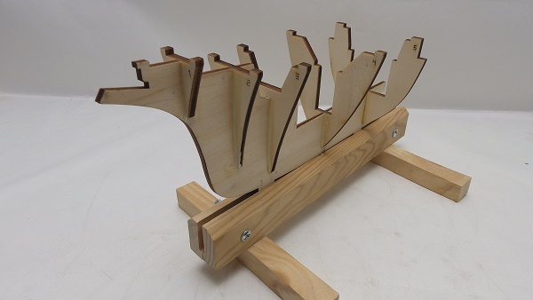

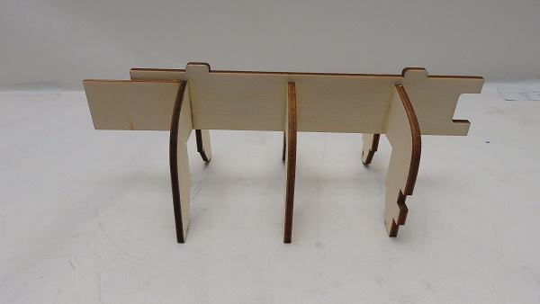

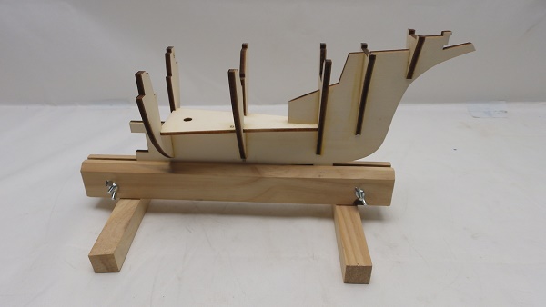

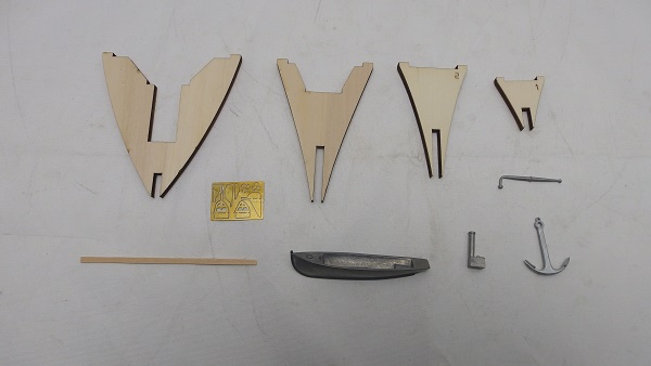

#3 Posted : 24 November 2018 20:44:01
Stage 2
Stage 2 contents
:- Frames, launch, launch fittings and an anchor.

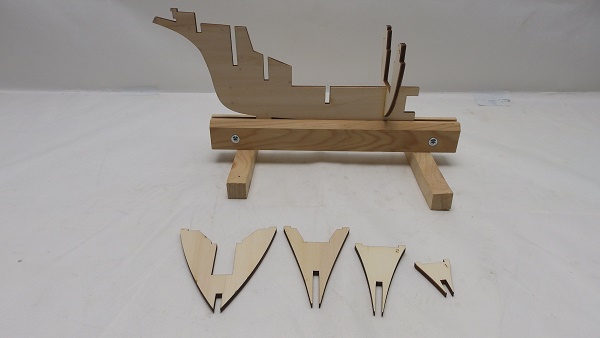

Take the four frames and sand them smooth then check there fit on the false keel then glue them in place.

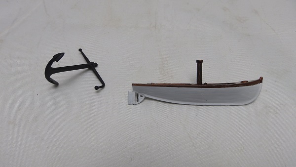

Now take the launch and smooth its sides and any other cast metal parts. Remove the rudder from the etch sheet and glue the rudder to the stern of the launch then paint the outside of the launch white and the inside black. When dry mask off the lower part of the hull and paint the upper works with a copper paint. Take the boiler and chimney paint it copper and when dry dry brush it with black paint. Stain the wood strip and add the benches to the launch along with the boiler then cut a screw from the etch sheet paint it black and glue it just in front of the rudder.
Glue the anchor stock to the anchor and then paint it matt black.
Stage complete.

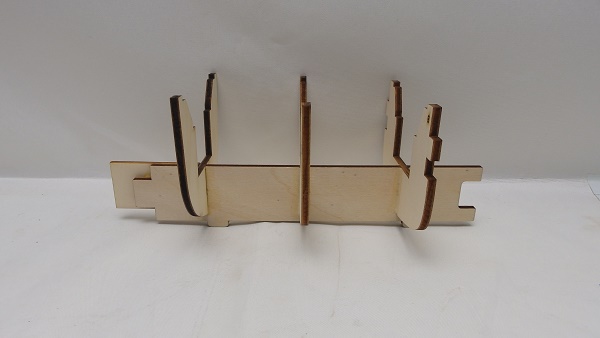

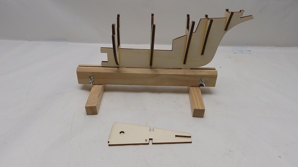

#4 Posted : 24 November 2018 20:46:28

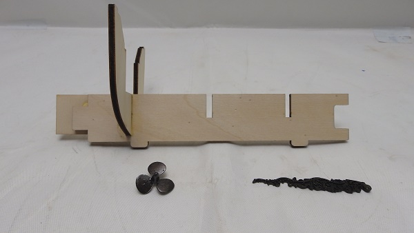

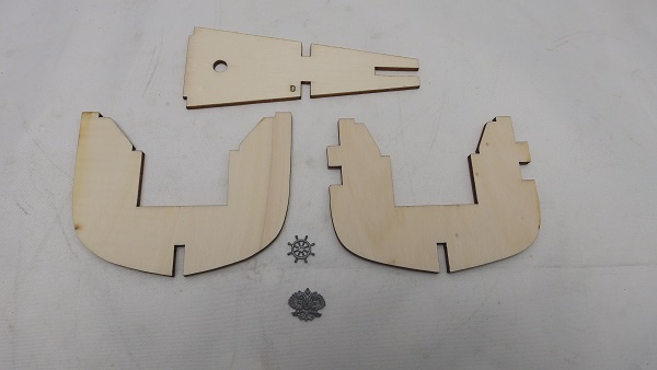

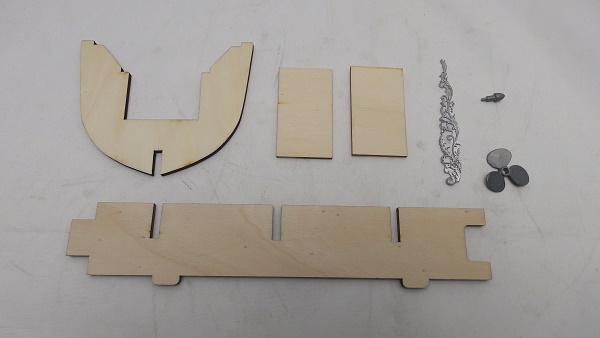

Stage 3
Stage 3 contents
:- Second false keel, frame, reinforcements. Bow decoration and propeller parts.

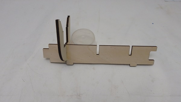

Take the frame and false keel and smooth them with sandpaper then check that the frame fits into its slot. Glue the frame onto the keel making sure it is at right angles to the keel then take one of the reinforcements and glue it to one side of the keel, forward of and against the frame just fitted.
Clean up all the metal parts then paint the propeller with bronze paint. Take the decoration and paint it matt black then dry brush it with gold paint like you did to the other decoration.
Stage complete.

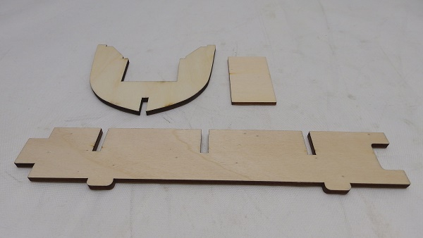

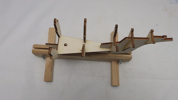

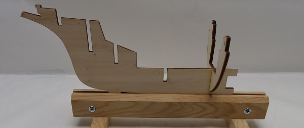

#5 Posted : 24 November 2018 20:48:54
Stage 4
Stage 4 contents
:- Frames, lower deck, wheel and stern crest.

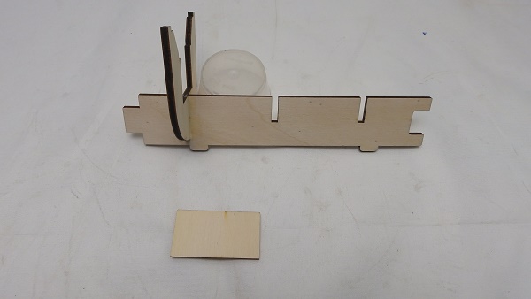

Take the frames clean them up and test fit them behind the last frame fitted to the false keel then glue them in place making sure they are at right angles to the keel.

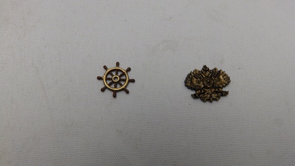

Next take the bow section of the false keel and test fit the lower deck to it, when it fits glue the deck in place. Again I opted here to paint the crest gold and add a wash like I did with the figurehead.
Now take the wheel and crest and clean them of any burrs. Paint the wheel brown and then use gold paint on the inner and outer rims of both sides. Take the crest and paint it gold then bring out the detail with a dark wash.
Stage complete.

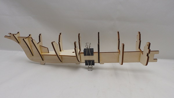

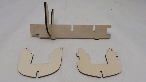

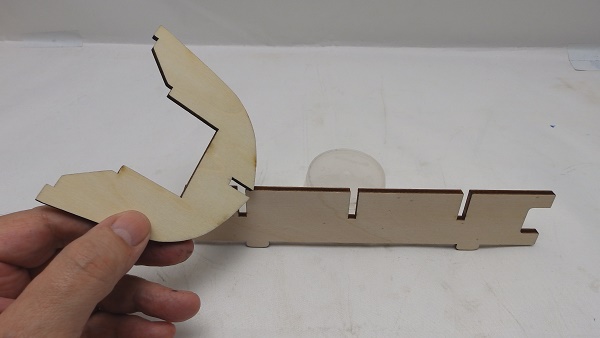

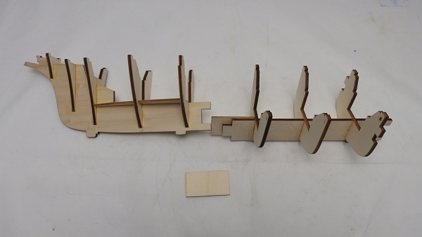

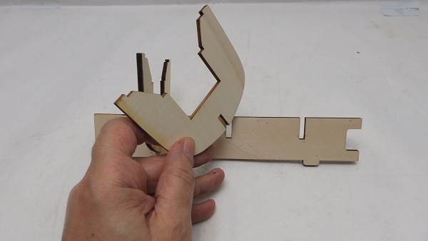

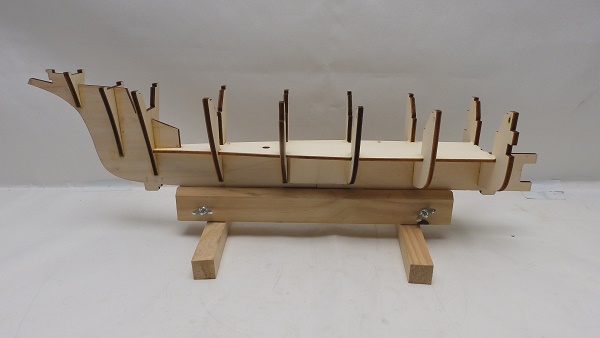

#6 Posted : 24 November 2018 20:51:13
Stage 5
Stage 5 contents
:- False keel, lower deck, reinforcements and a davit.
Take the two keel assemblies you have made and glue both together then use a reinforcement plate to cover the joint, clamp the joint together and leave to dry. When the keel section is dry take the second lower deck and test fit it to the keel and then glue it in place.
Remove any burrs from the davit and then paint it white.
Stage complete.
