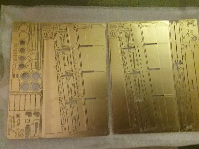

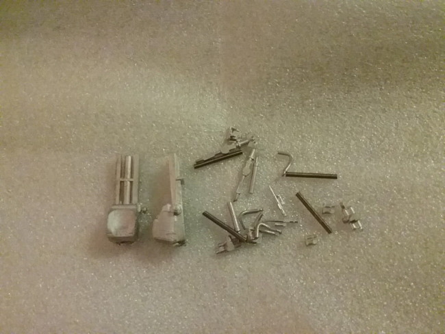

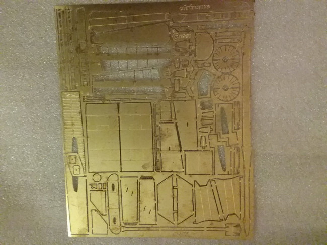

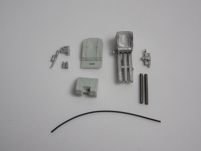

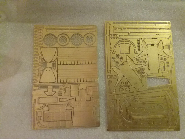

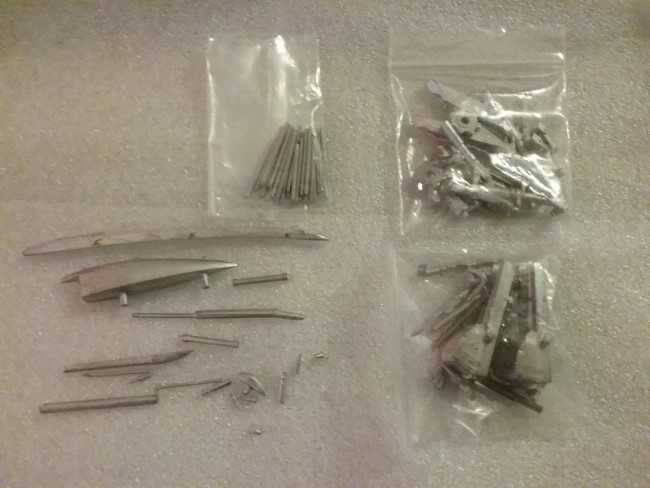

Here is my Entry into the "Last Year of the Panavia Tornado" competition
I have ordered the 1/32 Gulf war Tornado awaiting delivery. Also i have the White metal undercarriage and the Tornado book.
I have managed to get hold of the Old Flightpath Gr1 set not the conversion set.

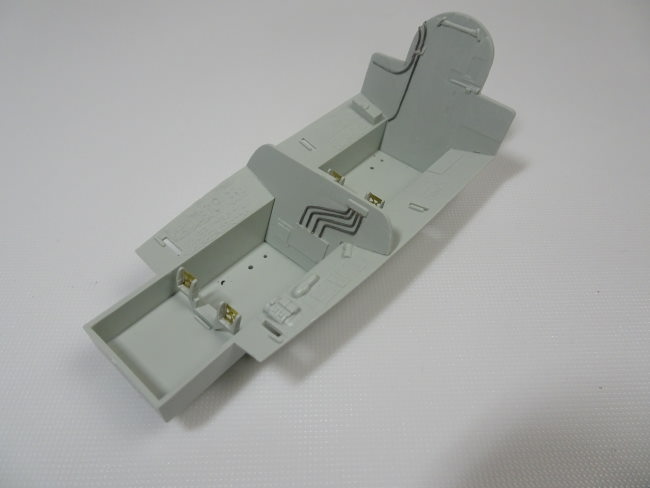

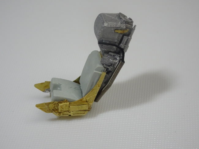

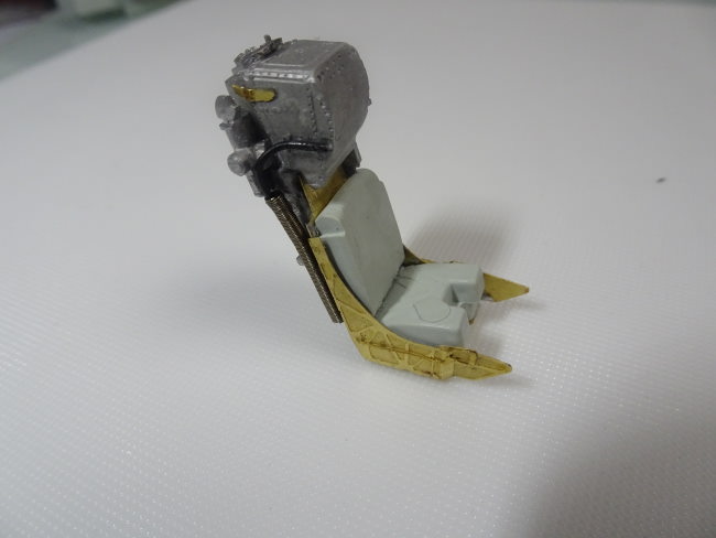

Finally I make a start on my first complex polystyrene Plastic kit with upgrades in over 10 years. So have to re-learn my skills again.
I started with the Ejector seats. Well one of them. It took a-lot of filing the white metal bits to get them to fit but I like the look. Some of the parts were wrong in the set. The Air pipes out of the side of the seat were incorrect, they gave me 4 the same not 2 left and 2 right. So I made my own from wire.
I had a few problems with the superglue not sticking. I made half the seat last night, picked it up and it fell apart. Not good. The brass bits weren't holding also the white metal parts weren't either. I roughed some of the bits up they have held up to now.
I then removed the wiring from the bulkheads and replaced with wire. I installed the pedals with the photo etch plates.
Chris Cool
#14 Posted : 23 November 2018 08:46:22
Nice start Chris, looking good. I’m sure it will all come back to you.Cool
#15 Posted : 23 November 2018 09:19:26
Nice start!
#16 Posted : 23 November 2018 09:36:05
Very nice start Chris, those seats look rather impressive.Cool
#17 Posted : 23 November 2018 11:58:38
Nice start Chris, the seat looks great.
#18 Posted : 23 November 2018 15:13:39
Nice start, good luck with the competition entry Cool
#19 Posted : 23 November 2018 17:20:19
BigGrin Nice start and looking good, by the way most plastic/resin kit parts have a release agent that needs to be washed in warm soapy water to remove it before construction begins its the same with etch parts but they have an oil coating that will need the use of a degreaser so the glue and paint will adhere to themCool
