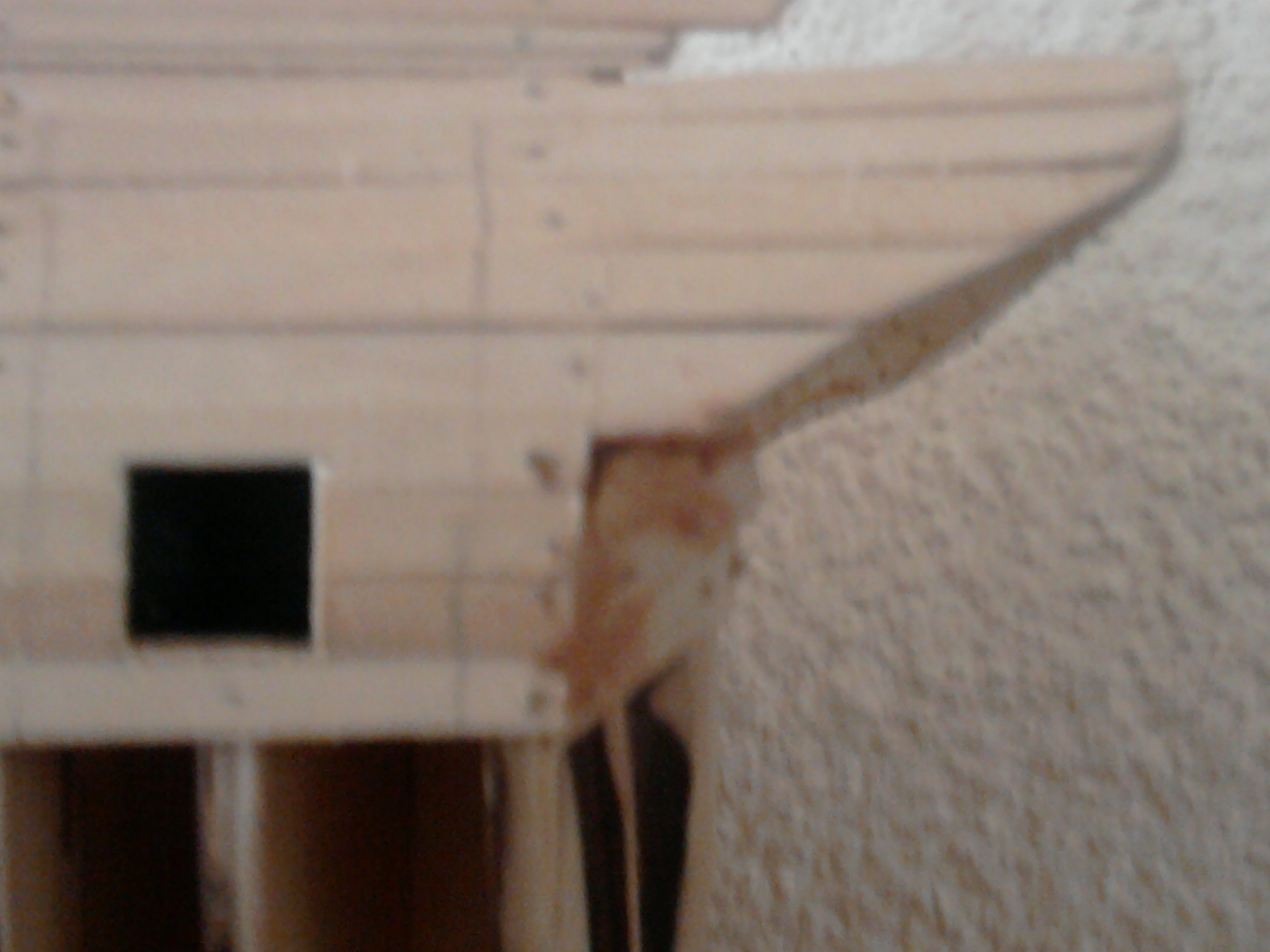

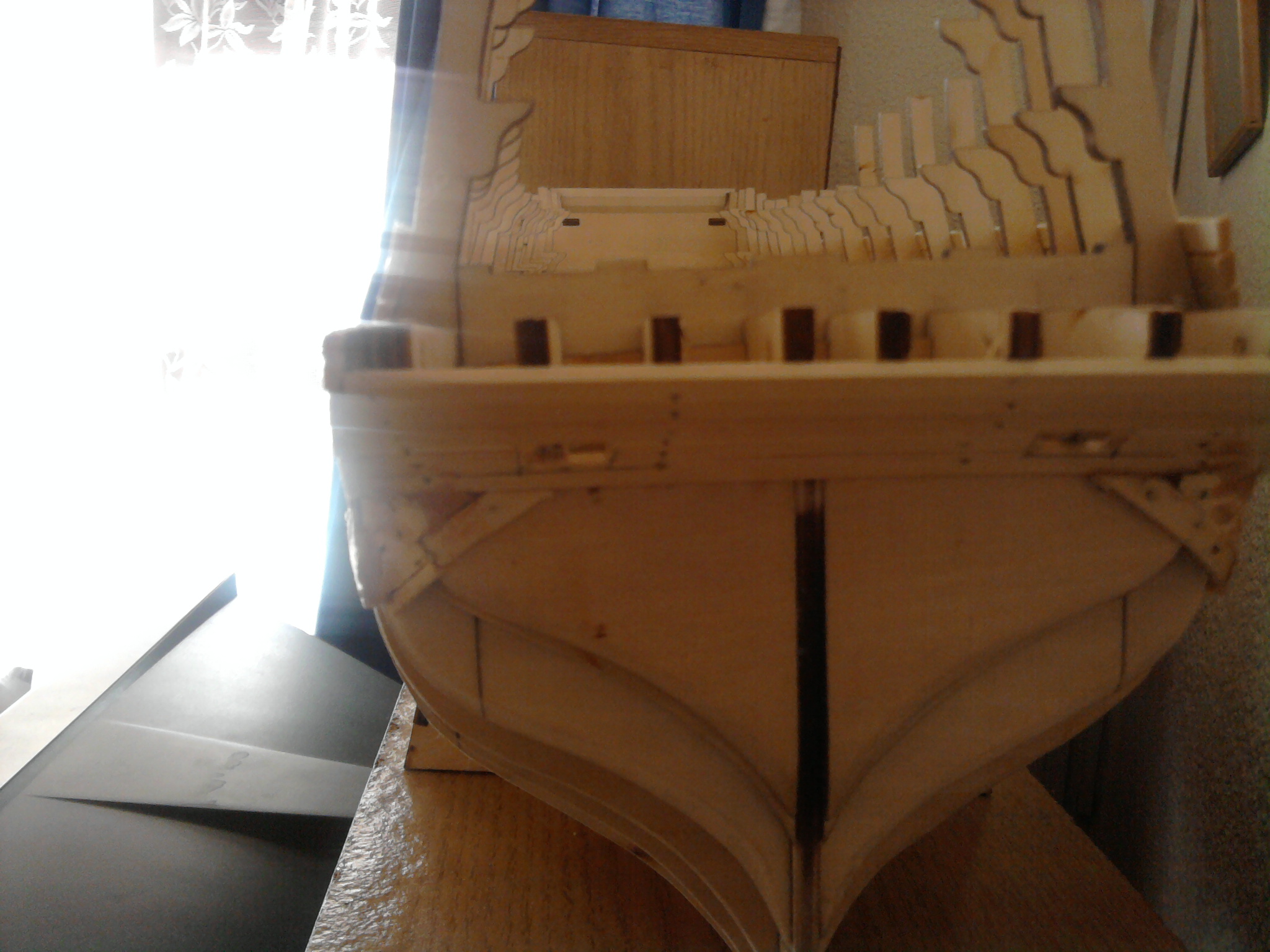

I am wondering if anyone else in SA is having this problem. According to the model pictures, the first level of planking on Victory's hull, towards the stern, ends on the bottom of the galley supports and must be in line with the lower gun deck. This was fine until I saw that my first layer is not in line with the bottom of the galley supports, in fact, it is about three layers out (when using the lower gun deck as a guide). I carried on, thinking that maybe the galley is going to be smaller than the books example, but when it came with issue 40, this was not the case. How does one rectify this, I was thinking either extending the last ribs up to accommodate more planking, or somehow shortening the galley structure (which seems foolish).

Arnold, I cannot make out the first pic, but from the 2nd pic, it looks like the frame is either not properly seated, or not sanded back completely.

see the keel the bit it looks black in your photo sand back at 90 deg to the keel the last frame till you just start sanding the black off the keel all the way dont be afraid when the last frame seams to disapear at the bottom that why there 3 frames glued to geather there is an angle at the back top to bottom ps your second last frame dose look to high

I can see what has happened when you fitted rib 30 into its slot you got it all the way down this is great. Rib 31 has court the top of its slot and hasn't gone all the way down its slot, this has made your gallery supports too high.
To correct this remove the lower planks at the stern, next remove the gallery supports with their planks if you can get hold of a steam cleaner or a steam wallpaper stripper use its jet to heat the glue on the supports at rib 31 and rib 34. The steam will heat the glue and the moister will soften the bond so you can slowly ease the sections off, if you can’t use steam, use some hot water. You will need to remove ribs 31 & 34 using the same method, once they are off let them dry, clean them with sand paper.
Next refit the ribs 31 & 34 in there correct place make sure that this time rib 31 fits all the way down the slot, you can mark across the end of the slot on the keel and the rib use these marks to check you have fitted the rib correctly. Fair the stern again to get the stern shape right.
Refit the gallery supports and the planking under them, you will need to fix a new plank sections to the side of the gallery supports, use the template in issue 24 to shape the planks that were next to the gallery supports before you started the corrections.
At least you found it before you went too far. It's not hard to sort-out at this early stage, and if you’re going to paint the hull you can hide the joint and only you will know.
