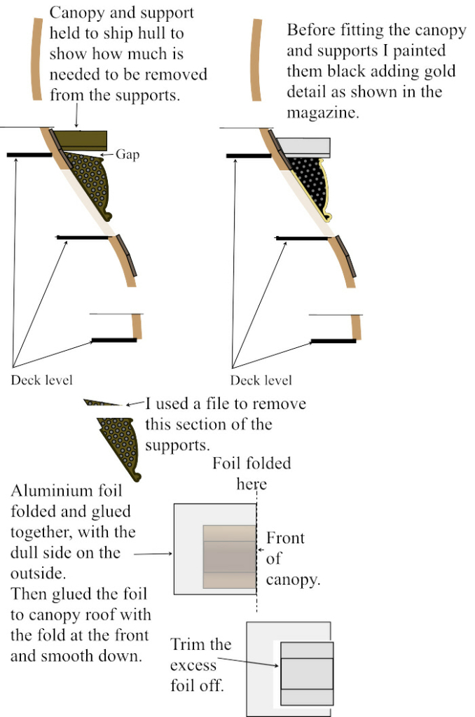

Everyones hull will differ, the fit of my canopies only had a small adjustment to make (material removed fron the tops of the supports), though the fit gap of your's does seem excessive.
To close the roof gap, you'll need to remove material at a corresponding sloping angle (wedge shaped) from the top surface of the supports, which in turn will close the roof gap, which is what the mag info relates to where it says - "Hold the side supports and roof in place on the hull, you may need to file the tops of the support to match the angle of the roof." - Obviously the roof needs to be removed from the supports to to be able to carry out this adjustment.

#8 Posted : 06 September 2011 18:18:34
Here you go Tom, a drawing courtesy of SoB, where the drawing outlines exactly what I said about the material removal
