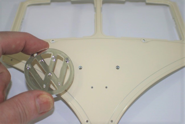

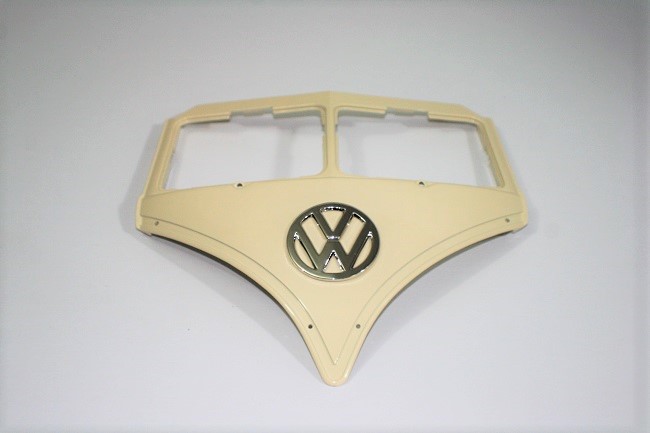

Stage 1 Contents: Body front, Volkswagen logo and Screws (BP01)
Note: At any time during the assembly when right or left are mentioned, this refers to your right and left as if you were sitting at the wheel of the vehicle.
The Body Front
Take the Volkswagen logo and place it onto the body front by inserting the pins on the back of it into the holes in the panel. Now secure the logo to the body front with two BP01 screws by inserting them through the holes on the inside of the body front and tighten them carefully.

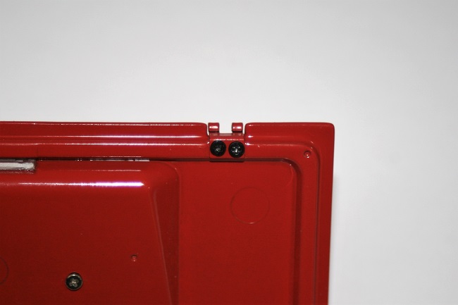

#3 Posted : 10 October 2018 20:19:37

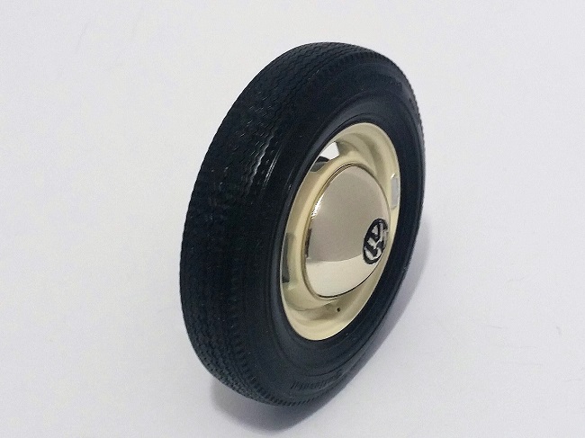

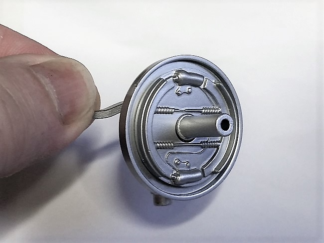

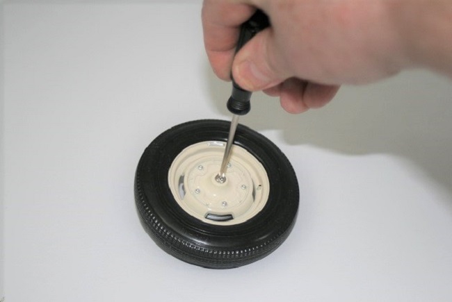

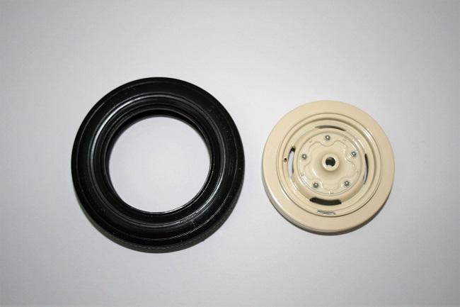

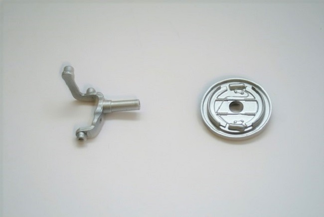

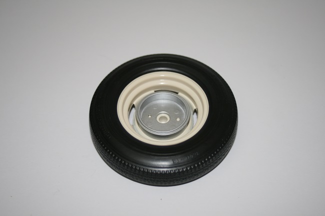

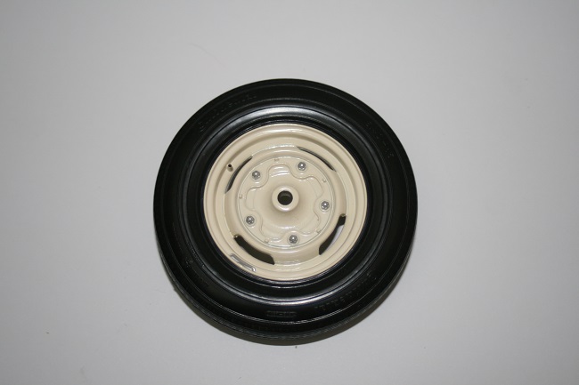

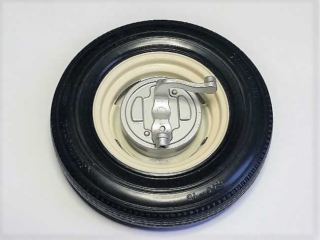

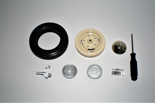

Stage 2 Contents: Tyre, Wheel, Hubcap, Brake, Brake drum, Hub, Screw (BD01) and Screwdriver
The left front wheel
NOTE: To make it easier to fit the tyre onto the wheel, either carefully heat it slightly with a hair dryer or immerse it in hot water for a few minutes. Doing this will make the tyre softer and more pliable while you fit it and it will harden again as it cools.
When the tyre is pliable insert the wheel into the tyre by lifting the wall of the tyre over the edge of the wheel. Now turn the wheel around and repeat on the other side checking that the edges of the tyre are positioned correctly on both sides of the wheel.
Fit the brake drum to the inside of the wheel by placing it onto the two pins, noting that the pins are different sizes so the drum will only fit one way.
Now fit the brake and the hub together then insert the shaft of the hub into the hole in the centre of the drum and wheel. Secure the parts together with a BD01 screw. Now hold the hub with one hand and check that the wheel can turn freely. Loosen the screw slightly if it cant.
Tip: You can opt to paint the hub caps VW logo black or leave them chrome.
Finally press the hubcap lightly into place on the outside of the wheel ensuring that its in the correct position and the magnet is holding it securely in place.

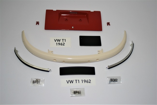

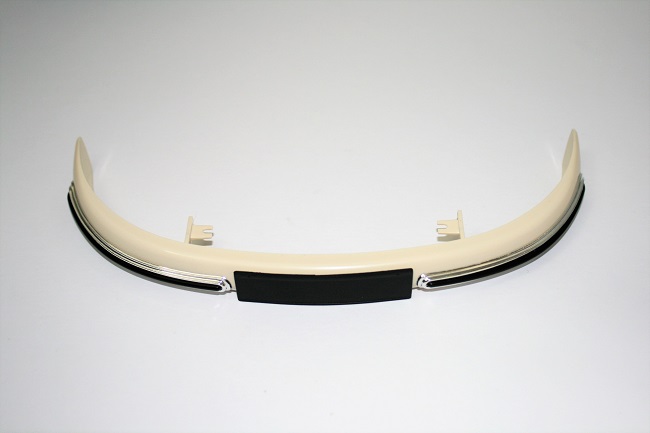

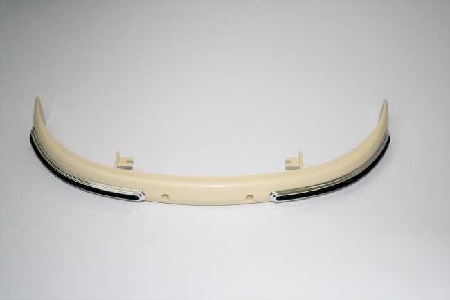

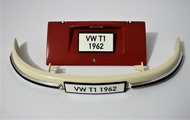

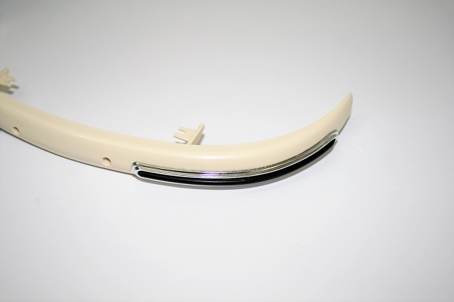

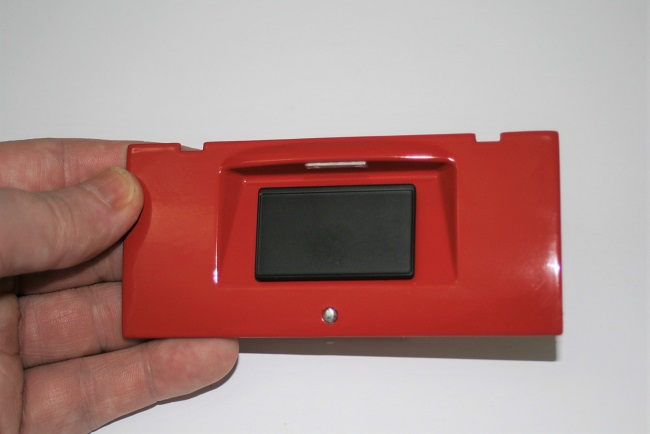

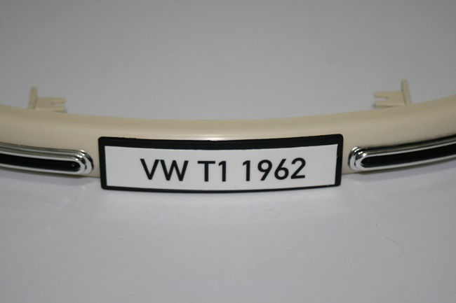

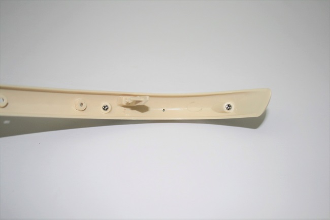

Stage 3 Contents: Front bumper, Front number plate mount, Engine cover, Right front bumper insert, Left front bumper insert, Front number plate, Rear number plate mount, Rear number plate, Hinges, Screws (BP01), (BD02) and (BP02)
The Front bumper and Engine cover

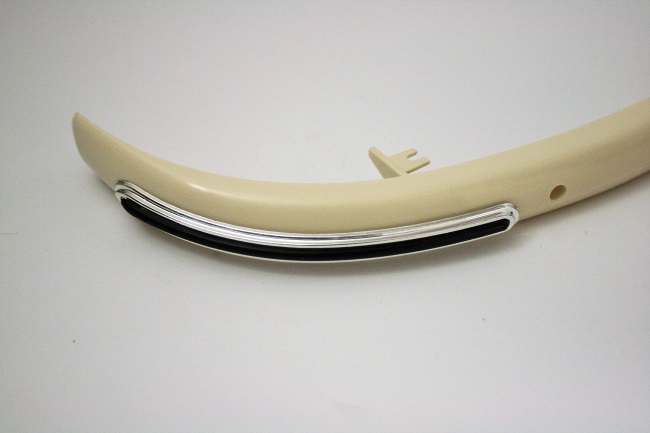

Fit the front right bumper insert indicated by the letter R to the right end of the front bumper, inserting the posts into the corresponding holes. Secure from the inside of the front bumper with two BP02 screws. Mount the left bumper insert to the front bumper in the same way, secure it with two BP02 screws.
Insert the two posts on the front number plate mount into the two central holes in the front bumper. Secure the mount to the bumper with two BP02 screws.

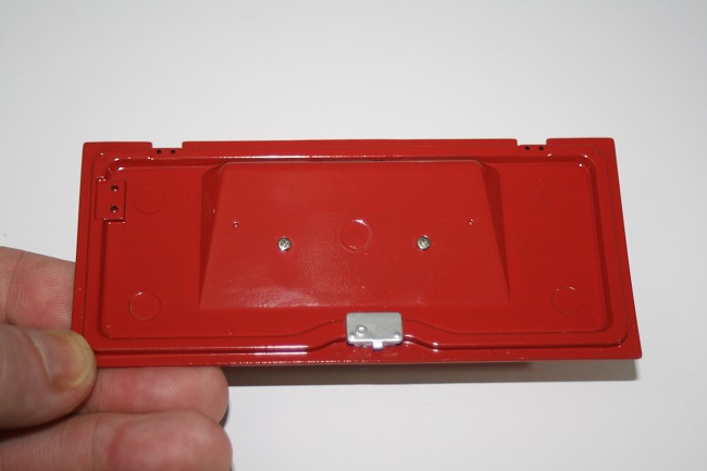

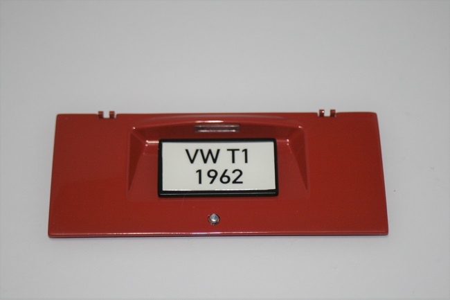

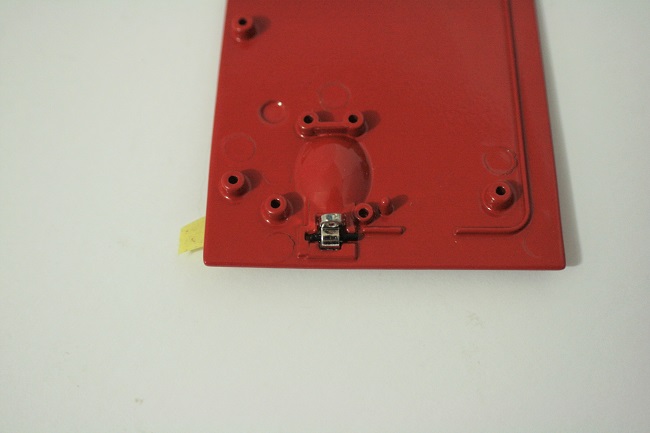

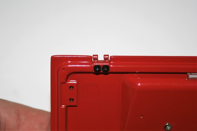

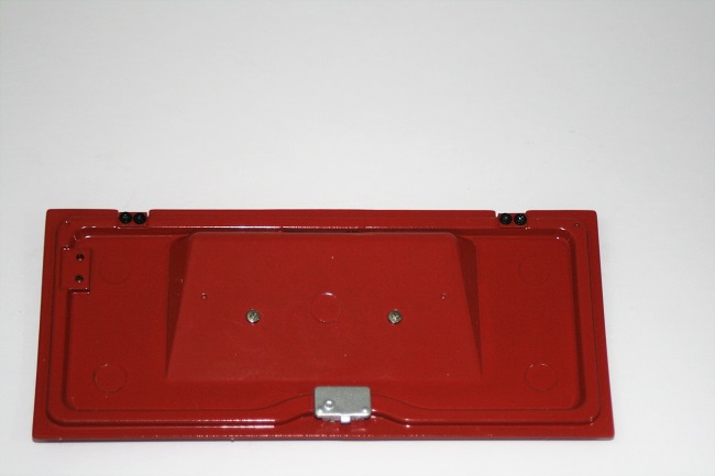

Insert the posts on the rear number plate mount into the holes in the engine cover. Secure the mount with two screws BP01.
Place one of the hinges onto its mounting point on the engine cover making sure you align the holes of both parts and secure the hinge to the engine cover with two BD02 screws. Then fit the second hinge at the other end of the engine cover securing it with two BD02 screws.
Remove the backing paper from the front and rear number plates in turn and fit them onto their respective mounts.

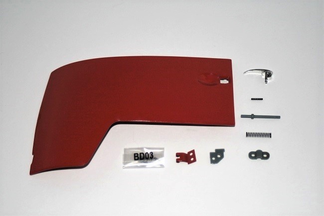

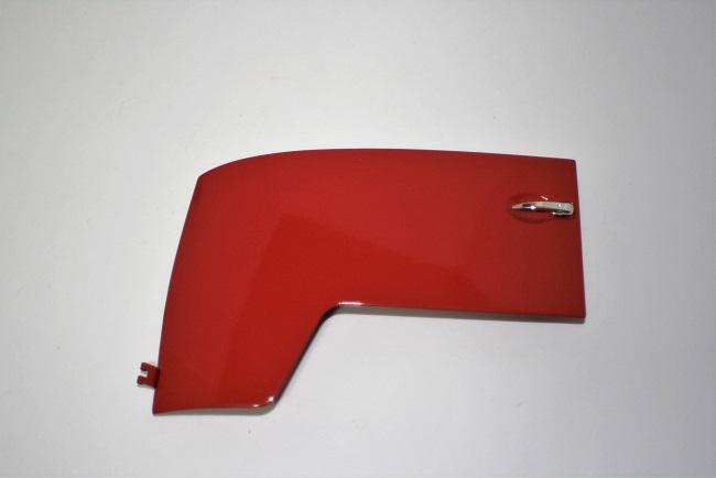

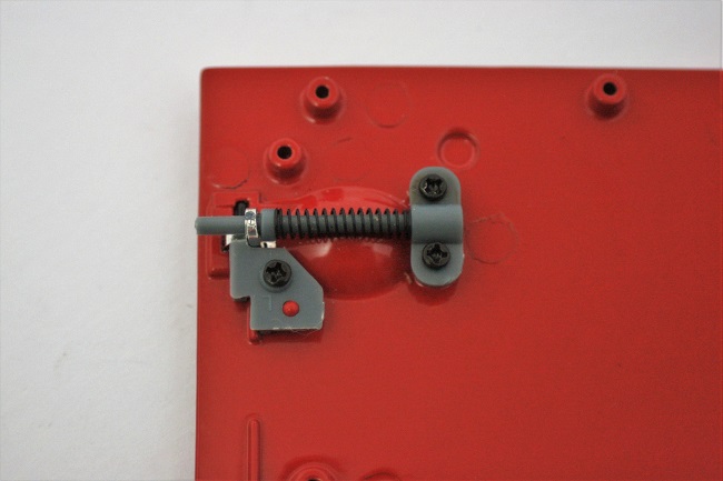

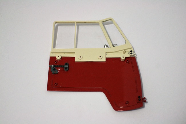

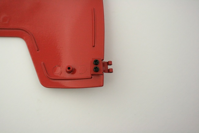

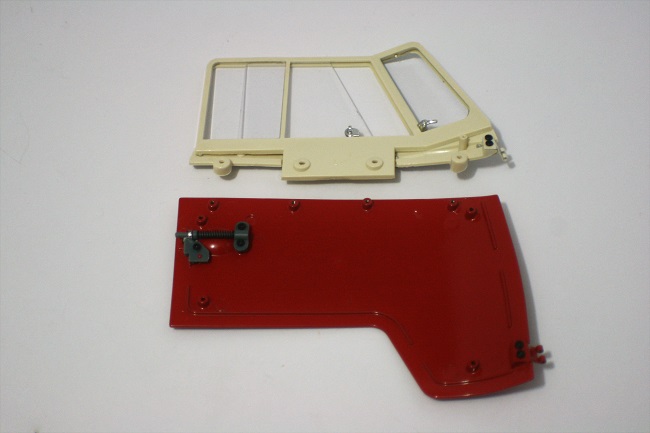

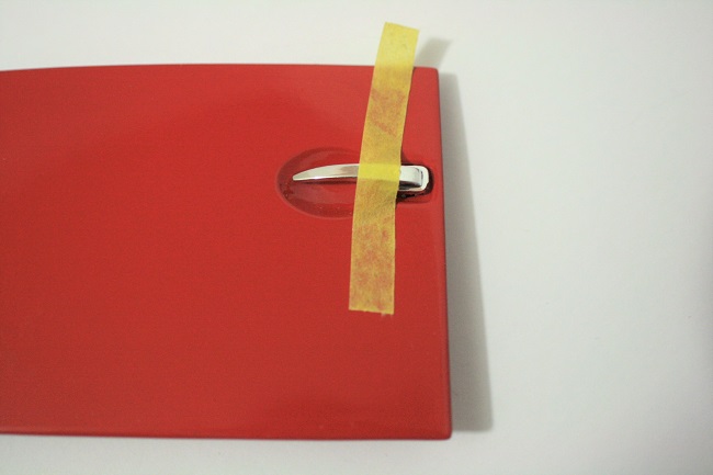

Stage 4 Contents: Left front door, Hinge, Handle, Pin, Bracket, Rod, Spring, Rod guide and Screws (BD03)
The left front Door

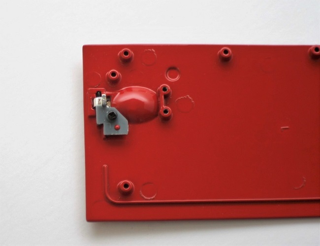

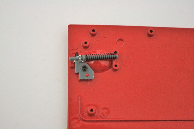

Fit the hinge into place on the inside of the left front door and secure it with two BD03 screws. Next insert the handle through the opening in the door and temporarily secure it with some low tack masking tape. Now insert the pin through the part of the handle on the inside of the door, placing the bracket onto the pin and the post then secure the bracket with a BD03 screw.
Insert the rod into the spring and insert the free end of the rod through the opening in the handle. Finally mount the rod guide onto the posts on either side of the rod and secure it with two BD03 screws. Note: The spring should be pulled back so that it is outside of the guide.

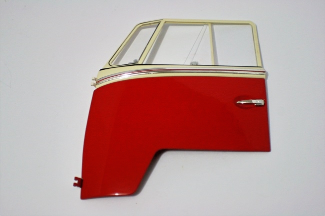

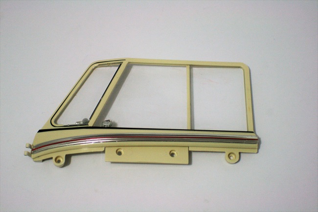

#6 Posted : 13 October 2018 18:17:35

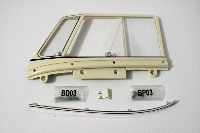

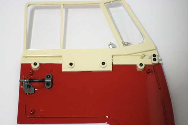

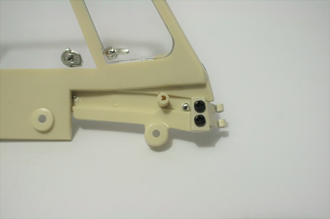

Stage 5 Contents: Left front door window frame, Trim, Upper door hinge, Screws (BD03) and (BP03)
The left front door Window

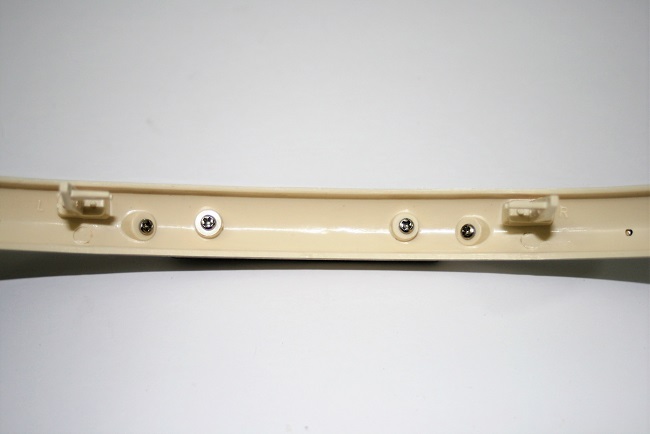

Align the holes of the upper door hinge with those in the left front door window frame and secure with two BP03 screws. Position the trim into the groove along the outside of the frame aligning the pins and corresponding holes, carefully press the trim into place.
Retrieve the front left door from Stage 4 and place the holes at the bottom of the window frame onto the posts at the top of the door, then secure the window frame to the door with four BD03 screws.
The windows of the model are fully functional: the side window can slide forwards and backwards and the quarter light pivots, as on the actual vehicle.
Pack 1 is now complete, carefully store any remaining parts in a stage labelled bag.
