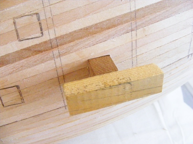

Hi Ronald, normally I check the ports by making up a jig. Made one up from a wooden strip that was 12x12mm…..
ronald305
#9 Posted : 30 September 2018 18:41:23
Joined: 08/02/2015
Posts: 426
Points: 1,259
Location: Louisiana
I've tried to make one out of pieces of tin first then out plywood left over from the bow fillers, I will try to make one like you have in the picture
Ronald
