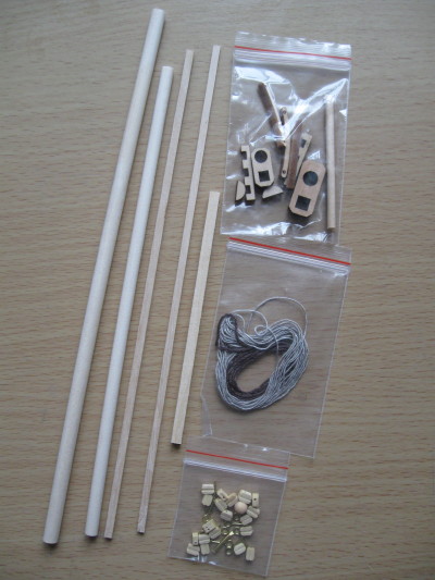

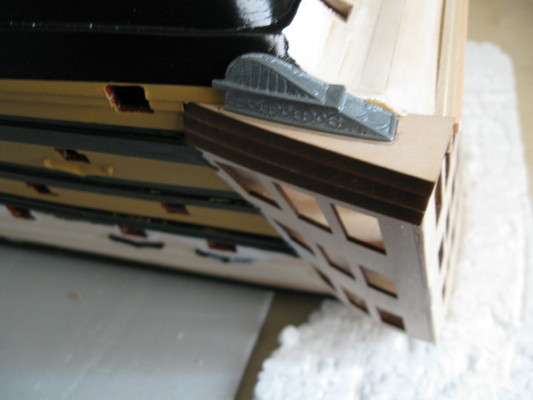

Issue 76 - Contains wood strips, gallery support trims, finials and three 12-pounder gun kits; and has instructions for completing and finishing the gallery support, and fitting the inner bulwark mouldings.

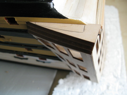

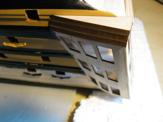

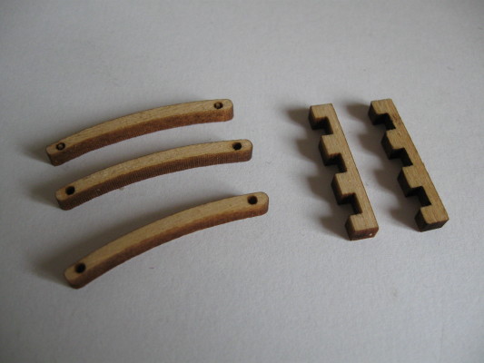

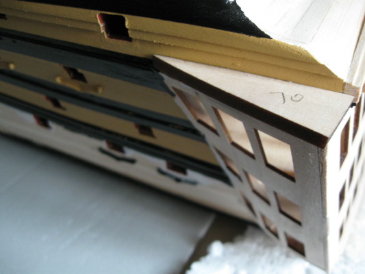

Completing the gallery support - You will need the six #70 shaped parts supplied with issue 41, make sure that the ends of the gallery support filler strips are flush with the side planking, trim or sand them if necessary.
Place two of the #70 parts in position beneath the gallery and make sure that they slip under the wale as they sit against the hull. if necessary, you cam trim away the top of the wale, (make sure that the parts sit flat on the gallery false deck and sand the deck if necessary). When you are satisfied with the fit, glue the two #70 parts together, but DO NOT GLUE them to the model, as you will need to remove them later.
Take the third #70 parts and make sure this also slips underneath the thicker wale, then glue this part to the other #70 parts.

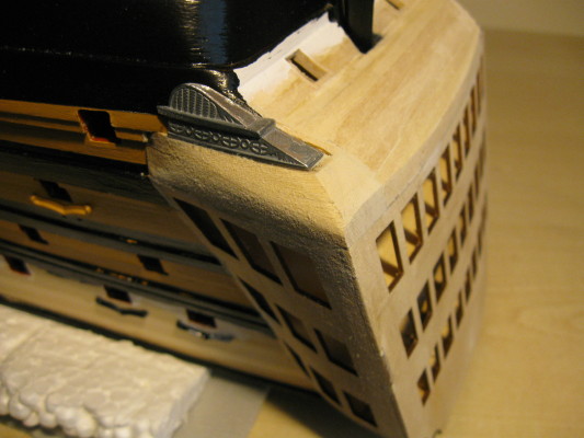

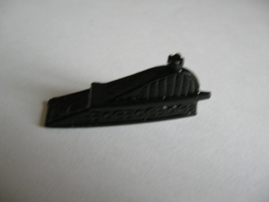

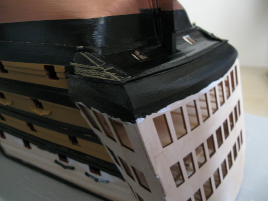

Take the gallery metal casting, and try it in place, the rear end should follow the line of the gallery support, while the front should stop short of the end of the third #70 part. When you are satisfied with the fit of the casting, carefully mark around it with a pencil.
Then remove the stack of #70 parts from the model, (ensure that the glue has fully dried before you attempt to shape the stack), and then shape the stack making sure you stay outside of the pencil line just made.

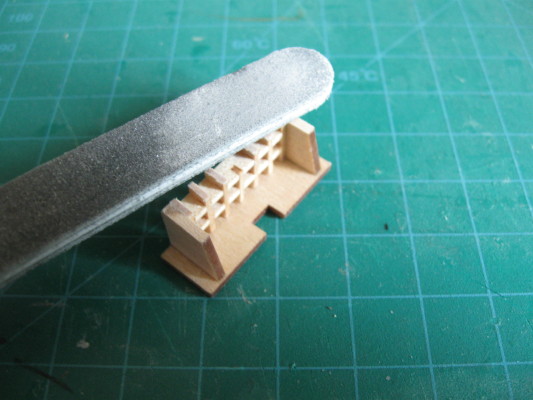

Sand the part until it is just oversized, trying it in position frequently to check the fit, then smooth with fine sandpaper.
You may find that there is a step between the gallery support and the block you have just sanded, adjust the position of the block and /or casting so that the step is less than 1mm. Then glue the block into place (but yet glue the casting to the block).
Repeat the block fitting process on the other side of the model, then sand the back and both sides of the gallery support flush with the gallery walls.
Fill any remaining gaps with wood filler, and then sand the rear of the gallery support to form a smooth curve that blends the rear gallery wall up to the point where the gallery support changes angle.

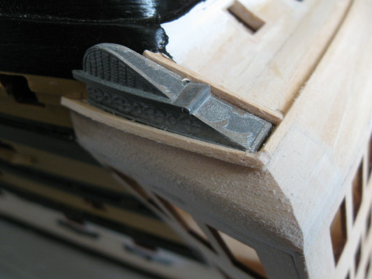

Use a little PVA glue to temporarily glue the gallery metal castings into place, (this will form only a weak bond which can be easily parted later on).
Glue a strip of 1.5 x 1.5mm wood under the gallery support so that it extends across the ends of the metal castings, (you will need to form a slight curve in its length to follow the line of the gallery).
Add another strip along the outside edge of the castings - you will need to bend the strip to conform to the slope. Add a final strip along the inner edge of the castings and again bend to follow the slope of the gallery support.
Insert a knife blade on the inside edge of the casting to gently release it from its PVA bond - (You should protect you eyes against the unlikely event of the blade snapping).

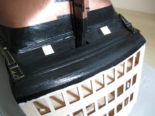

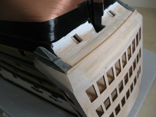

Fitting the stern gun port covers - Fit the two stern gun pot cover while you can still turn the model upside down, the hinges are supplied with a later issue and will be easy to add at that time.
Cut four 10mm lengths from some left-over strip. Lightly chamfer the two meeting edges to emphasise a joint line, then glue the pieces together in pairs to form two complete gallery gun port covers.
Test fit the covers and make any adjustment needed, then paint both to match the finish of the gallery and glue into place.

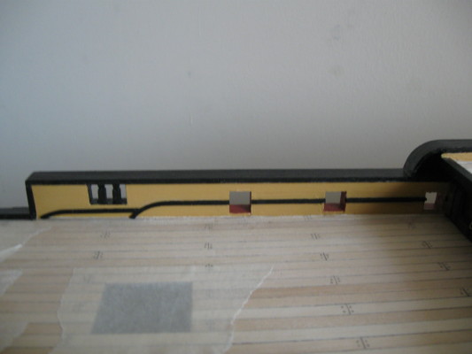

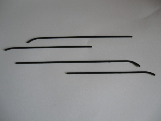

Fitting the inner bulwark mouldings - There are two lengths of curved mouldings running along the inside of the bulwarks; to make them, you will need the 1.5 x1.5mm strip supplied with this issue.
Using the template as a guide, carefully bend strips of 1.5 x 1.5mm strip and leave over-length so you can cut to fit.
For the natural version of the ship, stain the three visible edges of the mouldings walnut, or paint them black for the painted version.
Fit the longer length into position, trimming the ends to fit neatly, then glue into place. Then ad the shorter length, trimming its ends to match the angles of the deck and where it meets with the longer strip.
Finally, use a sharp blade to carefully cut away the short sections of moulding that span the gun ports, and touch in the cut ends with your chosen finish.
Repeat the fitting of the moulding trims on the opposite bulwark.

Issue 77 - Contains the mizzen mast plan, assorted wood strips, mizzen mast top parts, blocks, thread brass wire & eyebolts; and has instructions for assembling the mizzen mast top, assembling the skylight and fitting the first knees.
Issue 78 - Contains mizzen bibbs, pinrail, driver boom saddle, blocks, threads, net, brass wire, brass stanchions and belaying pins; and has instructions for the assembly & finishing of the mizzen lower mast, and constructing & finishing of the the flag lockers.
Issue 79 - Contains assorted strips & dowel, threads, brass wire, eyebolts, cross tree parts, caps, guides and assorted blocks; and has instructions for preparing & finishing the mizzen topmast, making the deck rails, and constructing & finishing the belfry.
Issue 80 - Contains assorted wood strips & blocks, yard slings, brass wire, assorted threads, lantern parts & acetate sheet; and has instructions for making the cross jack yard, the mizzen topgallant, completing the cockpit rails, adding the mizzen mast eyebolts and adding the poop deck forward rail.

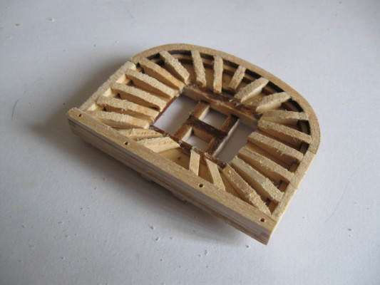

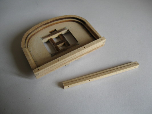

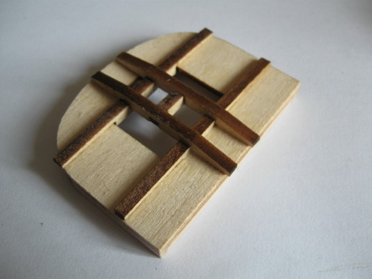

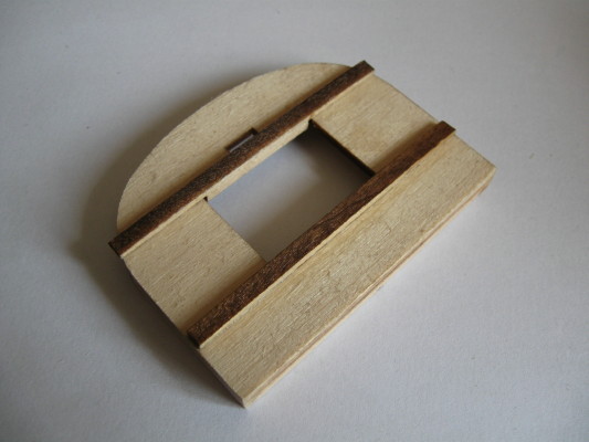

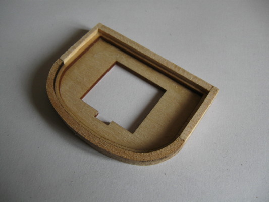

Assembling the mizzen top - The assembly of the mizzen mast top is very similar to the assembly of the main mast top, which was covered in issue 61; the main difference being that the mizzen top has five eyebolts and a single double block. I found that the pack contained a spare central spacer (at step 4) as the mizzen top only has room for one.

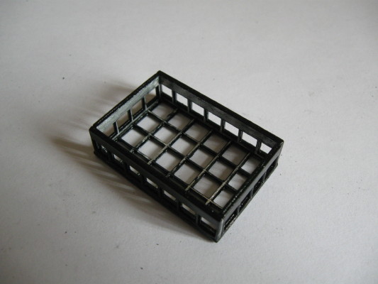

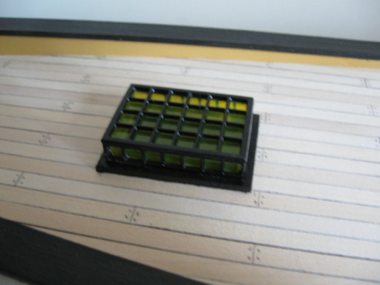

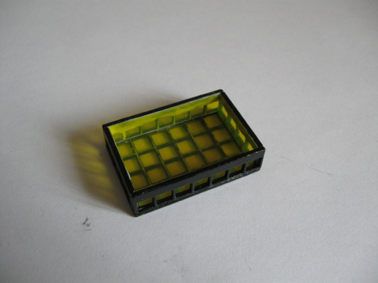

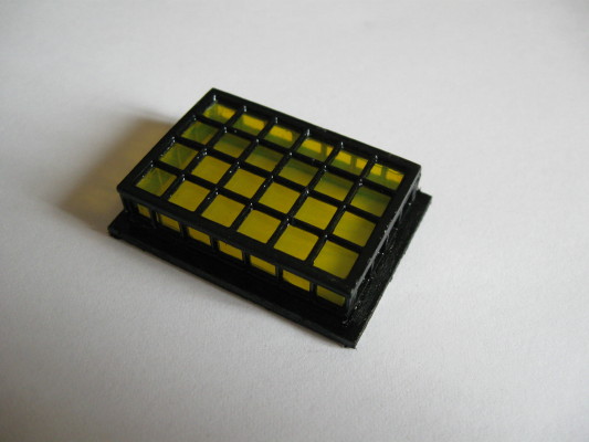

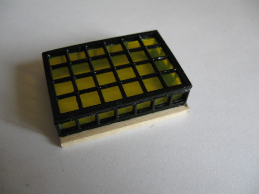

Assembling the skylight - You will need the die-cast metal parts supplied with issue 58, and the yellow acetate that came with issue 60.
Take the five metal castings and sand the inside surfaces to remove the paint; you also need to remove paint from the tops and bottoms of the longer sides. the shorter sides need the paint removed from the tops, bottoms and ends.
Take one long side and glue it to the roof using a gap-filling (gel) Superglue. Make sure you get the two parts at right angles with the ends lining up. Then add the sides, again making sure all is square. (Do Not try to bend any of the castings as they are quite brittle and will snap). Add the remaining long side, then fill any gaps and touch up with black paint.
Allow the glue & paint to dry thoroughly before fixing the acetate's.
Cut a rectangle of acetate to fit the top, remove the protective film, and then glue into place using such as Forumla 560 canopy glue', (this glue dries clear and is designed for the installation of clear parts); Do Not use Superglue, it will fog the acetate!
Cut four smaller pieces of acetate to glaze the sides of the skylight and glue them into place.
Cut a length of 2x2mm strip slightly longer than the longest side of the skylight, glue it into position with superglue, and then repeat at the opposite side. complete the skylight frame by adding two short strips, then smooth the ends/corners flush.
Stain the skylight frame in your choice of finish or paint it black.

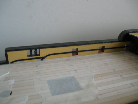

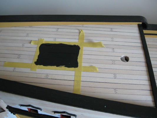

Mask a rectangle approx 25x36mm, which is located on the centre line, 74mm back from the front edge of the poop deck. Paint this area black, but before you start painting, double check that the painted area does not fall outside of the skylight footprint.
Remove the masking tape and then glue the skylight in place over the black rectangle, so that it starts 72mm from the front of the poop deck.

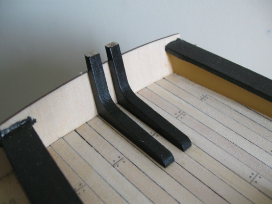

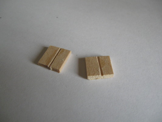

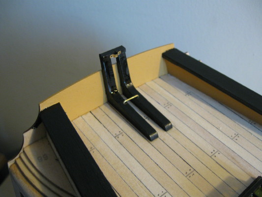

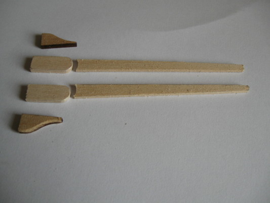

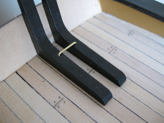

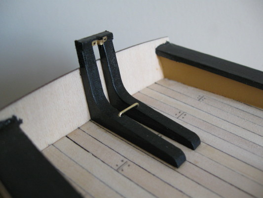

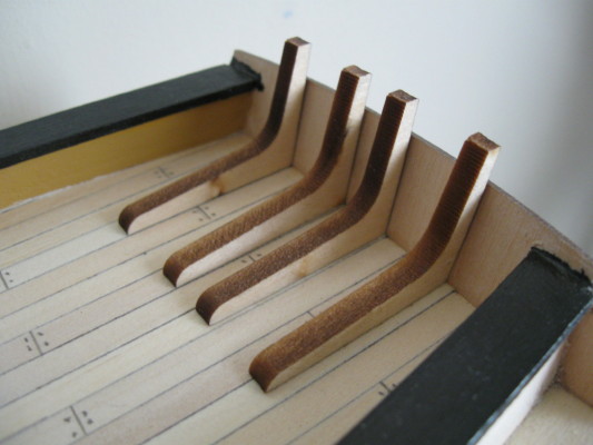

Fitting the first knees - You will need parts supplied with issue 58. You'll need to trim all four knees to fit the poop deck, but only fit the centre pair of knees, the outer two are not fitted until later, when you complete the flag lockers.
Take the four 'L' shaped knees, and check that their rear angle matches the angle of the gallery panel, sand the knees if necessary. Place the inner knees either side of the centre plank, 5mm apart. the outer knees fit centrally in the remaining gallery panel gaps.
Carefully store the two outer knees and do not paint them.
Take the two inner knees and sand a radius on the inner edges, except for the top face where you will fit the cross bar, then stain the knees or paint them black.

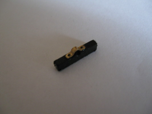

Glue them into position, making sure they are straight and upright, then cut a piece of 2x3mm strip to span the tops of the two knees, then file a semi circular groove about 1.5mm deep in the centre on one side of the strip.
Glue the brass fitting over the groove, then paint or stain the strip to match ther knees, then glue the piece into place.

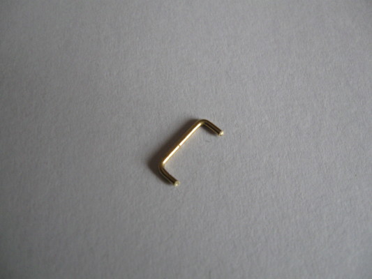

Take the 0.8mm brass wire, and form a 'U' shape with a 9-10mm span, then drill two 1mm holes in the knees and glue the 'U' shaped wire into position.

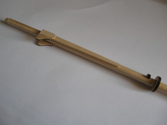

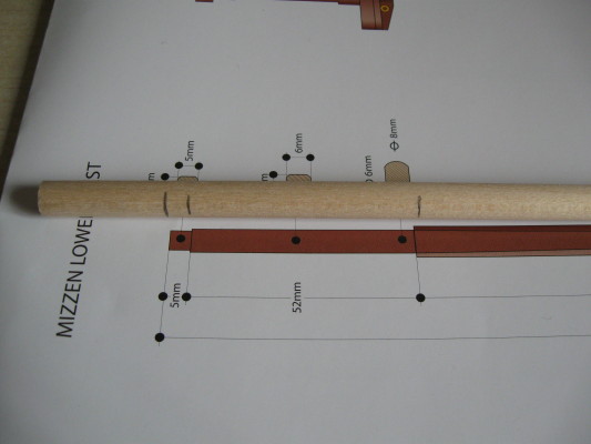

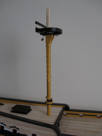

Assembling the mizzen lower mast - This is a similar build to the previous lower masts, where you might want to refer back to the relevant issues for more detail on the construction techniques.
Editorial would like to offer its apologies for the printed dimensions errors on the Mizzen mast Plans that came with issue 77.
If you could please ignore the printed dimensions and use the plans as a direct-measuring pattern (ie, as instructed in the steps).

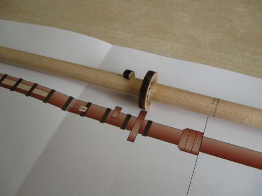

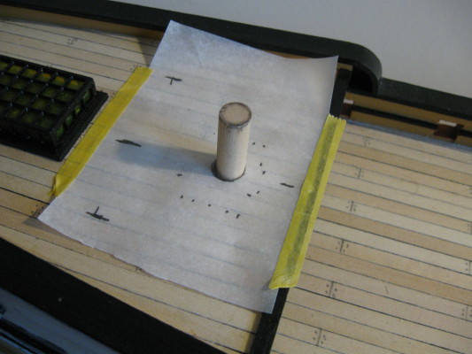

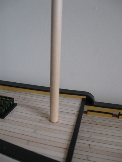

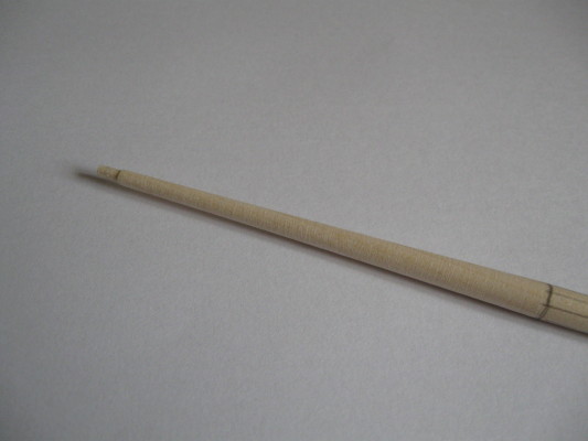

Start by marking the 8mm dowel for the two top square sections, poop deck level and the bottom cheeks, cut the mast to length and carve the 6mm square section and the smaller 5mm square section at the top.
Sand the flats on either side of the mast to accept the cheeks and hounds, not forgetting that the cheeks are tapered strips.
Sand a chamfer at the bottom of the mast to make it easier to insert, you may have to slightly taper it to ensure it slides to the bottom, the deck level should coincide with the deck level mark already made, if not remark it now.

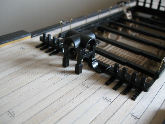

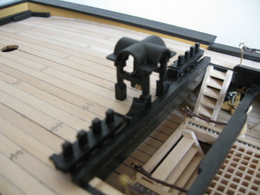

Add the circular pin rail and the semi circle of the driver boom saddle to the mast at the marked point shown on the plan.
Note that the driver boom saddle faces AFT, as the boom will rest on this later on, while the holes in the circular pinrail should face FORWARD and be central to the mast.
Cut and then taper the cheeks from 5.5mm at the top to 3mm at the bottom, I then added the bibbs, hounds and cheeks to the mast.
If going the natural route, stain the mast in your chosen colour and paint the bottom section below the poop deck level mark, black for at least 30mm as this will be visible in the space behind the ships wheel.
Then make the mast bands with the black thread, using the same technique as before, taking four turns of the thread to make each band.
For those going the painted route, add the thread bands and then paint the mast yellow ochre, and paint black BELOW the deck line mark for at least 30mm long.
Finally glue the mizzen top to the mast making sure it is square and straight, then paint the belaying pins black and insert them into the holes of the mast pinrail.
You can test-fit the completed mizzen lower mast in place, but DO NOT glue it at this stage.

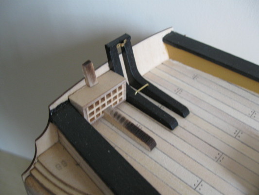

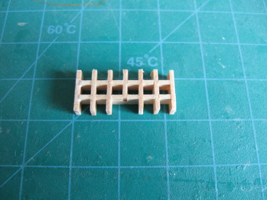

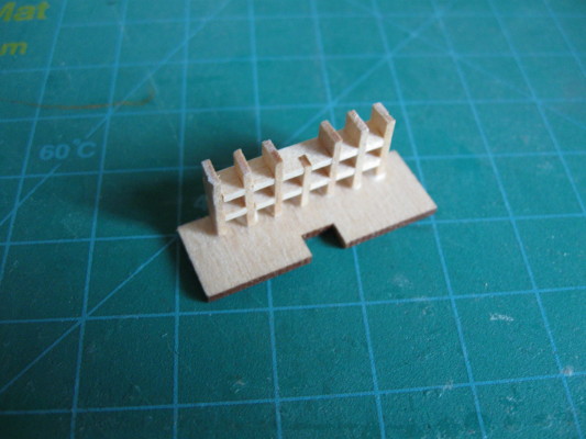

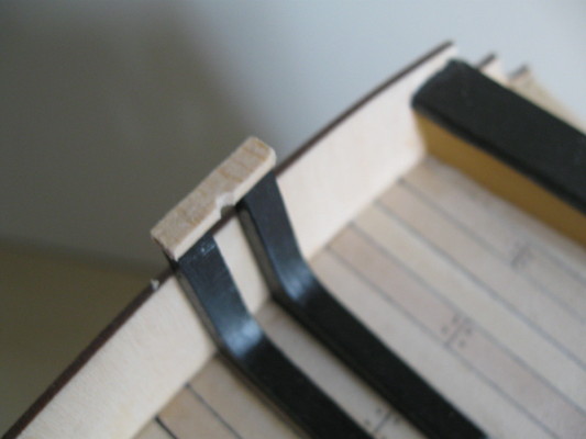

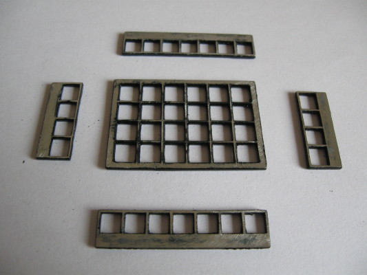

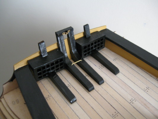

Completing the flag lockers - The parts supplied for the flag lockers were supplied in issue 58, the flag lockers are assembled so that they fit around the outboard knees on the poop deck which you started last time.

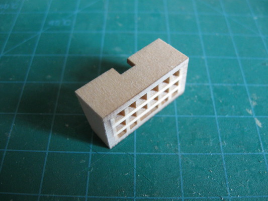

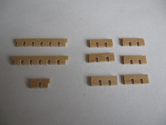

Cut nine sections of grating strip to the lengths shown in the magazine, noting that the three on the left have ends of the notches projecting, while the six on the right are trimmed flush.
Glue the strips together to form a grid, note that the short piece goes in the centre, leaving a gap.
Glue the grid to the top of the flack locker part, which is the wider of the two strips with a large slot in the middle. Align the grid flush against the face without the slot. Make sure the gap in the grid is on top and that it lines up with the slot.
Glue the two sides of the flag locker against the ends of the grid, ensuring that the straight edge aligns with the face of the grid and that the angled edge slopes in the direction shown.
Carefully sand the grid flush with the sides, ensuring that you keep the face straight, then glue the bottom to the flag locker, making sure that its slot aligns with the slot in the top of the locker.
Remove the overhanging ends from the top and bottom of the locker, and sand the front, top, bottom and sides smooth with fine sandpaper.

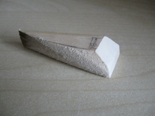

Take one of the two knees and sand the inside curve to form a sharp corner, then round the front facing edges.
File the inside edge of the slot in the flag locker to match the slop of the knee, keep test the knee and locker in place being careful not to sand off too much.
You'll need to sand the back edge of the locker to fit the slope and curve of the gallery panel, keep sanding a little at a time until the locker fits neatly into place.
Repeat the locker assembly steps to make a second locker at the oposite side, then stain the lockers and knees or paint them black, then glue them into position, (though for those painting, it would be an idea to paint the inside of the gallery panel yellow ochre before the painted flag lockers are glued into place, rather than after).
Finally, carefully trim the tops of the outboard knees flush with the top of the gallery panel, then paint black or stain the cut ends.

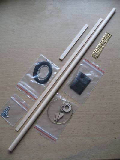

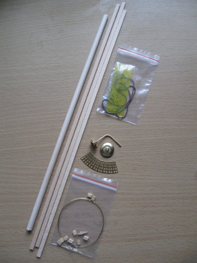

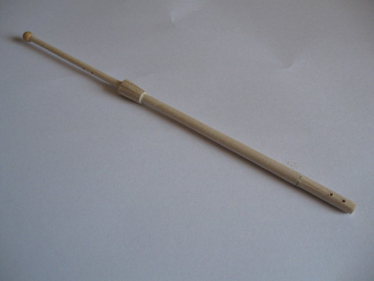

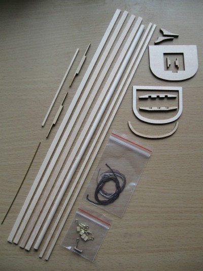

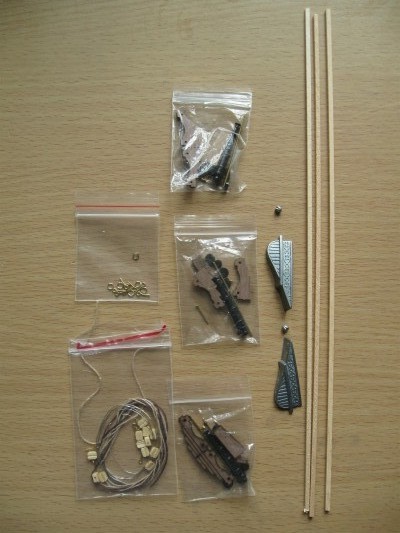

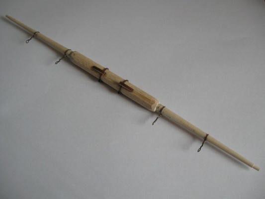

You may find it helpful to refer to the main topmast assembly (issue 63) and fore mast assembly (issue 69).

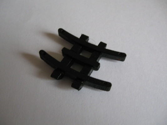

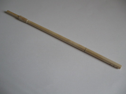

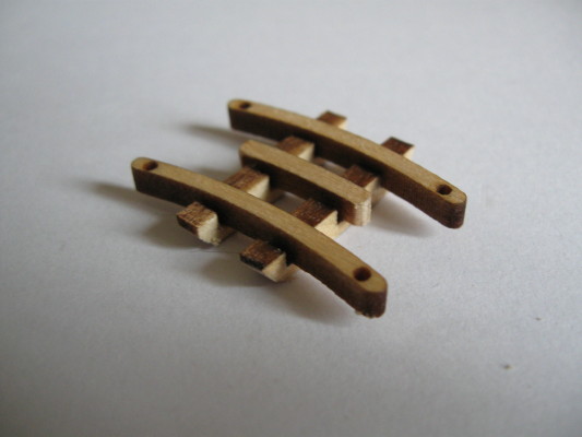

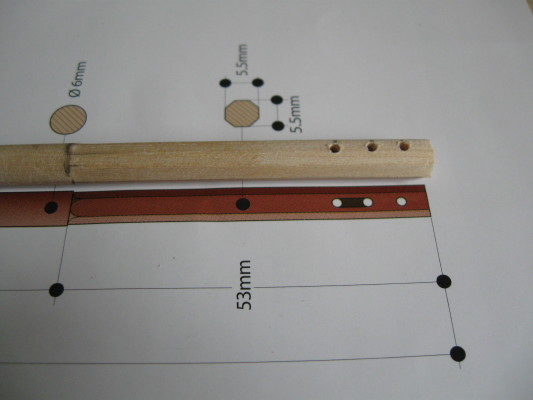

Preparing the mizzen topmast - Start by assembling the cross tree parts; take one of the cross trees and cut 7.5mm off each end. Then glue the cross trees into the slots in the fore-and-aft rails, making sure the parts are square. The gap between the rails should be 4.5mm - 5mm.
Sand bevels on the ends of the fore-and-aft rails, then stain or paint the cross tree to match those of the other masts.

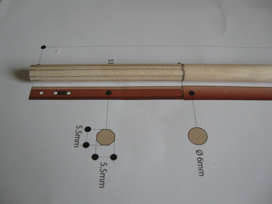

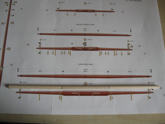

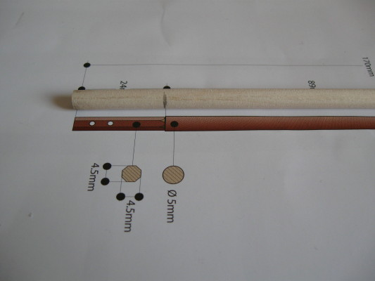

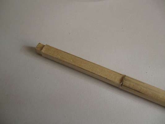

Take the 6mm dowel mark the position of the lower octagonal section, and then taper the mast to 5mm at the top, then carve or sand the bottom section to an octagonal shape, and drill the three 1.5mm holes.
Mark the top square section, then cut the mast to length. carve the top section to 4.5mm square, making sure that the square is parallel to the three holes drilled earlier.
Mark the position of the cross tree support, then carefully carve this to a 3mm square, then sand off the corners to make a 3mm octagon.
Use the 2x3mm strip to complete the cross tree support as per the technique described in issue 63.
The mast can now be stained, or if painting, it can be painted after the mast is assembled.

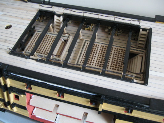

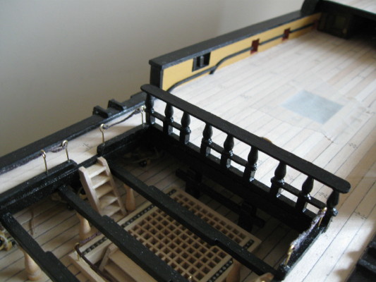

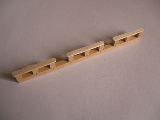

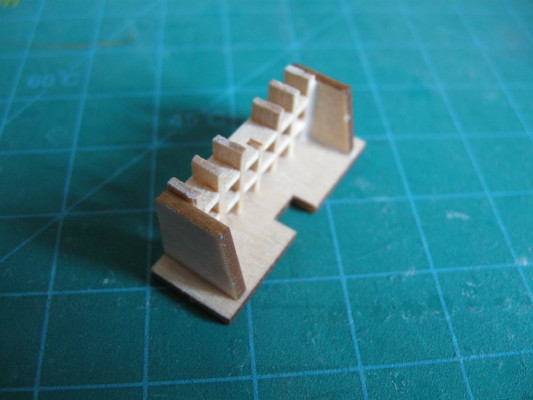

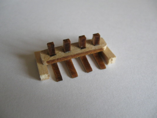

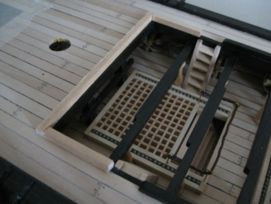

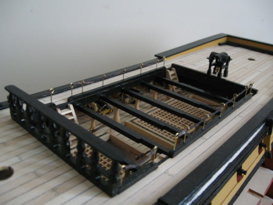

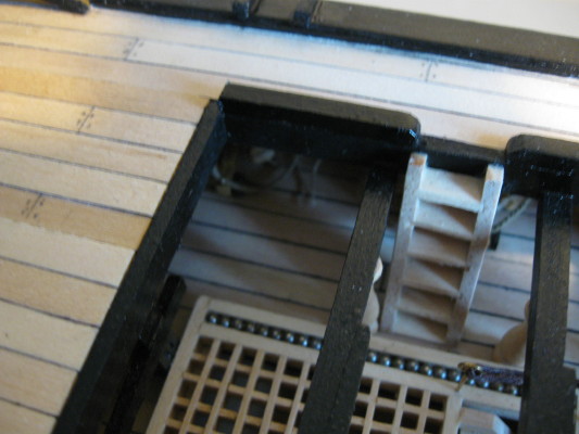

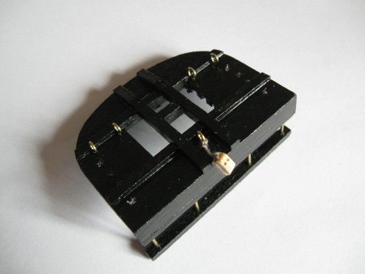

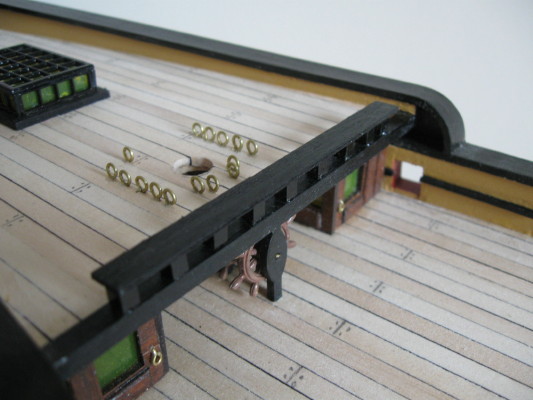

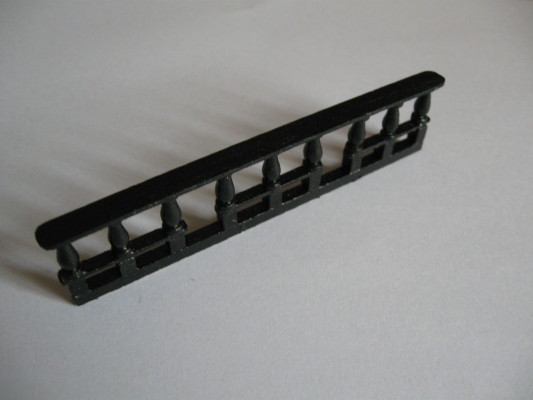

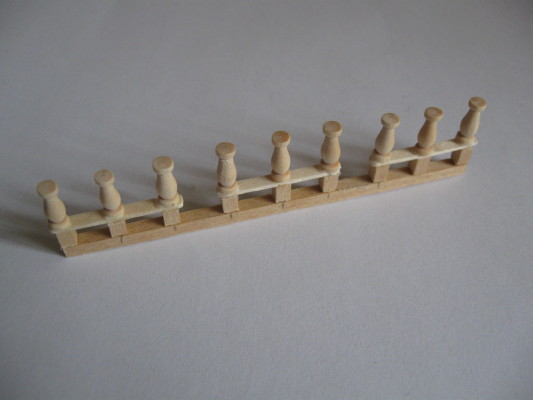

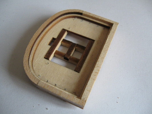

Making the deck rails - You will need the parts supplied with issue 52.

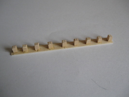

Cut two lengths of 3x3mm wood to fit at the aft end of the deck opening, to fit between the side of the deck opening, running between the ladder and the end rail, sand a radius on the ends closest to the ladder, then cut a length of 3x3mm wood to fit across the aft end of the opening.

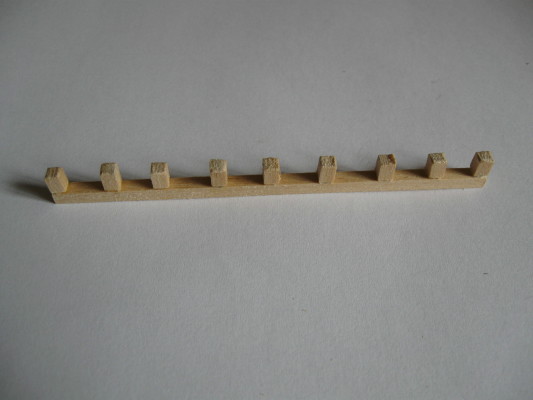

Cut nine pieces of 3x3mm wood, each exactly 5mm long.
Mark the long opening strip (made earlier), as per the marking shown in the instructions, then glue into place the nine 5mm blocks uprights made at the points shown.
Cut three lengths of 1x3m strip to make rails that each overhang the uprights by about 1mm; round the ends and then glue into place.
If you have opted for a natural finish, stain the two small side rails and the aft rail now.
Check that the ends of the pillars are smooth, and sand if necessary, then glue nine pillars directly above the uprights.
Glue side by side, two 95mm strips of 1x3mm wood to make a 1m thick, 6mm width, 95mm long. Then trim this rail, to overhang the pillars by about 1mm; then round off the corners, stain it and glue the rail into place. If painting, paint the entire aft and side deck rails black.
Glue the two side rails into place next to the ladders.

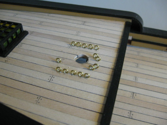

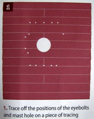

Drill 0.7mm holes. 2mm deep positioned as shown in the steps.
Place (but do not glue) eyebolts into them, with the holes in the eyebolts at the ends of each run facing left to right, and holes in the centre of each run facing fore to aft.
(18 eyebolts are included, which is enough to complete a short gap at either end of the two main run's, which is a closer resemblence to that seen the actual ship, therefore I installed 9 eyebolts on each side of the opening spaced as shown.)
Run lengths of brown thread through the eyes, then cut and fold the ends back and glue them with PVA, and when the glue has dried, glue the eyebolts into place.

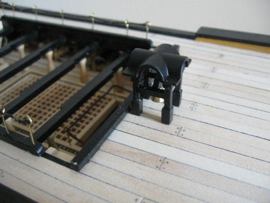

Finally glue the aft rail into place.

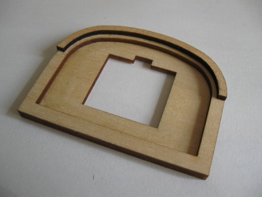

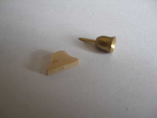

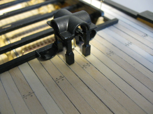

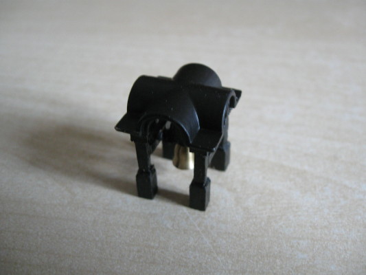

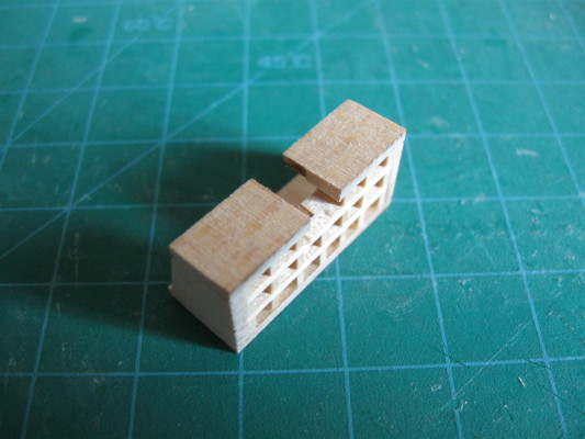

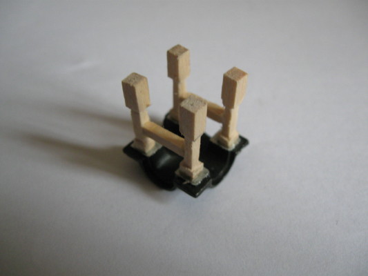

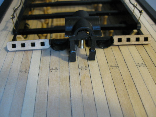

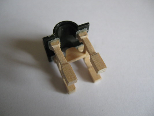

Assembly of the belfry -You will need parts supplied in issue 50.
Take the top of the belfry and file or sand the bottom smooth, removing any moulding marks and the paint.

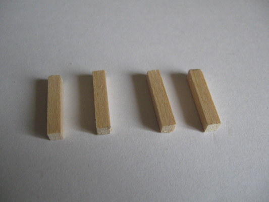

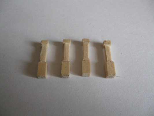

Cut four pillars from 3x3mm wood, all 16mm long. Then with a sharp knife, thing the centre of each strip, leaving a shoulder of 6mm at the bottom and 2mm at the top. Cut two 9mm lengths of 2x2mm wood and use them to join the pillars just over half way up from the bottom.
Use superglue to glue the sides to the top, making sure that the legs are square.
From an offcut of 5x2m strip, cut a length to fit between the two cross bars, then carve the piece to the shape shown to form the bell support, and drill a 0.7mm central hole in the bottom about 3mm deep.Then glue the bell support between the cross bars.
The wood can now be stained or painted black, also touch in any bare metal around the pillar tops.
Insert a pin-nail into the bell from the inside and fix with superglue, then cut the nail so that it is about 2-3mm long, then glue the shaft into the bell support.
Glue the belfry against the frame at the forward end of the deck opening, so that it straddles the centre line of the model.
That's it for this week, carefully store the assembly and any remaining parts!
Mizzen cross jack yard - The mizzen cross jack yard is assembed from the parts supplied with this issue, it is made in a similar way to the other yards, therefore I'm not going to repeat the making process. (The suppled yard slings are slightly smaller than shown on the plan)
Mizzen topgallant - You will need parts from issue 79.
The topgallant is made in a similar way to the other yards, therefore I'm not going to repeat the making process, other than to remind that the top two holes of the topgallant are drilled so they face fore to aft, and the bottom two drilled so they face port to starboard.

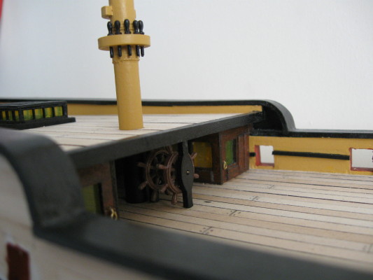

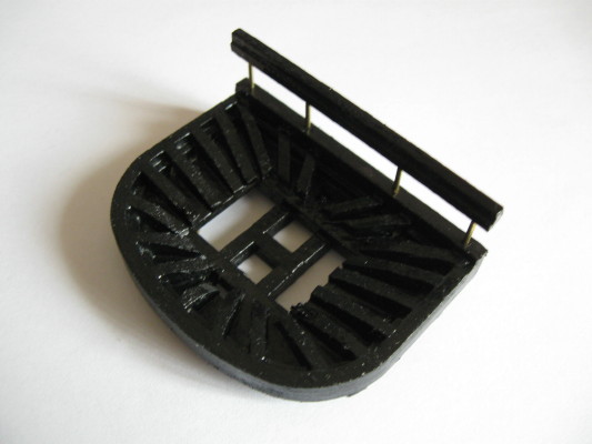

Completing the cockpit rails - You will need parts supplied with issues 59 and 60.
Paint the 'U' shaped die-cast metal parts with a metal primer, then paint brown to match the stain you are using or paint them black.
Use superglue to secure them to the deck, next to the forward frame of the cockpit and against the belfry.
Take the two pin rail sections, and locate each into position either side of the 'U' shaped fittings, then trim both ends of the pin rails until they fit from the end of the 'U' shaped fitting to the end of the cockpit frame, then sand them smooth and radius the ends slightly.
Glue the 'L' shaped pin rail supports into the holes of the pin rails, use two off-cuts of 3mm sq wood as supports to ensure that the pin rails are set at the correct height, (be careful not to glue the spacers to the assembly). Then stain or paint black the pin rail assemblies and glue them into position either side of the 'U' shaped fittings.
Adding the mizzen mast eyebolts - The eyebolts were supplied in issue 66.
Trace the eyebolt plan from the magazine and trace the eyebolt positions onto the poop deck, ensure that the tracing is positioned correctly, then mark and drill the eyebolt positions with a 0.7mm bit.
Cut the eyebolt shanks to about 4mm, then glue each in place using superglue so that they align fore to aft.
Adding the poop deck forward rail - Use the remainder of the 1x3mm strip supplied with issue 52, and the 3x3mm strip supplied with issue 66.
Cut two pieces of 1x3mm strip, each 83mm long, then glue these together to form a strip 6mm wide.
Cut nine 5mm lengths of 3x3mm strip, ensuring all are the exact same length, then space the nine blocks evenly onto the 6mm wide rail made earlier, gluing the first block in the centre of the rail and leaving a rail overhang of rail at either end.
Stain the rail or paint it black, then glue it centrally onto the beam which spans the front of the poop deck.
