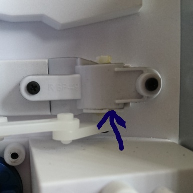

Hi,
My bottom arm was catching on the body as it closed, I found that the arm was loose within the pivot mount causing it to sag.
So I stuck I piece of plasticard to the underside of the pivot mount and filed the recess slightly bigger than the original.
Works a treat now, will post some pics later to show this.

Spudtrooper37
#6 Posted : 02 September 2018 16:09:24
Joined: 16/04/2011
Posts: 328
Points: 998
Location: Anglesey
Hope you can see what I have done, it was to make that recess where the pin goes slightly smaller to make it a tighter fit.
