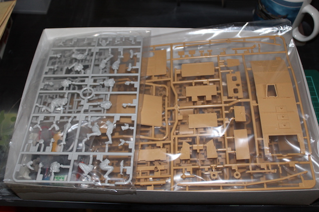

I will be building Tamiya's 1:35 male tank. I have the export version which includes the set of British infantry release around the same time as the kit. I Diorama in a boxLove

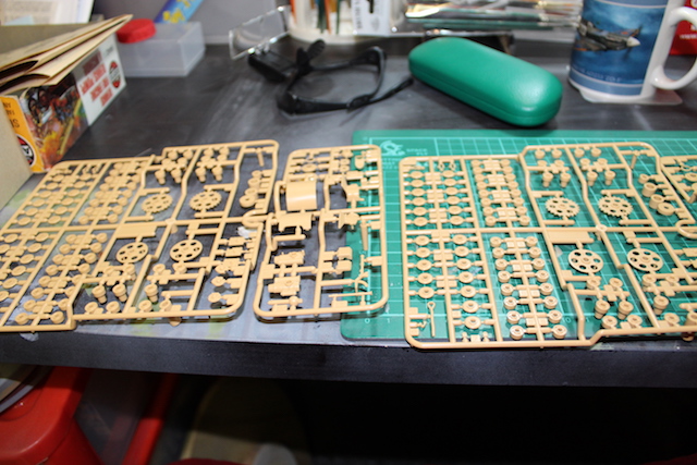

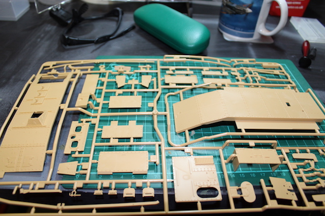

Kit review,

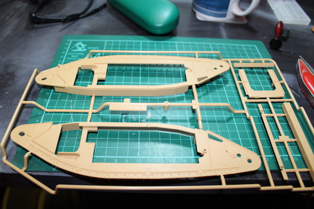

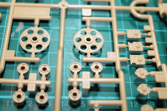

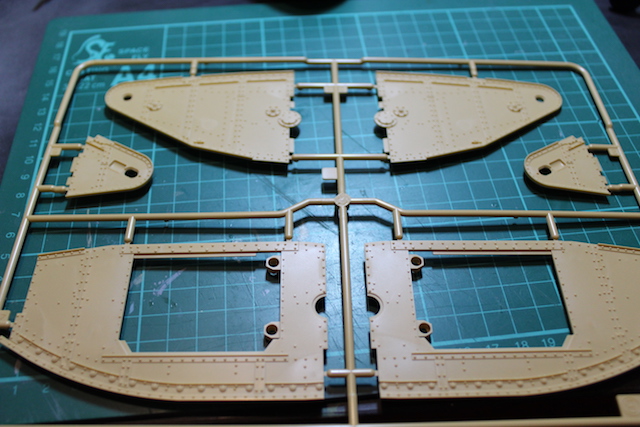

I am not going to labour on the detail of the kit, it is to Tamiya's usual high standard. This is the motorised version which plusses up the number of parts from what is otherwise a quite simple kit.

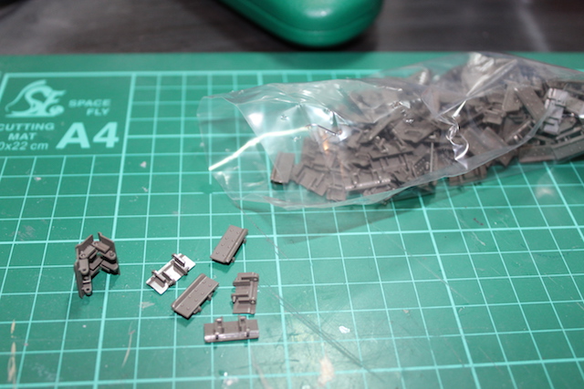

A highlight is the fully working snap together track links.
looking forward to building this Diorama.

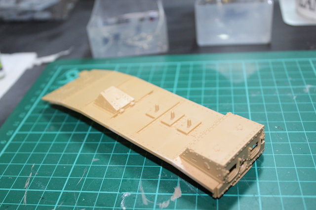

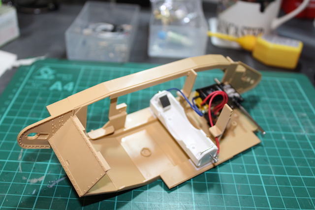

#10 Posted : 14 September 2018 18:18:41

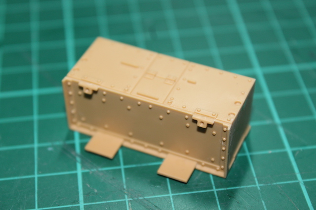

of we go then...

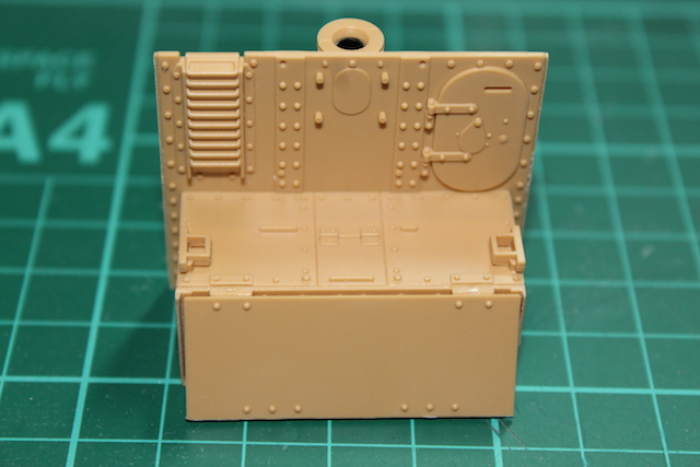

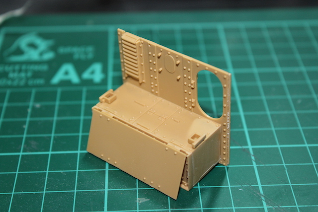

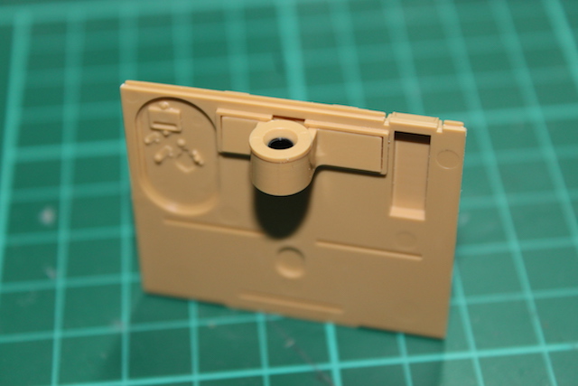

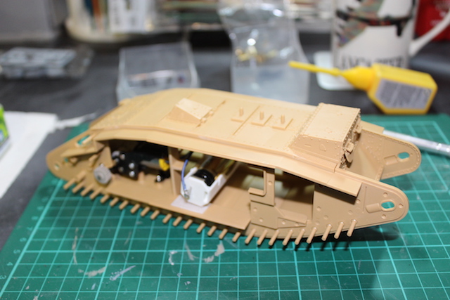

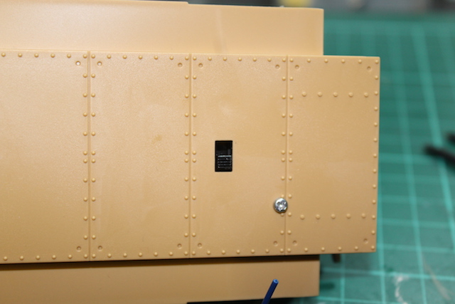

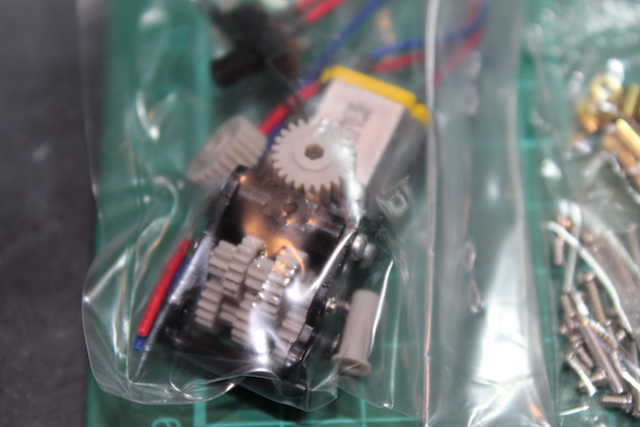

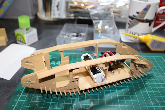

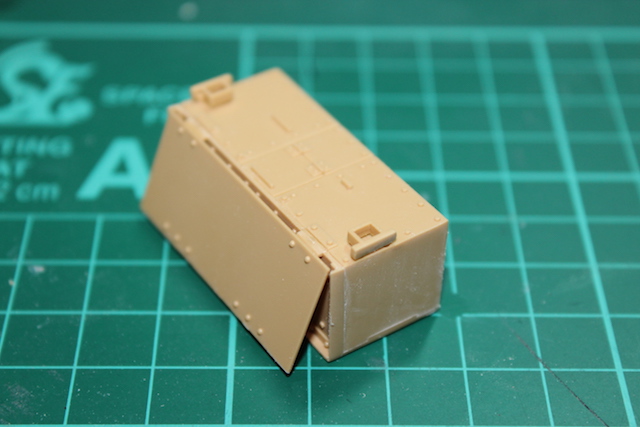

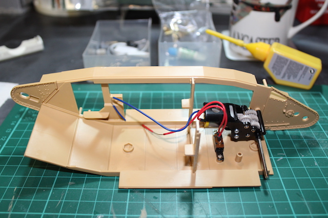

Build starts with the box mounted on the rear of the tank. lots ov cleverly rivet detail and the usual Tamiya quality of fit. The rear plate gives the option to model the door open, the door has inter detail, but given this has a motor ne point having it open.

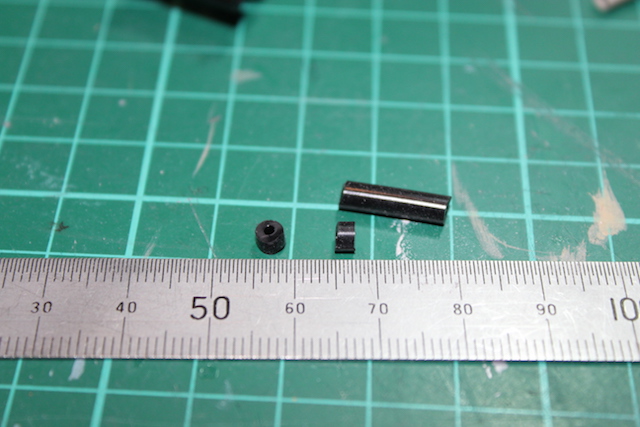

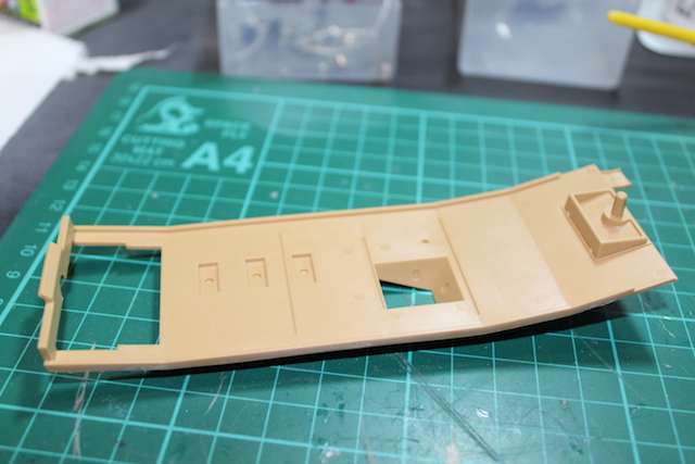

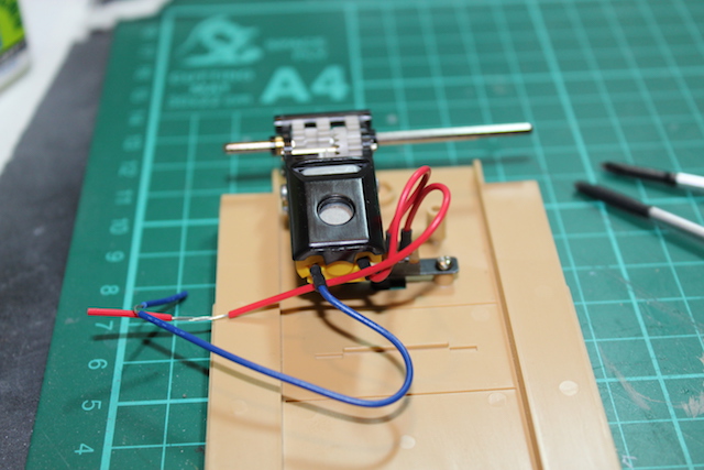

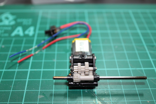

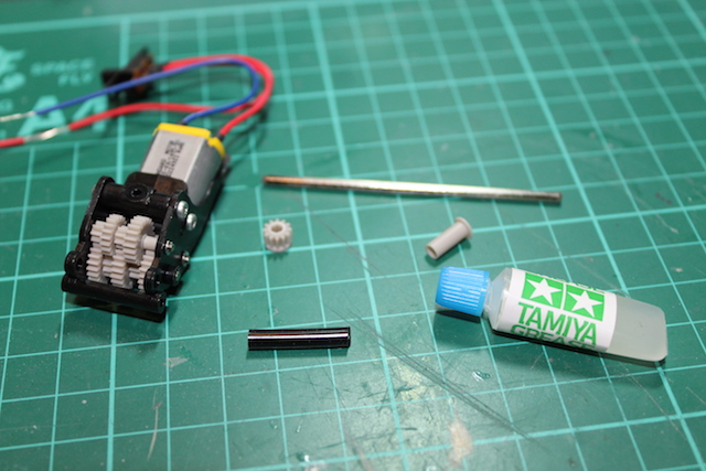

we are straight into building the motor after that. Its very easy to pull together a little bit of cutting polly tube but nothing taxing.

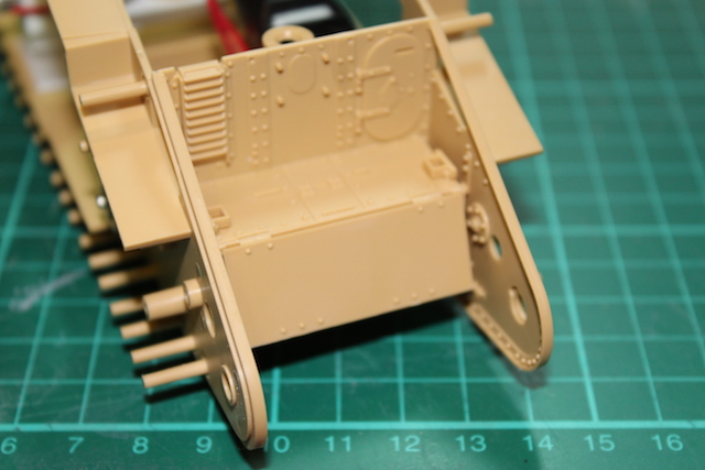

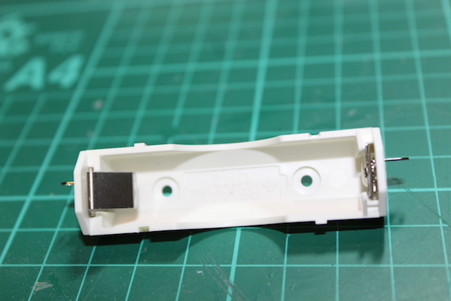

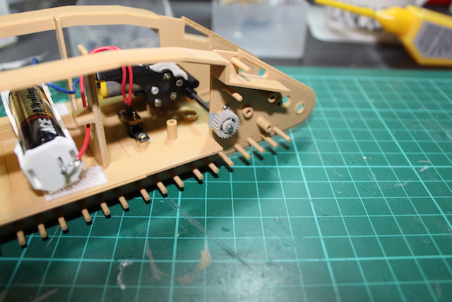

The motor is screwed to the floor plate with the switch face down. the battery holder mounts onto the base plate with Velcro. the wires from the motor are supposed to be held on with polly tube, but I chose to rack them on with a spot of solder.
The first internal side plate then goes on which further secures the motor. Front plate then goes on before the second side.
A motor test at his point and all good Cool

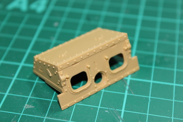

The top plate is designed to be removable to allow access the battery and motor. The driver and commander forward positions are assembled next with options to show the vision ports in any degree of open or closed.
