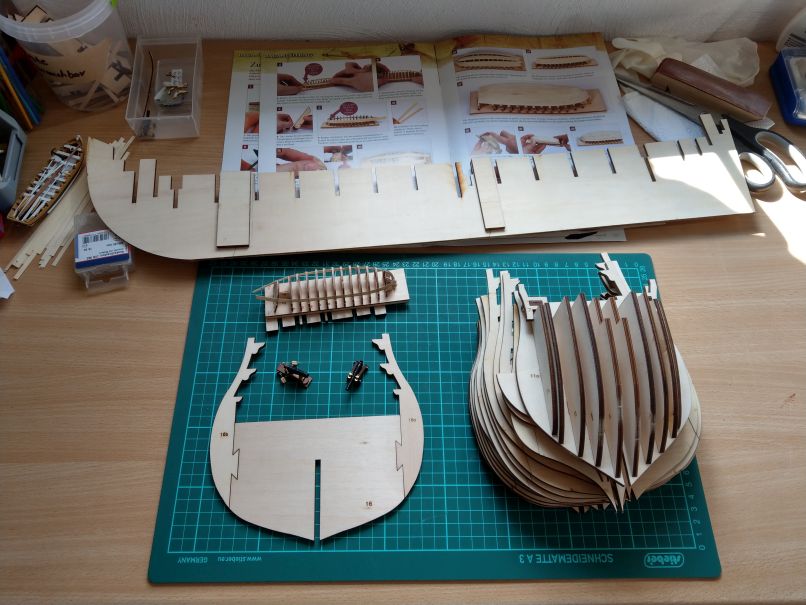

So for now I started with stages 1-20 and differed just a little bid from the manual. Since I had all packages at hand I completet the keel elements first (it thought it would be easier to get it straight that way compared to add the last parts when frame no. 12 - the first one - is glued to it).
At this point I had to start differnt tasks because a lot of frames were totally bend, I had to contact CS twice to send me new ones, 7 years in storage has left it's trace.

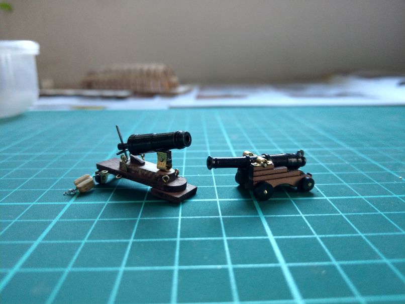

I wanted to keep the anchor, the longboat the 12 pound canon and the carronade for later and do as many as possible together so they would be almost identical and I woud be faster. Since I'm still on wait for the frames I started all those tasks.
The canon was quite easy and fun to build, I will leave all those parts at a natural look (I like the dark wood) but I'm not sure what to do with the ship, yet. At first I wanted it completely stained but everybody here told me not to do so, so I will stain only the lower hull but don't know yet what to do with the upper part.
The anchor was quite fun, too. Although I'm not done yet, staining and vanishing everything takes a little while.

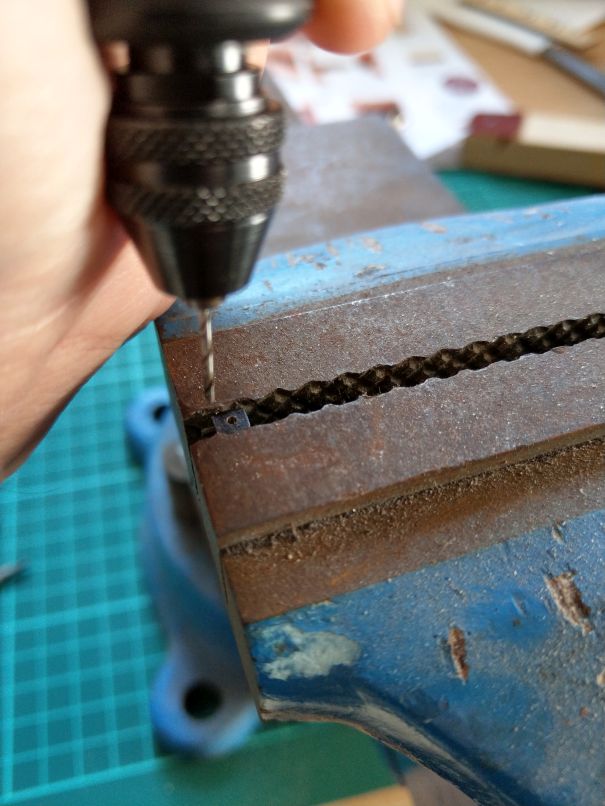

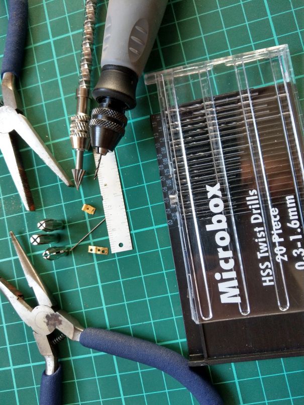

In addition to the canon, I yesterday build the carronade... not. so. much. fun. For starters I bought all the tools I found helpful from posts from here, I do have an archimedean drill. There was no chance to get through the brass with it. First the collets are no good, the drill wobles all the time and even with a Dremel I couldn't get trough. With all the heavy machinery in the picture and a milling piece for the dremel I finally made it, but it took me hours.
I suppose I do have some cheap drills (came as a set). Can you recommend drills for the metal parts?

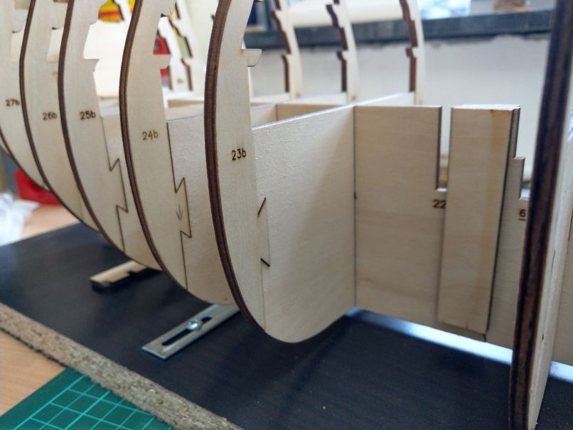

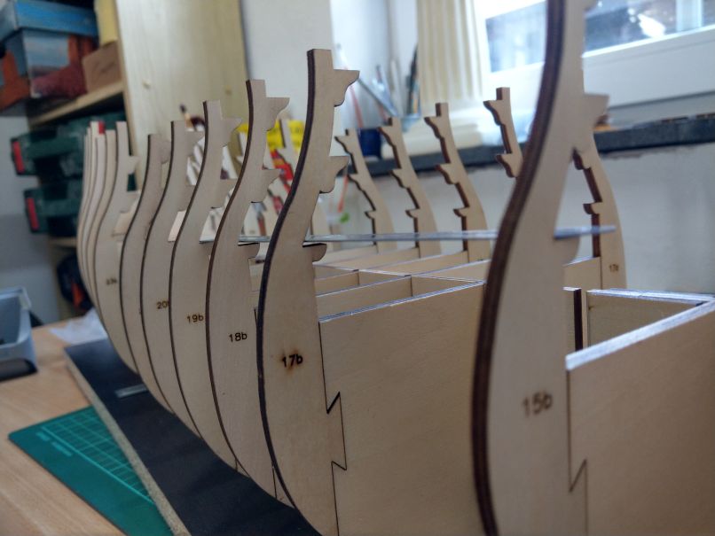

During my waiting time I decided to build a dry-dock an set in the whole keel and the frames which I have. Due to some horrorstories I read I wanted to check before gluing if everything is straight. It isn't.
First some frames go lower than the keel and I put the keel on spacers. Neither one helps to avoid those changes in height of the deck supports (some are either to high or to low) I just read a post where this lead to some serious problems not only for the decks but also for dents in the hull.
What would you do? Raise the ones which are to low with the keel set on spacers by putting some pieces of leftover planking of the launche between the keel and the frame. Or lower the ones to high by sanding a little bit off? Or contact CS about that issue and ask for new parts?

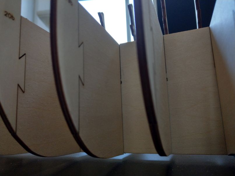

In another picture one can see, that the outside parts of the frames are from different charges in produktion, they are slighty thicker than the inner part of the frame (sorry I don't know the words in english) - also you can peek through the connection part of 20b and 20. I do have this with every other frame. Is this going to be a problem during the build? I have not seen this on any pictures of other builds.

Hi Daniel,
With the frames you need to ensure your frames are set flush with the top of the keel, they also need to be level and square. Small adjustments of the frame slots will help you achieve this either with small fillers or sanding down a little.
From what I can see the outside of your frames all look fine to me, any adjustments needed here will be carried out during the faring stage.
Hope this helps...

BigGrin I agree with Alan getting all the frames the same height along the keel is the way to go hereCool

Hi Daniel.
Remember that these supports will be used for the lower and middle gun decks which will eventually be hidden. Although these part are said to be 'laser cut', you will find they will be many discrepancies as you progress especially when you come to the fairing. The key from now until the planking is finished, is to make sure the keel remains straight and there are no other warps or misplaced ribs. Be especially careful to ensure that the stern ribs are seated properly.
