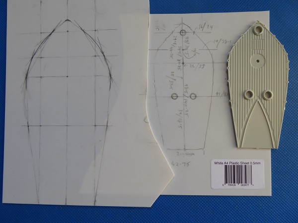

Using a 1/72 donor model for guidance I have already made the 'footprint' for the tower and this week I began to make the lower platform, using the same technique as before; measuring the donor model and multiplying the measurements by a factor of 1.5 to correctly scale up from 1/72 scale to 1/48 scale.
The attached photo shows the donor model lower platform, a drawing of it with dimensions and the scaled up version, all drawn out onto 0.5mm thick plastic sheet.

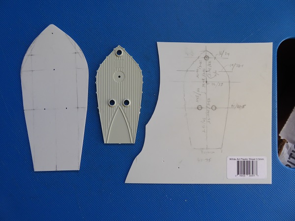

#2 Posted : 07 June 2018 07:48:18
The new lower platform profile cut out.

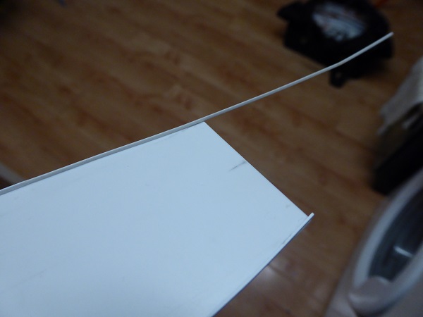

I then glued a thin strip of plastic around its edge. This acts as a locator for the tapered sides and allows the mahogany decking to butt up against it.
#4 Posted : 07 June 2018 07:51:38
The attached photo shows the strip glued in place. I have left it oversize for this picture so that you can better see it. It was then cut to length.

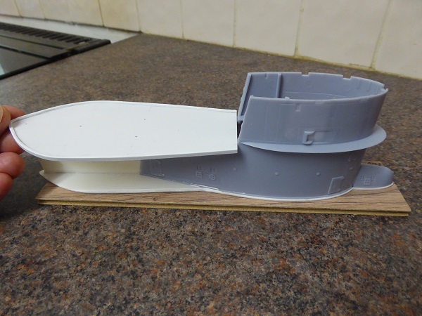

#5 Posted : 07 June 2018 07:52:24
The lower platform being offered up to the existing conning tower.

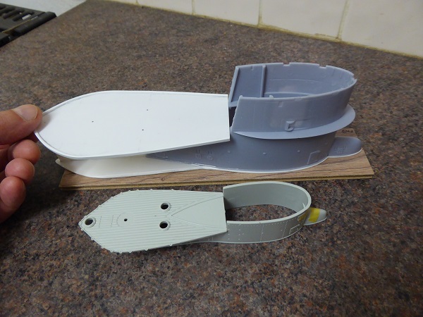

#6 Posted : 07 June 2018 07:53:18

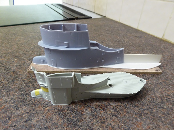

My 1/48 scale conning tower and the 1/72 scale donor version side by side.

Both versions side by side. As you see there is a lot more work to be done to convert my 1/48 scale version to build it up to resemble the 1/72 donor model next to it.

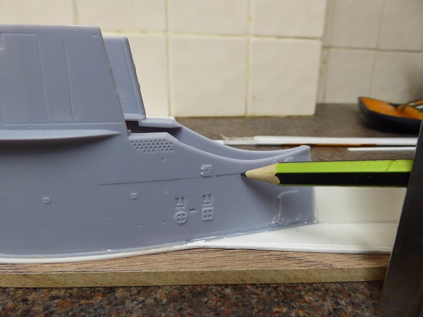

The attached photo shows the location of the lower deck being marked out on the conning tower with a pencil clipped to an engineers square; just getting to this point where I was confident of the correct height can be summed up in a few words on here but involved lots of cross-checking and head scratching.
