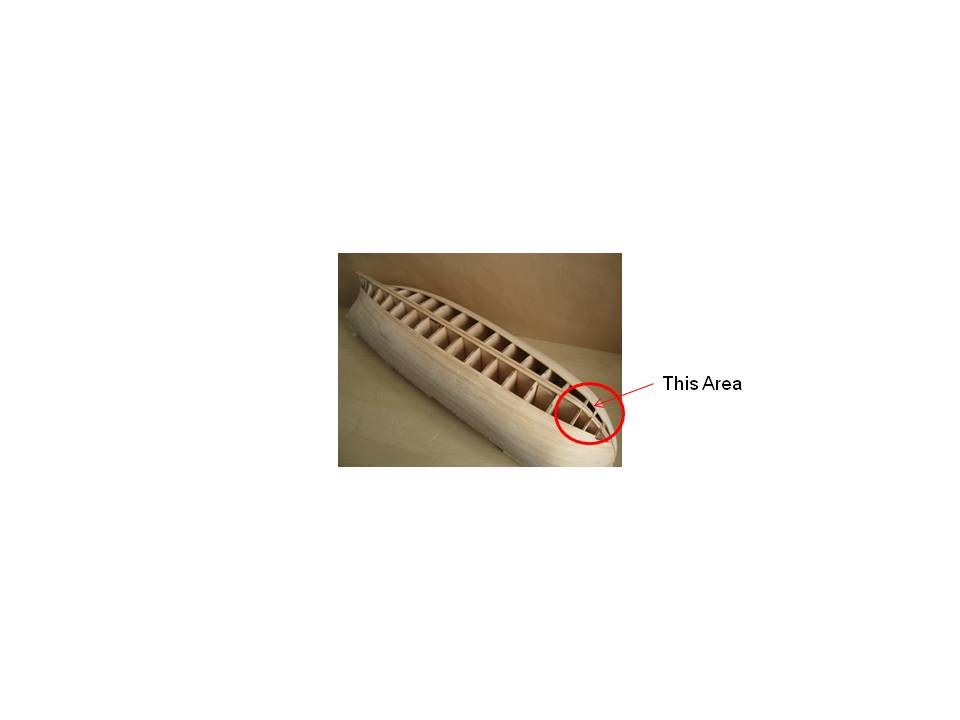

Question: I cannot make heads or tails of fitting the bow plank. I have looked at the pictures but they are not accurate (Tomick's build - photos are at an angle). Could some one please take a close up from the front so that I can see what must be done.

Thanks for the help. Photo is good, but does not show the area I am interested in. See attched photo.

Ok! Castos here is the link in my diary for that area:-
http://forum.model-space...s&m=21004#post21004

Thanks Son of Bulwark. Now I can continue.
