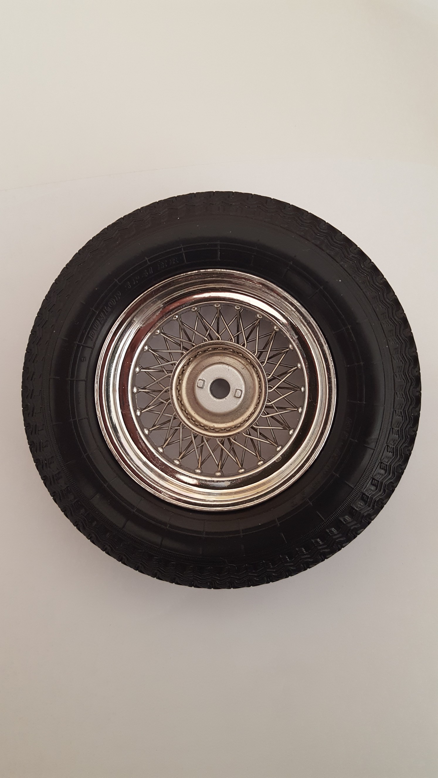

I've been getting up to date with my Jaguar build and started to fit the first front wheel. After a few attempts at lining up the lugs I thought I must be doing something wrong as the brake disc/female end of lugs wasn't rotating when I turned the wheel. After trying other wheels I realised what the problem was.
The inner hub part with the lugs in the picture below can be rotated within its enclosure on two of my wheels but not the other two. The net effect of this is that my fitted wheel doesn't turn the brake disc when the wheel turns as the inner hub stays in a fixed position. I'll fix this easily later with a spot of glue between the two parts of the wheel hub. It probably happened during one of my many painful attempts to get the outer spokes fitted to the wheels... soooo difficult.
Putting this in perspective the wheels will hardly ever get turned when it's built - if the Jag is even allowed to rest on them but at least I'll know it's built ok. I know it's all a bit anal, just thought I'd mention it in case anyone else was interested or hadn't noticed.

I haven't noticed this on my own build but it does seem odd that the central 'core' of your wheel can rotate so easily within the hub.
Mine do move, but only with some effort.
My fitted wheels all work a treat and the disc also moves with the wheels, so no problems.
At this stage, I wouldn't worry about it as there 'could' be more to come later on.

Thanks for your insights. I'm not worried and I agree that the wire wheels are well designed but I still think the outer spokes are a little too short, maybe only half a millimetre, but - on occasion - I've had to clamp the inner hub and outer rim together a little more than they naturally rest after fitting the inner spokes to get a few of the outer spokes to fit, all after trying as many techniques as I could think of, scraping the coating off while trying to force tbe spokes over and the limit of brute force etc.

I have found that the outer spokes A & B are more of a struggle than is desirable but, if after fitting the first pair then fit the opposite pair it evens the tension on the central hub and then continue working opposites. Works for me, the ends of the A & B spokes don't look as good as the picture in the instructions but they are concealed with the inner rim anyway.
As for wheel turning my front wheels and discs turn fine but the rears are never going to spin because it's a static model not a push along toy. I recon the cost of a working differential and universal joints at this scale could well have put a lot of people off.
Yes I can move the wheel centre if I try but it's never going to spin.
