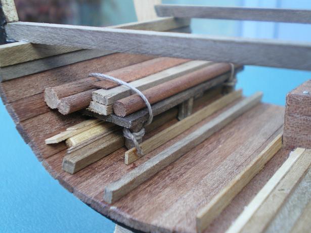

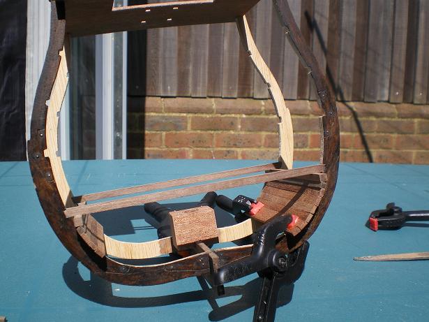

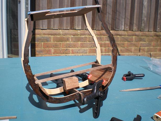

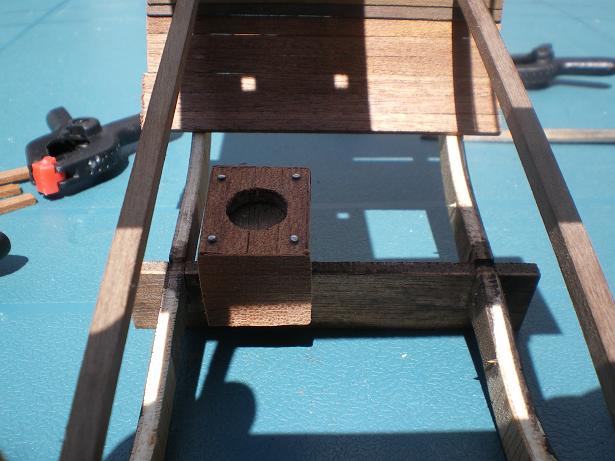

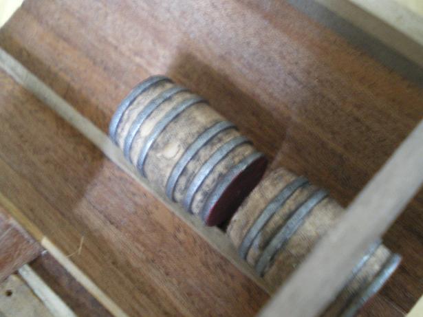

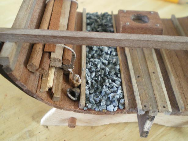

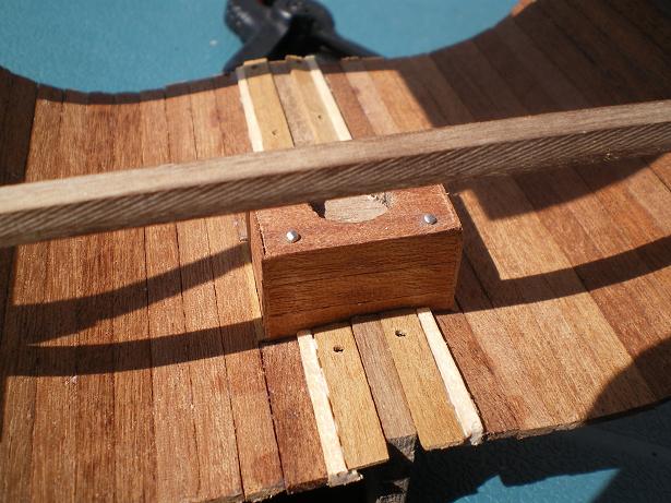

The ribs were glued together and left to dry . They where sanded and covered with veneer so I could make some braces on the keel piece and rib joints. Next up was fitting the beams very simple to fit and certainly stiffens the whole thing up . Once dry the planks where cut to size and fitted as per the instructions. The mast foot was glued together and covered with veneer as I didn't like the look of the ply Cool . Now the slight change to the instructions I have added lumber board and lumber strake these are used in real ship to clean out the bilge as the lumber board had holes in them so they could be lifted up for access. A bit fiddly to make but looks realistic. I fitted some ballast boards, these stop the ballast from moving about when the ship was rolling on rough seas Cool . Next job was making a shelf to store some spare wood . I found some in my bits box and piled them up on the shelf and roped them down. I haven't used the ballast that came with the kit as it looked to big so I got some from my local model shop . It was glued down with diluted PVA Cool . The barrels were painted and aged because I want the hold to look dirty and cluttered. I have also made a couple of buckets just to add a little more clutter Cool . Next job on the list making the lanterns as the tiny leds have turned up Blink
Cheers for looking
Martyn

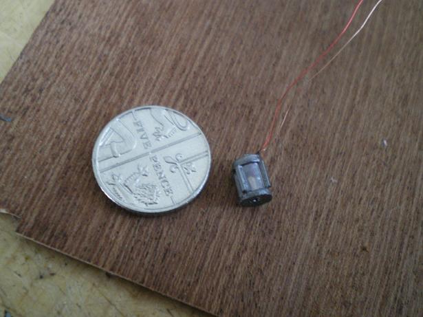

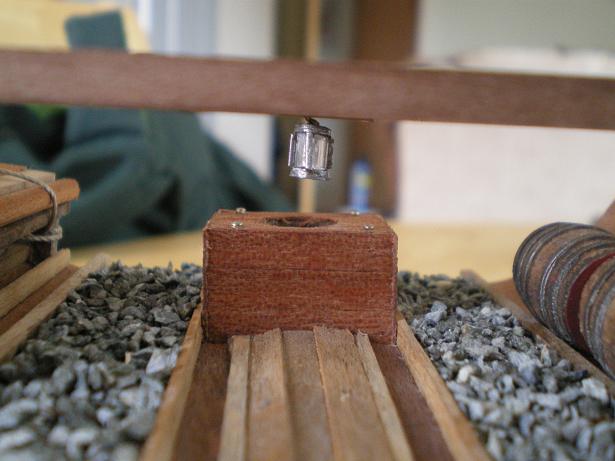

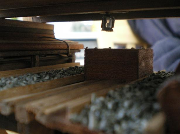

I have started making the lanterns. The clear plastic came from the tube that comes with paint brushes to protect the bristles and the top and bottom are punched out of some plastic sheeting with a leather punch Cool the tube was cut to 4mm and the top section was drilled to accept the led Cool the bottom was drilled with a small hole so I could put a candle in it Cool . What am I doing I must be mad LOL . The top and bottom where glued to the tube and when dry a small piece of plastic strip was glued to the side. The led was put in the top to sit on top of the candle and a little bit of wood pushed into the hole to hold it in place Blink . The whole lot was painted with gunbolt silver Blink Blink once dry it was fitted to the beam and the wires led across to the outside Blink Blink Blink . After that I picked my eyes off the floor and took some pictures LOL . Only seven more to make Crying
Cheers for looking
Martyn
