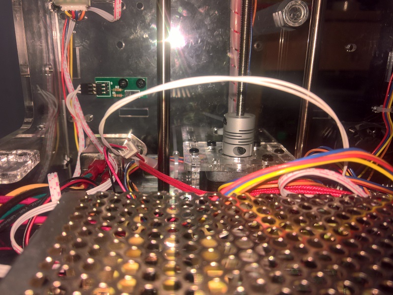

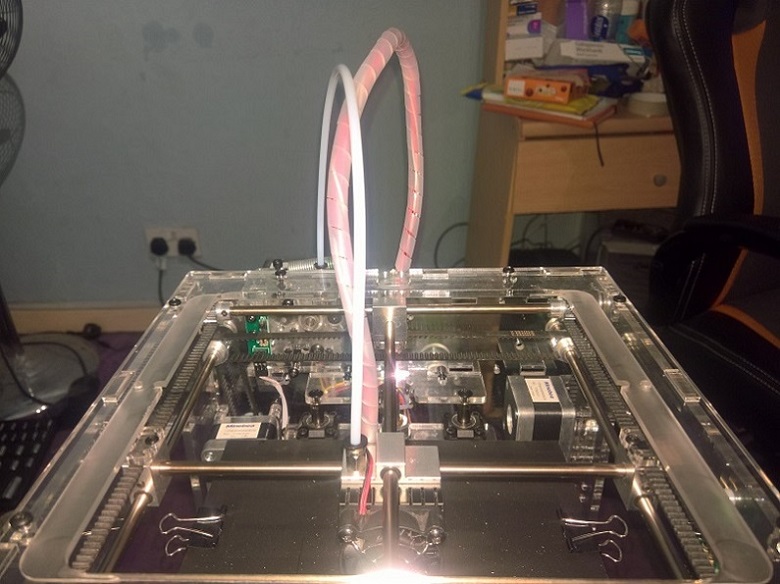

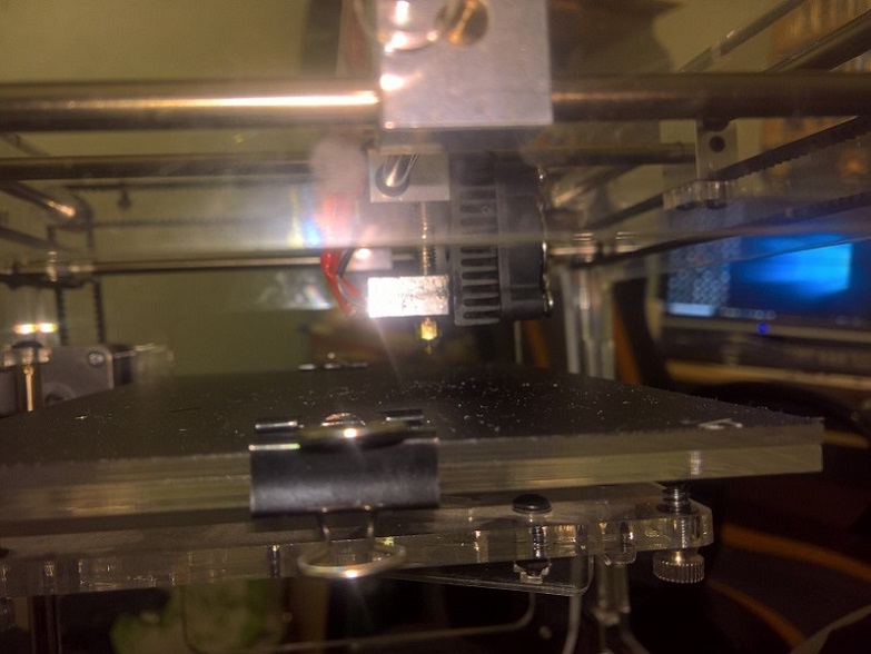

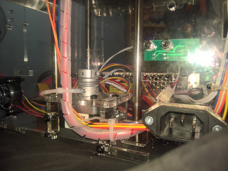

ncall1976
#20 Posted : 08 May 2018 00:56:28
Joined: 19/06/2014
Posts: 78
Points: 216
Location: Doncaster
ncall1976 attached the following image(s):
