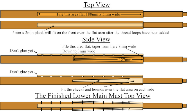

Well riff-raff perhaps this will make thing's clear.
Son of Bulwark attached the following image(s):

darren drawings is correct the only way to get aflat 8mmto3mm over 127mm is to taper a flat it check the drawing at the cross section at the start of the taper bottom of the square

The squared area at the top of the mast is 8mm x 8mm x 68mm with the corners rounded and a 5mm x 5mm x 5mm square on top. If you have done this right the flat area of the squared part would have about 6mm wide flat area with 1mm on each side still rounded (untouched part of the dowel) that will make the 8mm square section. The front 188mm flat area is 5mm wide to take the 5mm x 2mm rubbing paunch.
The mast has a flat taper below the square section on each side going from 8mm at the top going to 3mm at the bottom 127mm below the squared area. It is on this section the cheeks and hounds fit.
Here is another graphic to show how the mast will look before fitting the cheeks, hounds and rubbing paunch.

I think what MWG meant, is that for clarity the lower mast is not tapered around its full circumference, obviously your graphic is 2D not 3D.

Some people can't read tech drawings, not even simplified one's, I gave both top and side views which didn't show the taper on the mast going around the circumference of the mast but the taper was shown as a shaded area on the side of the mast. I don't know what can be done to be any clearer than that.

if the main drawing gave a front view instead of two side views it would be a lot clearer

Brilliant graphics you've come up with to describe the issues involved on the mast. They've helped me to read the magazine instructions much, much better. I really appreciate the effort you have gone to to produce these very clear drawings. The positive input on this forum just gets better and better. Thank you for your help.
