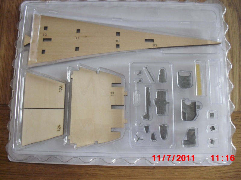

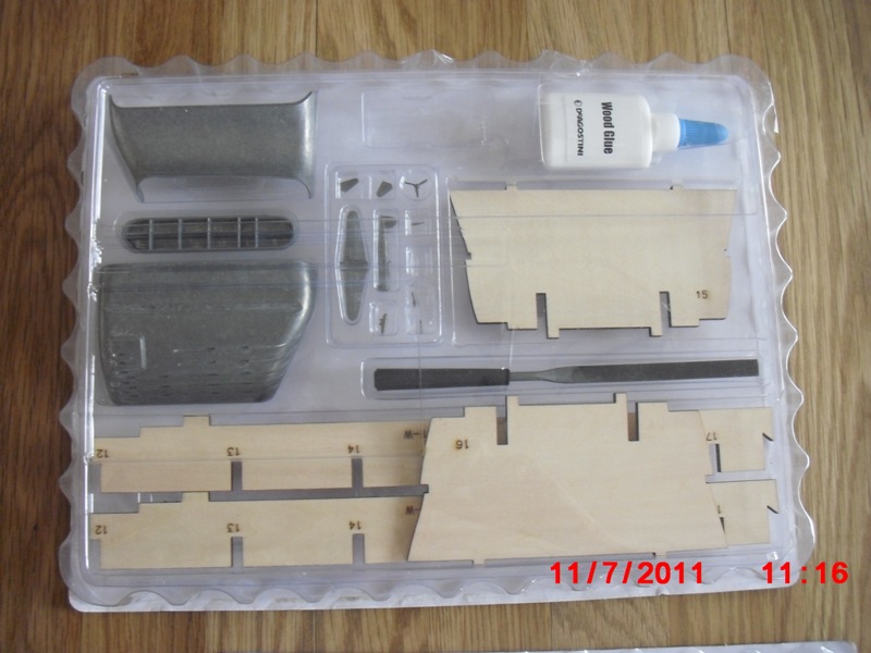

Well here we go with another exciteing Model Space Build.
The parts received in the first delivery (Issue 1) are 4 packs and a free tool kit.
Quality is excellent, and delivery was bang on time, I hope you join me during this build. untill next timeBigGrin ThumpUp

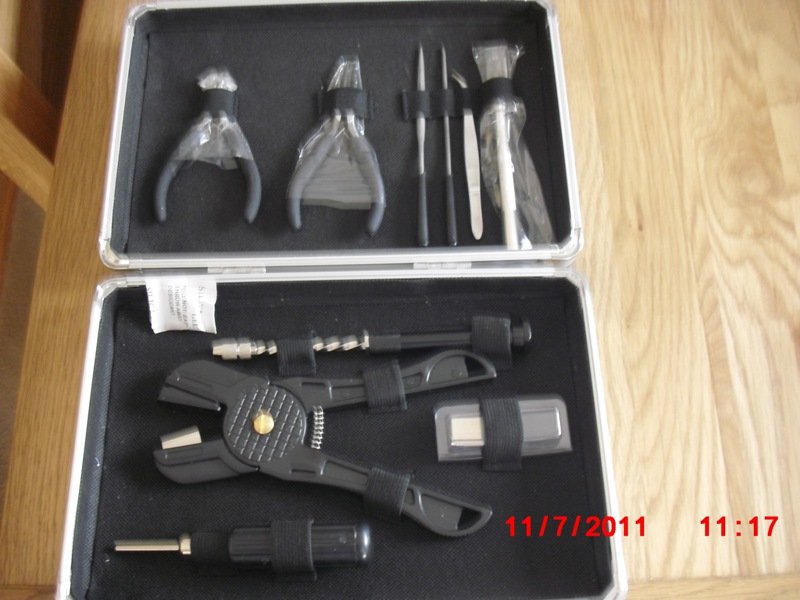

Not forgetting the tool kitDrool

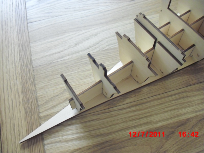

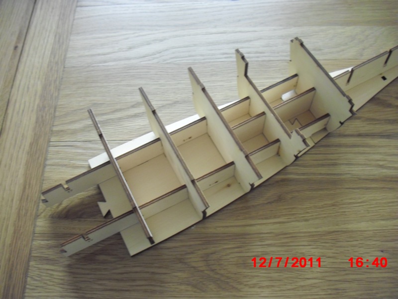

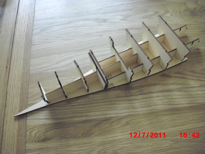

#4 Posted : 12 July 2011 18:09:31

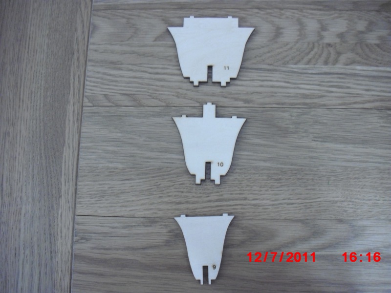

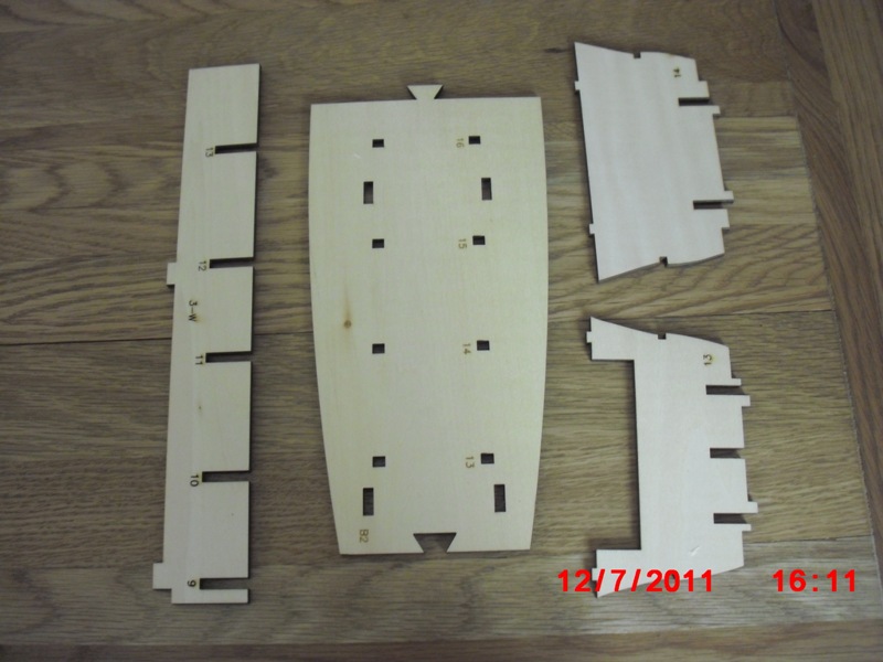

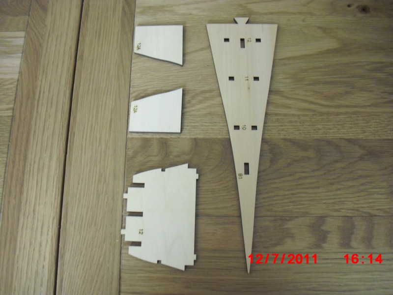

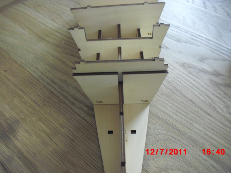

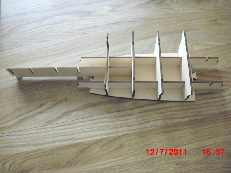

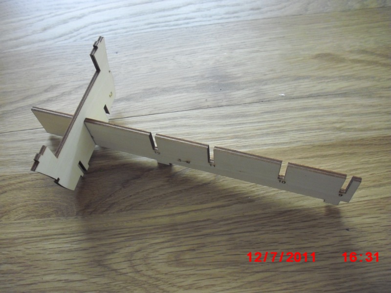

I have decided to build the keel first, with the other pieces coming later,I can do those later at my leisure because being metal they will not twist and warp, I am not going to rush I want to understand,the ship that I am building, It was an impulsive purchase on my part in the fist place and I want to do it justice.

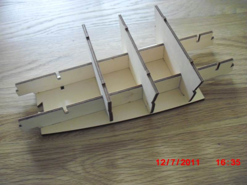

The First issue is in 4 STAGES. The first STAGE of the Keel are these, and I fitted them like this, ALL DRY FIT AT THIS TIME TILL I HAVE ALL THE KEEL
#5 Posted : 12 July 2011 18:14:09

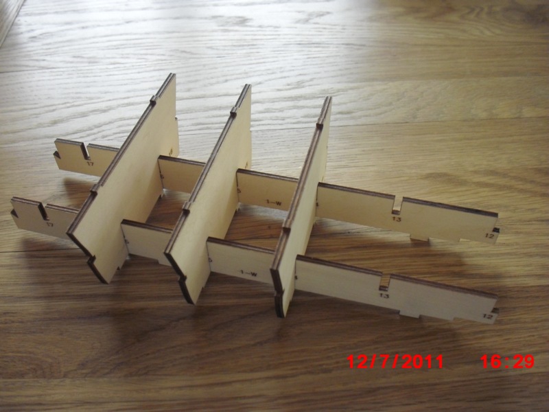

The parts go together very well with little adjustment, I only used the file that comes with the build. STAGE 2 Keel parts look like this, and I did this with them:-

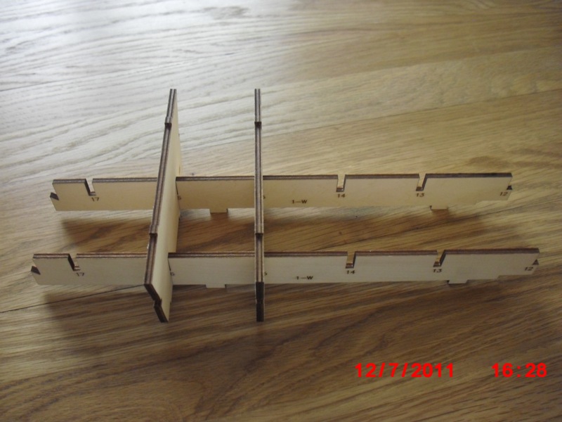

#6 Posted : 12 July 2011 18:18:59
STAGE 3 Keel parts were like this, and I did this with them:-

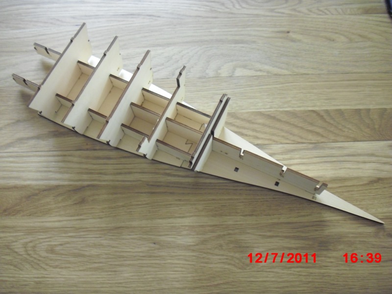

#7 Posted : 12 July 2011 18:26:36
Finaly STAGE 4 Keel parts look like this, and I did this with them:-
I make no apologies for my build following Mr T`s for he is the Master and If I am going to do it properly the it must do.
This is going to be a big Model,LOL LOL BigGrin and I am loving the build, you can be the judge of my work, all advice is sort by me else how are we to get better.
Thank you for looking at my buildBlushing

Excellent stuff stuff there MWG [biggrin). Going to post a little bit more on mine in a mo. I have constructed the island. If you don't mind me asking, why are you dry fitting the hull pieces? The reason I'm asking is that I have stuck mine, and now I'm wondering whether I should have.
#9 Posted : 12 July 2011 18:39:40
Thanks Glenn for your commentsLOL I dry fit the Keel at this stage untill I have all the Keel parts, then I can put into a jig (by screwing the base pieces down on a board) this will keep them straight and true while I glue the frames in place useing a set square,this is my method other guys will have different ideas, thats how we all learn, hope this helps GlennLOL BigGrin ThumpUp
