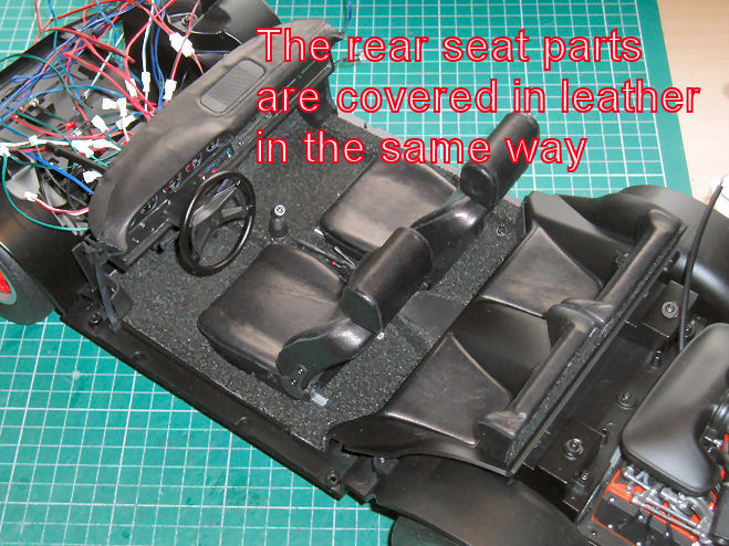

Rear seat and floor

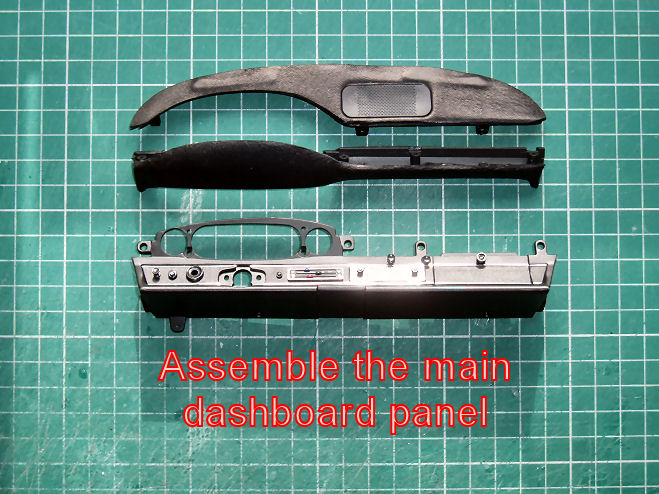

Dashboard

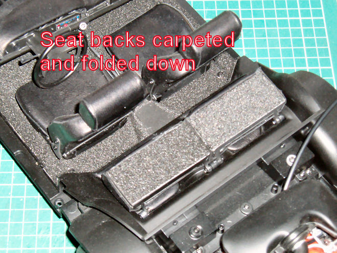

The rear floor section and seats are very straightforward and the seat base parts are covered in leather in a very simple manner – one piece of leather stuck in place and folded underneath the part.

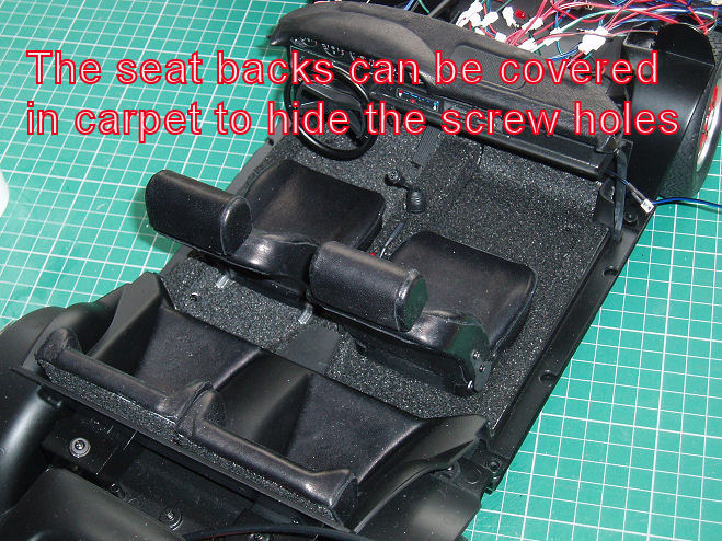

The seat backs are also covered in leather in the same way that the front seat backs were dealt with.
One piece of leather stuck to the face, and small shaped pieces stuck to each side.
The seat backs can be covered in either leather or carpeting. I chose carpet here so that the seats match the flooring when they are folded down.

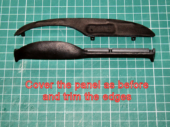

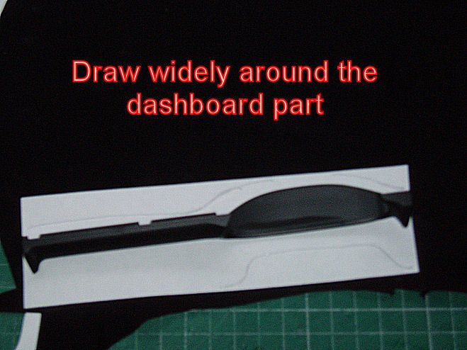

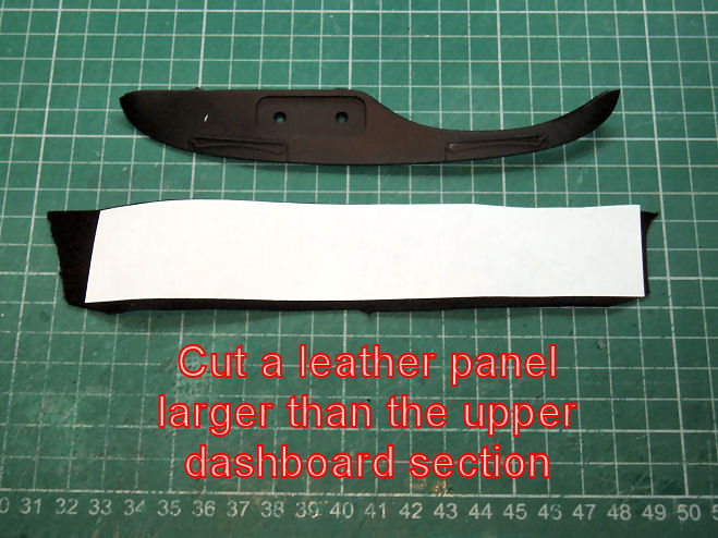

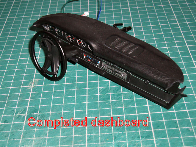

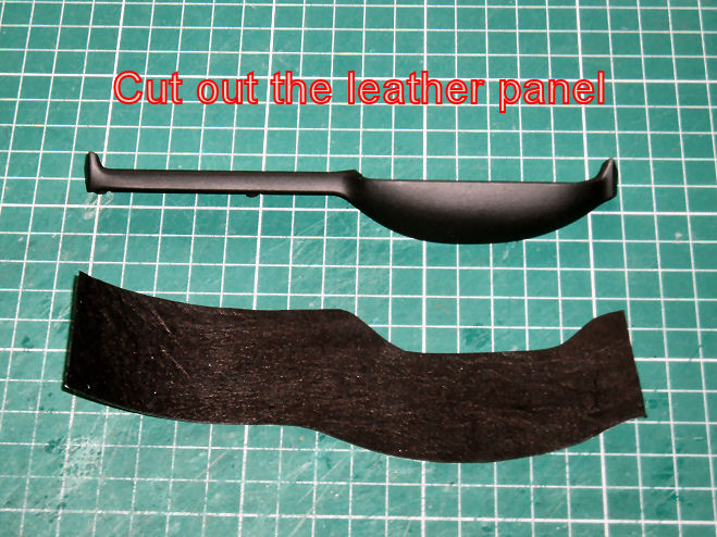

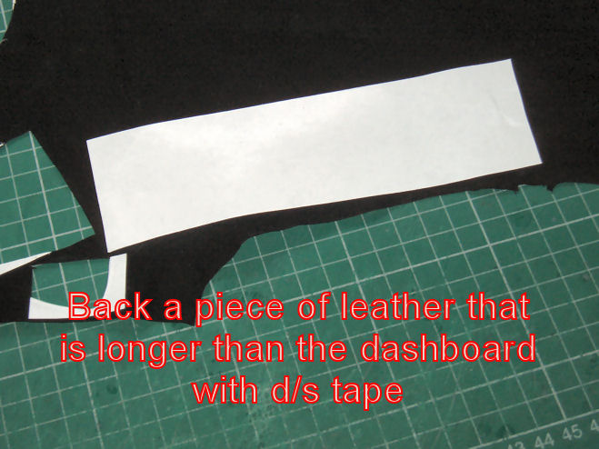

The dashboard is also a straightforward assembly but the upper panel can be covered in one piece of leather before any building work takes place.
Once trimmed with leather, the dashboard assembly follows the kit instructions.
