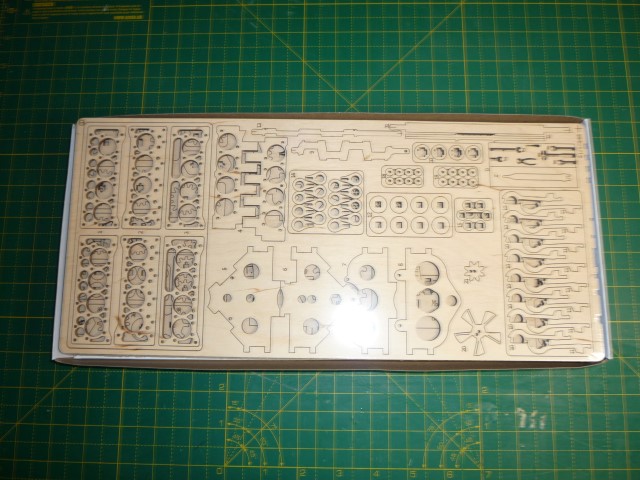

The kit itself looks very compact. The box itself measures 370mm x 170mm x 35mm, and when you open the box, you can see why! Very little space is wasted. the 6 sheets of laser-cut ply fill the box, and every sheet is cram-packed with parts. Although this is a 3D model, the parts are, by necessity, 'flat'. Very little sanding is required, although mating surfaces are given a coat of wax (using a cheap tea light candle) prior to assembly.

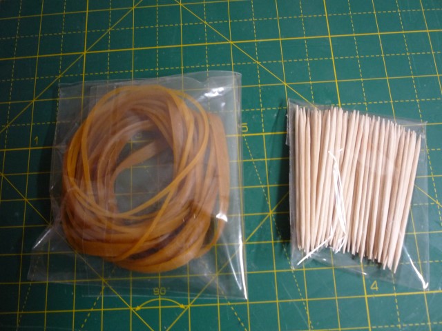

The motor is actually propelled by rubber bands (there's plenty of them). basically it is just case of insert the 'cranking handle', give it a few turns, select drive (you have 3 position gearshift: idle, reverse and 'race ahead!), and off you go BigGrin.

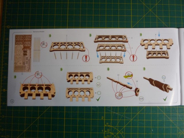

I have an issue though, at about step 4 you have to thread cam followers onto a cam, however I can't get mine on and I don't want to force anything! The instructions tell you were to sand, cut or wax. It tells you to wax the mating parts not sand them. Has anyone else had this issue.
As said, no only does the car move, but the V8 pistons and valves do too!
The clock looks like a must have kit too Love
Thanks in advance
aDub

Hi aDub
The cam followers are just threaded onto the cam, appying a little wax helps. it is a little tight getting them over the end stops,and should only need a light sanding of the inner edge of the cam follower. The valve stems are then pushed firmly into the guides.
Check post 17 of my build here:
https://forum.model-spac...spx?g=posts&t=26015
If i can offer any further advice, please just ask.
Gray

I assumed it'd be fine, but I didn't want to sand and then find that I should have reamed, and so causing problems later.
I'll make another start tomorrow.

Quick update:
I'd also emailed an address at Ugears. A lady called Helena came back to say, "Do what you think is best, and if you break anything we will send you spares!"
Can't say fairer than that! BigGrin
I re-waxed both ends of the cam and tried again. I managed to get a follower on the "wrong end"; by the 3rd they were slipping on quite easily.
I now have a complete engine with 16 valves all popping up and down.
My Hint:
* I chamfered the bottom of each valve-stem (may not be necessary)
* used a cocktail stick to line up the followers in turn
* engaged the valve-stem a short distance
* when finished, I set the cam for each valve to it's lowest value and pressed the valve until flush with the block
I love the detail of different size exhaust and inlet valves! (this was taken before I adjusted the valve-stems)
The elastic motor(s) is interesting. Read ALL of the instructions before you begin as the drawings can be misinterpreted. The motor even has thrust bearings! (not seen in this image)
