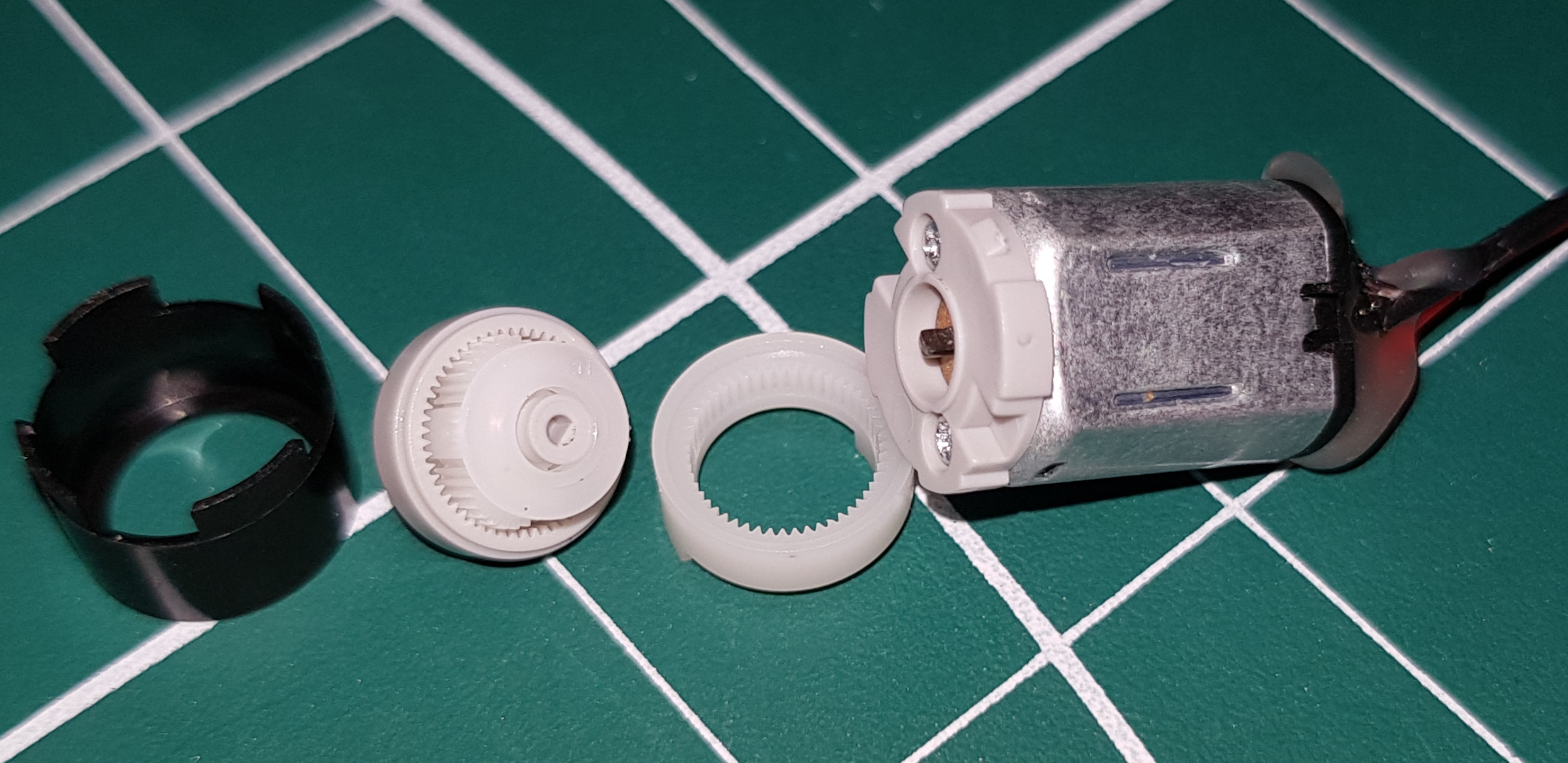

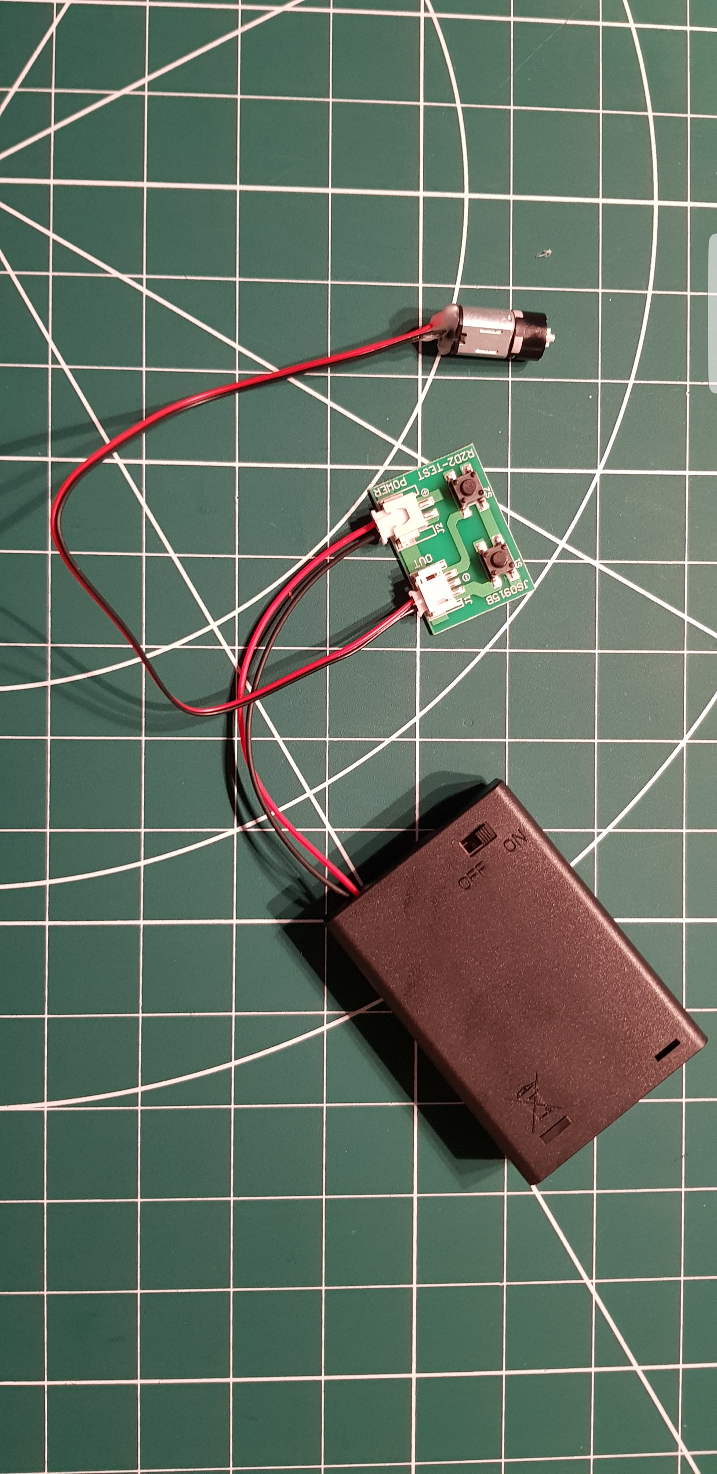

My unit did not work when tested. I found that the motor was the problem. If you connect it to the original test board (see pic) it should run. The problem with mine was with the gear on the end of the motor. I released this gear(see pic for clip on gear housing circled in yellow) then retested, motor worked. Gearing worked ok, so I assume the flat on the motor shaft was not aligned properly with the flat inside the gear. Once assembled correctly, all worked ok
#9 Posted : 01 January 2019 21:31:08
Thats a good tip and thanks for posting it.
