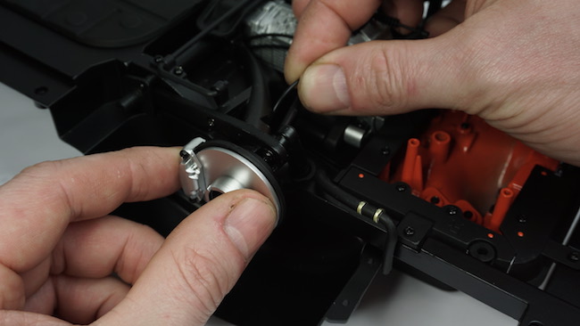

#1 Posted : 16 January 2018 22:22:47

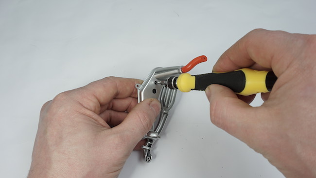

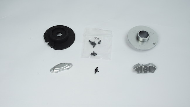

Stage 29

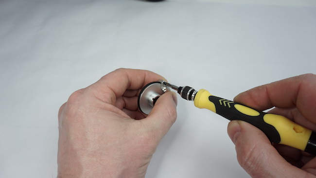

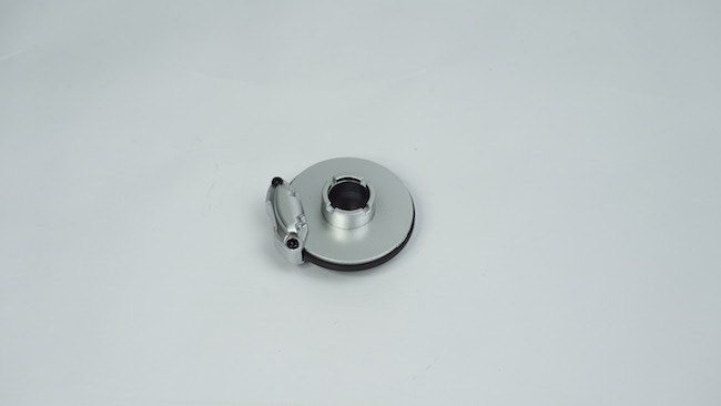

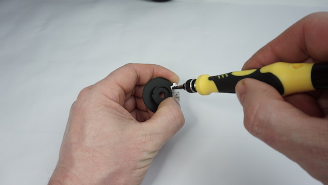

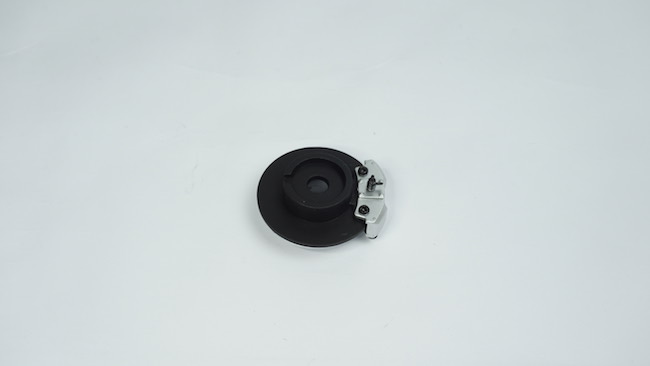

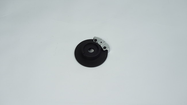

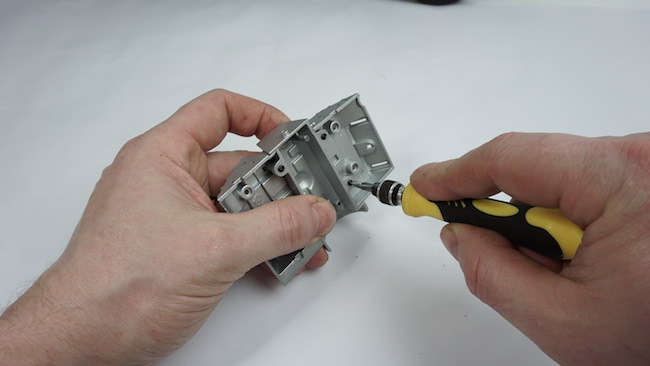

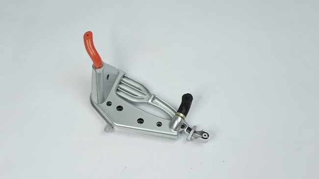

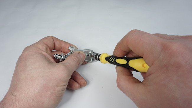

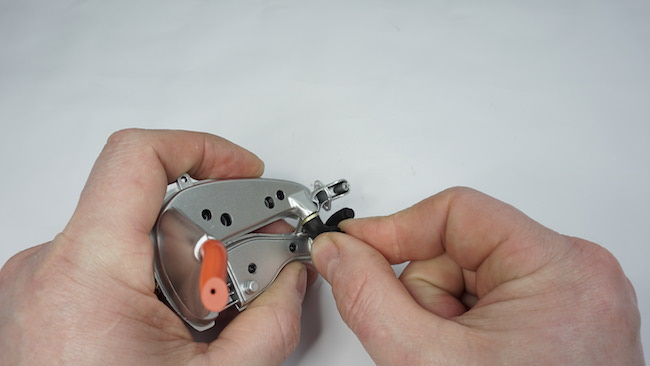

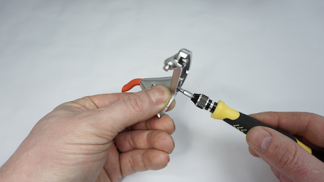

Contains: Rear brake disc cover, Rear brake disc, Rear brake caliper A, Rear brake caliper B, Brake hose connector and assorted screws.
Align the holes in rear brake caliper A with those in the rear brake disc cover then fix the parts together with two AP screws now turn the assembly over and push the rear brake disc into the centre of the rear brake disc cover.
Align the holes in rear brake caliper B with those in the rear brake caliper A then fix the parts together with two AP screws, now insert the larger end of the brake hose connector into the hole in rear brake caliper A.
#2 Posted : 16 January 2018 22:25:32

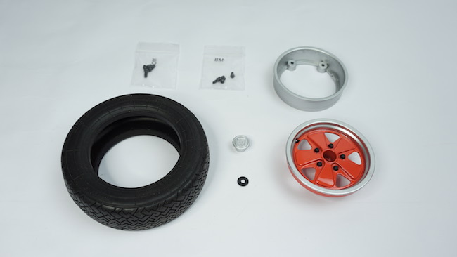

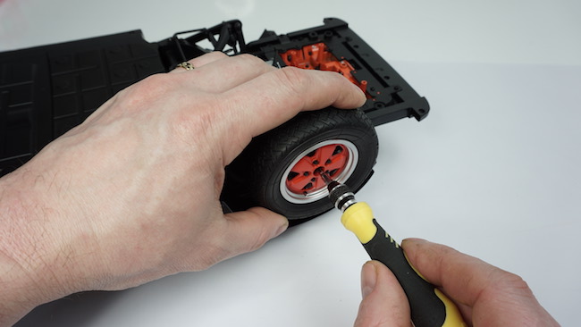

Stage 30

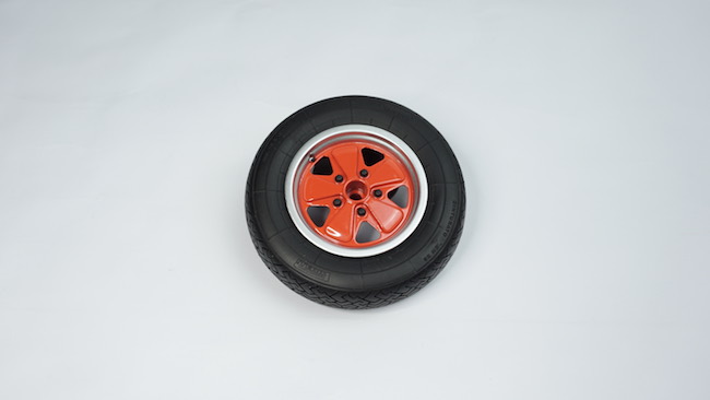

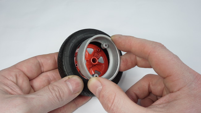

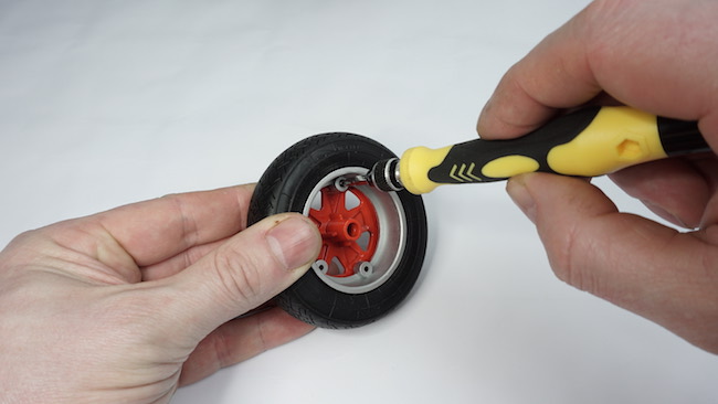

Contains: Rear Tyre (215/60 R15), Rim, Wheel, Hub cover, Washer and assorted screws.
Pack 5 stock (which includes the Stage 30 rear wheel & tyre), contains an incorrect front tyre rather than a rear tyre, (the front and rear tyres differ in width).
The correct Stage 30 rear tyre is being provided with later content at around Pack 10 or 12.
In the meantime, you can temporarily fit the incorrect tyre onto the wheel, then do a rear tyre swop when you receive the replacement rear tyre.
Note that the Rear tyres are wider than the front.

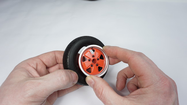

Place the rim into the tyre then turn the assembly over and insert the wheel into the tyre, aligning the holes of both.
Now tighten three BM screws into the three holes in the wheel.

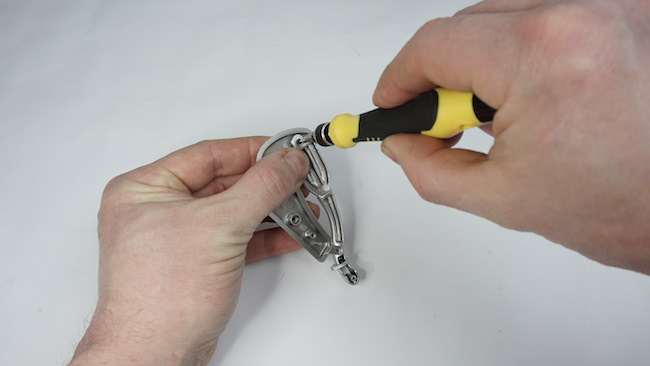

Stage 31

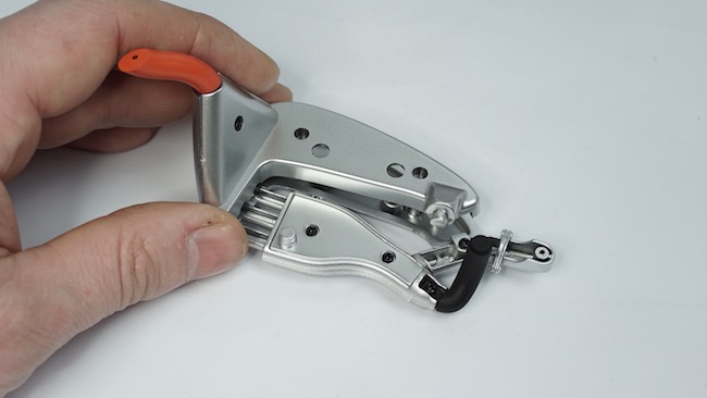

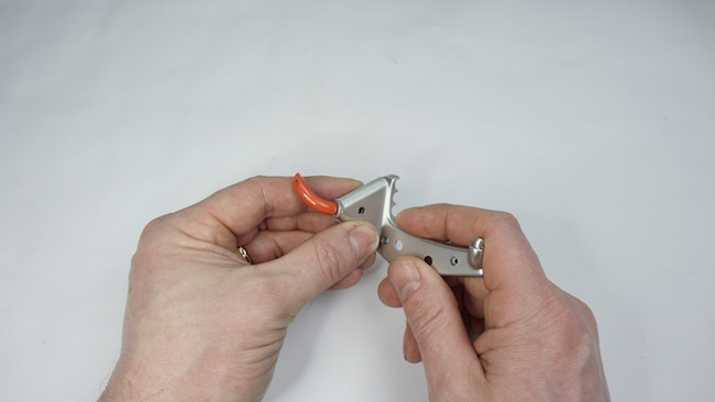

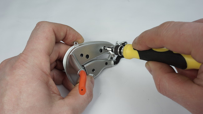

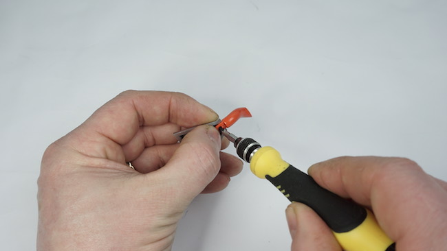

Align the holes in rear brake caliper A with those in the rear brake disc cover then secure the parts with two AP screws, now turn the assembly around and place the rear brake disc into the centre of the rear brake disc cover.
Align the holes in rear brake caliper B with those in the rear brake caliper A. Make sure the holes in the brake calipers are aligned, then tighten two AP screws into them to secure, now insert the larger end of the brake hose connector into the hole in rear brake caliper A.

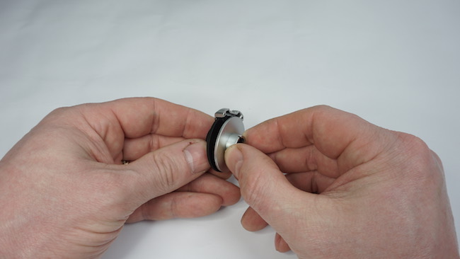

#4 Posted : 16 January 2018 22:35:26

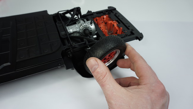

Stage 32

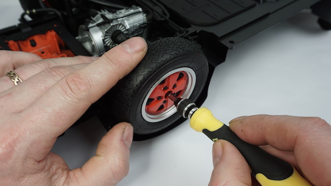

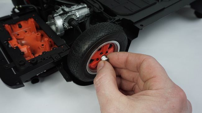

Insert the rim into the tyre then turn the assembly over and insert the wheel into the tyre. Make sure that the screw holes of the wheel and rim are aligned, now tighten three BM screws into the holes in the wheel.

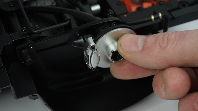

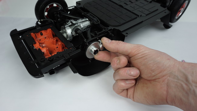

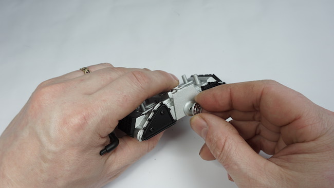

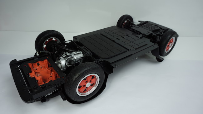

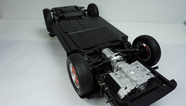

Place the main body assembly upside down on a flat surface and place one of the rear brake assemblies onto the swingarm of the right rear suspension, with the brake caliper facing forward. Locate the free ends of the rear brake hose and handbrake cable then pass them between the swingarm and the underbody, now connect them to the protruding parts of the brake hose connector.
Mount the right rear wheel onto the rear disc brake, make sure the post on the inside of the rim engages with the disc.
Place a washer into the centre of the rim and secure the wheel with a CM screw, now take the remaining rear disc brake and set it onto the swingarm of the left rear suspension, then follow the previous steps to mount the left rear wheel.
Position the disc so that the calipers are facing forward, locate the free ends of the rear brake hose and handbrake cable now pass them between the left rear suspension swingarm and the underbody, and connect them to the protruding parts of the brake hose connector.
Fit the post on the inside of the rear wheel into the space in the centre of the brake disc then place the washer into the rim and secure the wheel with a CM screw, now insert the hub covers into the centre of the rims.

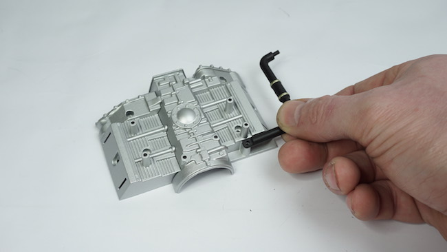

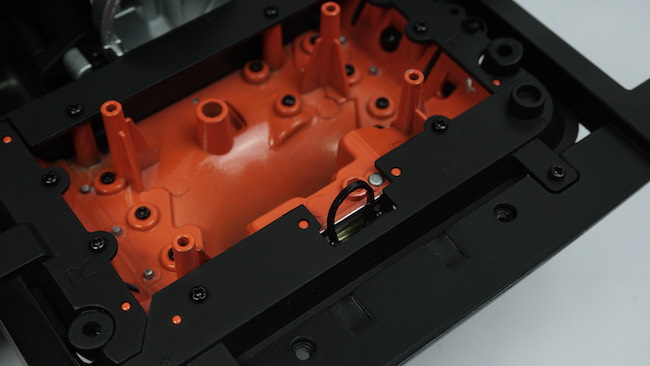

#5 Posted : 16 January 2018 22:48:58

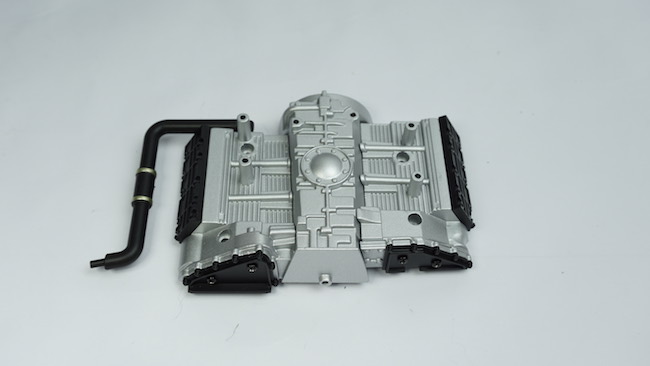

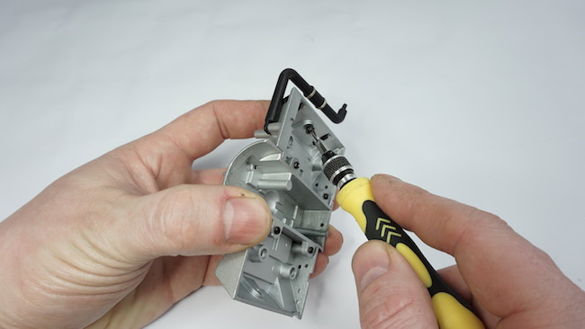

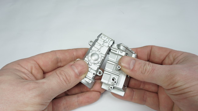

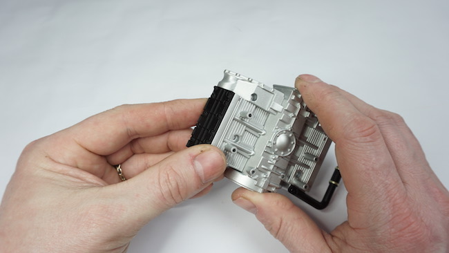

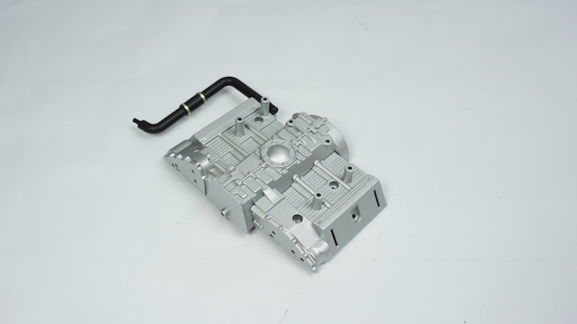

Stage 33

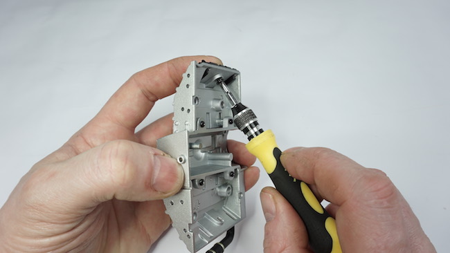

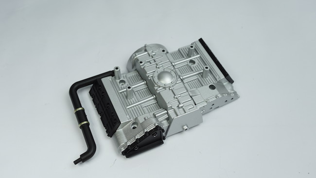

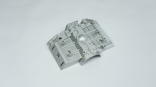

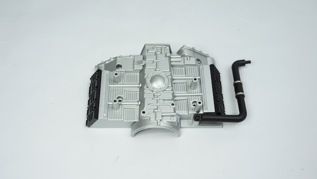

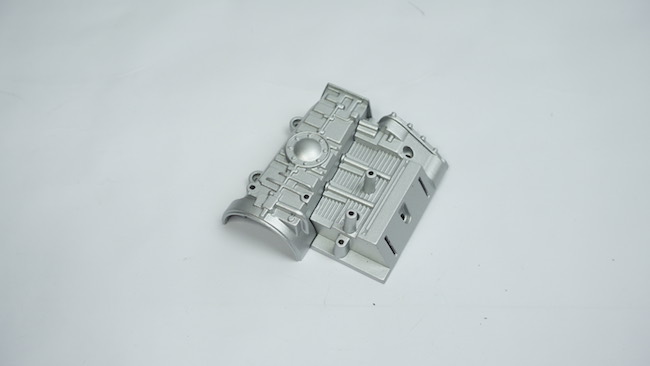

Contains: Crankcase, Right cylinder block, Left cylinder block, Oil pipe and assorted screws.
Insert the posts on the inside of the right cylinder block marked R, into the holes in the tabs at the side of the crankcase then secure the block to the crankcase with two BM screws inserted through the crankcase tabs.
Insert the posts of the left cylinder block into the holes in the tabs on the other side of the crankcase, then secure the left cylinder block to the crankcase with two BM screws, now align the hole in the oil pipe with the hole in the right cylinder block and secure it with a BM screw.

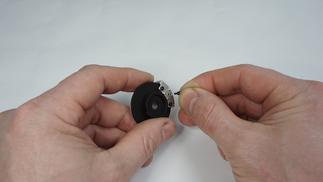

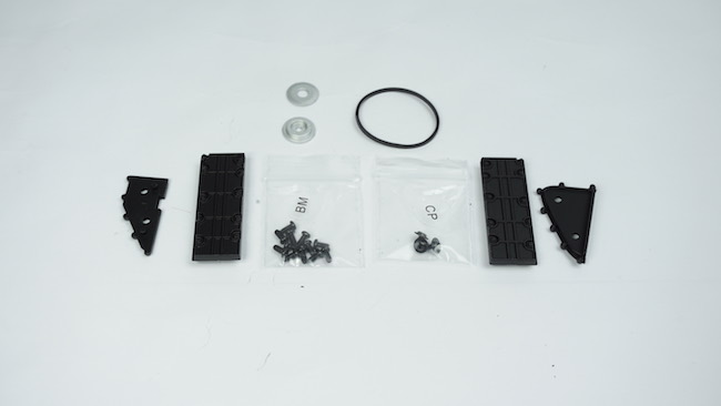

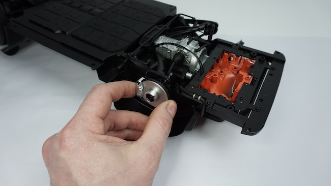

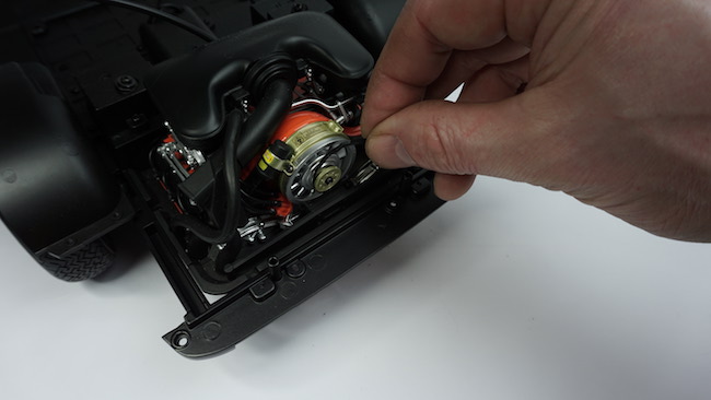

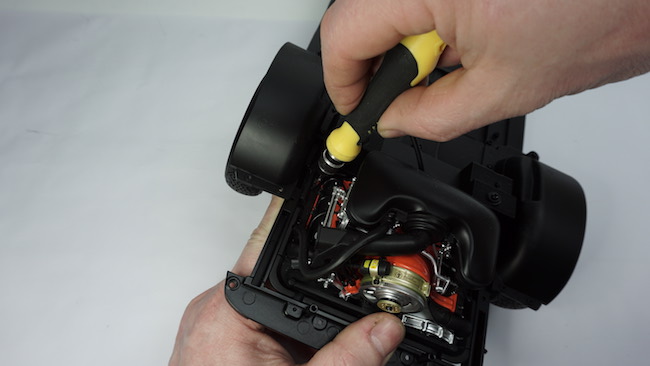

#6 Posted : 16 January 2018 23:04:06

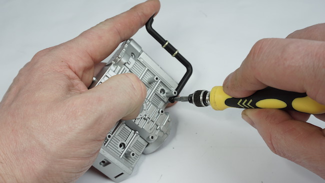

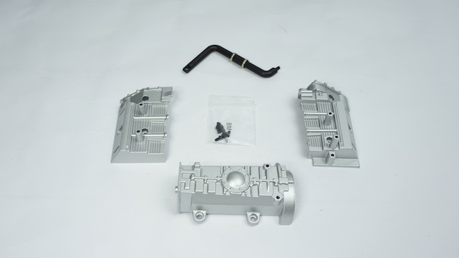

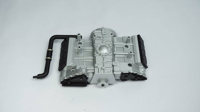

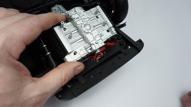

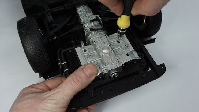

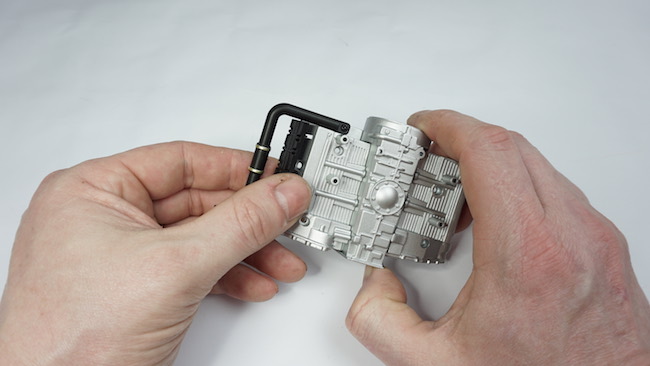

Stage 34

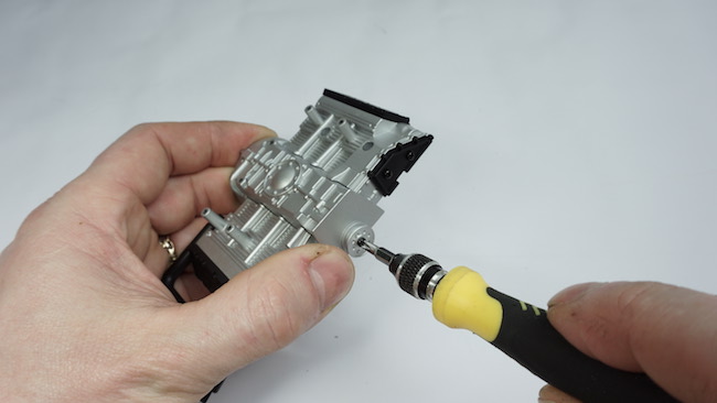

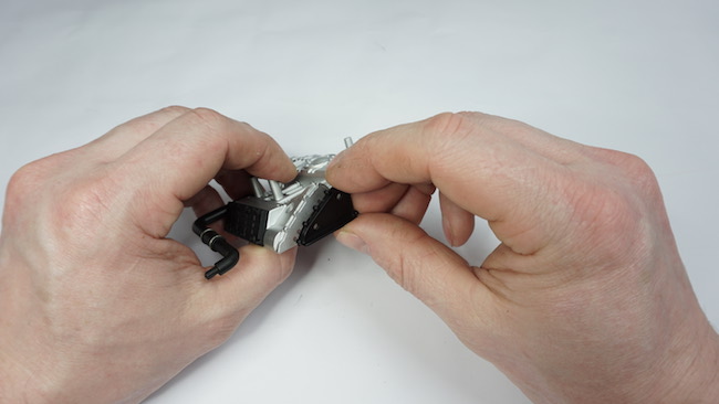

Contains: Right cylinder head cover, Right cover, Left cylinder head cover, Left cover, Crankshaft pulley 1, Crankshaft pulley 2, Fan belt and assorted screws.

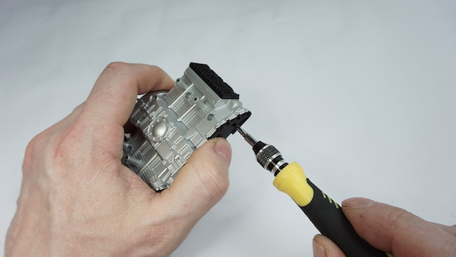

Place the right cylinder head cover marked R, on the right cylinder block, inserting the three projections into the corresponding holes, then secure the parts together with a CP screw. Place the left cylinder head cover marked L, on the left cylinder block, now secure it there with a CP screw inserted from the inside.
Insert the pins on the right cover into the holes in the right cylinder block and secure the parts with two BM screws. Insert the pins of the left cover into the holes in the left cylinder block then use two BM screws to secure the cover.
Place crankshaft pulley 1 onto the post on the rear of the crankcase, with the smooth side facing forward. Next, fit crankshaft pulley 2 onto the post so that the small circular depressions are facing the back then use a BM screw to secure the parts.
Locate the fan pulley on the engine and place the fan belt in the space between the pulley and the fan, passing the belt down. Turn the main body assembly over then pull the fan belt down and place it over the crankshaft pulleys. Insert the semicircular tab on the crankcase into the transmission case, make sure that the posts of the engine fit into the corresponding holes in the crankcase then fix the crankcase to the engine top with four BM screws.

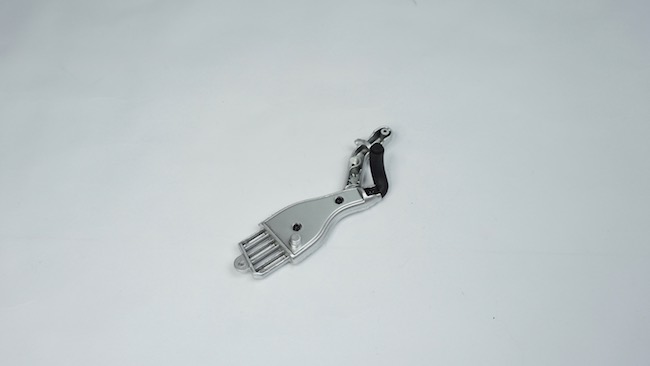

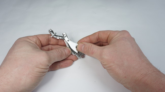

#7 Posted : 16 January 2018 23:20:10

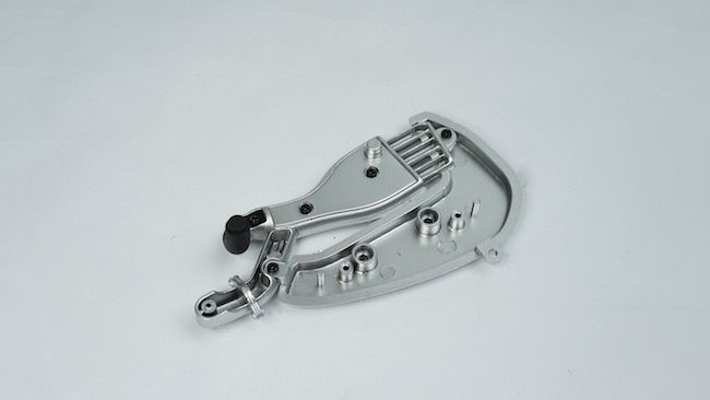

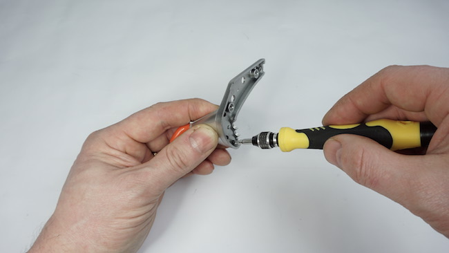

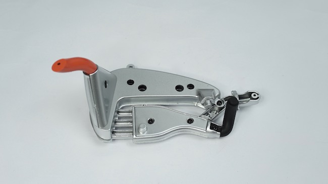

Stage 35

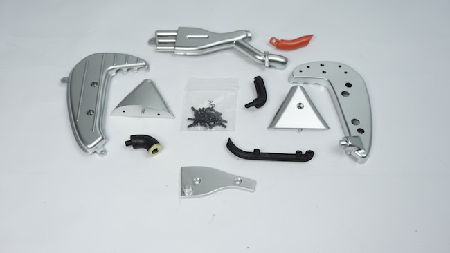

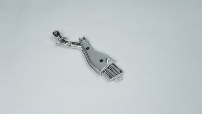

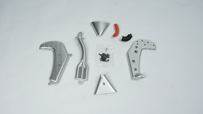

Contains: Left exhaust heat exchanger 1, Left exhaust heat exchanger 2, Left exhaust heat exchanger 3, Left exhaust heat exchanger 4, Left exhaust heat exchanger 5, Left exhaust heat exchanger 6, Left exhaust heat exchanger 7, Left exhaust heat exchanger 8, Left exhaust heat exchanger 9, Left exhaust heat exchanger 10 and assorted screws.

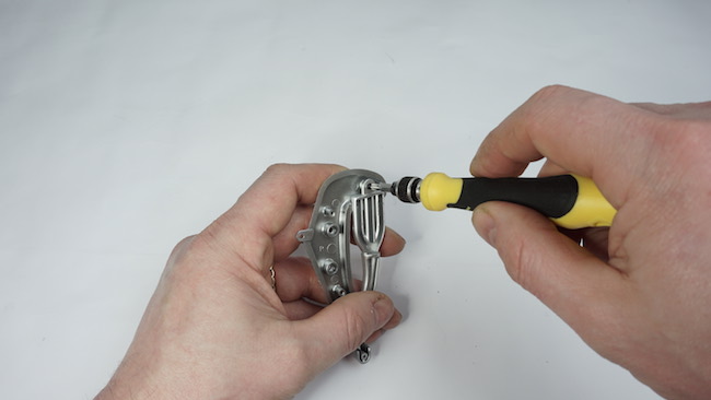

Place left exhaust heat exchanger 7 into the left exhaust heat exchanger 6, and secure it with two AP screws. Then place left exhaust heat exchanger 8 into the rectangular socket at the end of left exhaust heat exchanger 6 and secure with an AP screw.
Engage the left exhaust heat exchanger 5 with the left exhaust heat exchanger 6, aligning the indicated holes of both parts then tighten an AP screw into each of the two indicated holes to fix the parts together. Align the hole in the tab on left exhaust heat exchanger 4 with the hole in the end of left exhaust heat exchanger 2 then use an AP screw to secure it.
Insert the pins on the inside of left exhaust heat exchanger 3 into the holes in left exhaust heat exchanger 2 then secure the parts with an AP screw, inserted through the hole in the centre of left exhaust heat exchanger 3. Now insert the pins of the assembly into the holes in left exhaust heat exchanger 1 and secure the parts together from below with four AP screws.

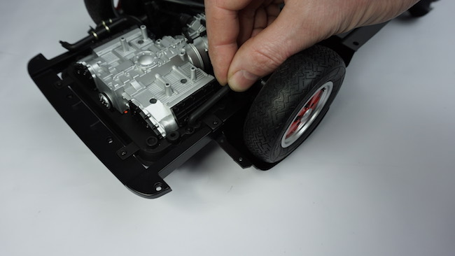

Place this assembly onto the parts from Step 35-4, aligning the pins and holes then secure the two assemblies together with two AP screws. Now place left exhaust heat exchanger 9 onto the end of left exhaust heat exchanger 1, positioned so that the free end is pointing upwards. Then insert the end of left exhaust heat exchanger 10 into the bottom end of the hot air pipe and secure it there with two AP screws inserted through the chassis, as shown.

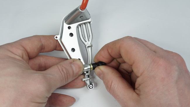

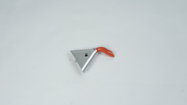

#8 Posted : 16 January 2018 23:24:51

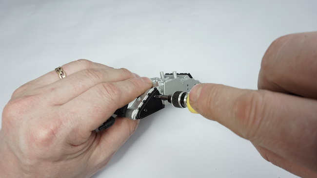

Stage 36

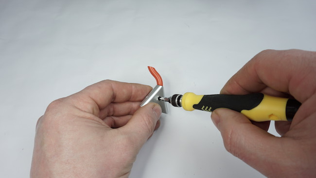

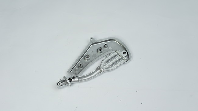

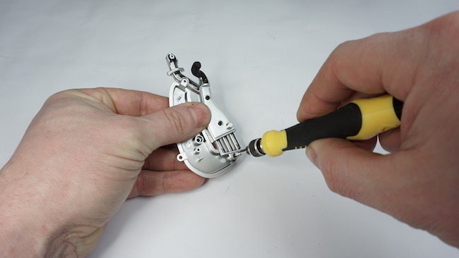

Contains: Right exhaust heat exchanger 1, Right exhaust heat exchanger 2, Right exhaust heat exchanger 3, Right exhaust heat exchanger 4, Right exhaust heat exchanger 5, Right exhaust heat exchanger, Right exhaust heat exchanger 7 and assorted screws.
Align the tab on right exhaust heat exchanger 4 with the hole in the end of right exhaust heat exchanger 2 then use an AP screw to secure them. Now insert the pins of right exhaust heat exchanger 3 into the holes in right exhaust heat exchanger 2 and secure the parts with an AP screw.
Insert the pins on the assembly into the holes in right exhaust heat exchanger 1 then fix them together with four AP screws, inserted from below. Combine right exhaust heat exchanger 5 with right exhaust heat exchanger 6, aligning the parts as shown and fix the two parts together with two AP screws.
Place the two assemblies together, and secure with two AP screws. Now place right exhaust heat exchanger 7 onto right exhaust heat exchanger 1. Position the part so that the end is pointing upwards.
