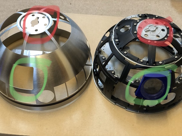

#3 Posted : 08 January 2018 13:08:30
Joined: 08/03/2011
Posts: 245
Points: 726
Location: Norwich
Hi Coser, Thanks for the reply but mine is definitely wrong.
I am going by the alignment of the "Primary Photoreceptor Faceplate" ringed in green on the dome & frame.
if you now compare the top one-way keyhole they do NOT line up (in red)Crying .
So any guidance or references eagerly accepted - thanks Cool

#4 Posted : 08 January 2018 13:22:06
Joined: 12/01/2017
Posts: 572
Points: 1,731
Location: Cambridgeshire
I see.
Yes, that's definitely wrong.
It looks like you have missed lining up the arrows at the start of each 'layer' of the frame.
If you have not had any further replies by tonight, I'll post some pics of mine and we can see where yours is different.
Edit:
Gut feeling is that the top layer is correct to the crown, but that layer is off with the one beneath.

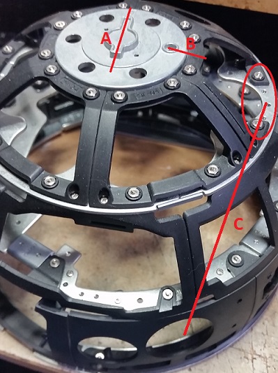

#6 Posted : 08 January 2018 15:20:33
Hi BigGrin
My dome arrived today so I`ve checked out that mine fits and it does.
I`ve attached a pic below with reference points of alignment.
A: is the key on top of the frame with the longest part of the key furthest away.
B: is the where the two alignment arrows should be.
C: is from the gap in the upper ring to the holes that are in one piece in the lower ring.
Hope this helps.

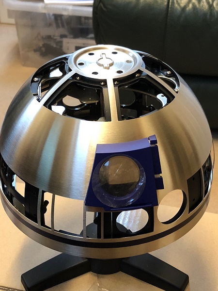

#8 Posted : 08 January 2018 15:27:09
Joined: 08/03/2011
Posts: 245
Points: 726
Location: Norwich
Hi Coser, thanks for the pointer on layer 1 > Layer 2
So I checked & it was the placement of the very first layer 2 frame.
All the layer 2 & 3 frame parts were aligned correctly with each other, just not with layer 1. So I removed just layer one & twisted it to the correct orientation & all looks good now :)
