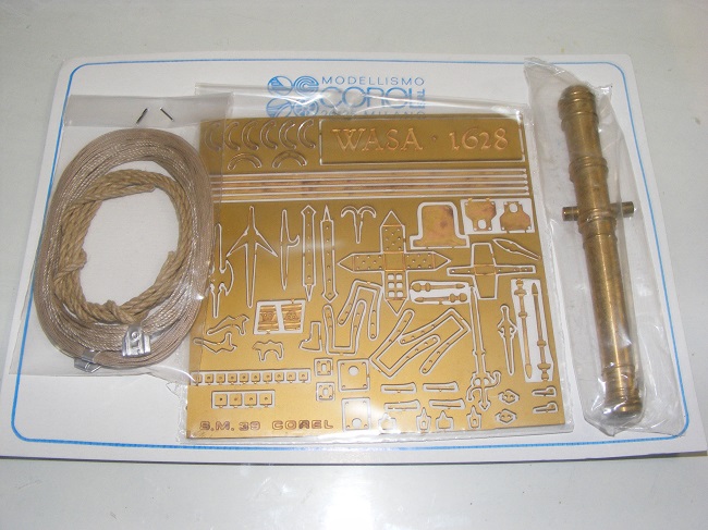

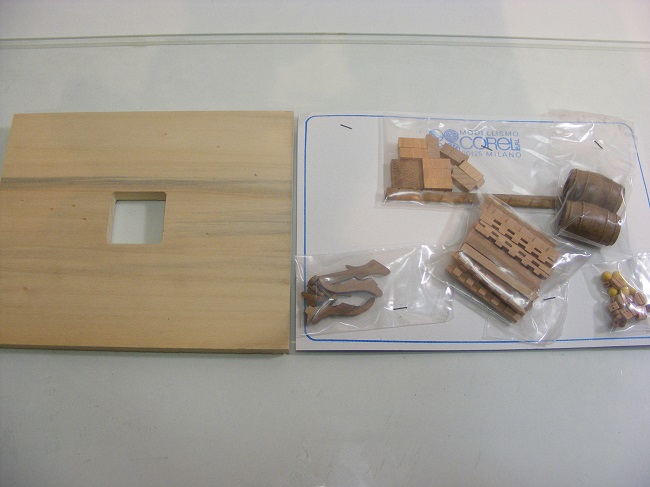

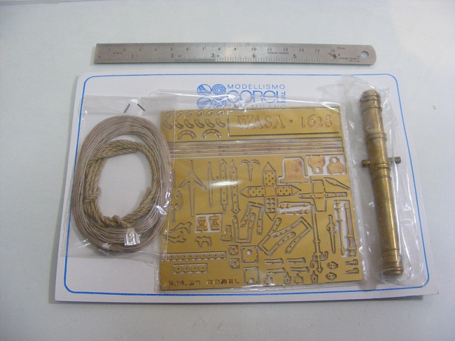

Thought it was time to throw my hat into the ring for this year’s competition and after much deliberation have decided to do Coral’s 1/24 Gun Deck section of the Swedish Warship WASA. A much sought after kit but normally at inflated prices. The kit reproduces a sector of the left bulwarks, part of the deck and underlying battery deck. Apart from the hull structure special emphasis has been paid to the cannon and gun carriage together with all the relevant equipment to make this as accurate as possible at the time of production.

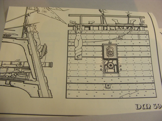

The fittings and ornaments provided are all hardwood or metal with a photoetch brass sheet for the swords and other items. Written instructions are very basic but the drawings/plans are excellent and hopefully will build up into a very nice display piece.
A couple of pics have been provided for now and more will be shown as the build progresses. Will be starting this very soon, just as soon as I have everything I need…..

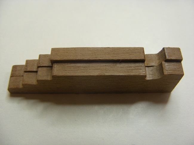

After spending some considerable amount of time just going through the plans and materials I thought it was about time to at least make a start on this one. My first conclusion after studying this was a realisation that this is not a kit for the beginner or feint hearted, it is what I would class as a model builders kit and not simply a kit of gluing parts together. In fact the instructions do come with a statement warning potential builders that they will not be able to construct this kit simply by referring to plans and personal experience alone. You have to work in conjunction with the written instructions which are pretty basic to say the least, they're simply a guide. Now I believe it.

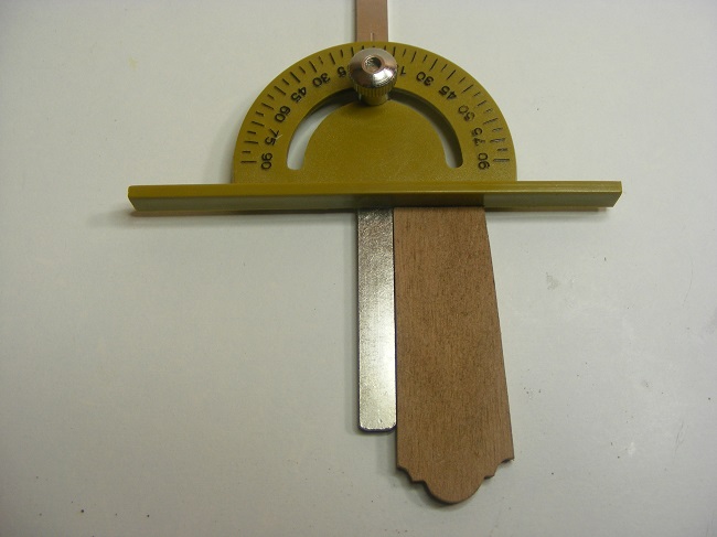

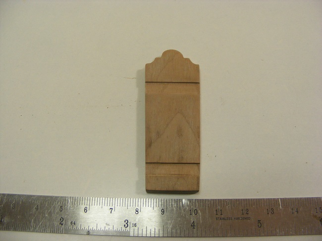

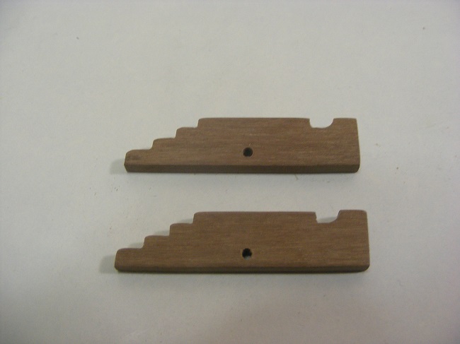

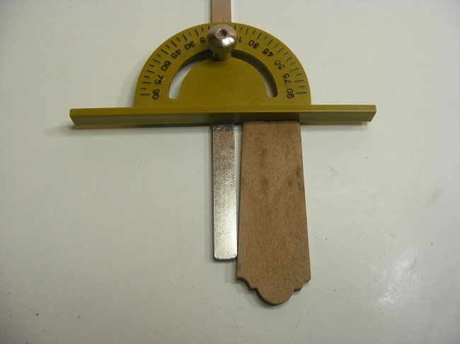

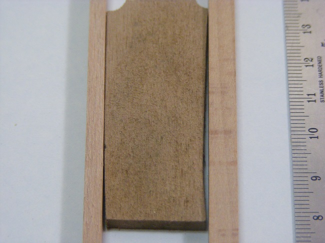

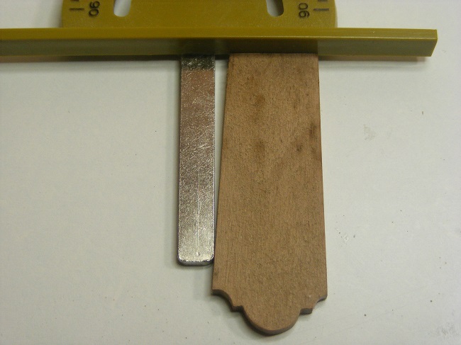

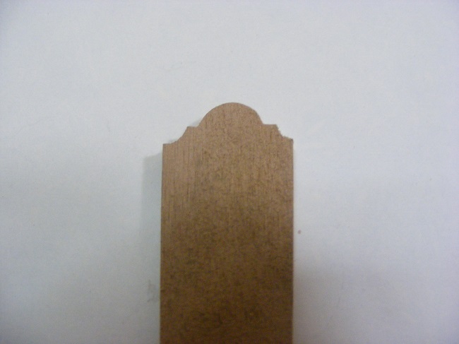

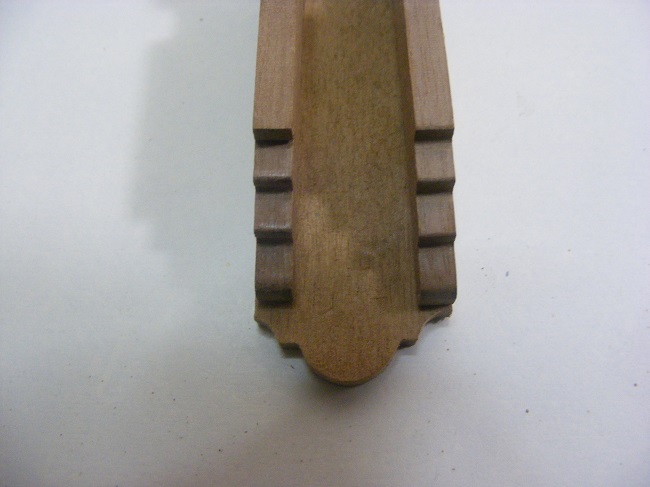

First part I thought we'd get underway was the cannon and gun carriage and this post will just outline the immediate problems I've found and I haven't started building it yet.....Huh Huh . The base of the cannon was found to have uneven sides and these will require straightening off. You will also see that the base is by no means symetrical, whoever cut this out must have had a heavy evening in the pub beforehand. When you see this it makes you appreciate kits that come with lazer cut parts. The pics clearly show how much needs to be done in order to put this right unless I want a wonky gun carriage.... It is so far out that I do have concerns whether this piece is actually viable, we'll see
You will also see the cannon sides, although a little better, they too require a degree of work to ensure they match up with each other but shouldn't present too much of a problem.

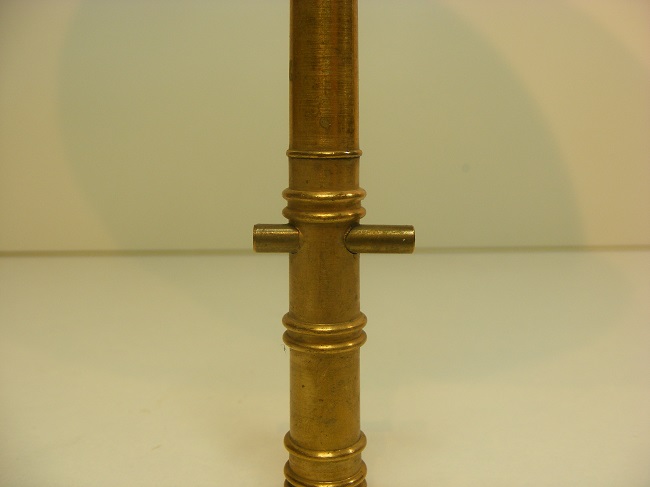

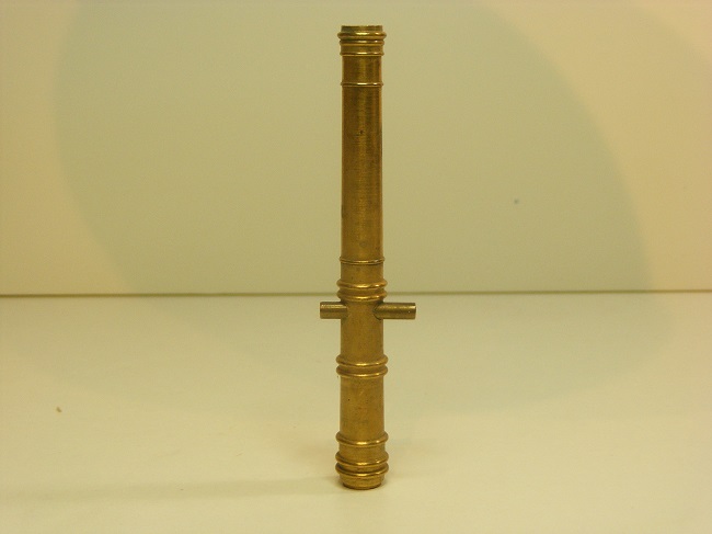

The cannon itself is 11cm of turned brass, very nicely done but I think you'll see the problem with the pivot when looking at the pic, the pivot is not a separate piece.

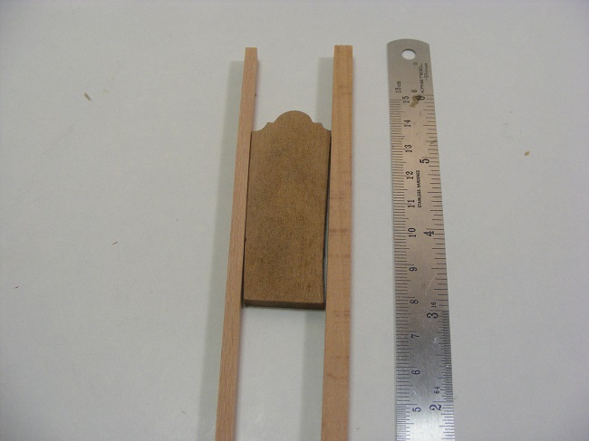

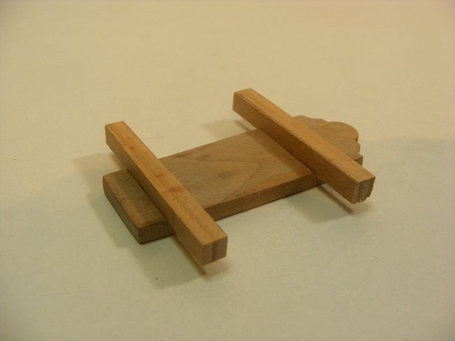

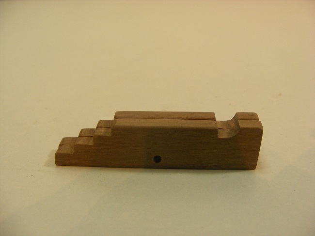

Positive progress has been made on the carriage base and sides, now think I have achieved something that can be classed as presentable. At least now the base is symmetrical and the sides are both the same..... BigGrin BigGrin
On the base, two 5mm channels were created to accommodate the axles, this was done using a small square needle file and a lot of care.... Piece was then sanded smooth. Once happy with the two side panels, 2mm holes were drilled in each for the slings, again both were sanded smooth to finish.

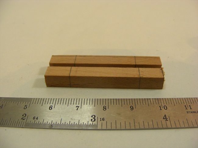

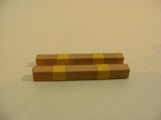

Next stage was to start work on the axles. Cut two pieces from a 6 x 6mm strip of beach. Strange they supplied 6 x 6mm for this rather than 5 x 5mm as the plans call for 5mm sqare, so these two pieces had to be reduced to 5mm square. The size is important as they have to fit the channels in the base plus any larger and some pieces of the brass etch will not fit. The two pieces are not identical due to the shape of the base and the masking is there so it can be seen when inserted into my lathe, so the axle ends can be rounded off for the fitting of the wheels.....Cool Cool .. This will be left until the next build session......Cool
