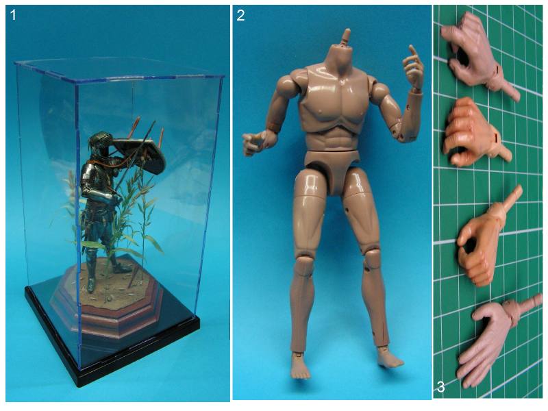

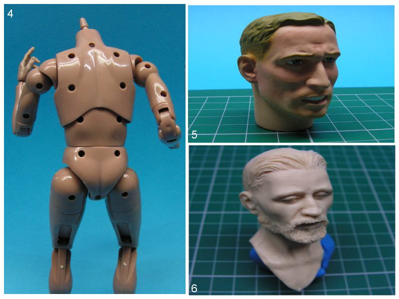

Most of the articles required for the build have now arrived so the real planning and experimenting can begin. The actual thing that gave me the idea for this model is shown in Photo 1. No, not Frederick himself, but his swanky new residence! This brilliant display case was found on ebay (of course), and was, to be honest, cheaper than I could make one for from scratch. The case consisting of five clip together acrylic panels measures 14cm square (at the base and lid) by 21.5cm high. It cost just under £9 which is very good value. I had intended using this size for the busts but it soon became apparent that this would be too tight. The next size up is intended to display a full size 1/6th scale figure and a bust, together with a name plinth (especially if the arm(s) are raised) isn’t going to be much shorter than the full figure height anyway. The next purchase will have to be one of those cases to make sure the pose will actually fit inside! That's just arrived now!
Photo 2 illustrates the basic ‘core’ of the bust – a 1/6th scale articulated ‘action figure’ all the way from China. The cost of this figure is even more impressive – far more articulation joints than a basic Action Man for just £3.25 (and free p&p!) Costing more than the whole figure, in Photo 3 I have a selection of hands, these are made by a company called “Dragon in Dreams”, who also make full figures and uniforms. The two I’m planning on using are the second one down (gripping the machete) and the bottom one (where the others are moulded that shape, this one actually bends to whatever position is required). Going back to the body again, in Photo 4 you can see the other reason apart from the cost that this figure is so useful – the whole thing is secured with lots of tiny screws! Although at that price I could simply epoxy the figure in the pose I want and saw it up to make moulds, I hate destroying any perfectly good model/item. So the intention is to dismantle the figure down to the torso and arms, make silicone moulds and resin casts to Milliput over and then put him back together again until the next figure evolves. In Photo 5 we have the head that won’t be used this time. This was another Chinese import at £2.29 and isn’t half bad at that price. I was going to Milliput a straggly beard and longer hair but after I’d sent off for that one I found a perfect match as seen in Photo 6. I came across an absolutely brilliant website called www.antheads.co.uk. This site is run by a chap called Tony Barton, who in my opinion is one of the best sculptors I’ve seen. I chose this head, No.67 in his catalogue as it looked just what I needed – haggard and exhausted. It was only after I’d ordered the head (and another item) that I looked through his photo gallery and discovered that he’d designed that face – for a Chindit figure!Blink (There must be something in that ‘Minds thinking alike’ saying!
So these are the main components, minus the plinth base which I’m still pondering over. The first job is to convert the solid resin Tony Barton casting into a hollow version which will eventually be losing the top of his head to accept his resin cast floppy jungle hat. So in the next instalment, lots of silicone rubber and my first experience of Roto Casting Resin.
Robin.

Looks like a nice collection of body parts for you to build on Robin. Can't wait to watch this build evolve and I'm sure it will be completely enthralling as your projects always are! Cool Drool ThumpUp
Can't believe how much that head in photo #5 reminds me of Arnold Schwarzenegger! Glare Blink BigGrin
#16 Posted : 05 February 2018 14:22:20
Not only Schwarzenegger in pic #5 but pic #6 could be Kirk Douglas in his younger days LOL nice update Robin, look forward to seeing more of your progress.

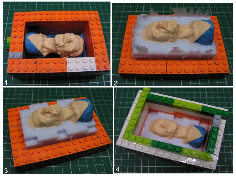

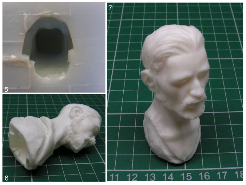

Since the whole idea behind this year’s entry is to create an entire model made of home cast resin, the first task I had to attempt was to turn the solid resin Tony Barton head into a hollow replica which will be fitted onto the also hollow torso later. Photo 1 illustrates the solid original fitted onto a plasticene ‘plug’ under the neck, resting in the lego brick mould casting box. The plan was that the plug was supposed to stick the head to the side wall and the first pouring of silicone rubber would flow under the head. What actually happened was that the head slowly sank down during the curing and came to rest on the plasticene base. When the rubber has cured I found a tiny hole where the back of the head touched the base which needed a second layer of silicone poured over the underside of the rubber. In hindsight, what I should have done was to pour in a layer of silicone first, let that cure and then put in the head to rest on that before pouring the main silicone in! Photo 2 shows the first pouring after curing before trimming off the rubber ‘flash’. The silicone was poured in up to the half way point in the width of the head as you can see. In Photo 3, the flash has been trimmed off and the edges of the rubber cut away to create the locating tabs for the second half of the mould. Once these were cut the surface of the rubber was given three coats of liquid wax release agent. When the last coat was dry the lego box was built up to the final height ready to pour in the second half of the mould as shown in Photo 4. Once the second half has fully cured, the two parts were carefully separated and the head removed. After placing the mould halves back together a small quantity of the Roto Resin was mixed together (1:1 part A and B just as per the ‘normal’ polyurethane resin) and the mixture was poured into the mould. I then had to carefully rotate the mould around, ensuring the liquid resin ran into all the various depressions inside the mould plus ‘almost’ running out of the top to cover the front of the neck and the plug. Eventually, when the resin can’t be seen to be running around anymore the mould was left either upside down or tilted up face down so any resin still able to ‘drool’ around would collect either in the top of the head or behind the face for extra thickness. The liquid resin can be seen running around the inside of the mould in Photo 5. This was repeated three more times giving an overall thickness of four coats of resin resulting in the finished casting shown in Photos 6 and 7. The detail from the silicone mould has come out very well indeed, the plug part will be cut away later when the torso is modelled and the head will then become an integral part of an even bigger mould with the head and torso combined as one casting.
In the next instalment, before starting the body part I’ll be creating the iconic floppy jungle hat to complete the head section first.

Excellent work on the home casting Robin, looks a flawless replica of the original resin head! CoolThumpUp
Another way to have kept the head raised and to prevent it from dropping down when pouring the silicone into the mould would have been to drill a suitably sized hole into the underside of the neck, insert a piece of brass rod, and then drill a hole the same size into the side of your Lego box and then disassemble the Lego bricks until you can insert the rod between them and tightly reassemble them to leave the head firmly suspended mid-air?
Keep up the good work Robin. ThumpUp
